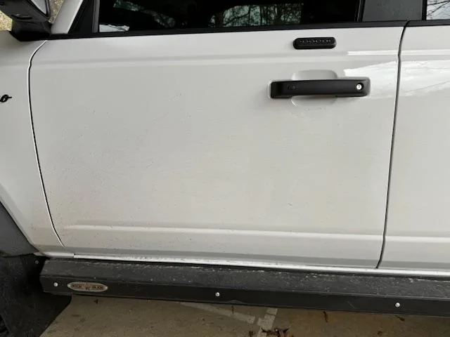

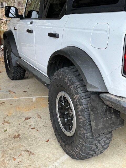

I'm not a big fan of mud flaps but I live on a lake and crossing the damn slings water on the Bronco everyday see first pic for results.

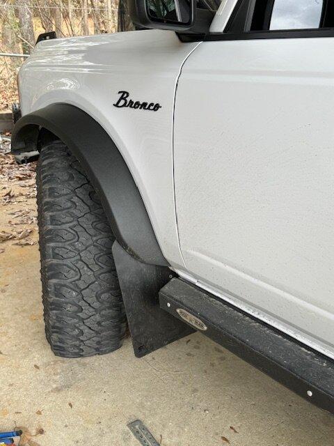

So as far as mud flaps go I love the RokBlokz the braces let me run 38s BUT they are so big

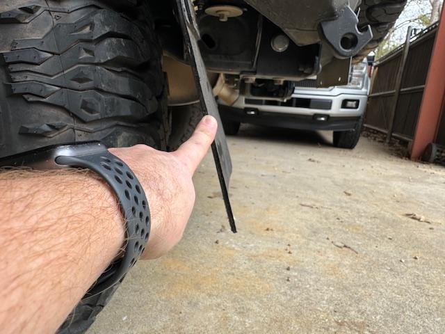

I take them off when I go riding being they stick down so far. I took them off the other day and was like they aren't going back on the next day yep dirt all over the side of my Bronco. This is when I decided to modify.

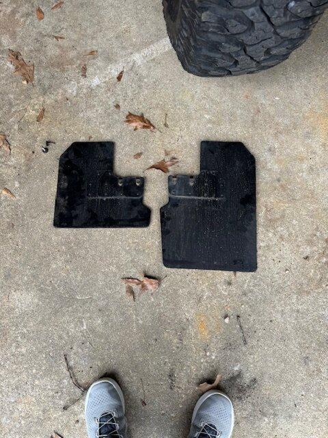

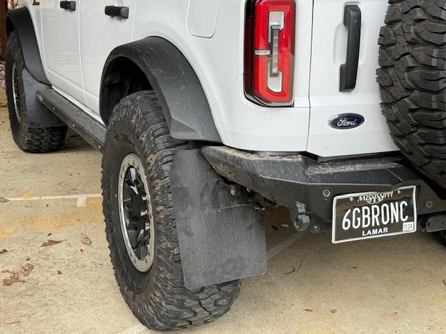

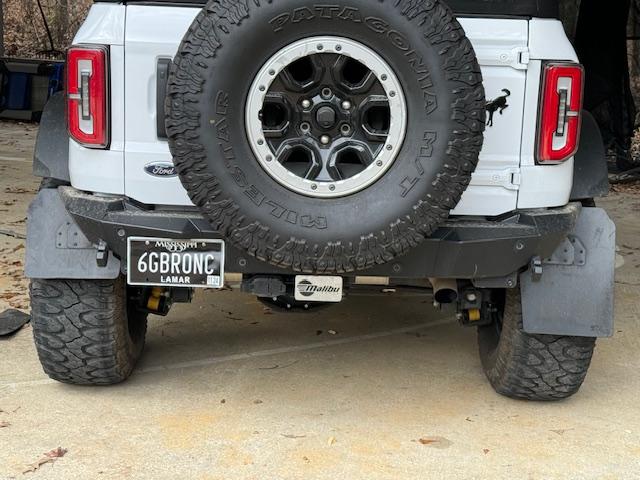

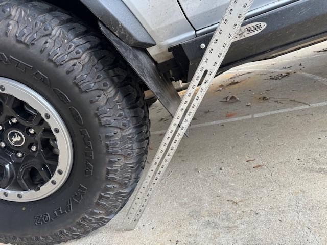

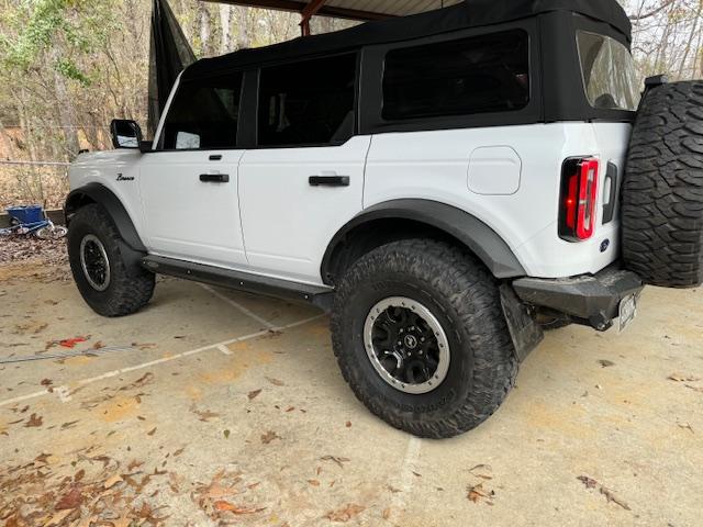

End results I took off 5 1/4in (This hight also is close to level with the undercarriage of the Bronco so I think I will leave them on when riding and see if I have any problems) If I do I will post back
I used a straight bar to decide how much to take off (See pic)

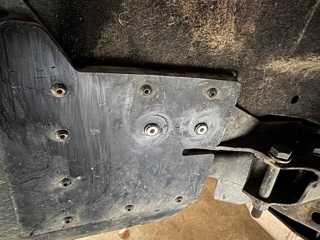

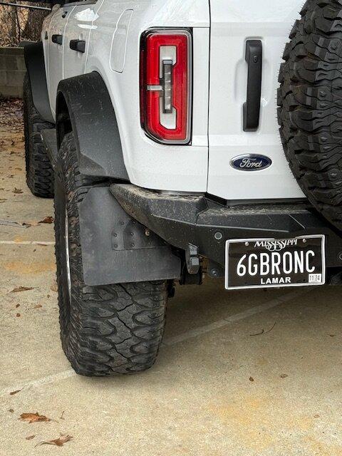

Tools needed I have a few types of cutters these ended up working best. After cutting I used a grinding wheel to get perfect then used the wire wheel to smooth out.
After cutting I used the piece I cut to make my curved edges and angles.
Key thing to point out is this worked for me because my steps block after that point so keep that in mind.

Keep in mind my steps poke out also so I only needed to fill the gap between the steps and finders.

Ok, for getting cheeper ones keep in mind when I got my flaps we didn't have but like 3 options I bought these back in Feb of 2022. But as I also wrote I like and need the brackets they use to help me fit 38s. They work great in mud gravel and dirt but as I also wrote I have steps that stick out so I only need to fill a small gap. As for Pics look at the ones I posted The first pic shows how the water was slinging up on the side. No need for another pic as I said no more water getting on the side of my bronco. If you are talking about Pics of the flaps before and after all the rest of the pics show that.

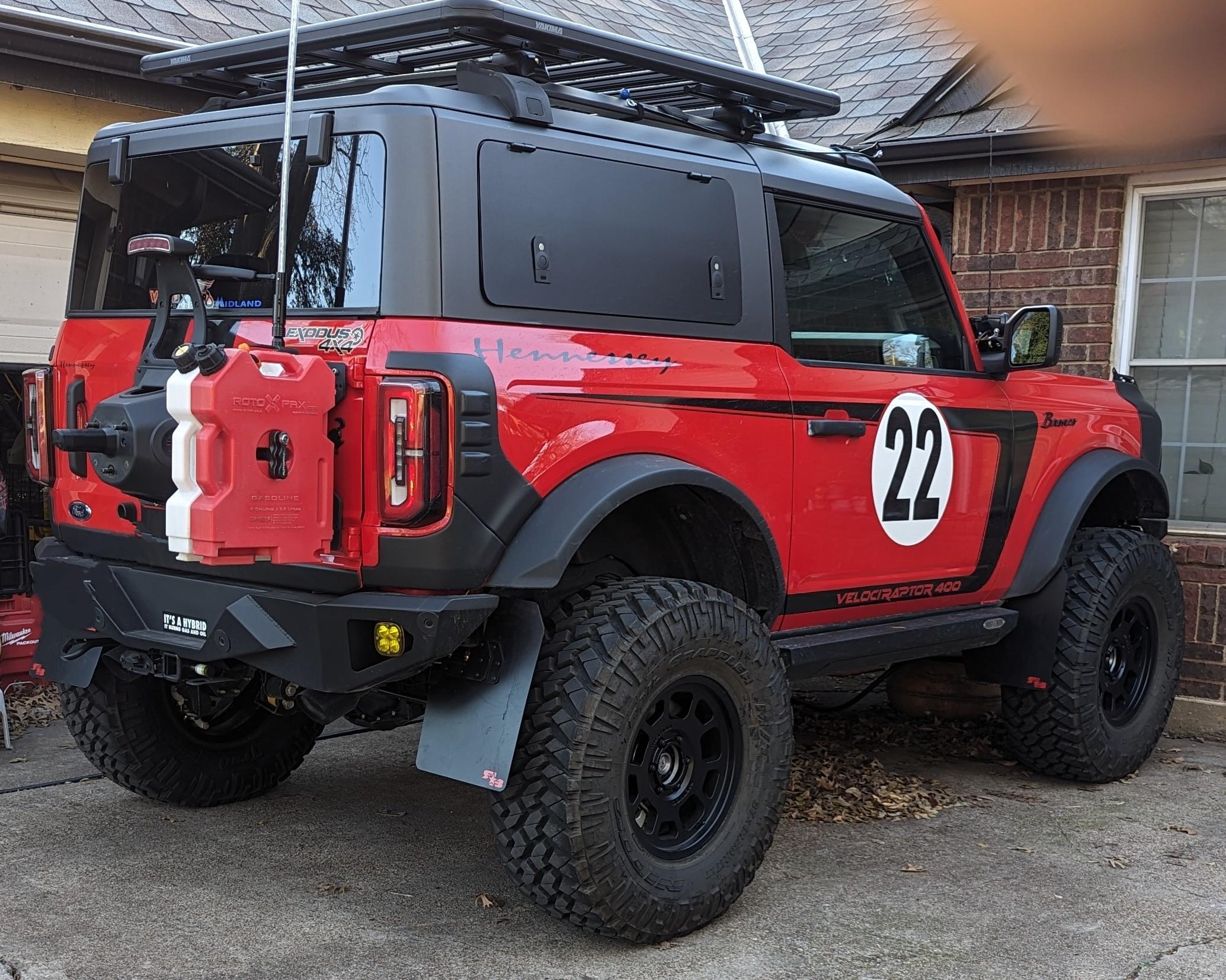

Well, I've had the truck back from the shop a couple of weeks now and I just got around to putting the XL rock bloks on to see about how much I might want to trim.
To be honest, after the 4-in lift and 37s it doesn't look too bad. I'm thinking if I did trim it it wouldn't be much more than the space the logos take up which is what one to two inches?.
I'm going to ride around like this for a while, see how they perform and take a gander at them from a few different angles. How do they look to you?
