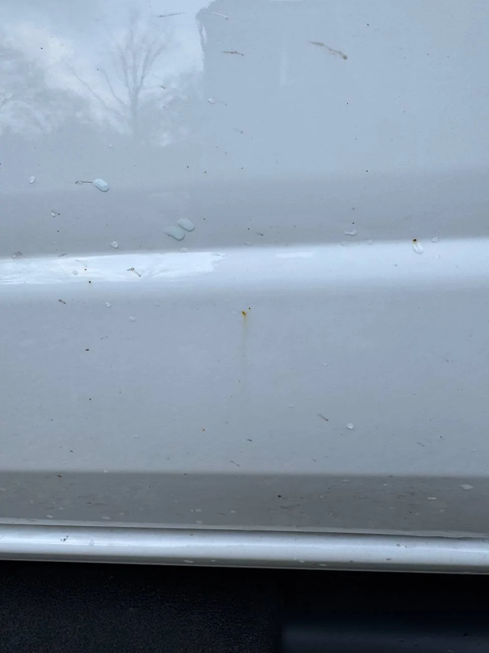

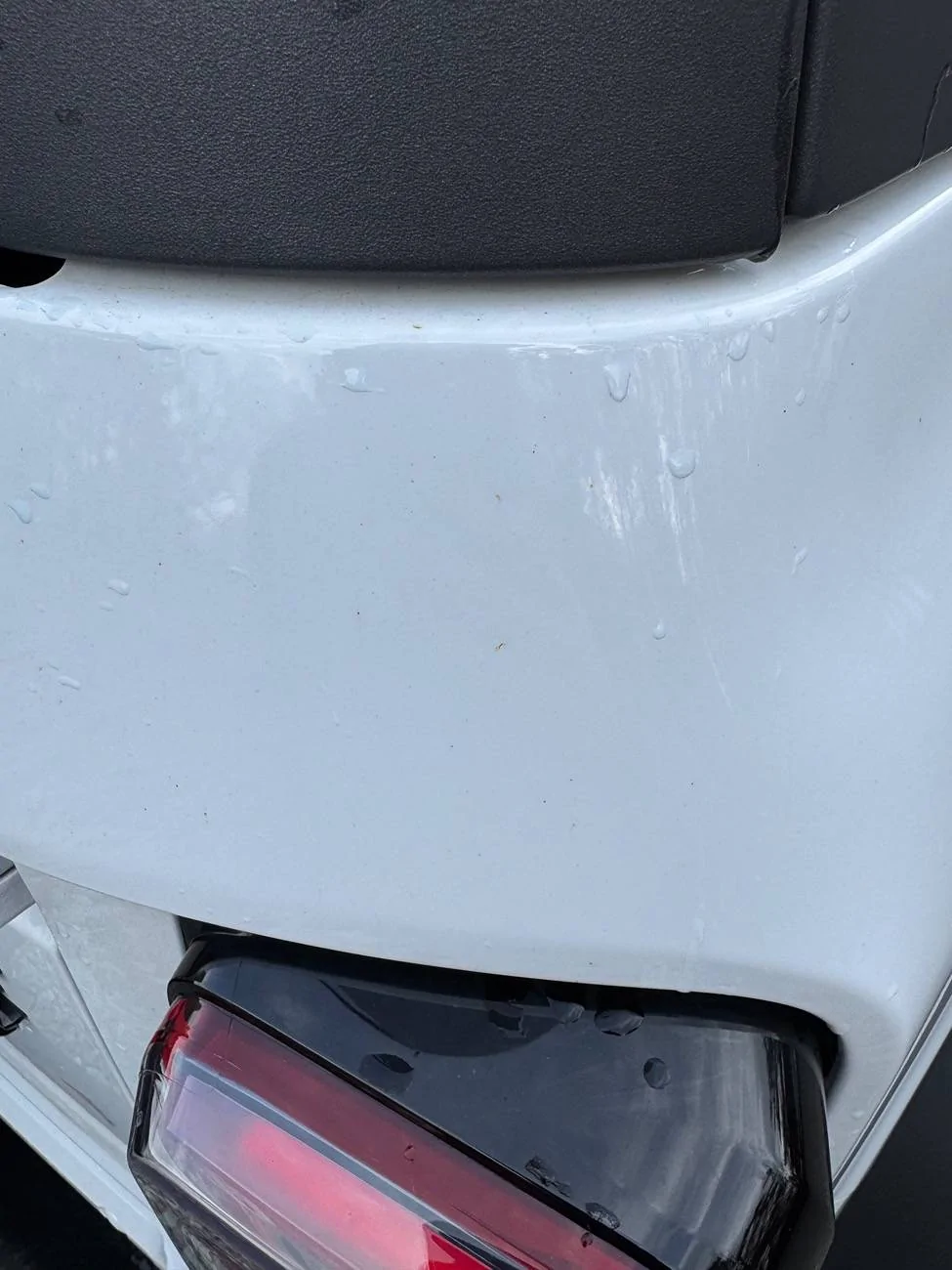

Hello I have a 23’ 4dr and noticed rust spots all over the vehicle. Hood, doors, behind fender flares, tailgate, above rear tail lights etc.
Anyone else have an issue like this? I ran it through a car wash and they’re still very prominent.

That's just industrial fallout from the roads. Very common in places that get snow in the winter where there are snow plows or other means of snow removal. Just apply some Iron X in the spring with a 2 bucket wash and they will go away.
