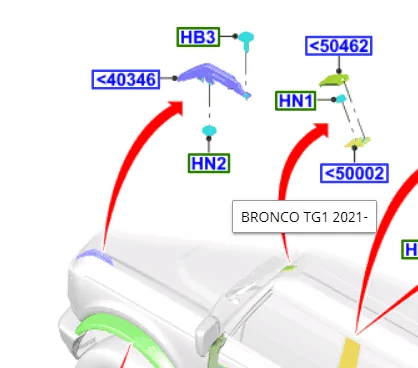

Are these the trail sights?
For the life of me I can't think of a "an exterior" grab handle on the Bronco.
Edit: Found the part in the parts catalog. It is the trail sights, they're listed as Handle Assist in the catalog. Very odd nomenclature for the part, but I guess they had to call it something internally.

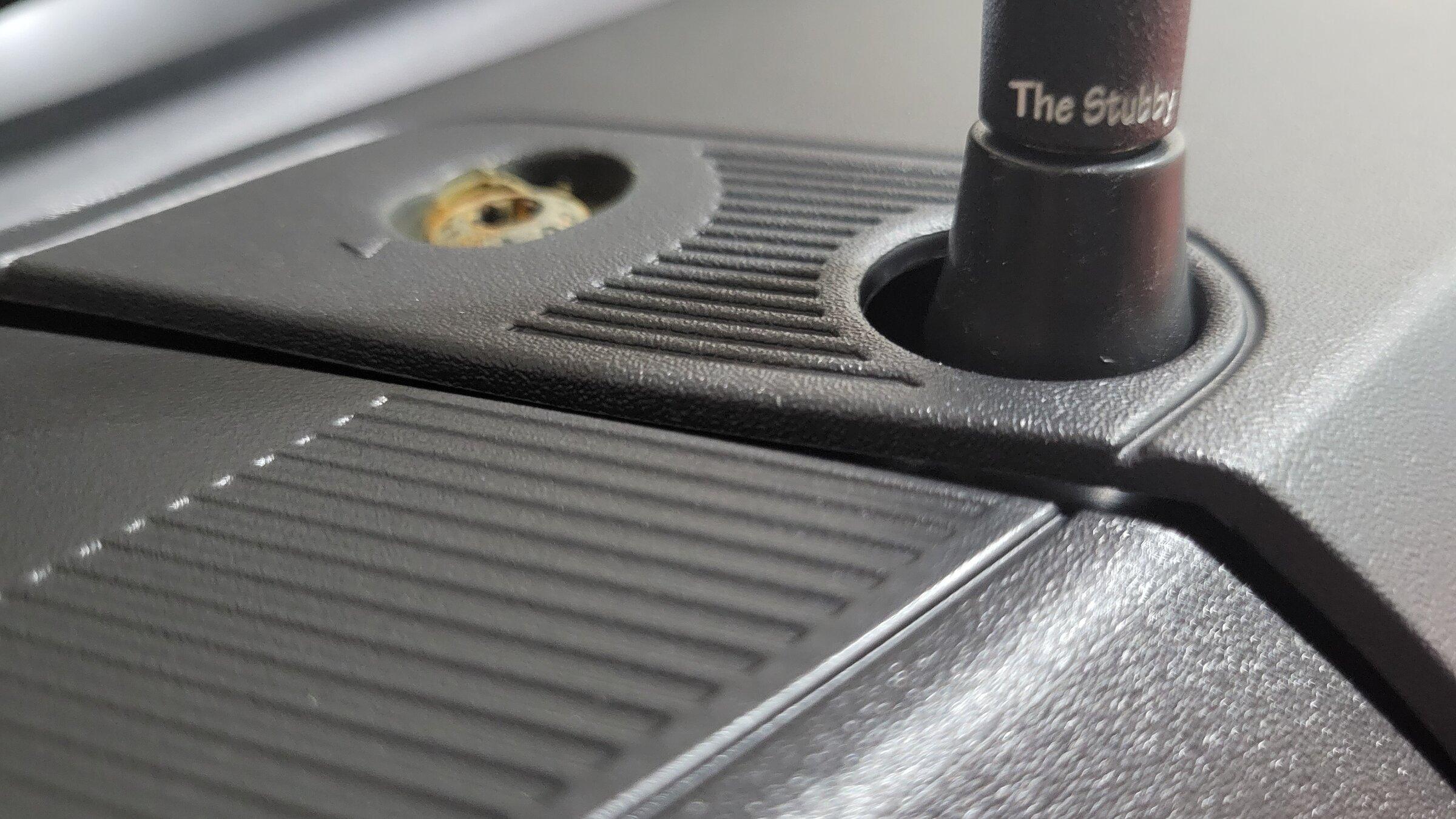

I found a rusty bolt too but on the cowl. Also see there is a gap here between the 2 cowl pieces. Just picked it up on Saturday and that particular dealer is 2 hours away.
