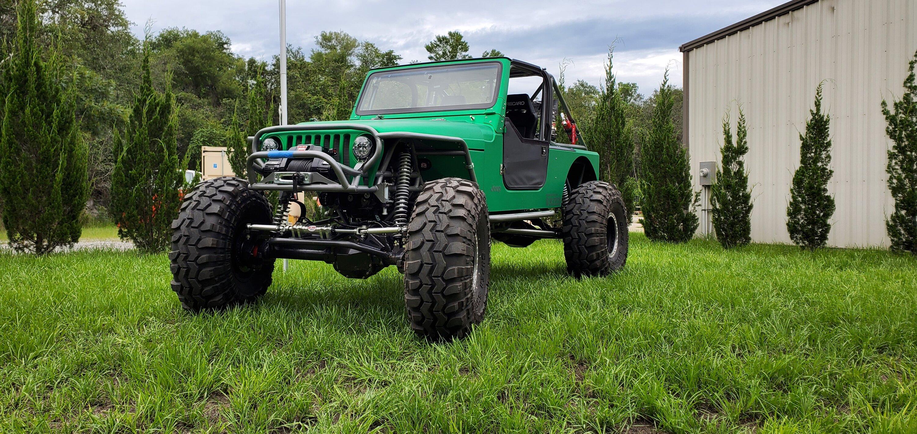

As an avid and long time wheeler, I depend heavily on low tire pressure. To put it into perspective...when I'm rockcrawling in my 5,500 pound buggy-with-a-body rig on 43" sticky tires with beadlock wheel's, I run the tires between 5 and 8 psi depending on the situation.
Ford Bronco Sand wheeling advice ROCKCANDY - FLAGPOLE - 09292021
The point of this is that the benefit of lowering tire pressures cannot be overstated. It increases traction an enormous amount, it is easier on the trail by reducing tire spin and allows for the softer tires to absorb bumps in the trail, reducing wear and tear on the rig, the driver and passengers. I will vehemently agree on the ARB deflator...I've had one for 15 years and love it.
I agree on 12 to 15 psi for non-beadlocked wheels with care taken to not do any hard cornering maneuvers so as not to push the tire off the wheel. Having a compressor or PowerTank on-board to bring the pressures back up for street use is wise.

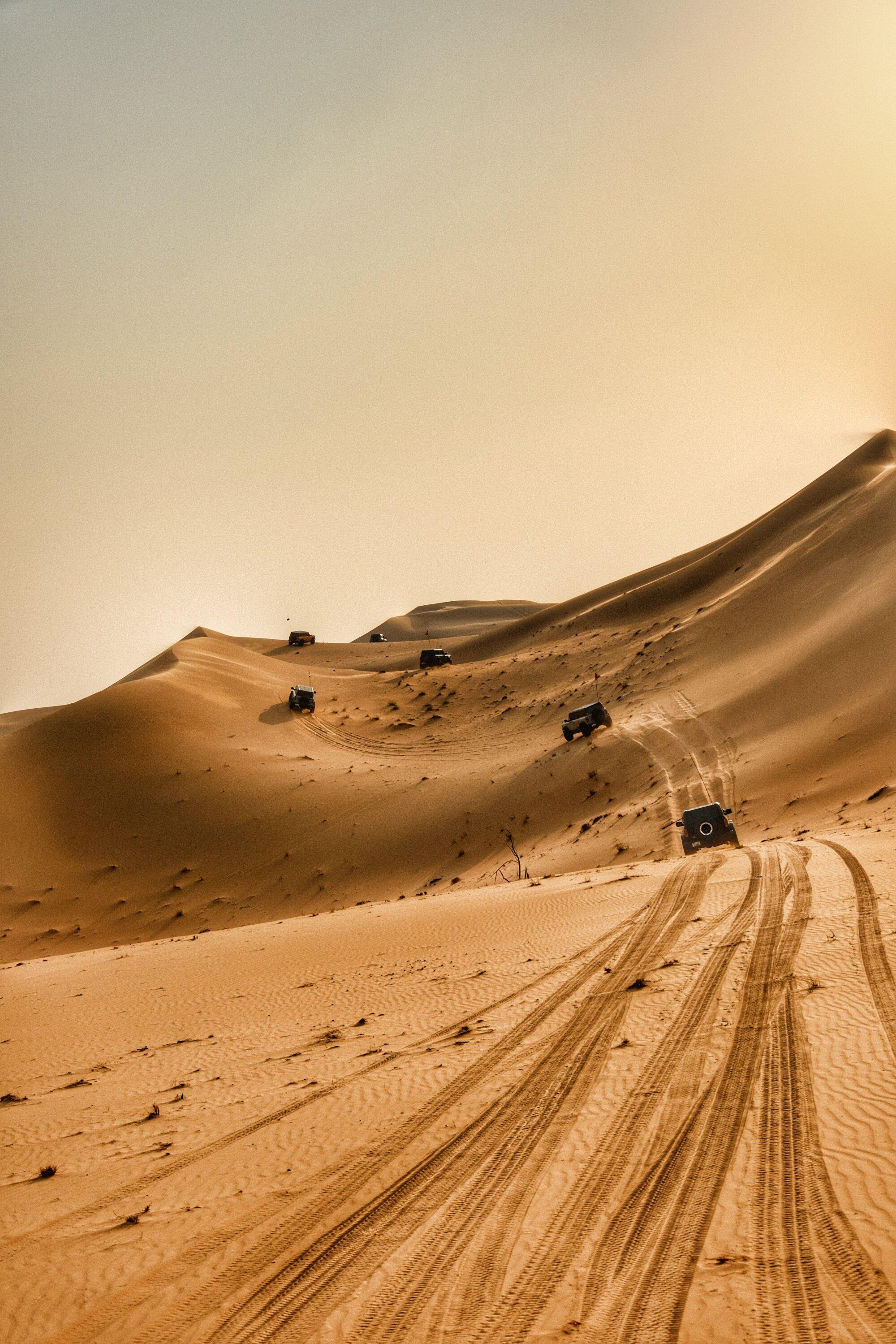

What everyone said above..
Low tire pressure (10psi)
Sand mode or Baja mode (4H mainly but 4L when you need more power), make sure to hold traction button and turn off ESC.
Rear lockers usually can remain off (Very situational or if you get stuck)
What we do out here for maximum effectiveness in deep sand is to just remove the ABS pump fuse (Fuse 29) and basically remove all interruptions to the power. This will disable GOAT modes so its best to put it in manual and keep it on the lower gears. Really really helps as you dont have any reduction in power and can power through all situations.
If you feel like you are getting stuck, use the steering wheel (keep turning left/right) to create space on the front. First instance getting stuck just stop, dont use too much power and try to either back out or move forward in whichever direction that gravity is pulling you towards.
Park at slant facing down so its easier to get moving..
If you air down to 10psi or lower with beadlock running the stock sas tire, its very hard to get stuck lol
Ford Bronco Sand wheeling advice WhatsApp Image 2023-10-15 at 5.08.36 PM

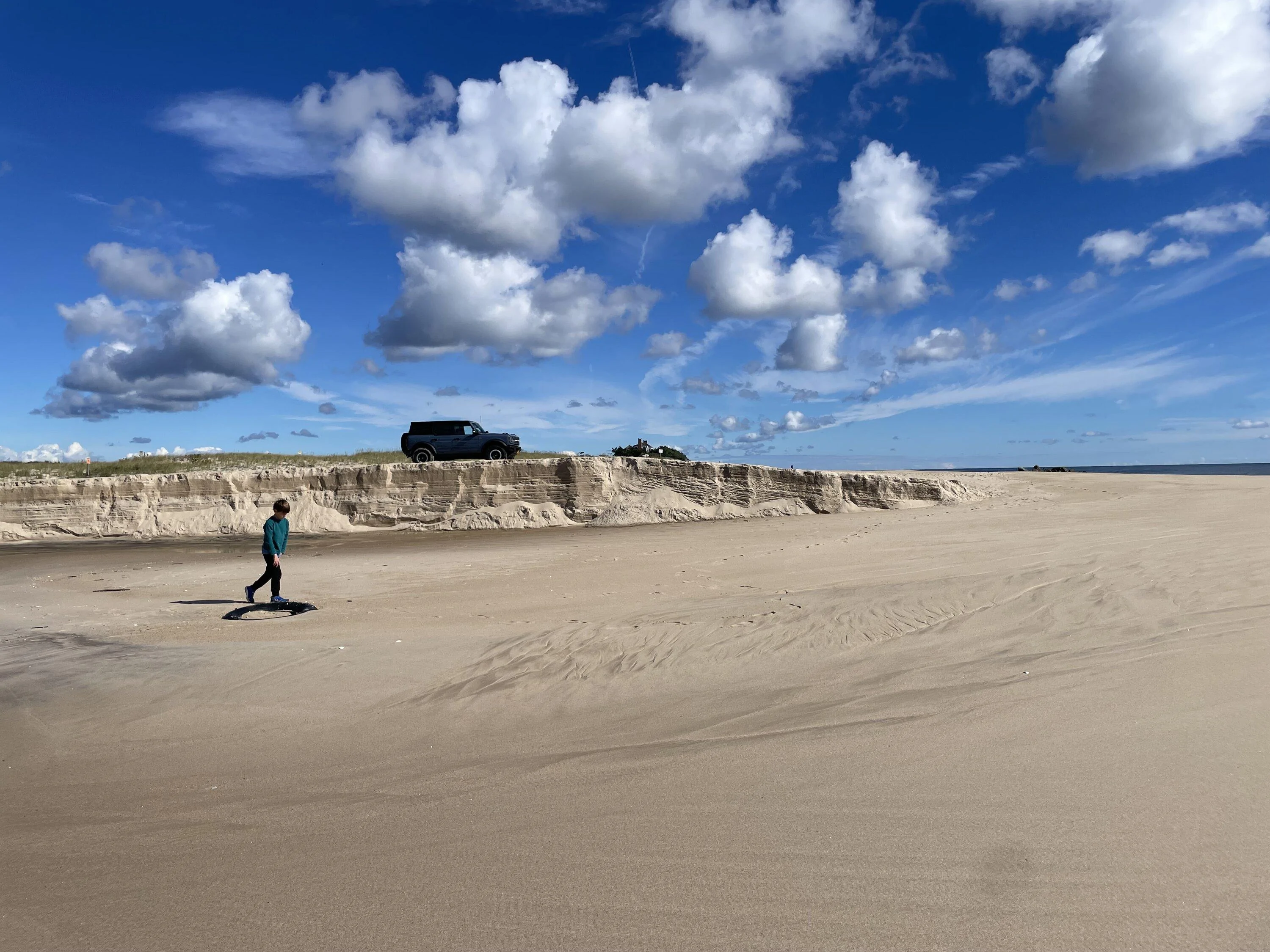

Thanks that makes sense I didn’t air down enough.
I drive my Bronco (Badlands Sasquatch) on the beach on the east end of Long Island almost daily. Prior to my Bronco I drove my jeeps almost daily on the beach for years. Not to toot my own horn but I'd say I have a lot of experience driving on beaches similar to the beach you are driving on.
All you need is Sand Mode and leave the rear diff locked. If your Bronco is not finding the right gear, just gas it for moment then let off and it will find the right gear. You do not need to air down unless, local laws or local customs dictate that you do. If you start to get stuck, stop and air down of course. It should be almost difficult or you have to do something really foolish to actually get your Bronco stuck on the beach in Sand Mode.
Driving on an east coast beach is far different than a some desert out west. In most circumstances an east coast beach is far easier for the driver and vehicle. The actual sand is completely different. Airing down to 10 - 15 PSI is ridiculous overkill for the beach.
Ford Bronco Sand wheeling advice IMG_0161
