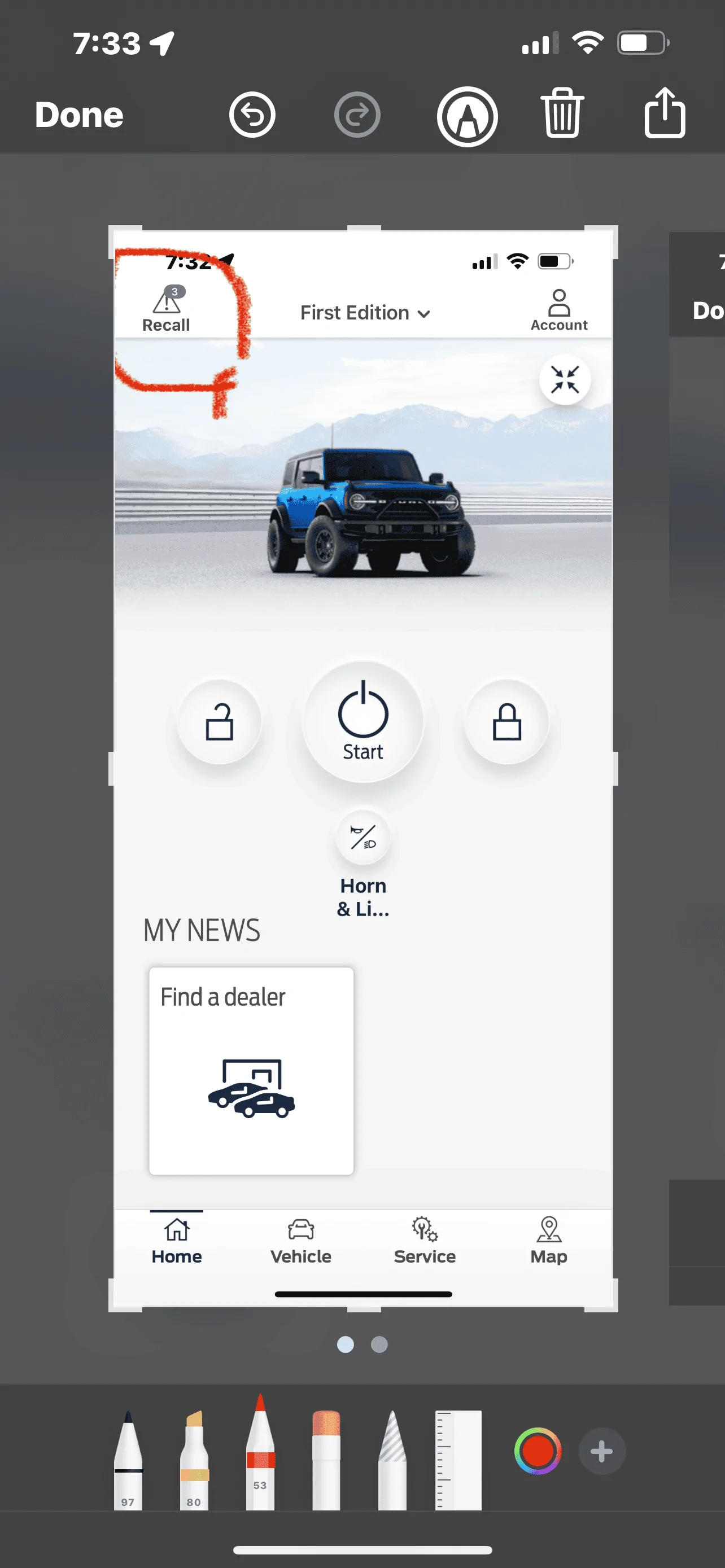

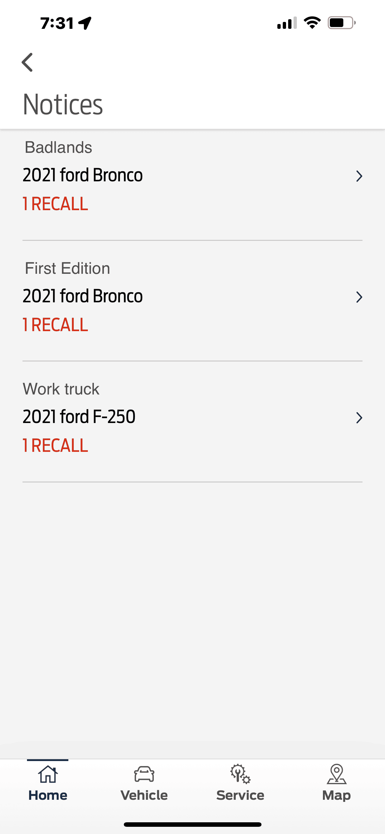

Should look look like this in your app- I think recall predated your delivery date. I am surprised the dealer didn't catch it. Have you added the VIN to your ford pass account?
Ford Bronco Scary situatuon child locks 6A524912-F645-4BDB-9E92-3600C8657063
Yeah all of my fords have recalls
Damn, never saw that tiny recall tab up there. Thanks
