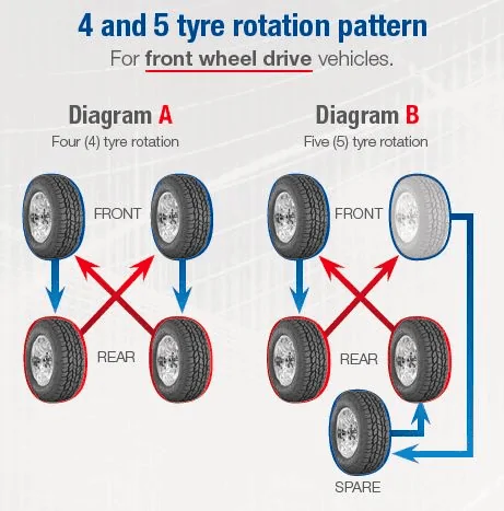

Two trains of thought here. Rotate with 4 and keep your spare fresh and pristine. Or rotate with all 5 wheels to get full usage out of all tires evenly over time. Either way is fine. But whichever way you choose, stick to the same rotation pattern each time.
FYI— That's the typical pattern for front-wheel drive vehicles. Rear-wheel drive vehicles (like the Bronco) don't utilize a cross.
  • Front Wheel Drive
    • Spare > P/R > D/F > D/R > P/F
  • Rear Wheel Drive
    • Spare > P/R > P/F > D/R > D/F
Does it really matter?? Not sure to be honest, I haven't done the research.
EDIT— I'm an idiot, if I had actually read the diagram I would have noticed it said "for front wheel drive vehicles". Here is diagram for a rear wheel drive vehicle:

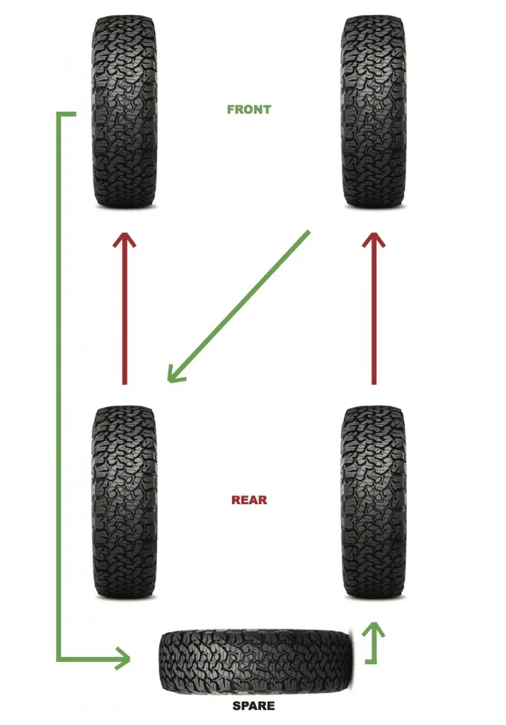

Roger123
Roger
1,254
2,924
VA Beach, VA
I'm in the 5 tire camp for many reasons stated above. But I'd use this diagram (G) for the sequence (Rear/ 4 wheel drive vehicles).
The spare has a tpms but you have to program them following the rotation. The unit is <$20 from Amazon and is easy to do.
