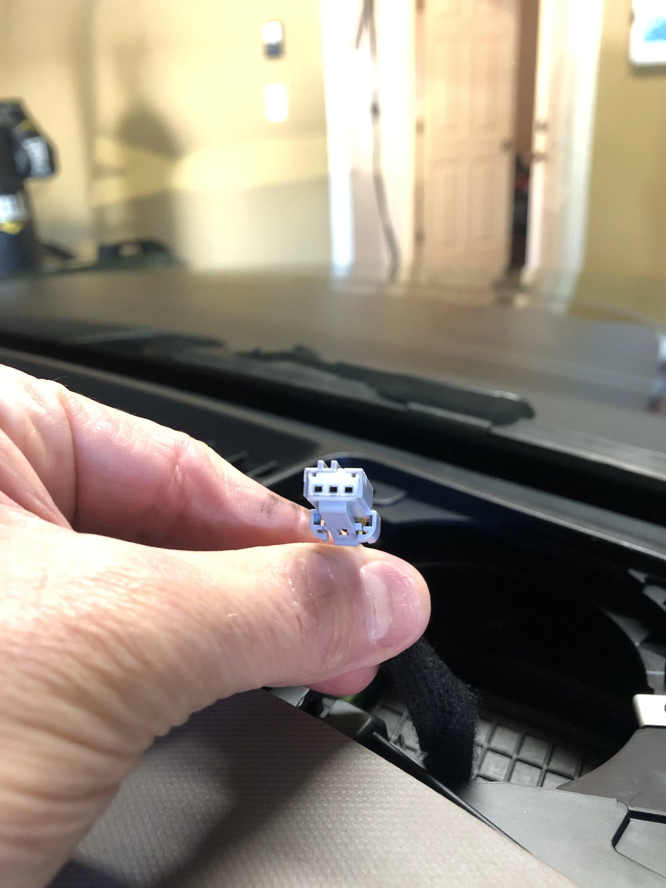

No. They're not.
Your stock wires will not just plug in to these. It either takes force or modification. This is NOT the same connector that's in the vehicle. Unless ford used two different types, every bronco I've seen in person does not have these connectors on them.

Yeah you're right. I knee jerk reacted as there were the 'other' ones floating around that everyone was swearing were a perfect fit (after you jam them in there real good).
The ones you pictured look right. The other ones didn't even have 3 pins.
