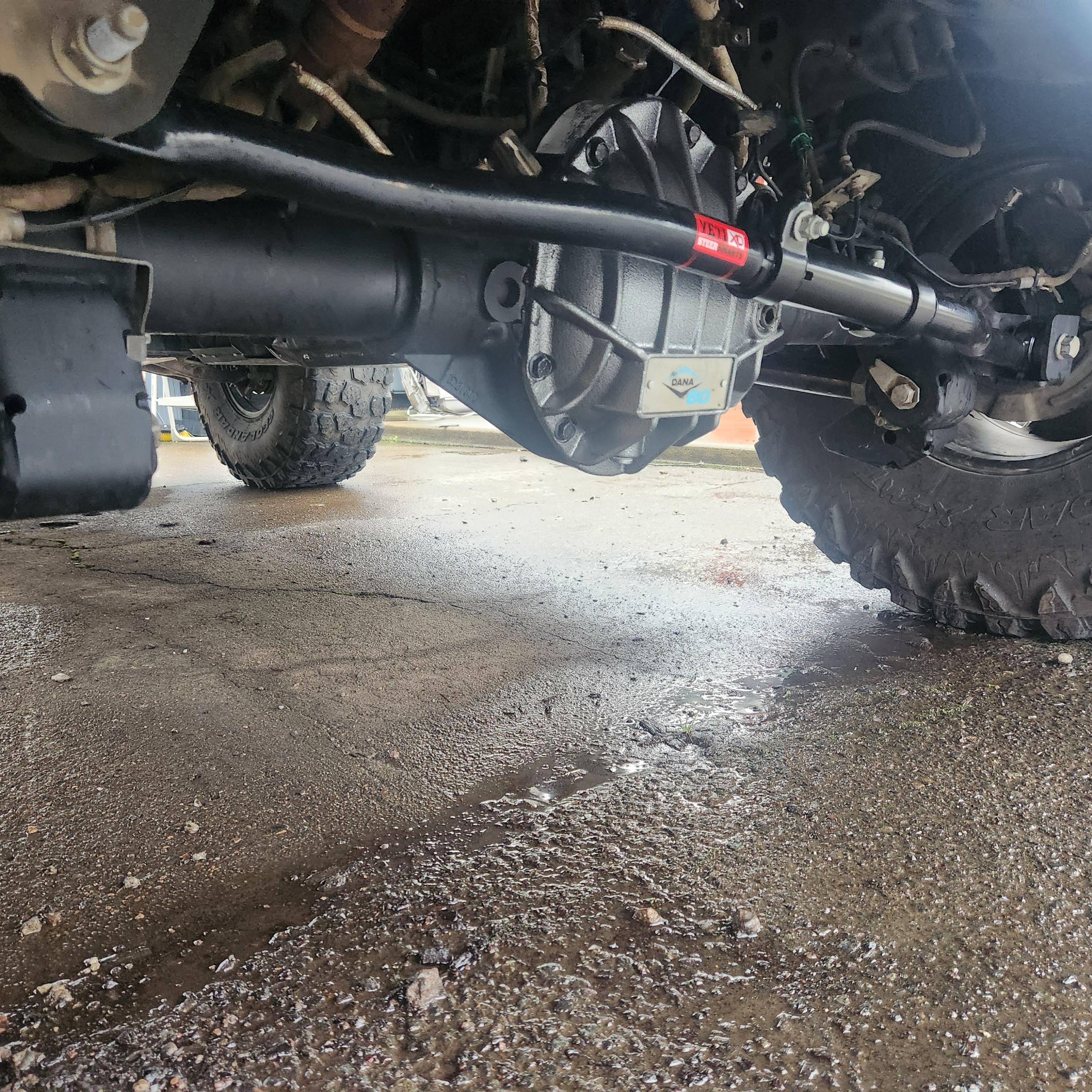

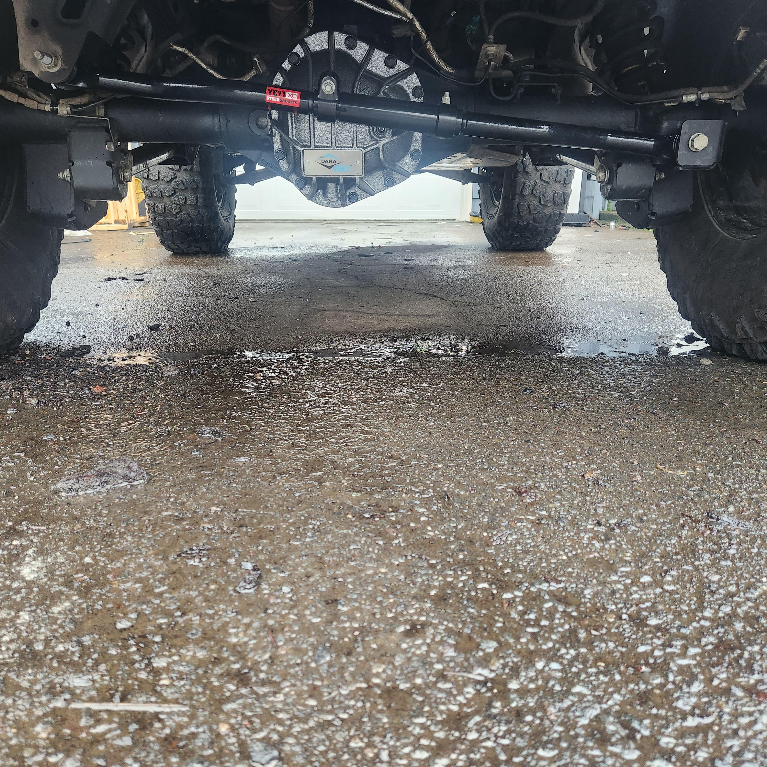

After damaging the M220 beyond repair I decided to upgrade to the Spicer Dana HD60 rear axle. these are now available in several widths. They are available for the Bronco in a 69." And also a 4" wider version the 73".
https://danaproparts.com/i-30498028...-38-gear-ratio-eaton-elocker-73-in-width.html
I did alot of research and chose this axle over a custom built 9" axle for several reasons. The price is very similar for a custom 9" complete axle, but The Spicer is far more "plug and play" and was purpose built for our broncos.
The axle is VERY heavy-duty and has worthwhile improvements over a standard d60.
The installation went super easy and Spicer even included a Extreem duty track bar as well.

Nice. Digging the boxed lower TA and shock mounts.

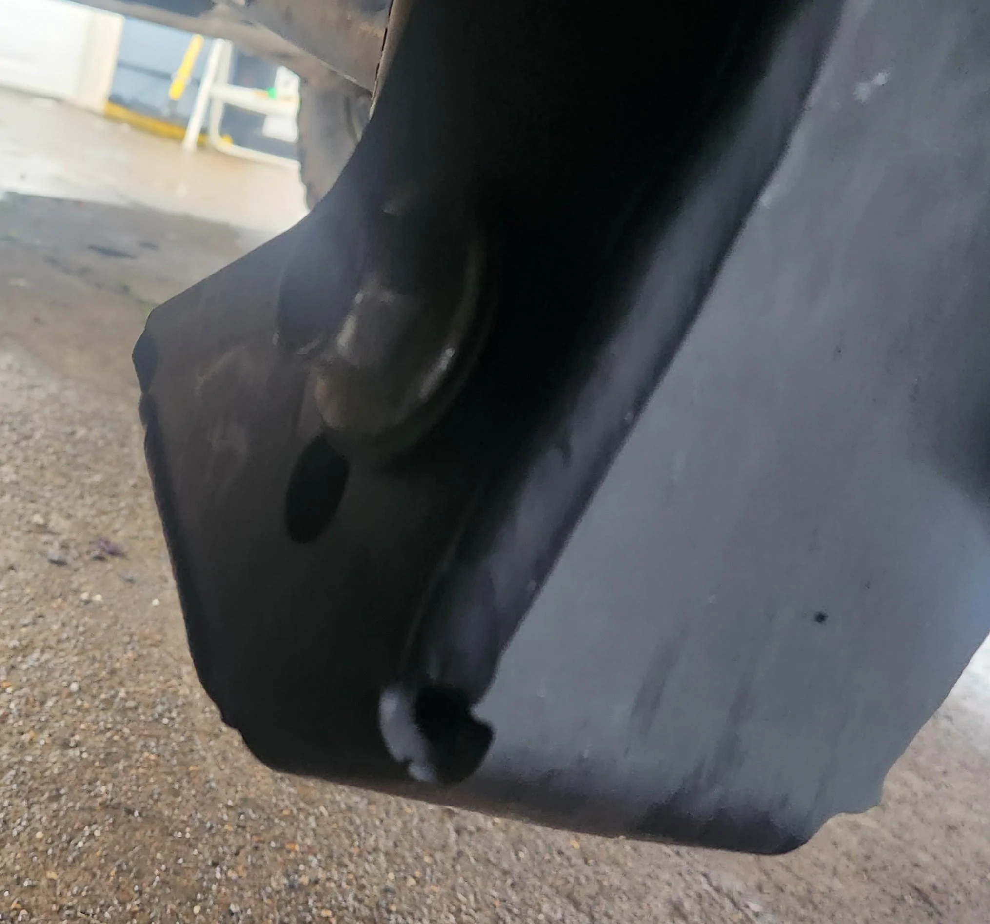

I did my signature BMB lift as well....re drilled the shock mounts higher.
I chose 1.5" lift this time (instead of 2") , and will adjust front ride height to match.
I'll cut and reweld the lower portion of the boxed bracket for a 2" increase in ground clearance, next.
Ford Bronco Spicer Ultimate Dana 60 axle +4" wide installed leonardo-dicaprio-clappin
Maybe they will see this, and adapt. A simple fix to anyone likely looking at this axle.

yeah all the brackets are twice as thick.
