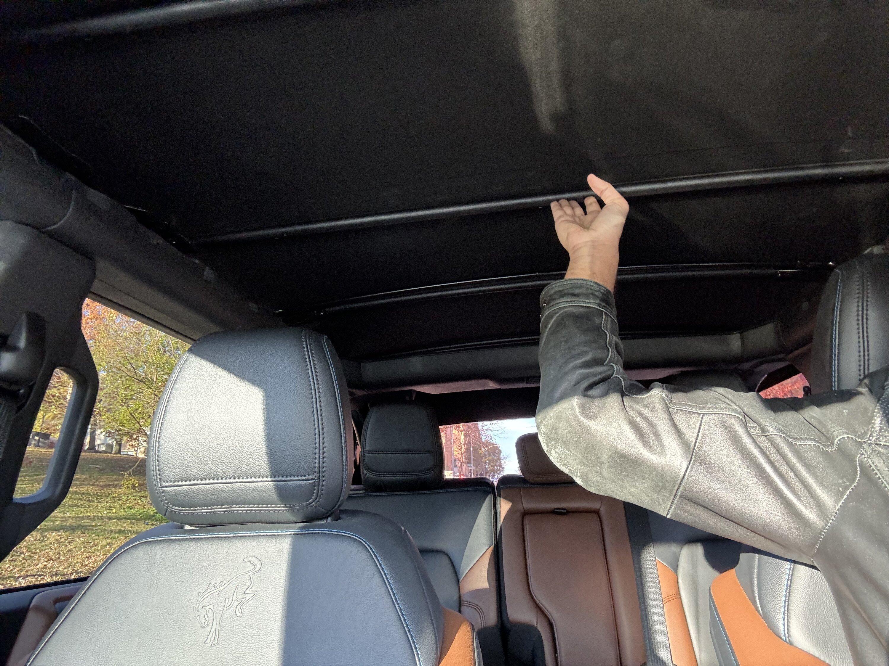

Funny thing is, if I just put my finger on the middle bracket and either put minimal pressure up or down. It stops immediately. As seen in this pic.
