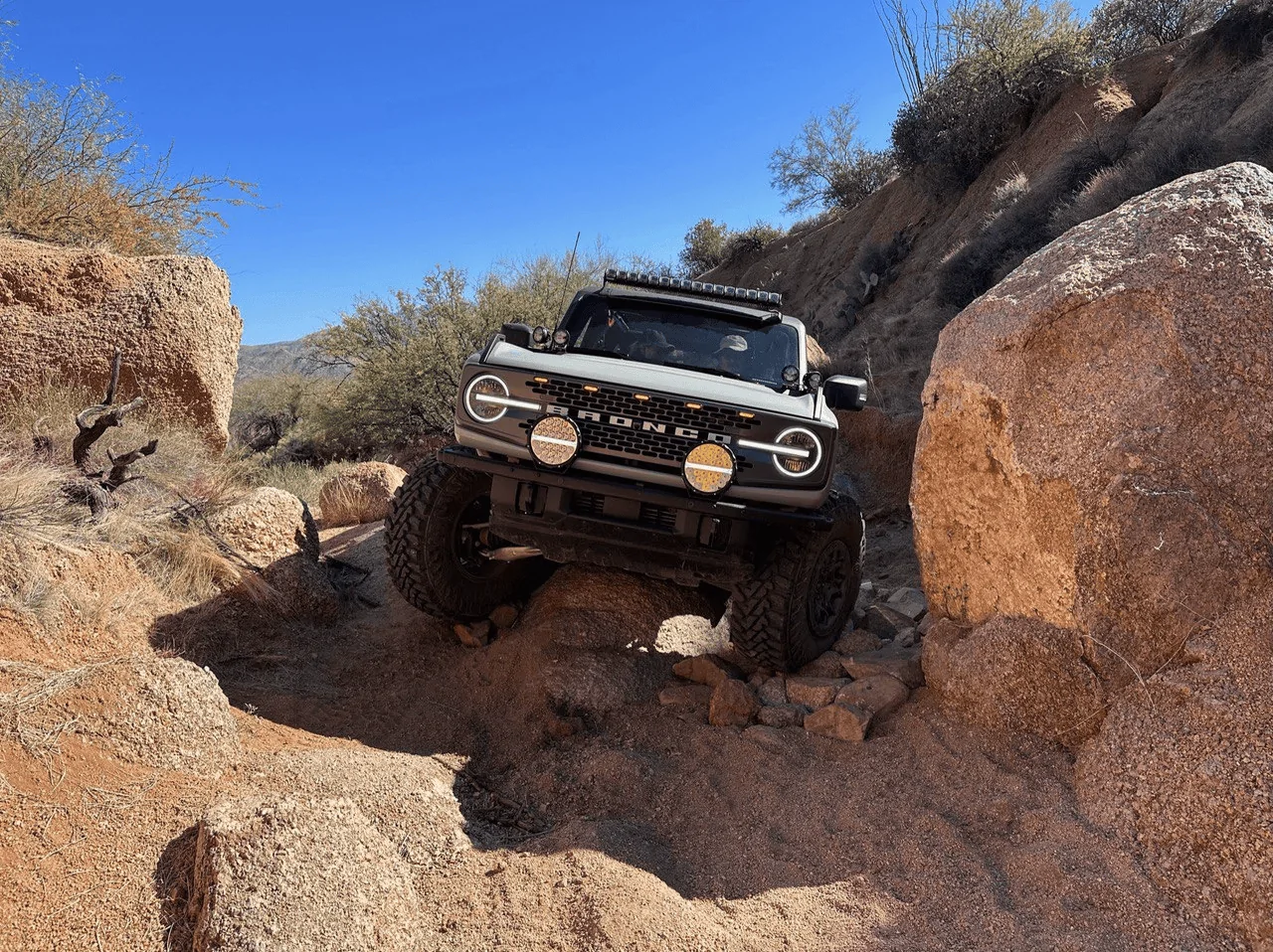

Hi guys!
So, I was running a 9 rated trail yesterday and had a very curious issue that I have not experienced prior with any vehicle and I'm not quite sure where to even go for help. This issue hasn't popped up on rutted roads or in washes etc. Only when I start crawling on rocks does the steering become unresponsive. Yesterday was the worst.
My steering would get so tight as to not be able to move the wheels at all without forward motion - even the tire in contact with the ground was on a somewhat slippery surface. As you can see from the photos below, the surface is very loose/sandy and even the rocks are crumbly. I would not expect very much steering resistance, even on 37s.
No grinding noises, no slipping feel.. nothing. Just an incredibly tight steering wheel. It almost feels like you would expect if you were trying to turn your wheel with some type of object in the way, stopping the wheel from turning. Once I'm back on flat ground, the steering feels just like the day I got it.
My only guess is I'm binding up the steering rack some how, but the only issue I was aware of with the Bronco steering is when the rack/pinion separate and teeth get damaged. Nothing like that has happened, and my steering wheel is still dead center (I would expect it to be crooked if the rack/pinion slipped.
Could it be the camber? I know camber plays a roll in steering. I do believe my camber may be a little positive right now..
My relevant rig setup is as follows:
2021 Badlands Sasquatch w/2.7
37x17x12.5 Yokohama Geolandar MT 003
Factory wheels with 1.5" spacers to clear UCA's
Icon Dynamics Adjustable Coil Overs
Icon Dynamics Billet UCA
.75" bump stop spacers installed front and back to limit rubbing with 37s
JKS Max Clearance Kit
JKS Tie Rod Braces
Lots more mods, but I think those are the only that matter for this conversation. Steering is still factory other than tie-rod braces being installed. Photo 3 shows the problem the best - you can see both front tires are on pretty slippery surfaces (the entire obstacle challenge is to get through without slipping and smashing your entire vehicle body into that car sized boulder)
So... any ideas? Anyone else have this issue?

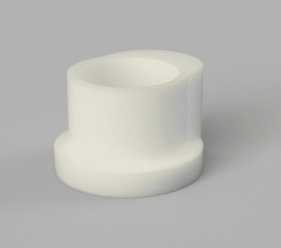

I want to put to bed forever the idea that charging $400 for a plastic part is anything other than highway robbery. This is going to upset a lot of people, but reality is what it is.
Ford Bronco Steering impossible while off-camber 1669935234460

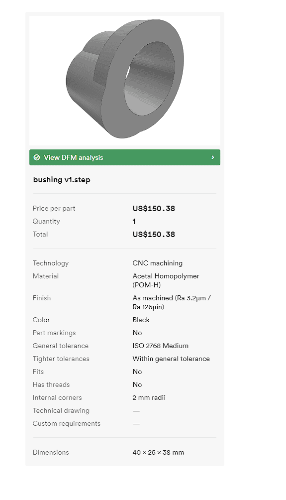

I'm not gonna pinch his design, but I just used some quick measurements to make an example bushing that would function identically to the BroncBuster bushing. I'm keeping it slightly vague in order not to get in trouble with the guy. It needs a snap ring and an o ring channel, but this is just a rough sketch for this next part..
Ford Bronco Steering impossible while off-camber 1669937157563

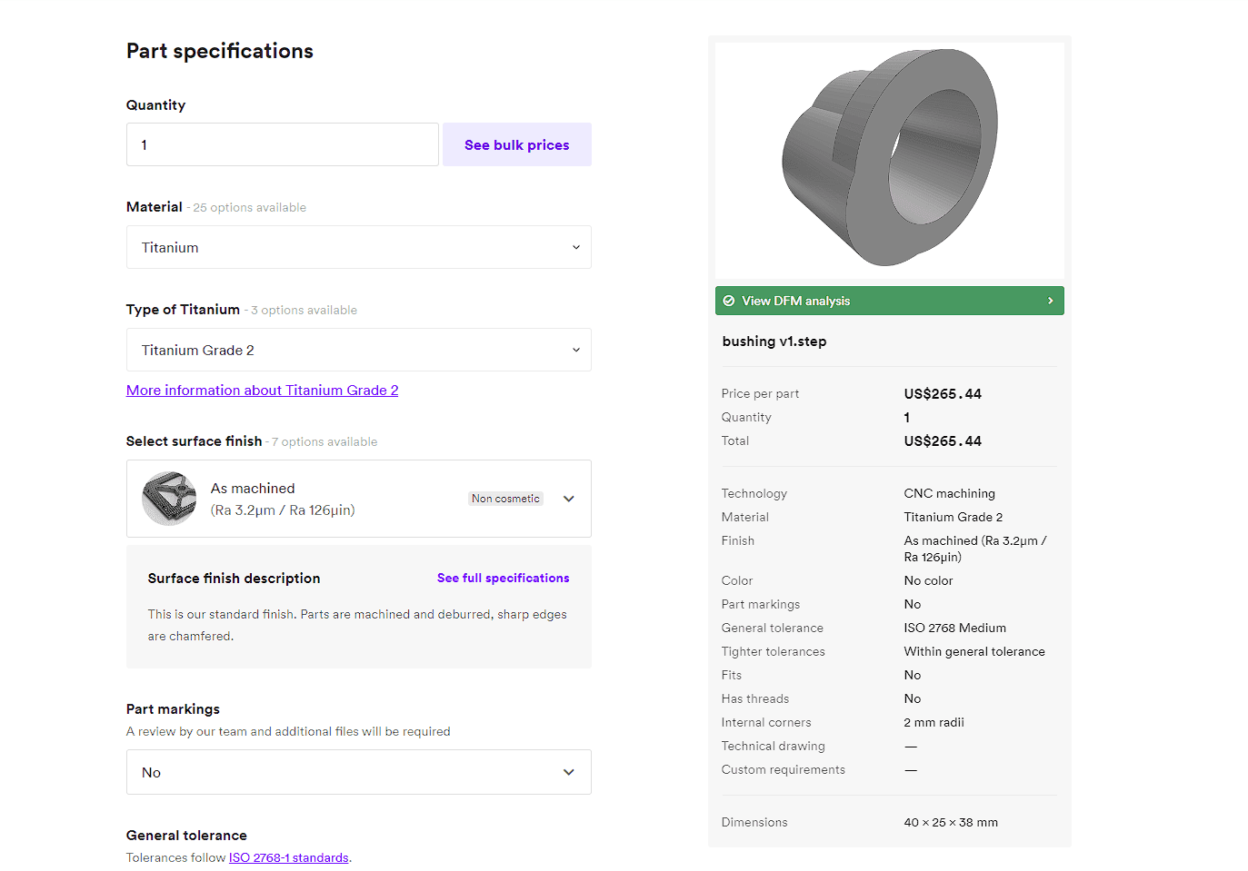

I can order an actual bushing made out of literal titanium as a one off for over $100 cheaper than the BroncBuster Delrin part, which is less than $1.50 a pop if I order more than 100 at a time.
Ford Bronco Steering impossible while off-camber 1669937233572
What you are paying for are his vacations, engineering time (this is a copied Ford part that is a bit thicker than OEM, nothing more), and marketing.
I'm not knocking the guy, but I wish people would stop trying to justify the cost. This is a free market, and he can charge every single penny he feels he deserves.. That doesn't mean it's reasonable or that I'm paying the markup.
Keep in mind that I'm being penalized with those prices for only quoting one part. The Titanium parts drop down to well below $200/each with just an order of 5..
Titanium isn't an ideal material for this, but is one of the most expensive to machine.
The billet passenger side housing he sells is a bit more reasonably priced, but I can promise you he isn't going hungry by selling them at $1200/each.
Correct, and nre (Non recurring engineering) matters. I do not have the time or willingness to do this myself and test it, let alone market it. $400 is cheaper than tie rods and imo this serves a much better purpose than beefier tie rods.
Knowing how to do what you indicated does not mean it's not worth what he is charging, most people have neither the brain power or time.
