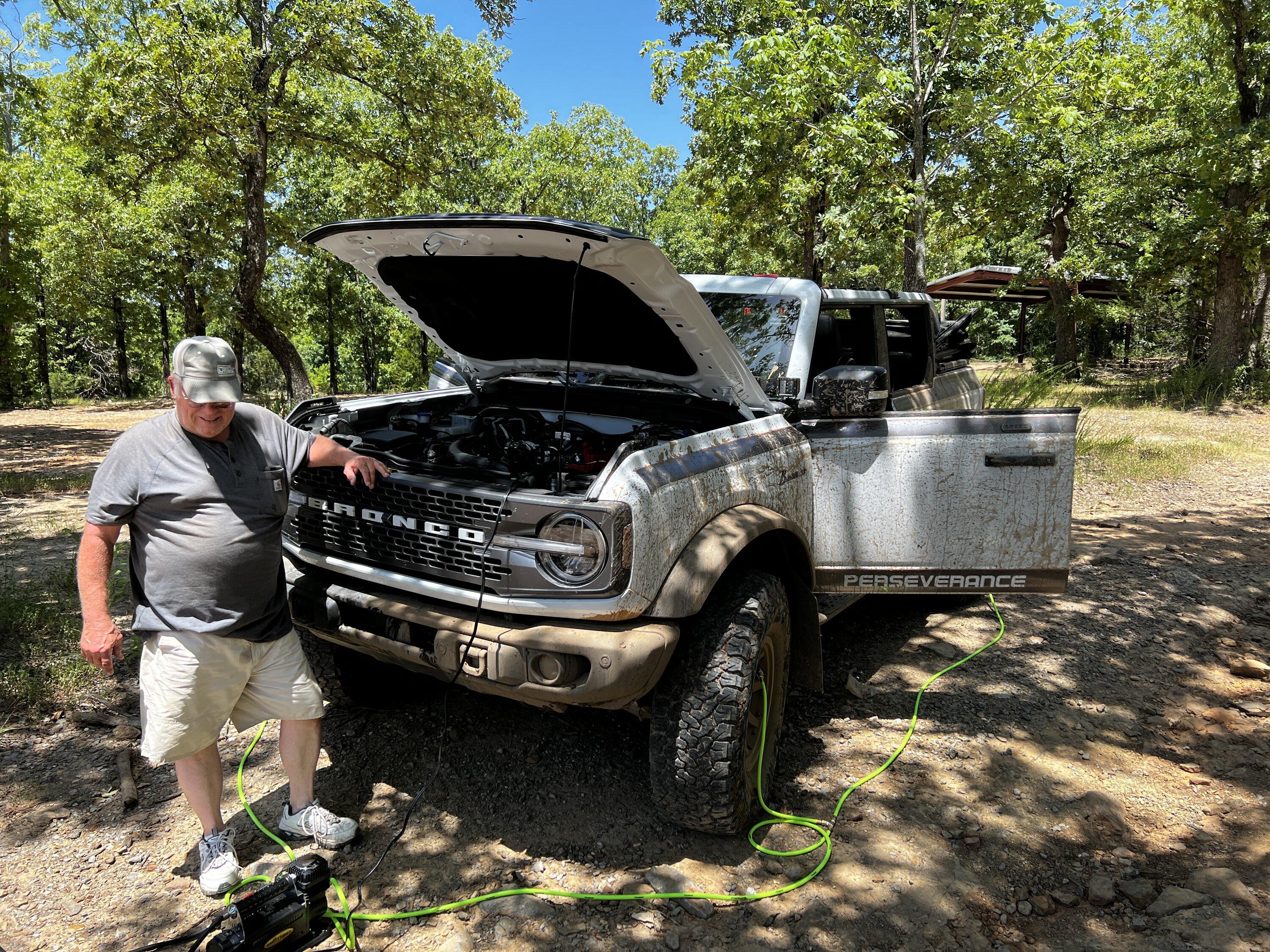

While wheeling at Gruber ORV Park today with my Dad, I encountered a new steering issue that I thought was going to leave me stranded more than once. I should preface this with the fact that we put the Bronco through its paces big time on this trip before it started. Lots of rock crawling, climbing ledges, dropping off big ledges, and mud holes that definitely made us pause.
We were on a trail I had never been down and came to a felled tree that caused us to have to turn around. After making a 672 point turn in the trees to get turned around I was trying to squeeze back between two trees that were rubbing my rock rails on both sides when the steering completely locked up at a full left lock. Not ideal timing. We thought were going to have to walk back out but I gave it enough time and eventually it started working with me hauling on the steering wheel as hard as I could. We worked back out of the trees, gave it about five more minutes and the steering came back.
Before everyone starts presuming it’s because of the lift and angle of the tie rods, this was at normal angle on relatively flat ground. There was no more upward pressure on the rack than when driving down the highway. I also can’t figure out why letting it cool off made it work again.
At that point we were able to get going again and it worked fine for another 10 minutes until
We came back to the mud holes. When trying to figure out how to get through (trees everywhere and very few angles we could fit through) it happened again after the first set of mud holes. I let it cool off again for a few minutes and it went back to working.
That’s when we made a huge mistake. The first time we came through these mud holes, I told my Dad I didn’t want to go through the straight route because there was a really big mud hole and I didn’t know what was in it. This time he told me why not try it because it cant be worse than the turning ruts full of mud and water that we went through the first time. Like an idiot, I said “why not”. We dove off into it and when we got to the middle, the passenger side sunk. Water was up to my Dad’s window (sitting in the passenger seat). He said “Well I was wrong”. I tried to gun it out, no go. I through it in reverse, made it about four feet and no go. Through it forward and made it a little further, then no go. I threw it in reverse again and realized I didn’t have my front locker in. Punched the button and it launched us out backwards.
My Dad kept saying “I can’t believe we made it out of that” and shaking his head. We took my path on out and when climbing ledges back up the original path,the steering locked up again. I disengaged the trail control (one pedal) in case it was brake related. It was better but still not right. I let it cool off again and it eventually went right back to working. Made it the rest of the way out and all the way back home without another incident.
Cooling off doesn’t really make sense on a rack and pinion unless it’s electronic related. There is no oil in that system that I’m aware of that could have gotten hot. I am in no way an expert on rack and pinion steering. I’m hoping someone on here has some ideas about where to start looking. It’s a little scary when this happens on the trail (but not as scary as sinking your bronco).
On a side note, this machine is an absolute beast. It will climb a wall with both lockers engaged. I still can’t believe we got out of that mud hole / pond. I have no idea how I’ll ever get it clean again.
Ford Bronco New Steering Problems while on Epic Adventure 762704AA-9A09-4F39-9172-99E084BCA74D
Ford Bronco New Steering Problems while on Epic Adventure 0A3BD248-6A50-44B6-8CD8-B9DB99245D97
Edit: Confirmed this is an overheating issue with the steering assist motor where the system puts it into either limp mode or manual steering mode due to the motor over heating. Not confirmed yet what the cause of the overheating is though there are many possibilities discussed in the thread. I’ll post again when I get a chance to confirm causes.
