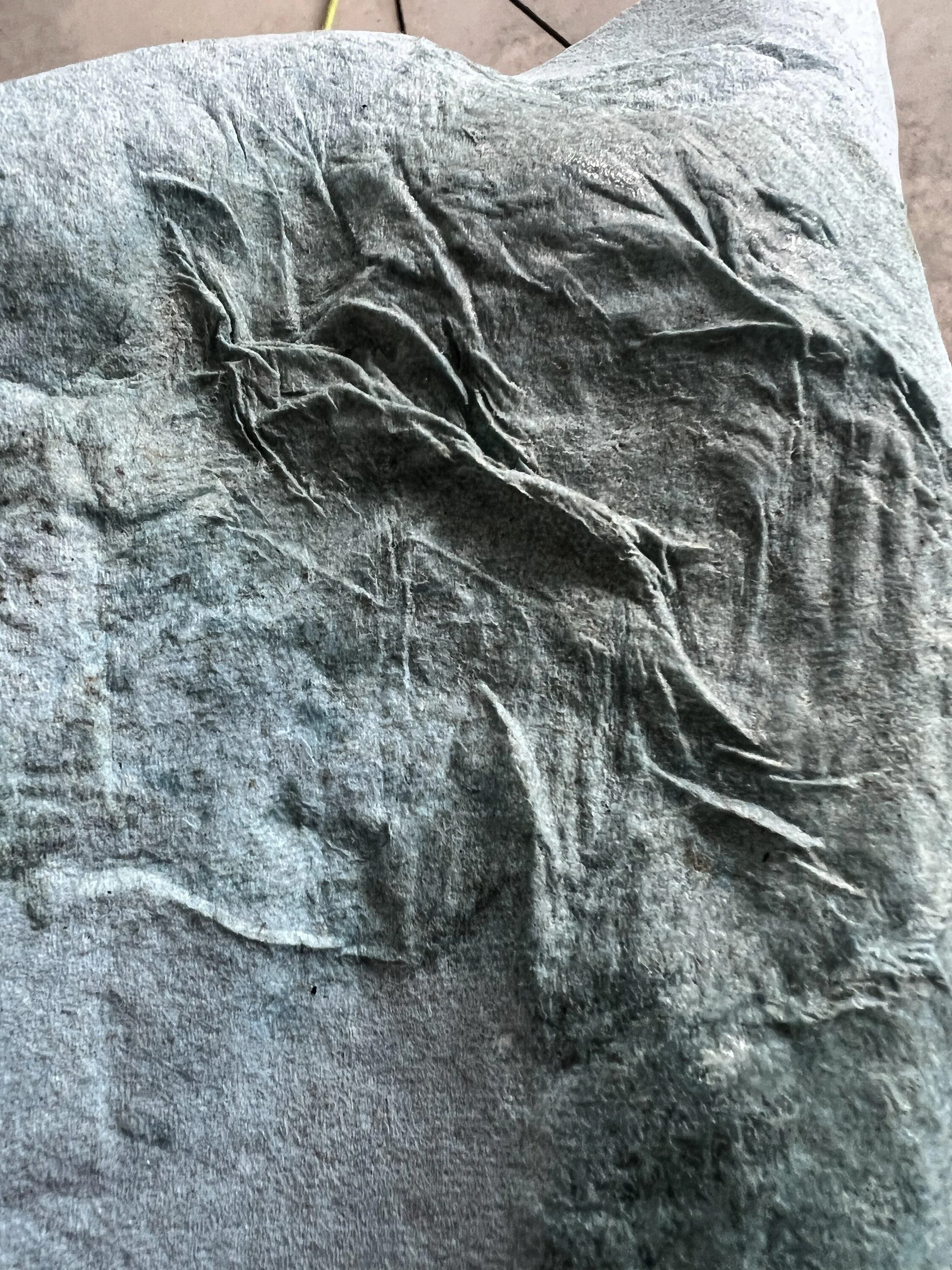

the tiny bits of black are metal shavings from the aluminum housing. was hardly anything but I never hammer on it off road with it being a first year vehicle and all. I’d rather not be the Guinea pig if I have other proven rigs.

If it really is this, the people in here saying it’s your bushing and braces would be partially correct. They’re causing it in that they’re enabling your steering rack to push itself that hard without breaking the slack adjuster on the driver side first, or bending a tie rod. That’s the problem when you upgrade things in general. You’ll find the other failure point somewhere else if you’re hard on your stuff.
good news is he made a part to prevent this. Bad news is it’s pretty pricey and won’t do much for a heavily damaged steering rack because you’ve already had those metal shavings grind through your rack. A little bit is okay but there’s a point to where the rack becomes infeasibly repairable.
