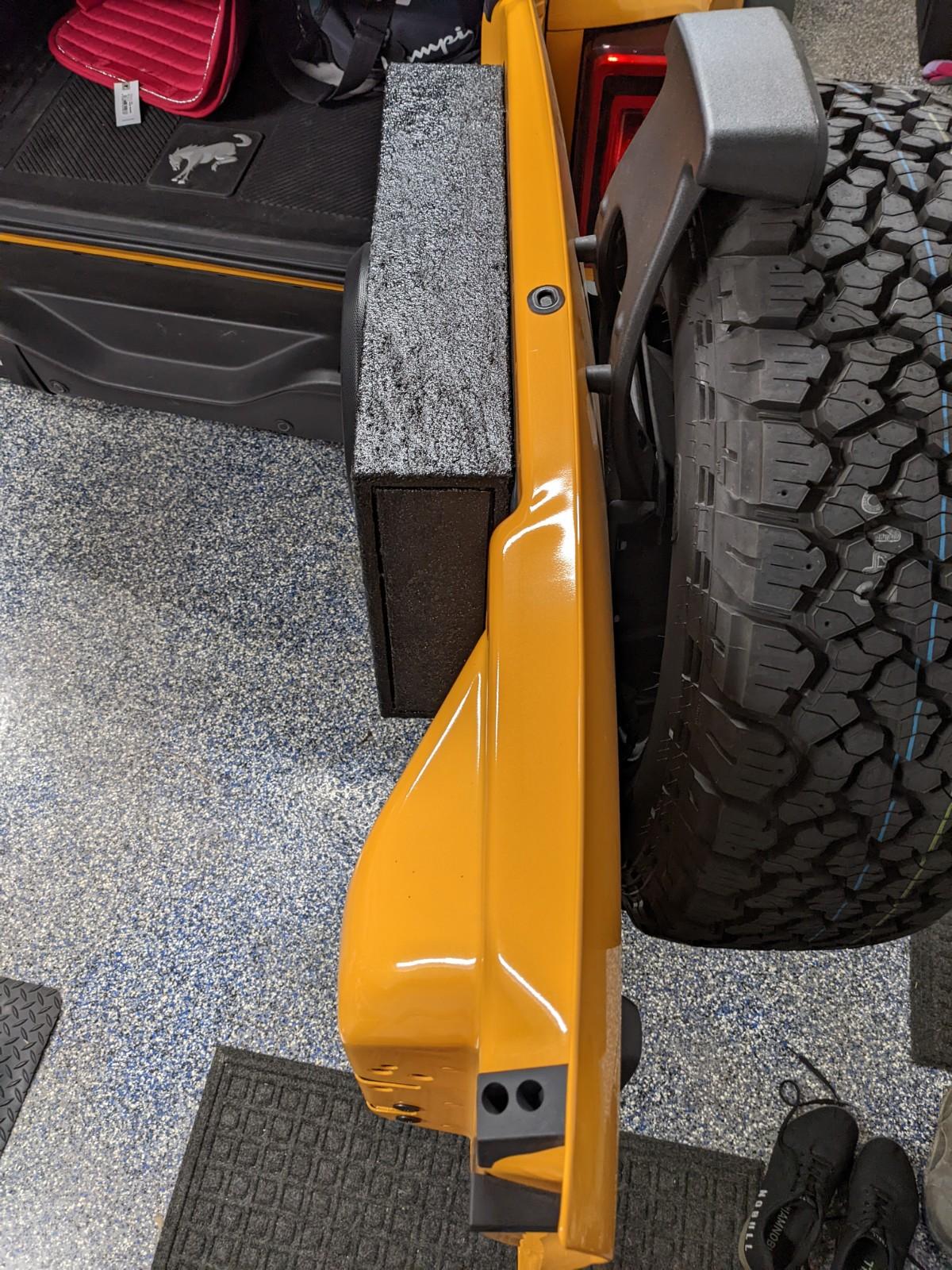

I put a piece of rubber sheeting between my box and the tailgate. This way there won't be any adhesive on the paint, and the box isn't touching the paint. Besides the plastic cover sticks out further than the painted panel below, so this helps to square up the box.

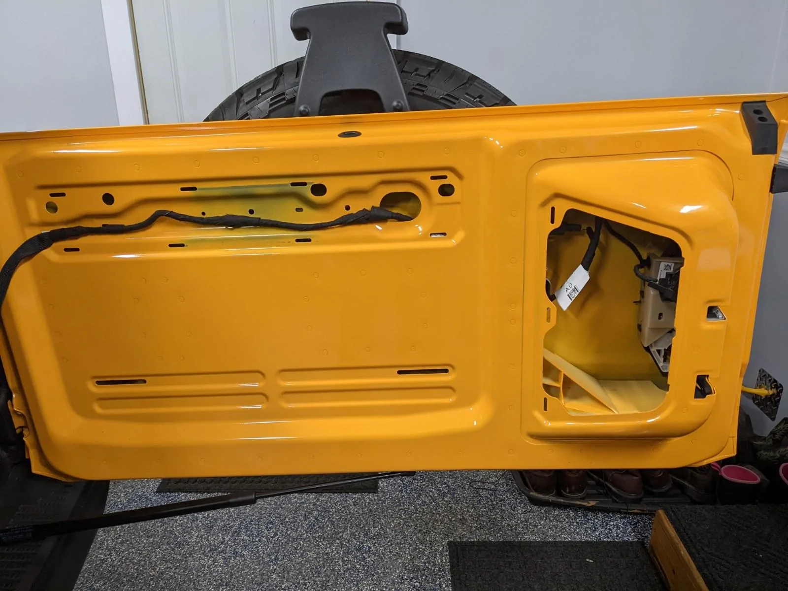

Most of the inside of the tailgate is full of bracing and honestly I could not see anywhere flat enough to put dynamat. Perhaps with a spray? The only rattle I get is immediately around the handle, and only with certain songs/frequencies. So eventually I may put a bit in that area.

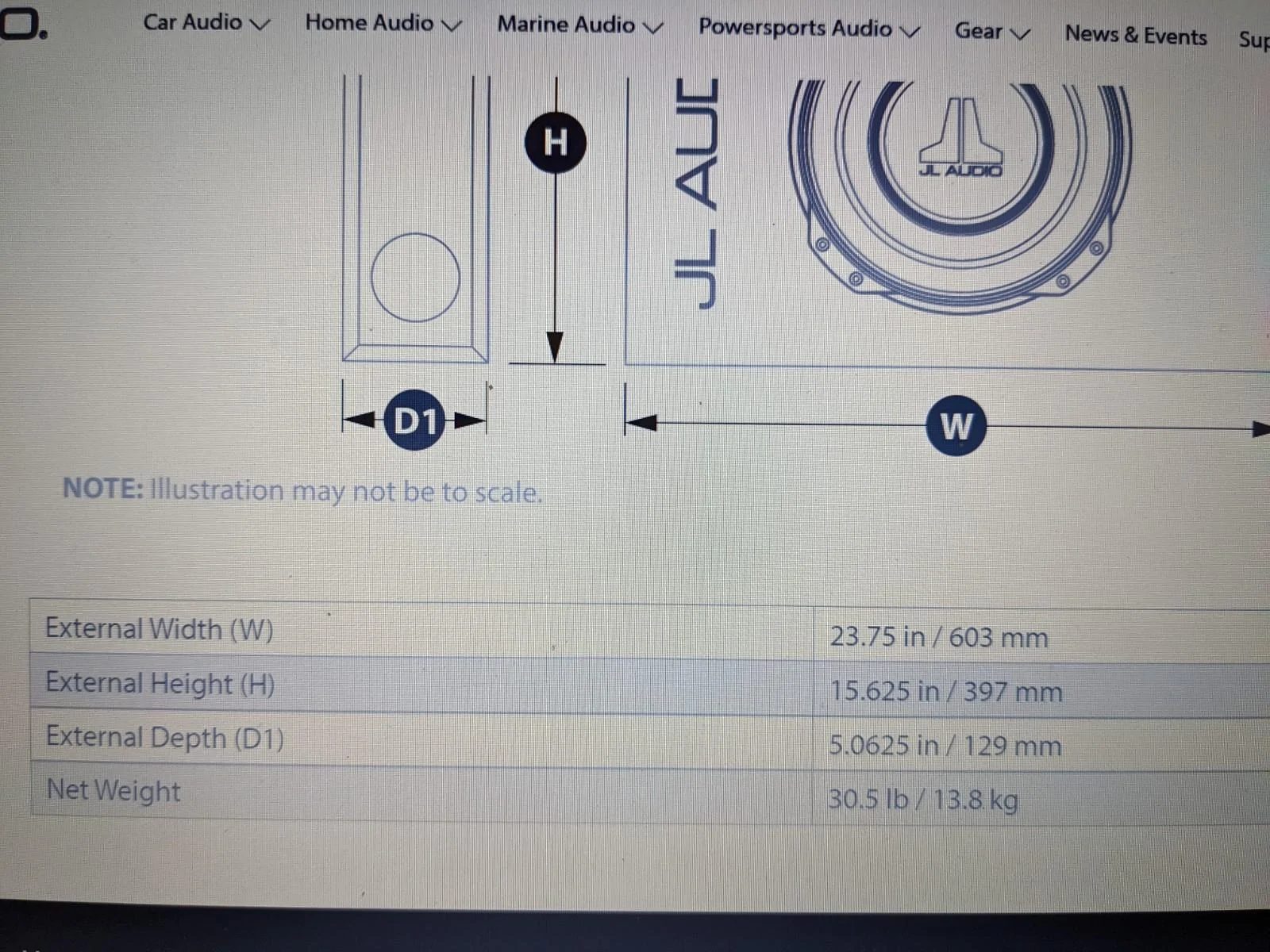

I feel the weight of the spare tire, coupled with the weight of the sub and box (30 lbs for mine) gives the tailgate so much mass that it doesn't rattle or vibrate.

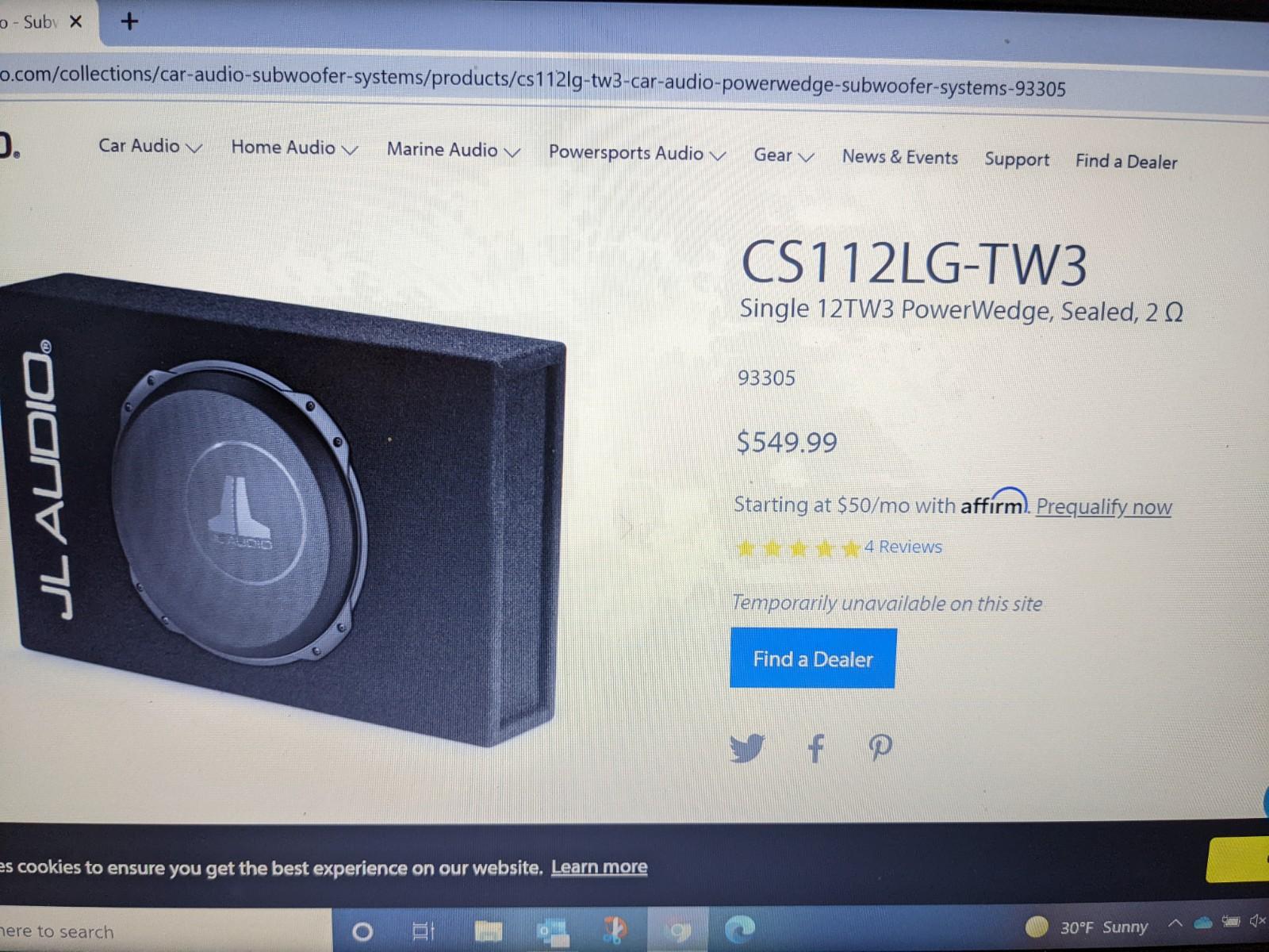

Which box is that? JL for the win!

Interesting to see that the same spot on my CO is also not painted well! WTF!?
Also, that empty space under the door latch bump out is the perfect spot for a custom sub. Years ago I had a powered sub in an empty, unusable space over the rear passenger tire in the back of an Explorer.

It could be that unpainted area is where the door is held as it goes through the paint line. Actually it could be where the fuel lid is held during painting? I will have to look at the paint jigs for that, we make all of that assembly where I work.
The handle area of the tailgate is the one area that isn't braced well and vibrates. So I would think a box there, would not only be pretty small, but would need to be dynamated really well.
