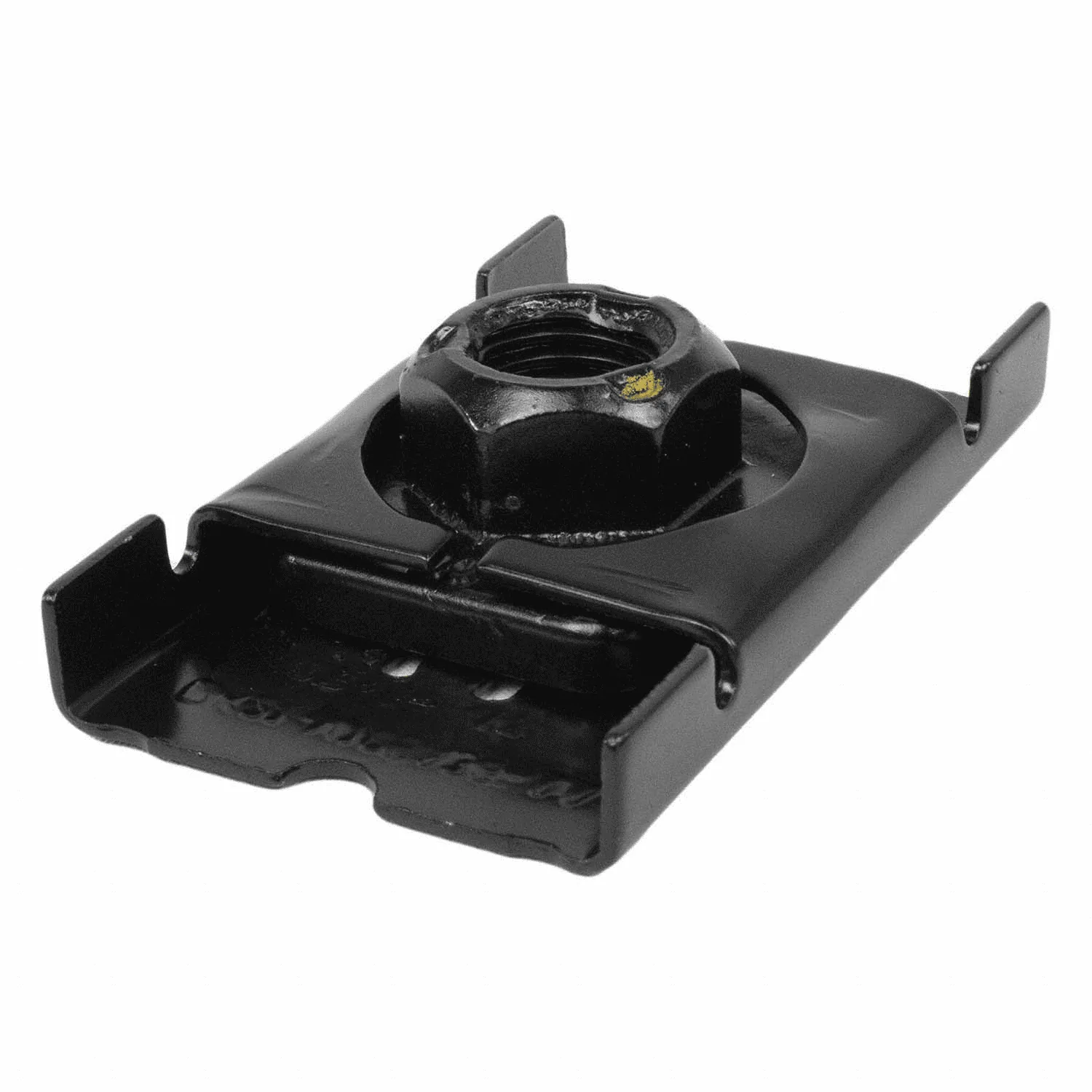

Yes. The cage of the nut will more than likely just be tack welded in. You should be able to bend the cage back, remove the nut plate. You'll then have to find a new nut that will fit and then you should be able to close the cage back around it.
This would be much easier if Ford showed a replacement in the catalog, but you should be able to make it work either way.
It should look something like this..
Sometimes they will spin in the cage too...threads are still there, but the tabs that are supposed to hold the nutsert get bent out. that will usually happen before stripping them, or the nutsert is just pushed out of the cage, and just laying up in there. Anybody who has put a tranny in a Contour knows all about this!
This is very true. The nut may be perfectly fine and just broke loose from the cage.

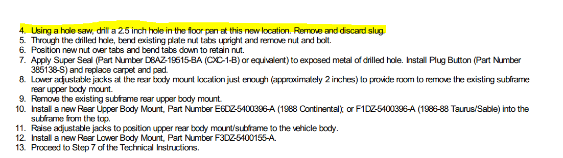

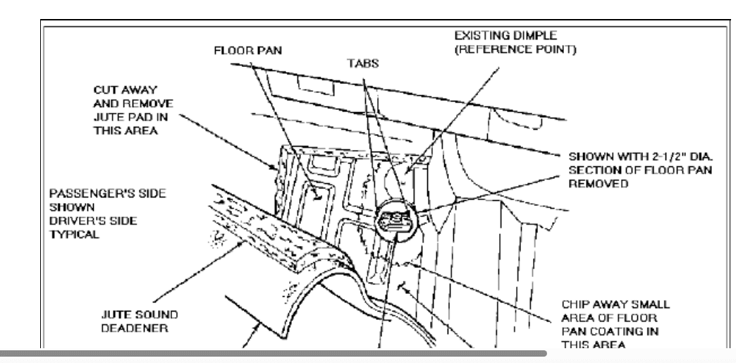

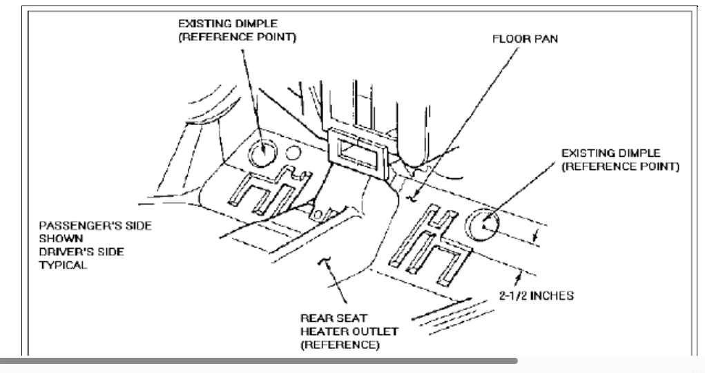

Wish I could find the Taurus sub frame recall, ya'll would love seeing how we had to cut out the floor board to get access to those stupid captive nuts when they spun out.
Hell, here it is....

I actually threw up in my mouth a little thinking about those...glad they have all gone to the crusher finally! BTW the book is wrong, if you drill the hole where it shows you it gets you nowhere...gotta drill it where that line that says 2 1/2 inches is
