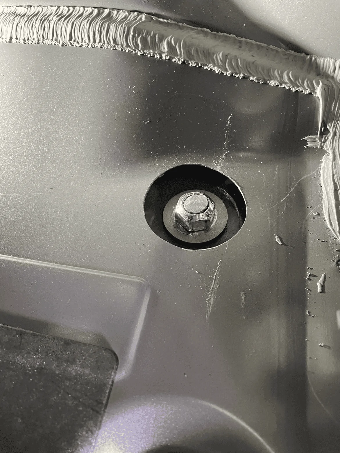

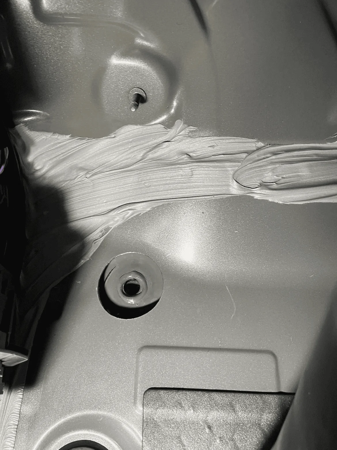

Not sure what came of this. But I'm willing to bet the nut is not strip. What bolt was used to come to conclusion that nut is stripped? Was a replacement from Ford bought?
If not, it's most likely the wrong size bolt. M13 bolts are only a custom made bolt, or bought through Ford.
Get a replacement from Ford and it'll thread in and torque down.

Mike you are who solved this problem for me with the new bolts you sent my way. Thanks again!

For future reference I fixed my stripped body nuts this way. Was not hard to do. Drilled pilot hole from the bottom. Drilled hole with 2" hole saw. Drilled out threads on the body mount with 1/2" drill bit. Put bolt in from the bottom through the body mount, cut bolt to fit. Used rubber plug to cover the hole when finished. There is no other way to fix it that I could see. The body mounts are made into the body.
