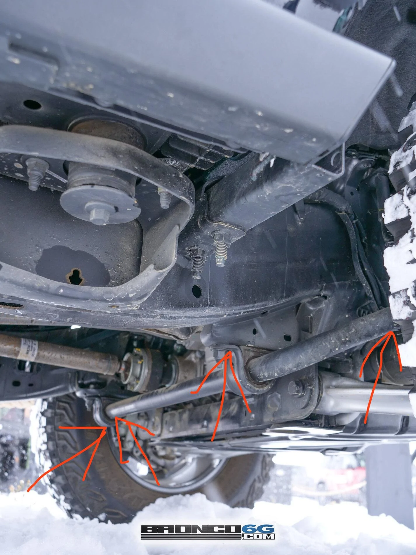

Granted I have a wrangler and used to have disconnects where I'd pull the pins and swapped those out for the currie anti-rock system which has been awesome but saw this pic from the other thread of the bronco on-site at the bronco event this week. All you need is a socket, ratchet or cordless impact gun to remove a couple of bolts.
