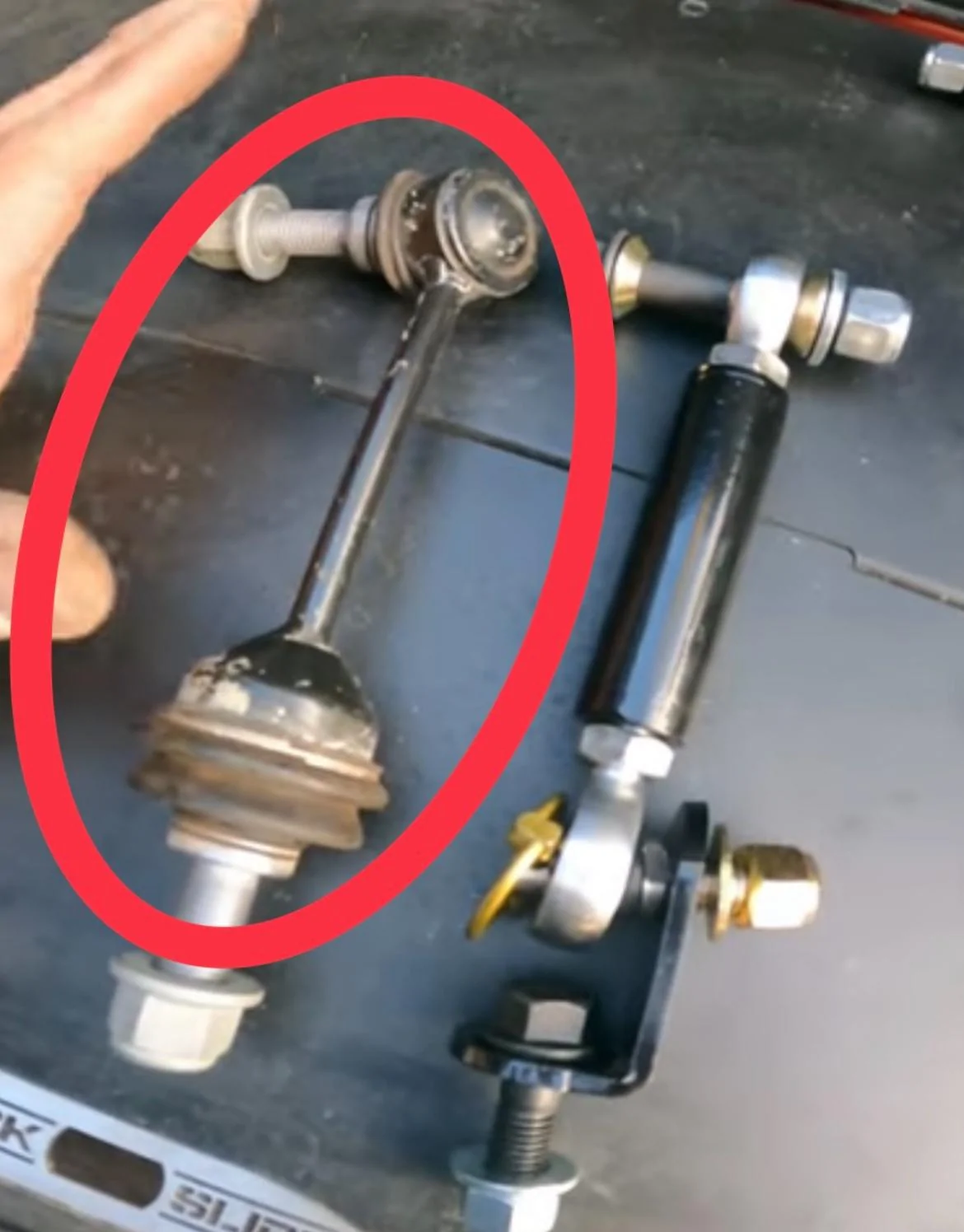

I believe thatā€™s just a single replacement part to the kit. You canā€™t just use those with the factory links.
Factory on left, AC Fab on right. Old pic, but you get the idea. AC Fab has improved theirs since and I believe there is at least one other manufacturer making them at this point.

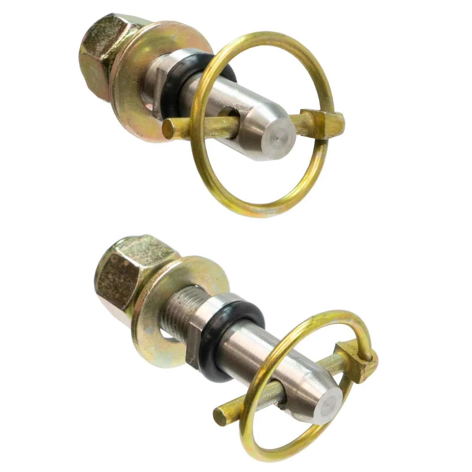

I just installed these AC fab disconnecting links like two weeks ago and they are clunking quite a bit.. have not even been off-road and it's really not so nice.. lubing doesn't help because it's the lower link where the lynch pin is.. even with the rubber o ring.. still annoying and I personally don't recommend.

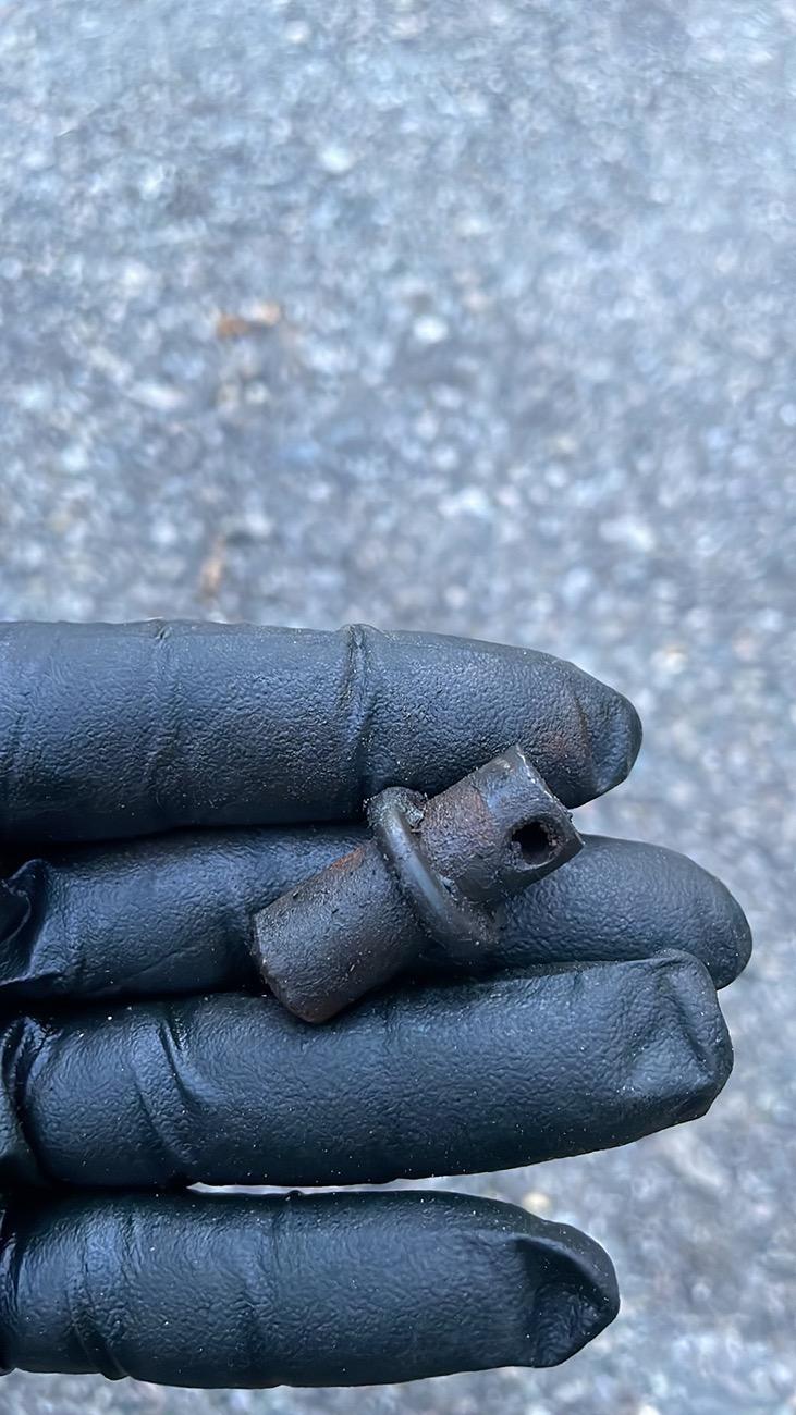

Iā€™m swaying in that direction too. Pun intended. The Boss Links look promising for half the cost. But, an upgrade is imminent. Oscar just sent me my 2nd replacement lower brackets. First pair was before they were welded. Second pair driver side weld snapped the other day on a pretty light trail in a rock garden (I didnā€™t have them disconnected).
