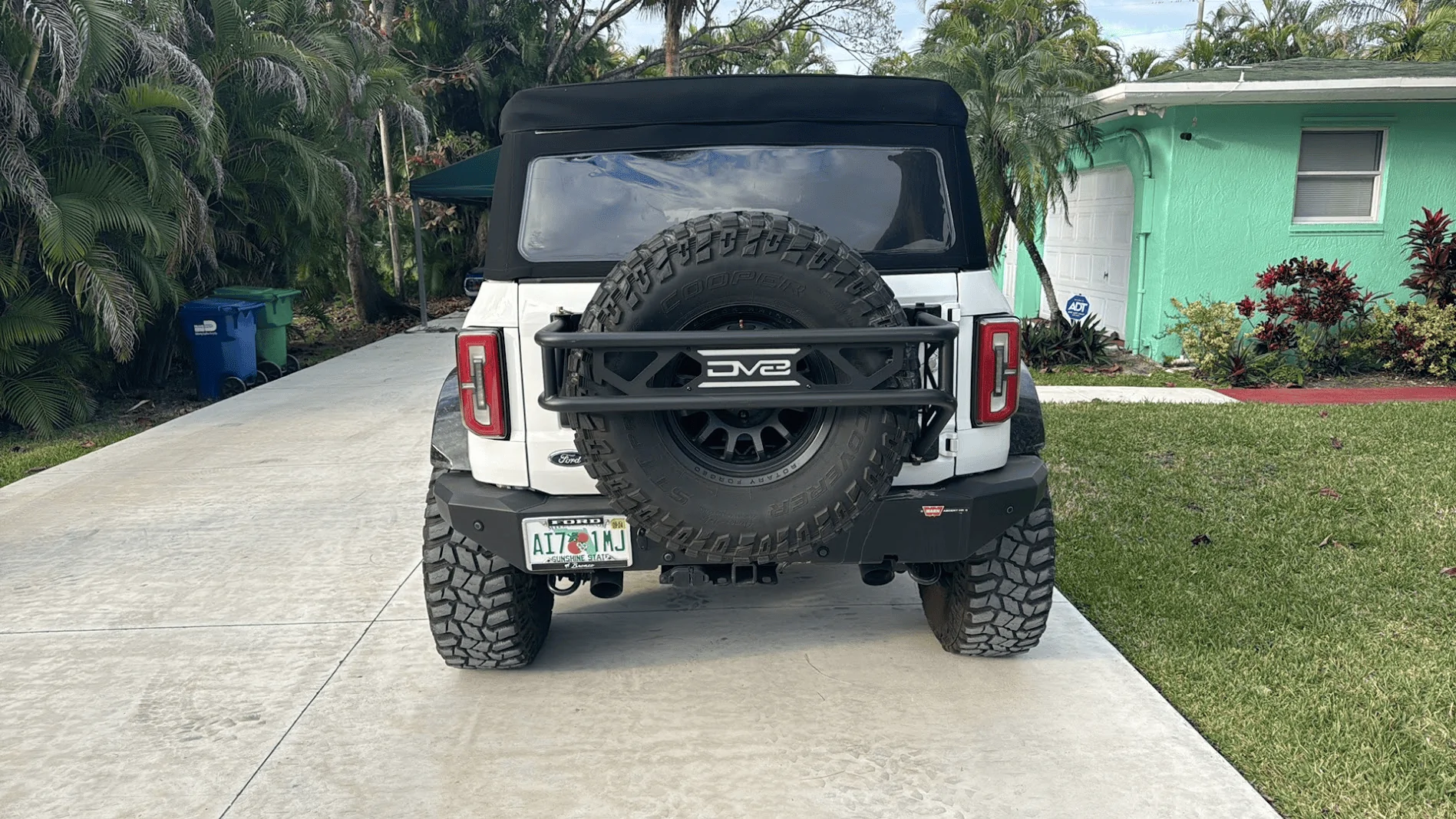

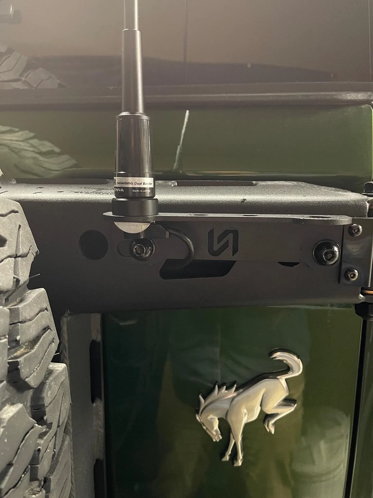

I run the DV8 Spare tire guard and accessory, along with the TOR Camera/Tire mount. Love my setup. I needed to use the TOR mount because my OEM mount was damaged when I had it off the RIG.
The DV8 is a great setup, and you can even lock the guard around the spare if needed.

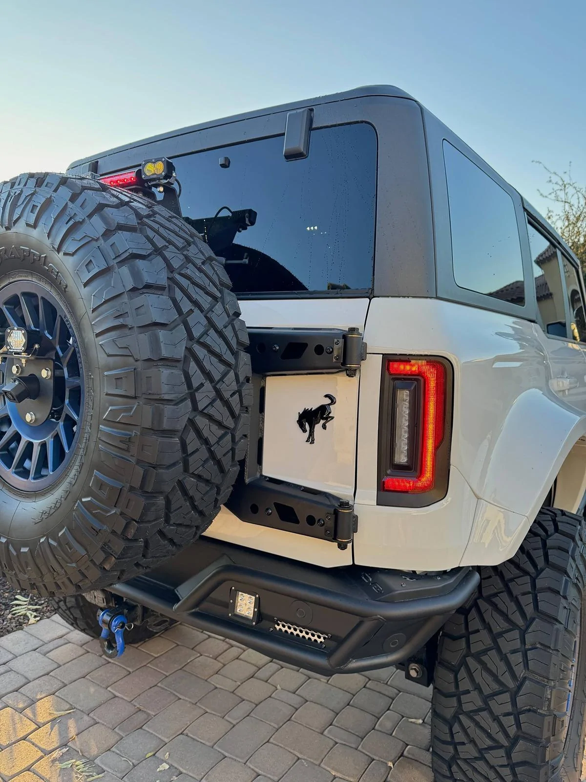

I run Hammer Built, no complaints. IMO, best one out there. If youā€™re going to run 37s, get a brace.

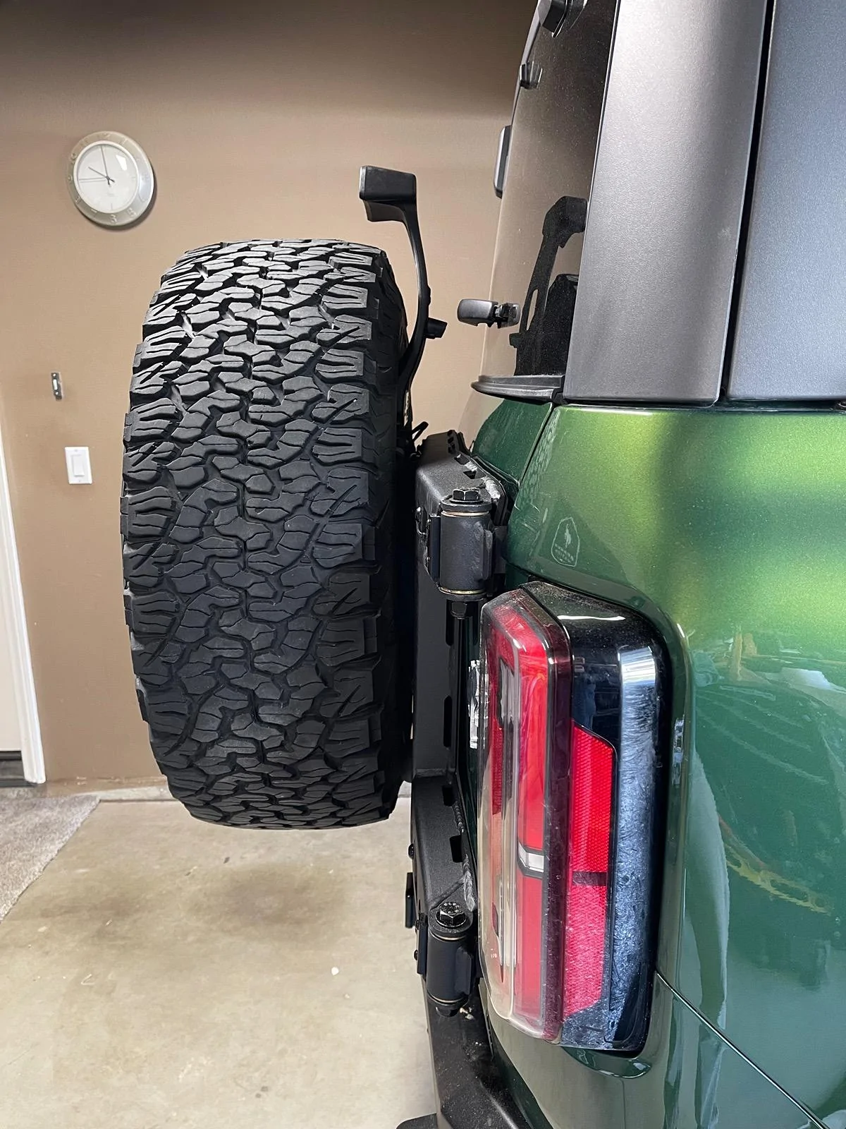

I went with Turn Offroad route. Watching their video sealed the deal. The adjustable spare tire mount helps with tucking off set wheels closer to tailgate. As you know when shopping for new tires even 35's the weight increase is minimum 10 to 12 pounds more than the Territory MT.

TORā€™s completely replaces the hinges and is a different hinge mechanism - the carrier bolts right to a plate on the new hinge and the tailgate bolts up on the other side of the plate; itā€™s a bit more than just a brace; not quite the bumper mount option but a close second. None of the weight is carried by the tailgate, but the weight is still carried by the right side frame mount (where the stock hinge bolts up).

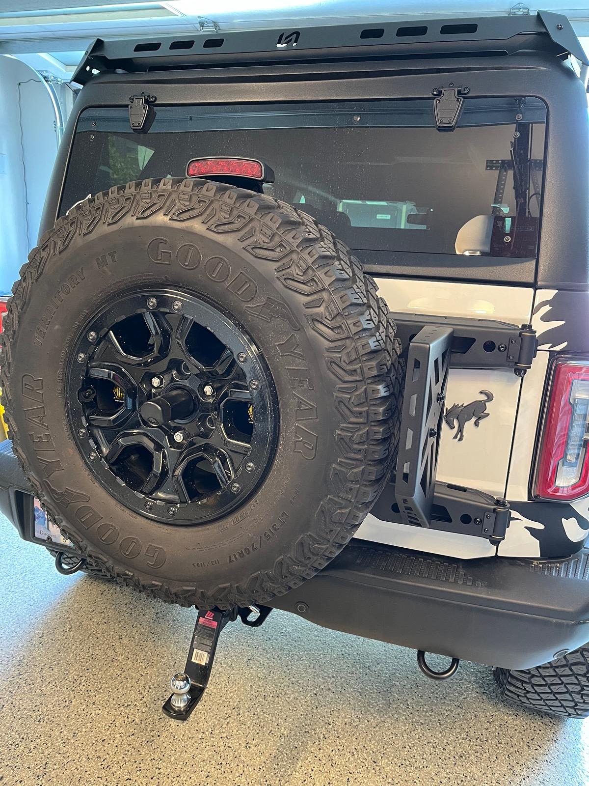

Another vote for @Turn Offroad - I have their tailgate reinforcement bracket for my 35ā€™s and itā€™s great. I recently upgraded my tires and they are significantly heavier than the OEM tires - no issues. This is very well built! They sell an add-on piece for larger tires as well, so everything should work for your needs.
Old picture, before the new tires:

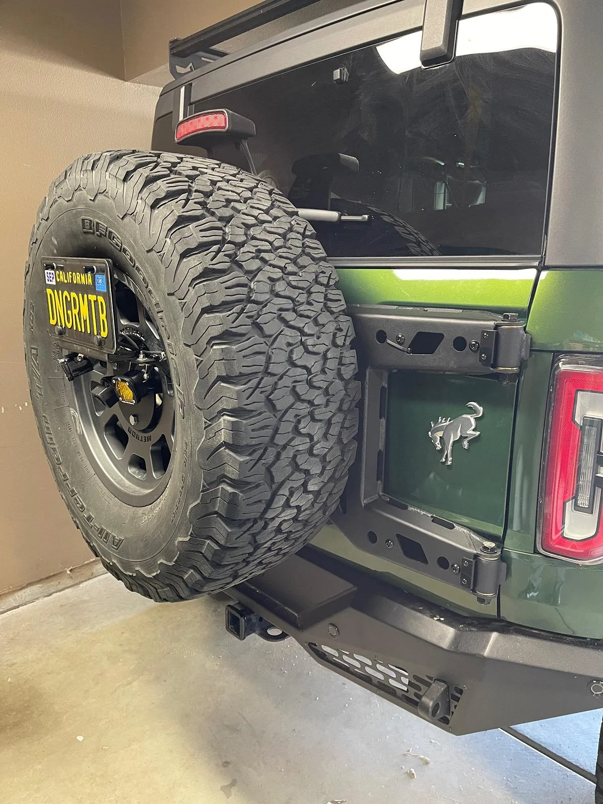

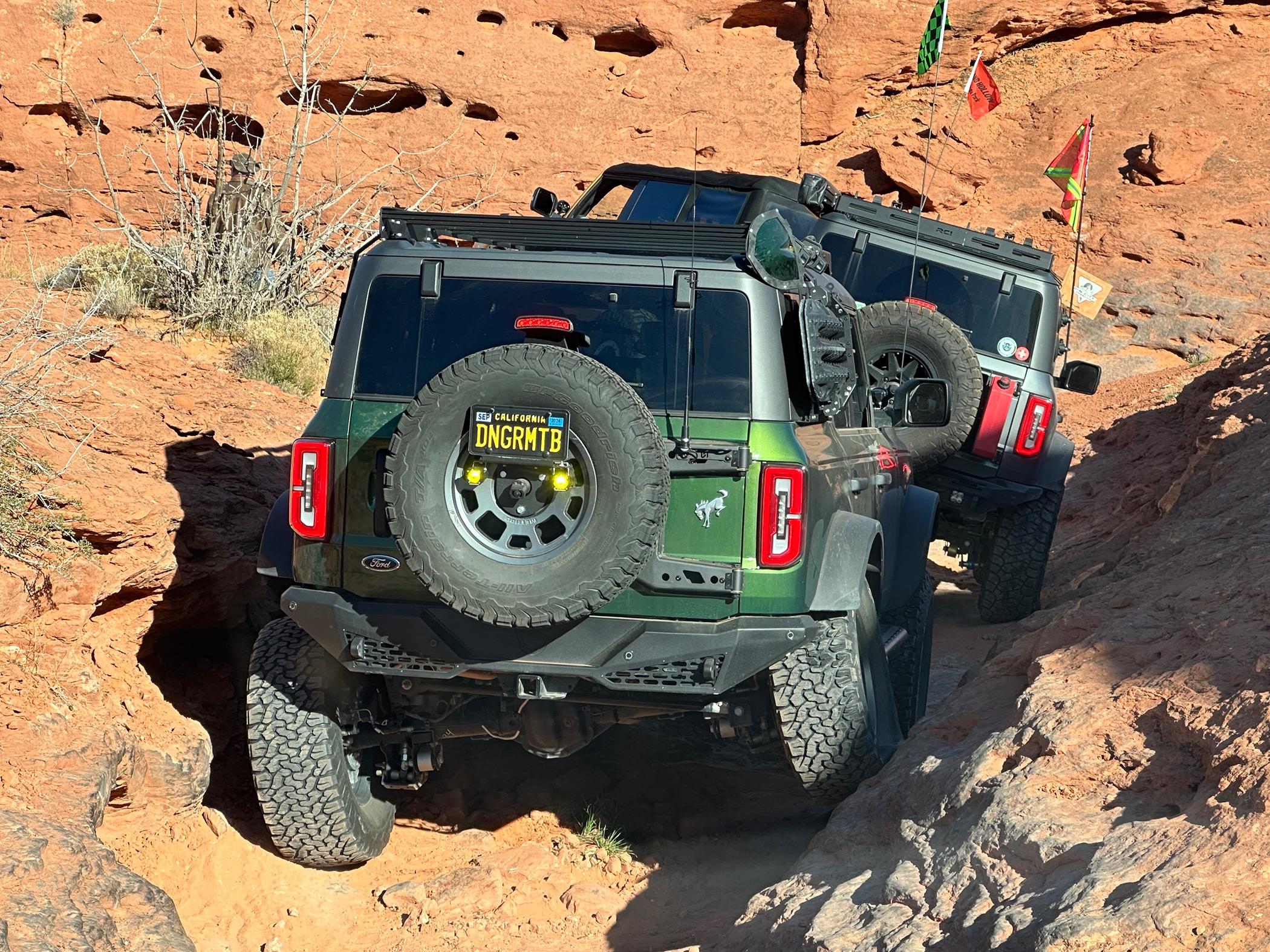

DangerMTBBronco
Dale
Jun 29, 2022
312
251
Lake Elsinore, CA
youtube.com
2022 Bronco Badlands Sasquatch

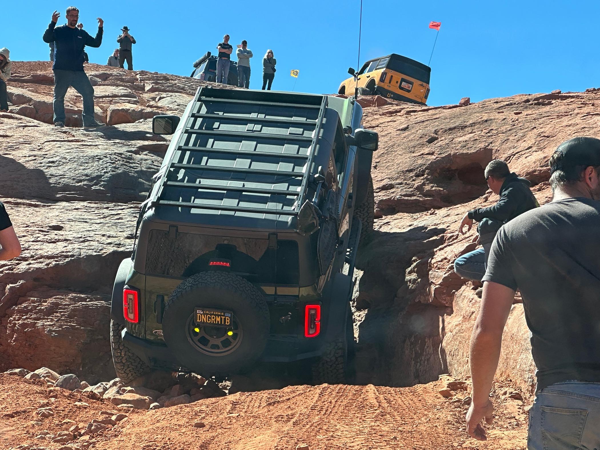

Another suggestion for Turn Offroad it is solid. Love that you can raise the spare height which really helps with departure angle running 37s
