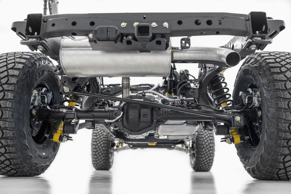

Wise to be cautious, but look at this pic of the Bronco rear -
Ford Bronco Tow capacity will keep me from switching... 2021 Bronco rear setu
You see the wimpy ClassII hitch attached to the crossmember, that is the reason for the current 3500lb rating.
You also see the tow hooks attached to the frame with two stout bolts. A ClassIII or ClassIV will bolt onto the frame after removing the tow hooks. The Ranger's 6000lb hitch is mounted where those tow hooks are. Even if Ford doesn't offer a stronger hitch I don't see a problem installing an aftermarket Curt.
