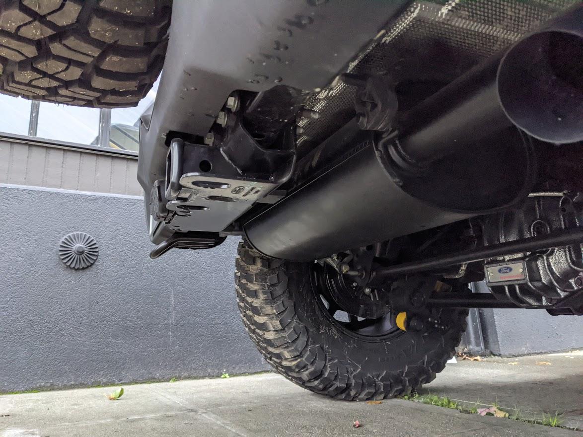

This was a good photo supplied by @damarble.
Ford Bronco Tow Package Question damarble

Not surprising - the press photos of the bare frame that's been also shown at regional events made that clear.
Ford Bronco Tow Package Question 1603722232699
But yes, I'm with you - sourcing a Curt or Draw-Tite equivalent should be extremely affordable.
Ford's profit margin on this package is THICC.

That's good to know, I've always used the hitch as a recovery point, even with a very similar hitch set-up, and no problem; but maybe it's not the best. Would those tow loops to the left and right be stronger?
