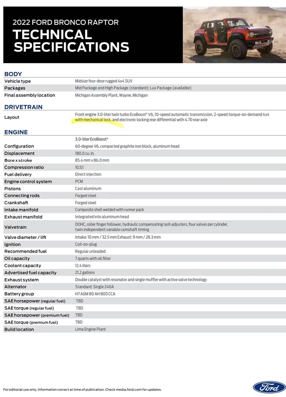

According to this it does indeed have a lockup. Still looking for more info.
Not sure I trust Ford literature much... but maybe... and if the BRaptor is running the 10R60 and it"s Tcase locks up.... we are half way there.

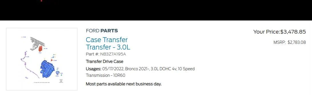

Looks like they also run the 60 if what I’m finding is correct. (Might not be) Started searching for Braptor transfer cases and this site shows them to be compatible with the rest of the trims. Whether that means it has a mechanical lockup or not I don’t know.
https://www.fordpartsonsale.com/oem...3tOceuuF9XCVdFjLMZqYgJH8iD0sr9sEFymPuPlhwsqMo

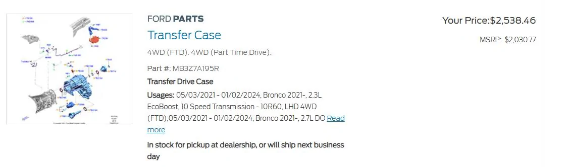

As close as I can get on the fly.... BRaptor is running the 10R60 so should mate up but the T cases appear to be different part numbers (at least on Ford parts.com)
