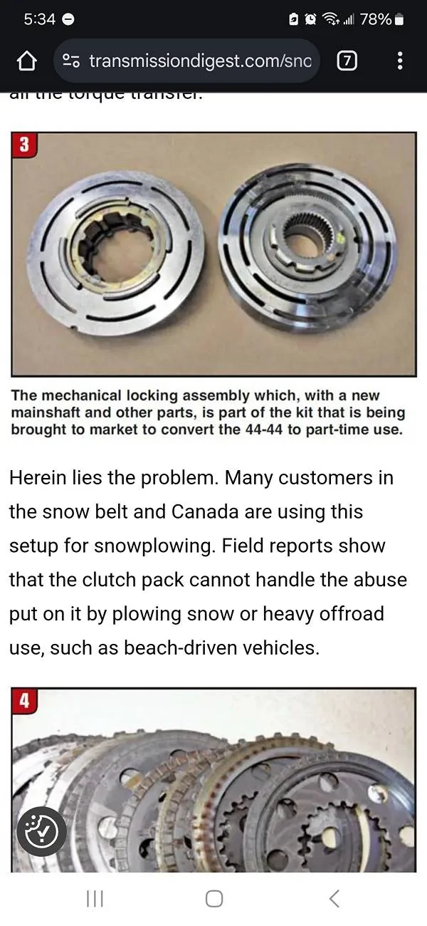

From @Snacktime link.
Ford Bronco Transfer Case Technical Discussion Screenshot_20250315_053433_Chrom
This is what we need plus a lower low gear ratio gear set! #3 and the bold below it. From the looks of it, it removes the clutches and makes it part time 4x4!!!
I'm going to read that in more depth this evening!
Edit to add: That is exactly what this is! Nice find @Snacktime ! Now, who's going to make it happen for ours? @BigMeatsBronco or perhaps you @SierraBronco 😉
Show me where to buy it! I clicked through their stuff and couldn’t find anything

Yeah. Couldn’t find anything for Bronco* 😢
I do not think there is anything yet... BUT I know you have been discussing this issue with people that may look to this design as inspiration... OR this company may determine this enough a market to offer it up... possibilities....

The part was never fully developed. Ram came out with an updated transfer case that was a drop in replacement.
Maybe the right size shim in the mechanism would increase the tension. A feeler gauge and calipers would be where I start. Looks like there is enough play that you could get a few more thousandths take up which might be all you need.
