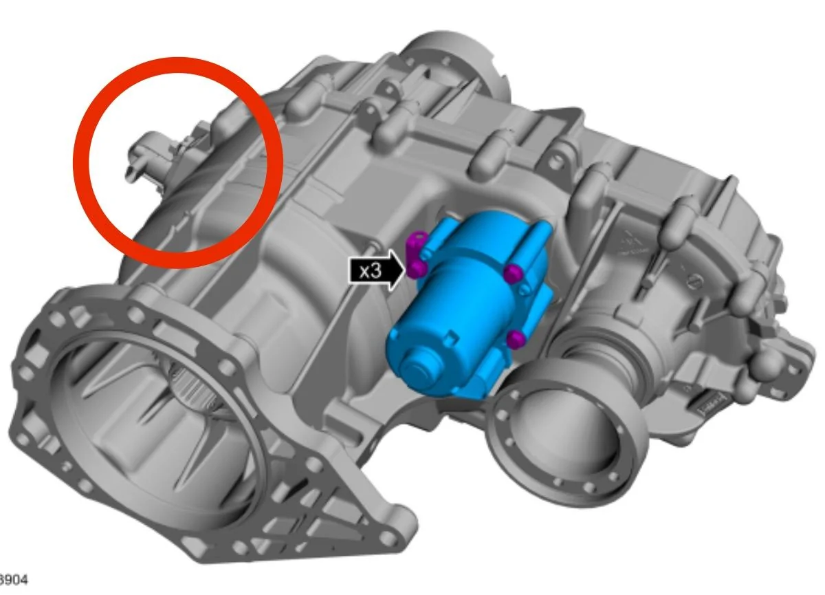

4A is an encoder motor also, it's mounted on the front of the case instead of the rear. No way you could get vise grips in there, but looks like the right allen socket could do it. W/that motor not mounted tho, idk what keeps the linkage from vibrating into a different position, possibly neutral, wouldn't be something I'd wana do on the trail unless totally out of options. The part time xfer case looks way easier...here's pics, 1st the 4A:
Now the part time case. Looks like you could shift it w/a screwdriver, but how to keep it locked in position? Might be a strong enough detent to hold it in each position, but I doubt it!

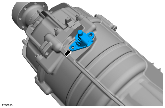

any chance you could show me where the tcase range sensor is on our advanced tcase? Is it also called the position solenoid??
Ducati1098
9,759
22,484
Midwest
It’s on top near the rear.
Ford Bronco Transfer Case Technical Discussion IMG_4016

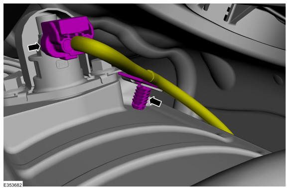

Disconnect the transfer case range sensor connector and detach the wiring harness retainer clip from the transfer case.

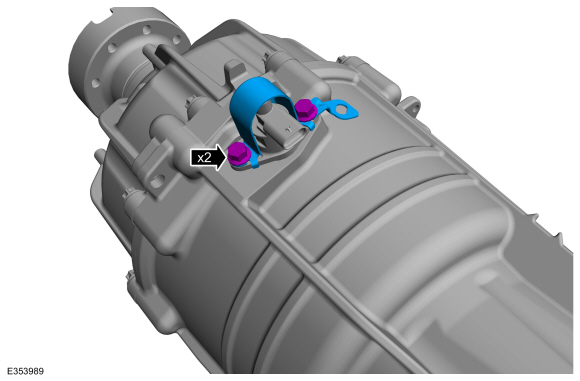

Remove the transfer case range sensor retainers and remove the transfer case range sensor cover.
