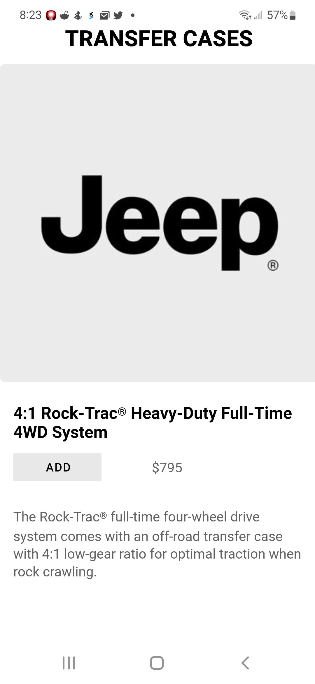

Jeep started offering the Rock Trac full time 4 wheel drive system. I wonder how that compares? Seems likes it's somewhat operated similar in the sense that's its electronically engaged and clutch packs. And has CV joints. I'm not a technically knowledgeable when it comes to this stuff. So not fully sure.
Wouldn't that be something if Stellantis goes to a more electronically driven system as the only option in the next gen Jeep in 2025 and the die hards have a heart attack.
It seems they might be trying to slowly ween them in that direction in plain sight. Not sure but everything is going electronic these days. It's only a matter of time.
