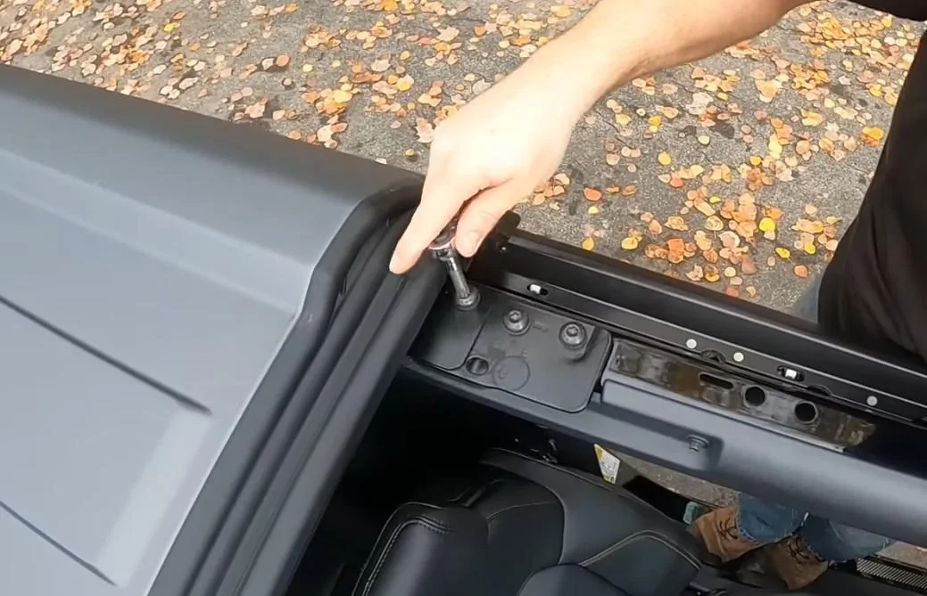

I took delivery of mine a week ago, and am not quite at 300 miles. I noticed mine is missing the two bolts that secure the clamshell at the to top front where the front panels meet the rear clamshell, so the connection plates rattle and Squeak a bit
The holes are a bit misaligned too, so after reading this thread, I cannot wait to hear what Ford has to say about it!
Wow! Definitely should be a bolt there. Not even close to lining up. The front 2 bolts are fixed by the holes in the rollbar so that means the top is skewed rearward somehow? This is a 2 door.

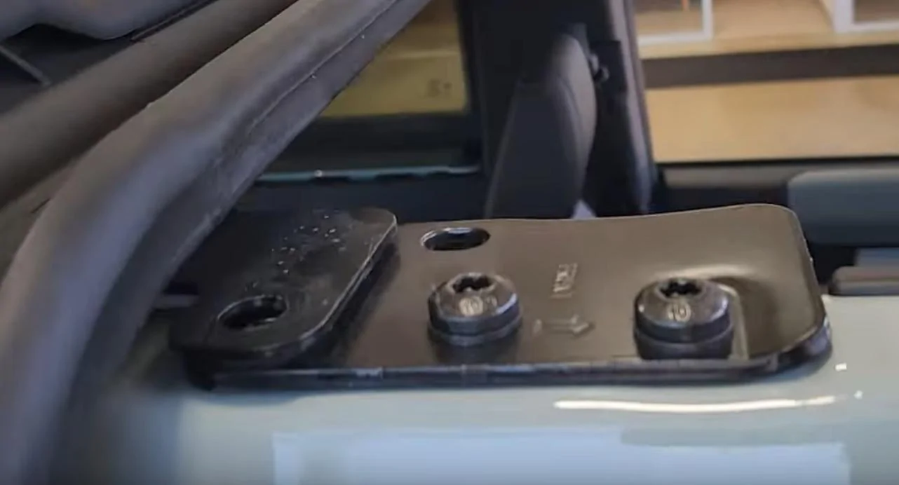

Side view just after the bolt was removed also 2 door.

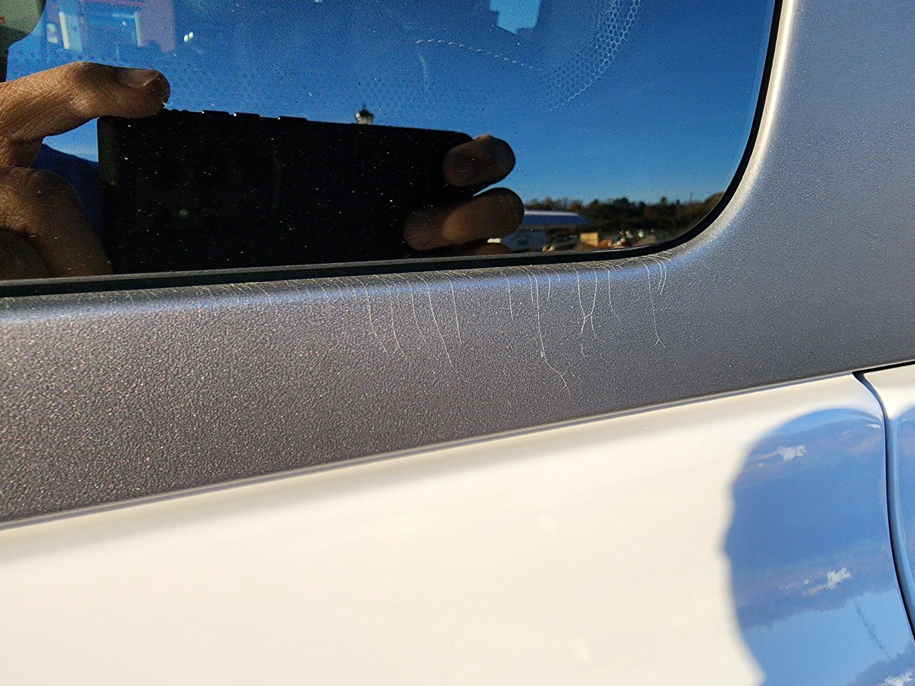

Just wondering if anyone else is having this same problem. Both the drivers side and passenger side are developing these hairline cracks in the lower window panel area. It hard to see in the picture but seems like I'm getting more and more every day

I can't tell - is this a 2dr or 4dr roof? I'd be curious if there's any trending data if one seems to be suspect over the other.

Thanks for the pics! Mine is also 2-door. I just took mine in and will have to schedule an appointment to confirm the bolts are missing before they will order the part, because despite the service advisor asking me to remove the panel to see, he could not confirm the obvious.

Wonder why the alignment is off though? It's not just a small amount. Should of been flagged at the plant when the bolts would not fit but apparently they sent it on down the line. Quality at this plant seems to be severely lacking. There are numerous easily seen defects slipping though, just imagine how many are unseen. No pride in what they do, almost like we are back to making cars in the 70's before changes were forced due to competition from Japan. Then again having worked in a similar environment, management pressures and their lack of concern other than for quantity creates that type of atmosphere.
Mine is a 2 Door

Glad to hear that. I'm going to take mine in next week for the same issues under the windows. I hope I have the same outcome. The build quality of these tops is horrendous. My wrangler top was much nicer quality. I really expected the same or better, but got much less.

Even though mine is not yet cracked, I am pretty sure at least the top will have to be replaced. Good to know they are starting to follow through for others. So far they have ordered replacement bolts and will then need to physically confirm the bolts will not fit. The dealership also did not want to remove the whole top until the bolts arrive.
Ford Bronco UPDATE/ Ford IS Warranting MIC top v2 developing  hairline cracks 20221021_173551
Mine is the same under and behind right rear window. 900 miles

just noticed today..... mine is developing hairline cracks on the driver's side - 2 door. Not missing any bolts.
