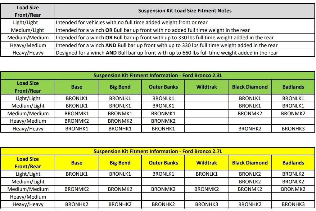

So am i right to assume that people are just putting on adjustable shocks and increasing the height to compensate for the added weight?
Adjustable shocks are one strategy, but in my opinion only really make sense if you don't intend on keeping the weight on full time. Otherwise I'd just buy shocks that are built to handle extra weight. For example, ARB Old Man Emu has suspension kits for varying levels of added weight (chart below).
Personally, I'm partial to Falcon/Teraflex shocks, but to my knowledge they don't offer a kit for stock ride heights—everything they got adds some sort of lift.
