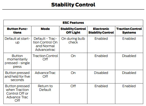

Simply put, when in 4lo ditch the nannies.
Based on the manual's pages 202-206, we have two major nannies, traction control and stability control. Stability control is fully functional when traction control is user disabled. 4lo disables both traction and stability control.
Ford Bronco Using Traction Control Off Road 1623161465005
Yes, and I believe the "AdvanceTrac" is the brake limited slip function and that remains unless you hold the button for the five seconds. This is good to leave on unless you have and are using both front and rear lockers.
