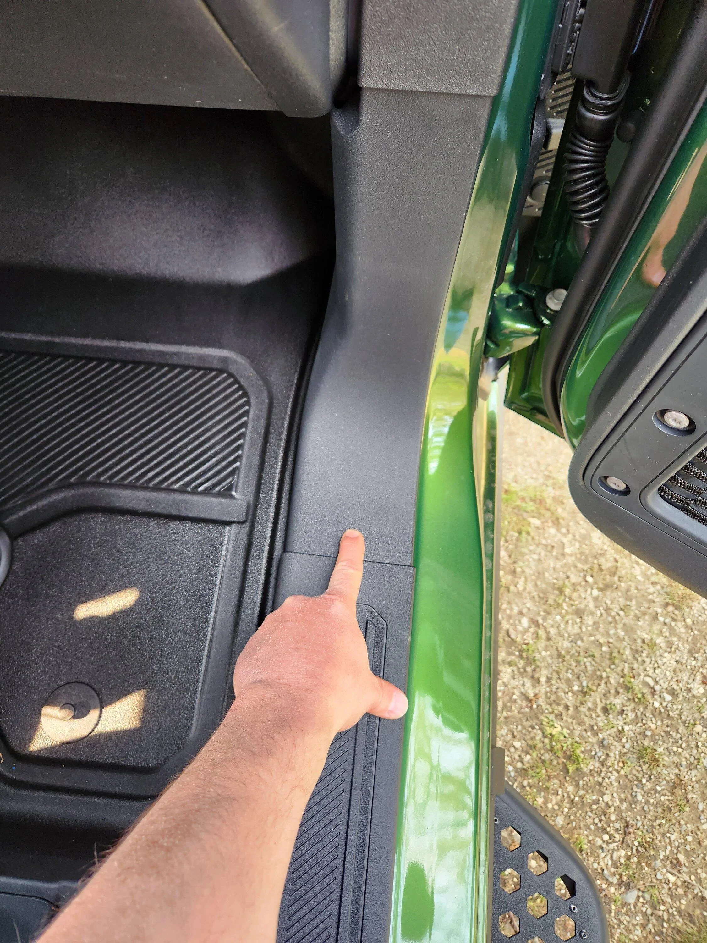

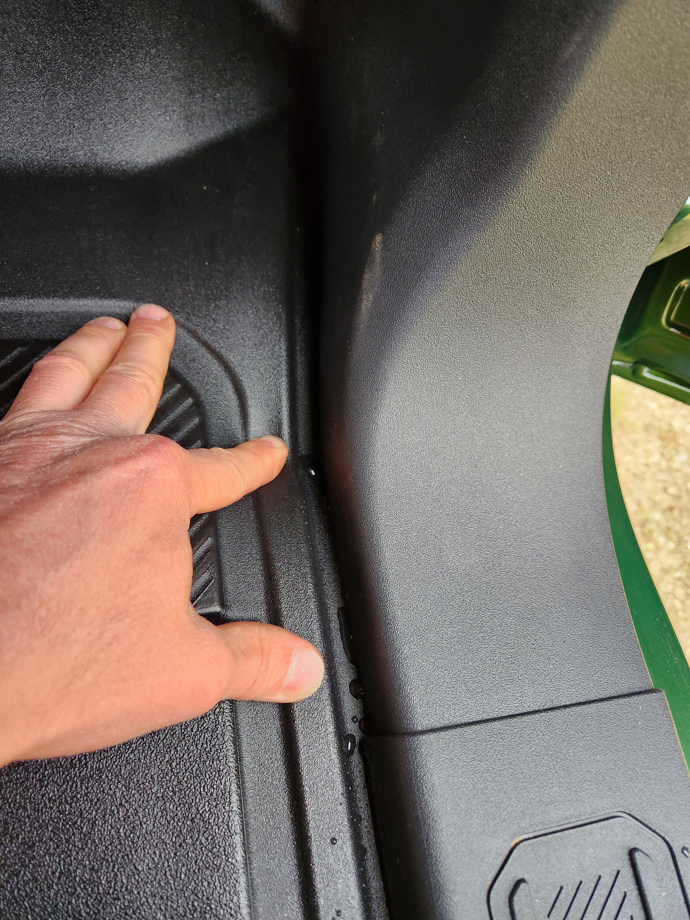

Hello all. I've had my 23 BL 2 door for 4 days now and have found a water leak. It rained pretty good last night and this morning I opened the passenger door and saw water sitting on the sill, and the carpet floor mat was wet. Had anyone seen this before?
Ford Bronco Water leak, passenger floor 20230508_161029
That is where the water was sitting.

Those drips where my finger is, is actually under the door. I don't think a leaking top could get water there. I'll have to sit in there while the wife sprays it with a garden hose.

I really don't think I've fixed it yet. It hasn't been out in the rain much. I really think it's coming from the triangle rubber piece at the front of the door glass. If I wipe the inside plastic with a wet cloth I can see water marks where rain has been running down from that area.

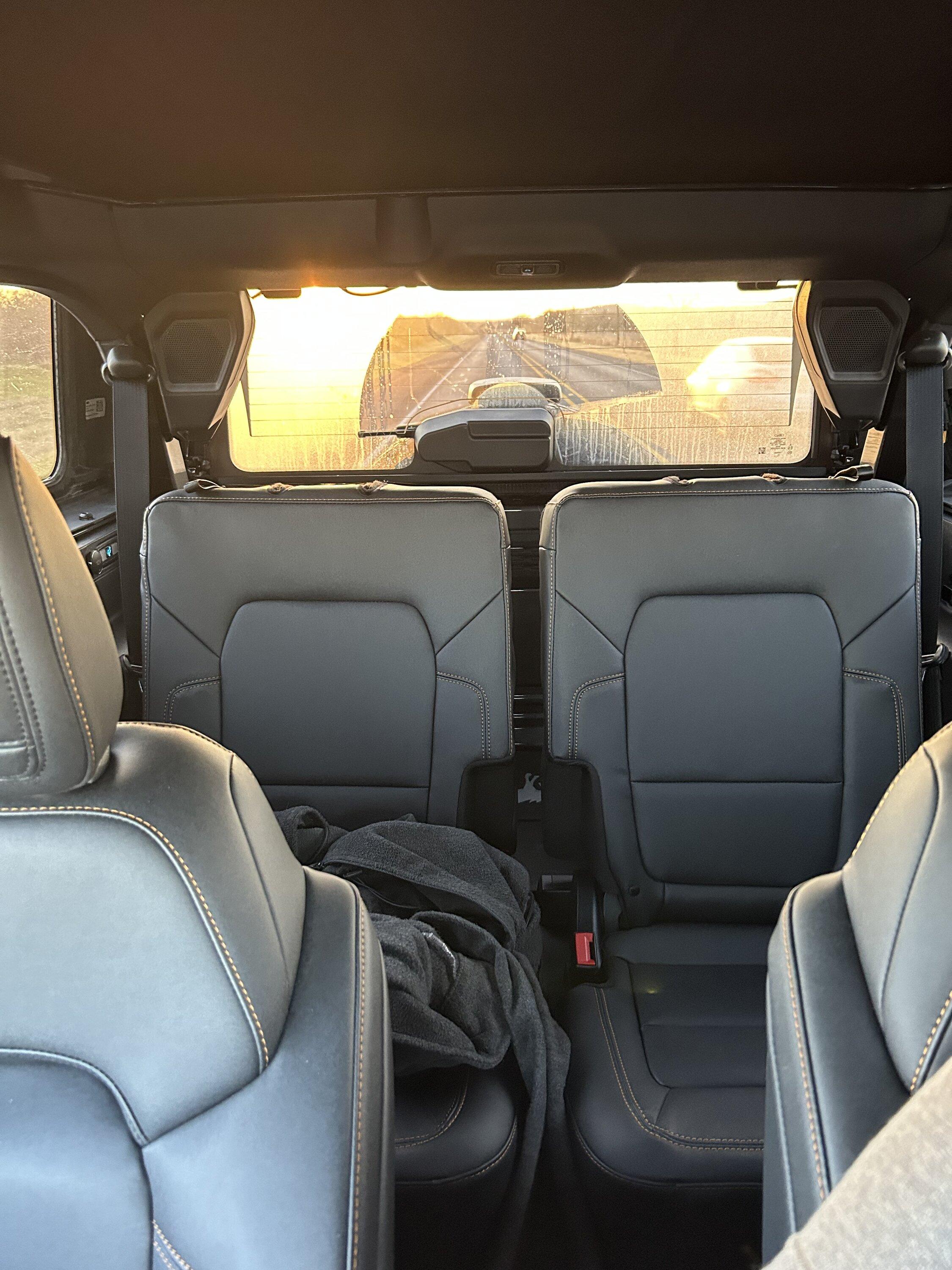

I had water intrusion (also 23 2dr BL) along the passenger door and the rear window. You can see the rear window here, the parts that look like clear rivers (like right down the center) are on the inside of the window. I suggest checking by opening the rear window and looking for the runs. I don't have any pictures of the front passenger door, but imagine it could be a similar issue if it's leaking and running down through the plastic covers on the door sill.
When I took it to the dealership, they found the seals between the top of the windshield and top and also the rear window seal had "flat spots". Frankly, I've heard of other 2023 Broncos having similar seal issues. I think they had a bad run of seals starting in late 2022 and through early 2023.
My seals were replaced under warranty and in the front I've not had issues. I think I see rivulets on the rear window again, so I'll have to take it in for that and a CSM issue.
