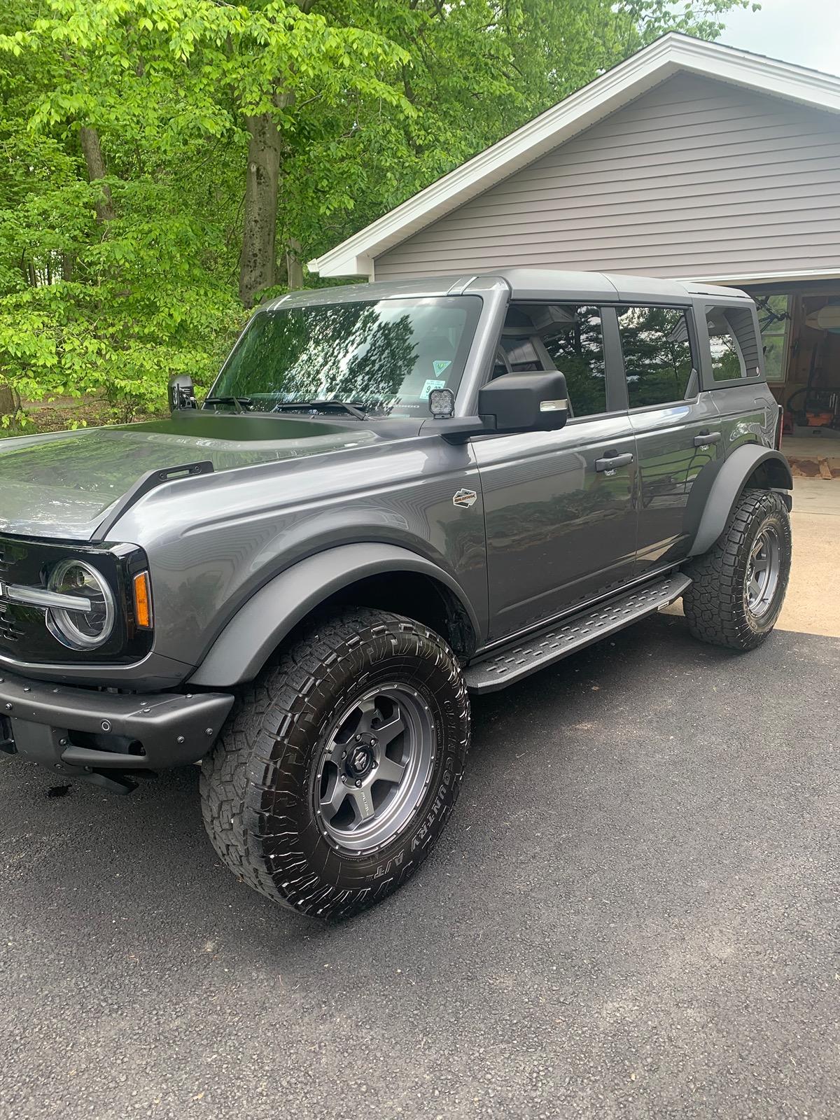

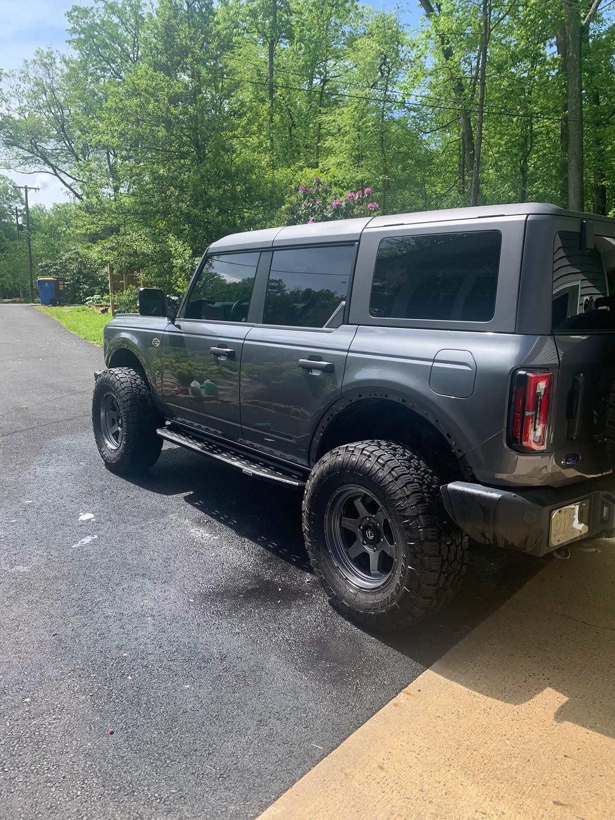

Just scored a set of ford removable hoop steps($180) and got them installed as a late Mother’s Day gift. She likes the look of them. I did not realize how light duty they are tho. No way these can take any vehicle weight or a hit off road like the badlands stick rails. I had already drove an hour to get them when I found this out so they will be the around town rails and I’ll have to keep the badlands style for more serious off roading.

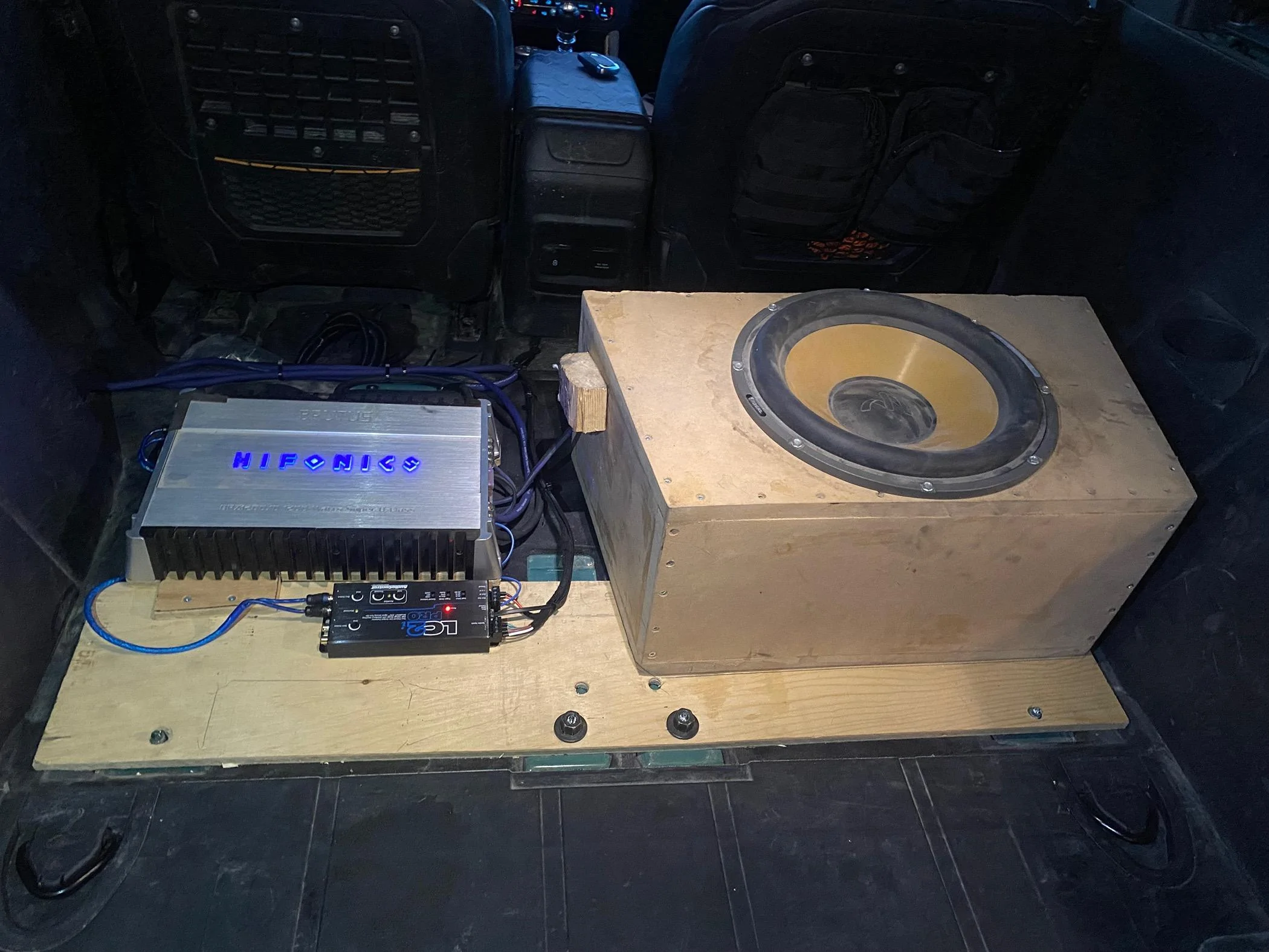

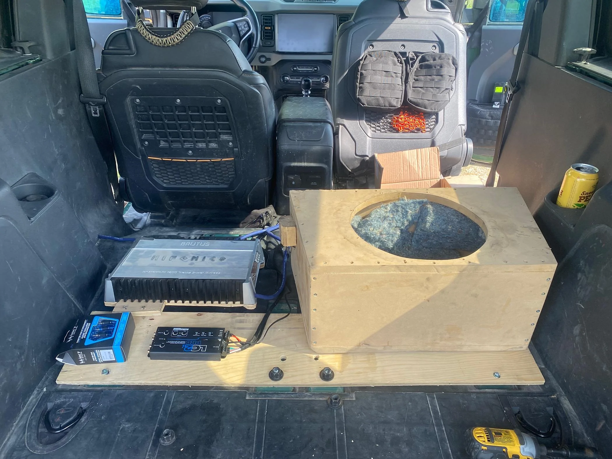

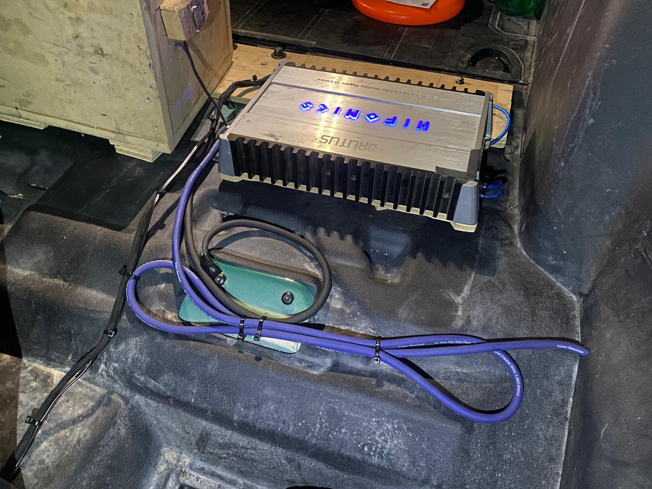

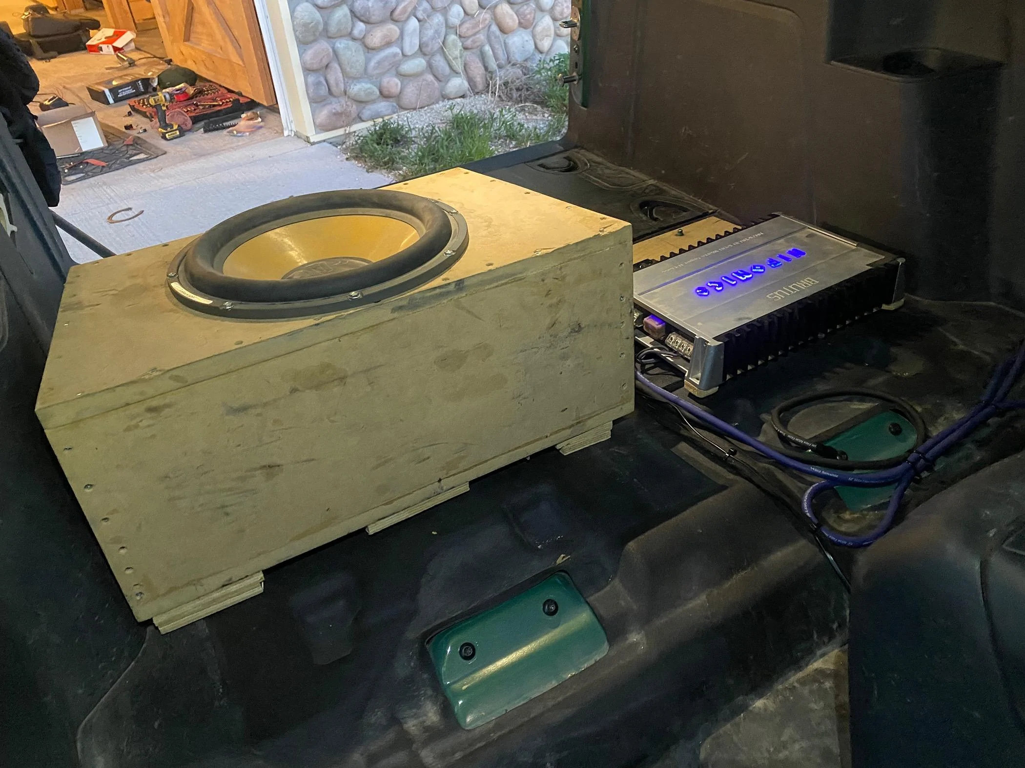

Finished off version 1 of the audio.
Just a temporary solution to get through for a few busy weeks and upcoming trips. The new floor setup will be built in a month or two
Powerbass 4” Waterproof’s up in the dash, I kept ingesting dirt through the pole vents of Kickers and Hertz. Needed a sealed unit.
Kicker CS6.5’s down low. Kicker Key200.4. Plug and Play Harness, Audio Control LC2iPro, Hifonics Brutus 1200.1D Mono, Focal E30KX K2 12” Sub.

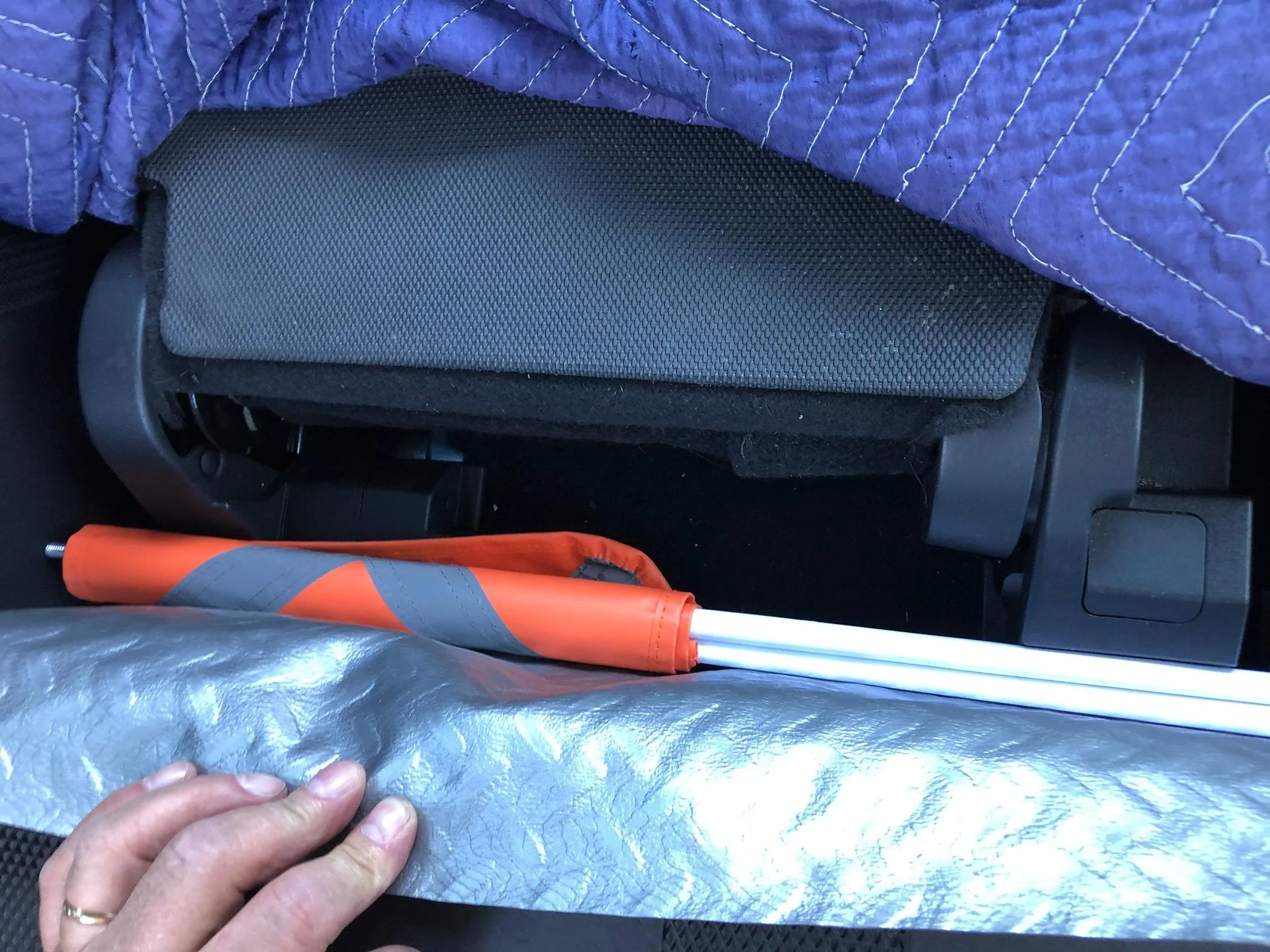

Ford points day……I added a mat under my locking box to reduce rubbing and it added a nice spot to hide my dunes flag

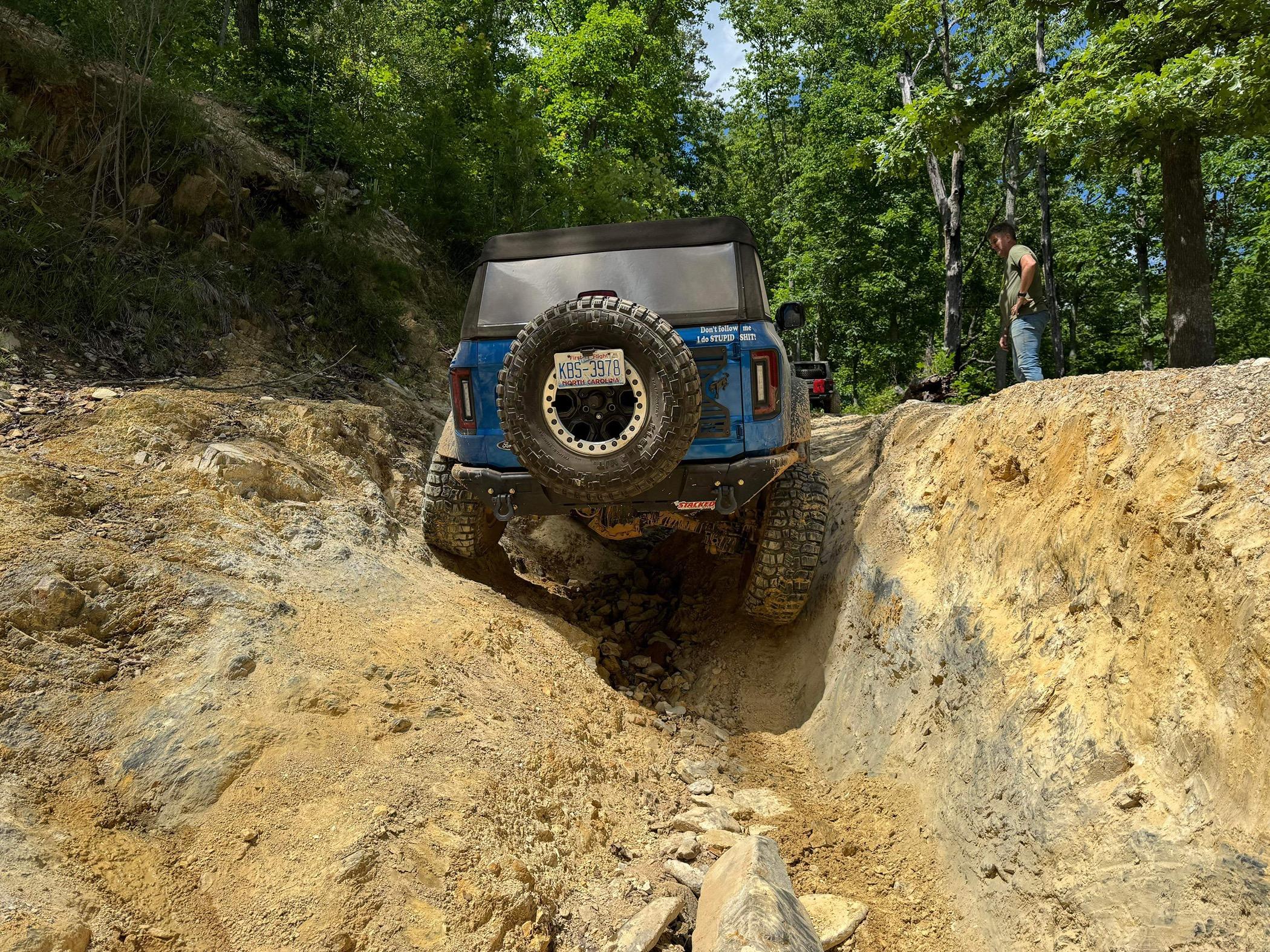

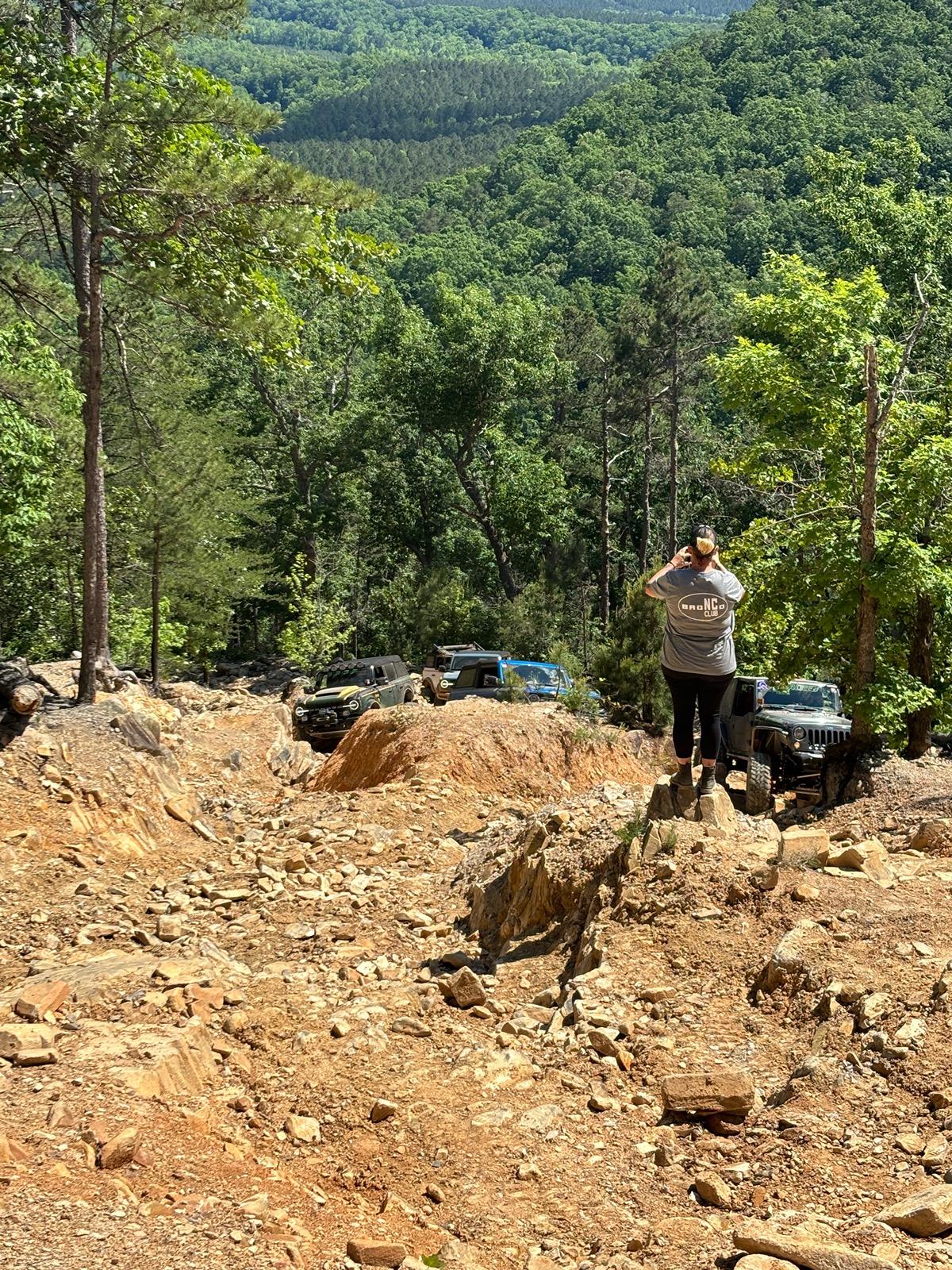

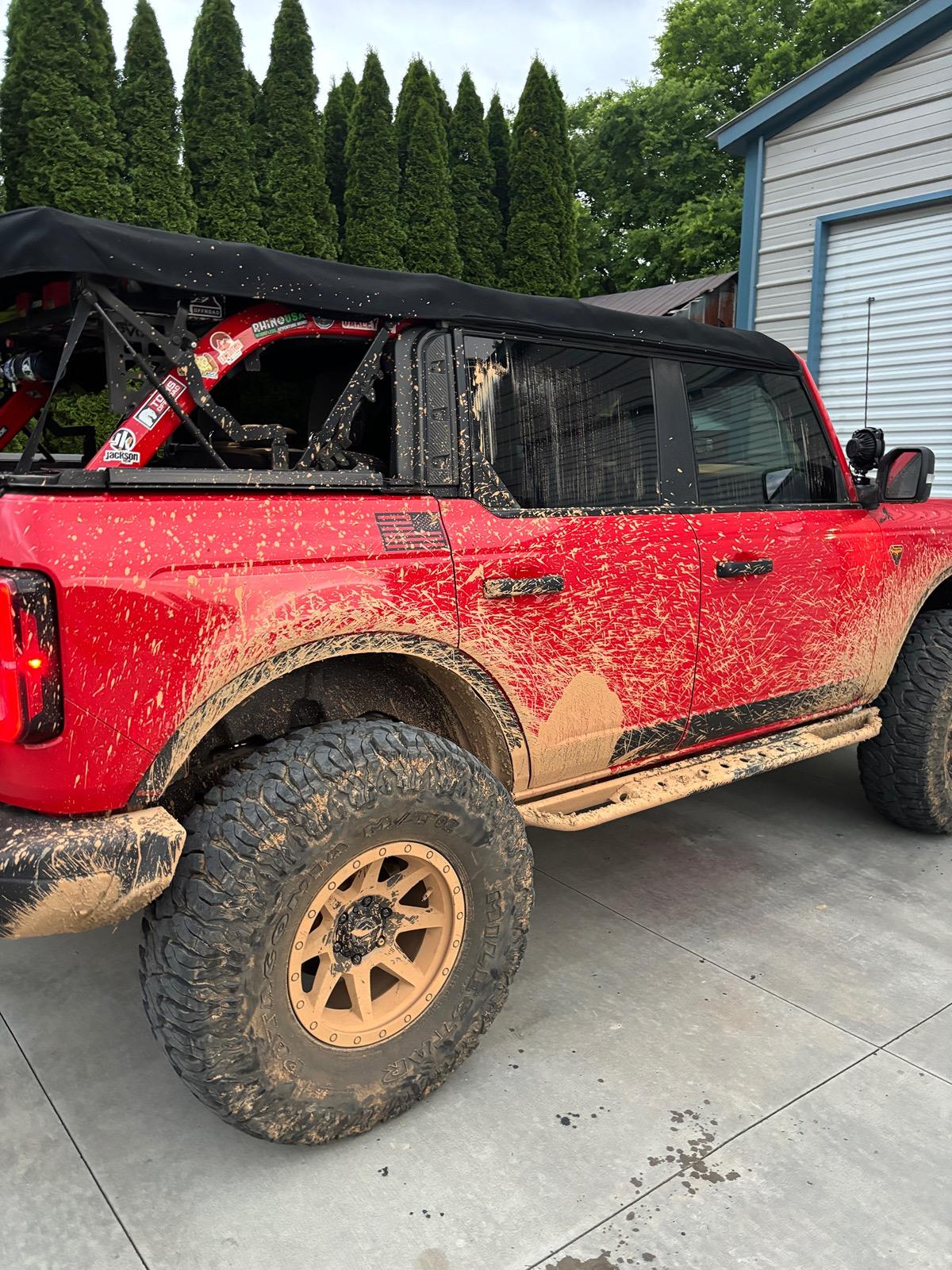

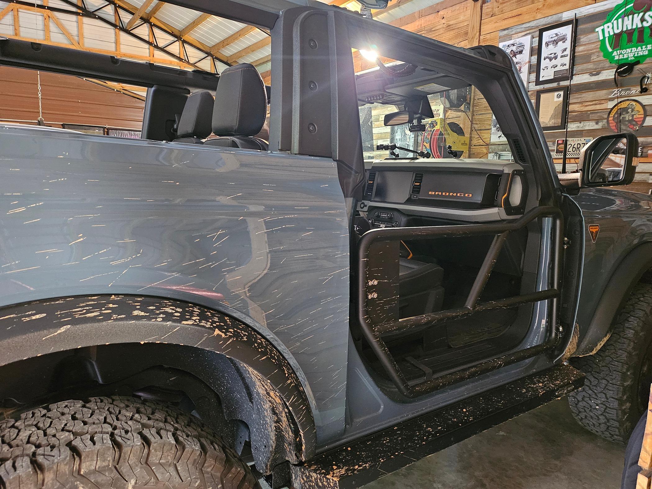

Saturday was spent in Uwharrie getting dirty with a few good people.
Yesterday the rack bushing was finally installed and transmission fluid and pan were changed out for the RockAuto one with the drain plug.
Hindsight tip:
Take the filler plug out and extract as much as you can. Helps with the mess.
Also the capacity is 13 qts. Doesn’t mean you get all 13 out and put 13 back in with the pan method. I got a little under 6qts out.

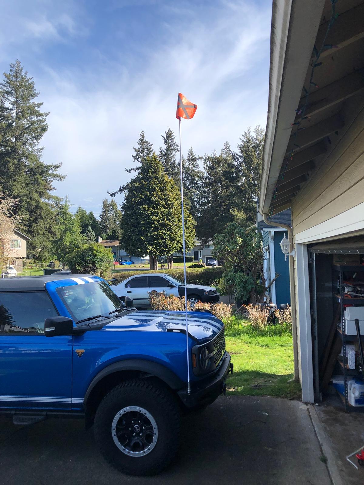

We're going to Silver Lake Dunes in MI next month and they require the flag to be on the front of the vehicle. I have a rear mount on my spare tire but am looking for something for the front.
Where/ how do you mount yours?
On the front Swarfworks, found it online, great fit and heavy duty. Look back in the thread, there’s some close ups too
