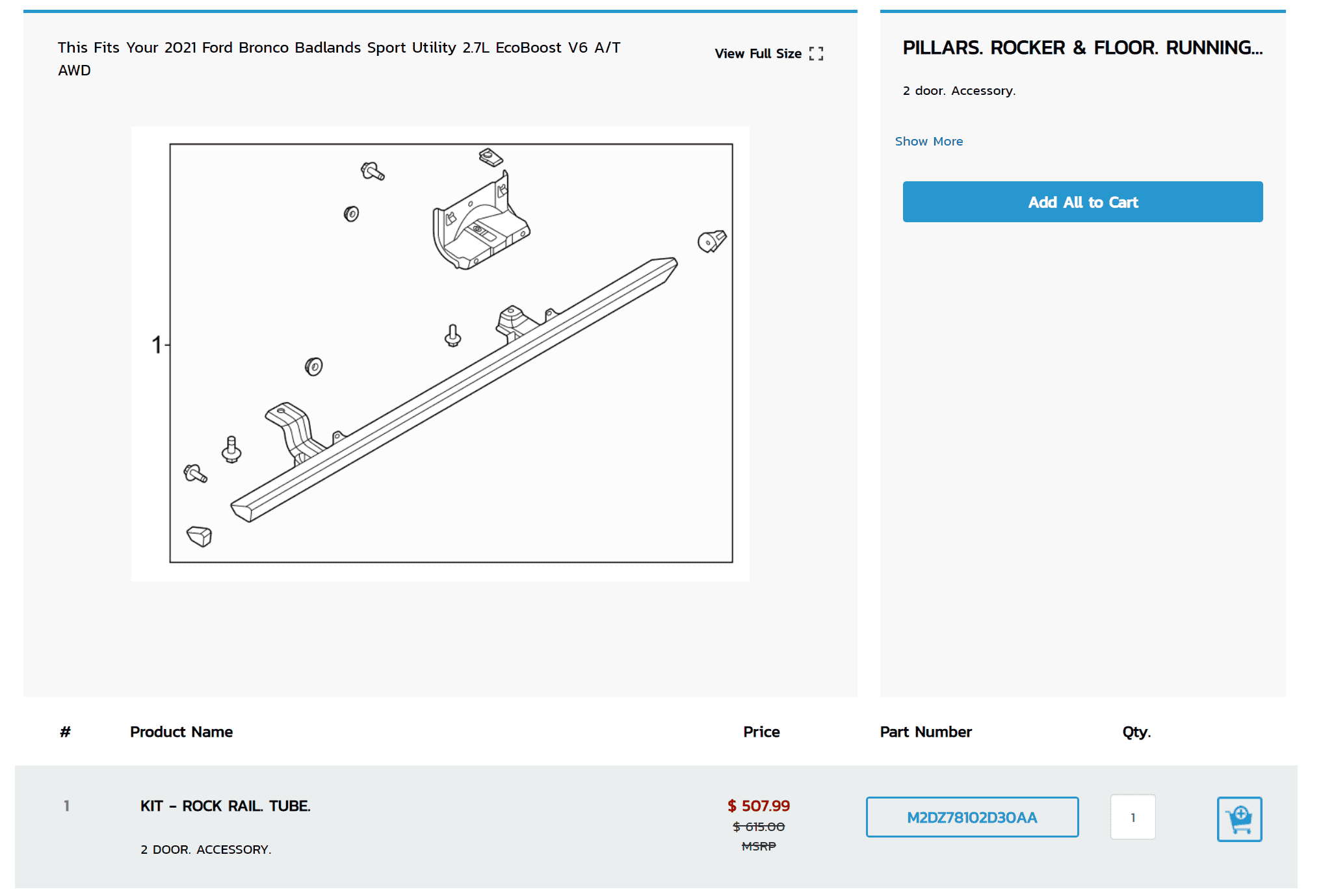

The brackets you need to mount these if you don't have a badlands are hard to find.
Mine have been on backorder for 4 weeks with no word on when I can expect them.
Got my steps almost 2 weeks ago.
What is the difference? Very interesting.
Gofar
Doug
Sep 16, 2021
Carson Valley
21 Bronco 4dr base sas 2.7
Base models don't have a factory Rock Rails and the brackets that mounted the rails.
You need those brackets.
Mine came with the brackets built into the step/sliders. Bolts were also built in that go into the pinch welds.

I have had my brackets on order through Ford since 12/29. Still no word on when I will get them. Unreal
I am not understanding what the folks are taking about when they say they have brackets on order. From Ford or from Zroadz.? Zroadz slider/steps have the brackets built in.
I just looked at my rock rails that came with my Bronco and those brackets are built into the rails as well.
The brackets where the horizontal bolts attach to the body are only on the factory equipped trucks. Without them there is no place to bolt the rails to the body. You would only have the pinch weld bolts holding them on.

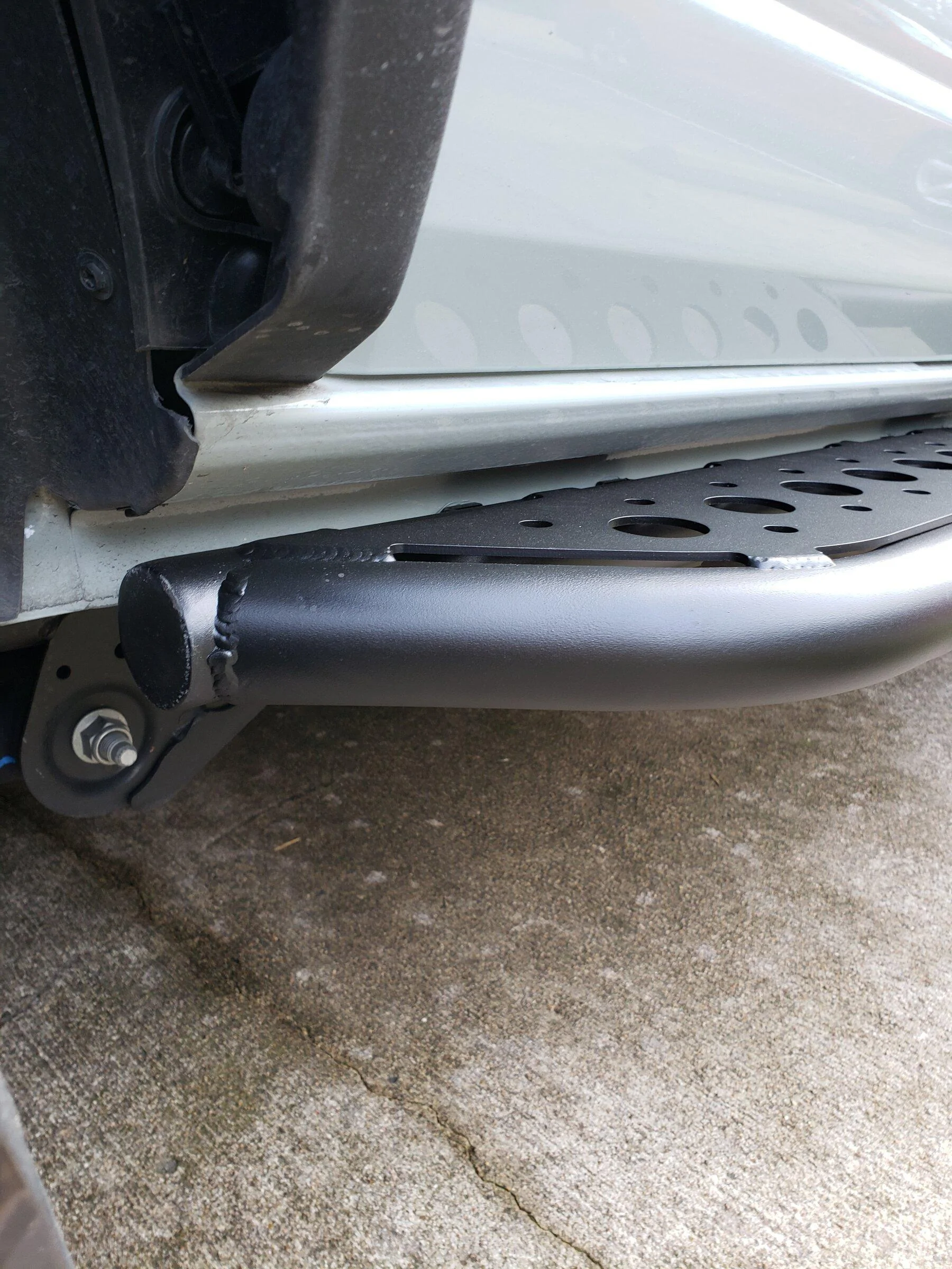

What??? So i dropped my Factory steps (WT) now that real rock rails are out. These are in my #1 #2 choice.
Are you guys saying that without factory rock rails you can't mount after market body rails?
Someone take a picture of what they're talking about.
If this is true then this sucks. Nobody should be selling rock rails that require factory rock rails in order to install.
NORCALGXP
Jul 10, 2021
71
2,101
8,250
Sacramento, California
2017 Raptor
Ford Bronco ZROADZ slider / step installed 1643128633682
Bybotie
Bybotie
Nigel
91
148
Edge ST, 2021 Mustang Mach1 HP, 2021 Bronco
The 4 door has 2 brackets that are not on the truck unless you ordered it with factory rock rails. The 2 door has 1. Pictures...
