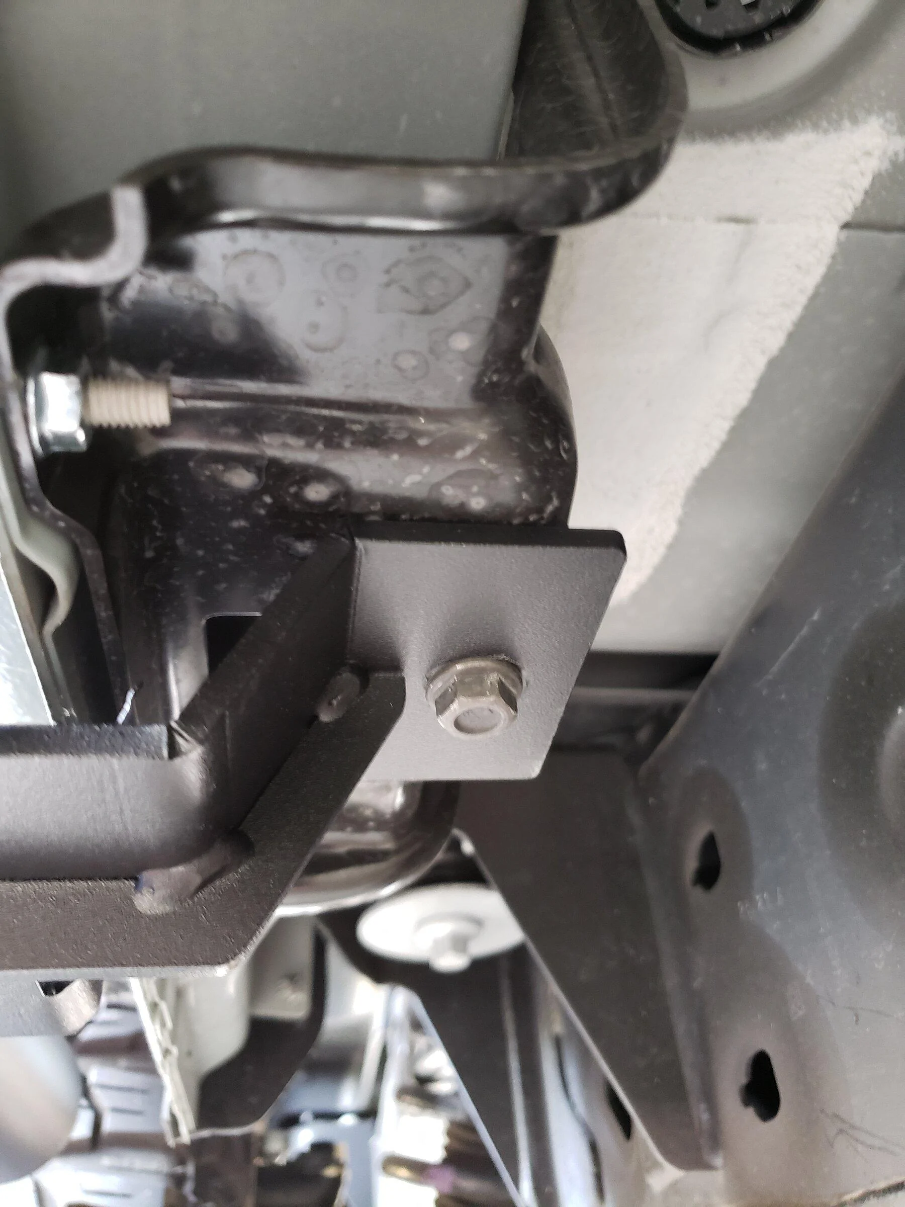

The 4 door has 2 brackets that are not on the truck unless you ordered it with factory rock rails. The 2 door has 1. Pictures...
The bolt going straight up in this picture does it go into the body?
There are 3 places(4 doors) that mount to the body/frame. The front mount bolts directly into the body, the other 2 bolt into the bracket you see. That bracket bolts to the pinch weld and the frame.
Well that sucks. Guess these are out. I haven't been reading installation instructions for all the possibilities.
I ASSumed they made use of the body bolt right behind that bracket (the vertical one with the big washer).
So looks like it different rail, or I'll have to go with the frame mounted ones.

I am posting the directions sent with the slider/steps. I still find it hard to believe you need brackets. Mine went into the pinch welds and straight into the body.
You might want to look under your truck, only the front vertical bolt goes directly into the body. The other 2 vertical bolts go into the Ford-installed brackets that your truck came with. The above picture is from my Badlands. The picture shows the Ford-installed bracket that my truck came with. If I did not have the factory-installed rack rails or steps, that bracket wouldn't be there and the Zroadz rails would not work. This is from their website:
INSTALL NOTE: 2/4 Door models NOT equipped with Factory Installed Rock Rails, Side/Tube Steps, or Running Boards require additional hardware only available through Ford Motors and is sold separately. Please contact our customer service department for additional details
I just went out and looked. You are absolutely right. The front goes into the body and the rear goes into a bracket that is there from the factory.
