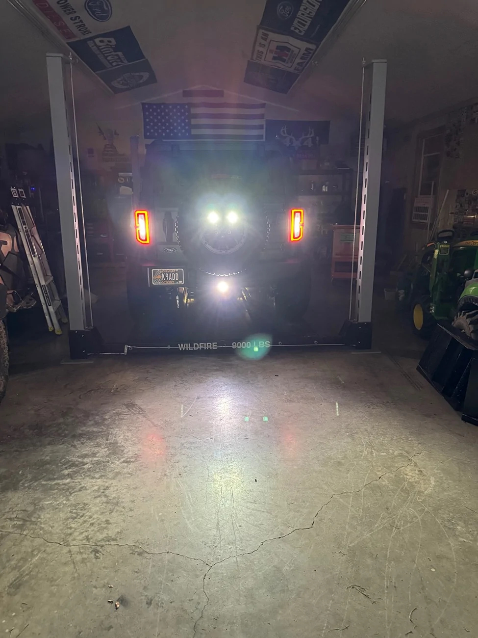

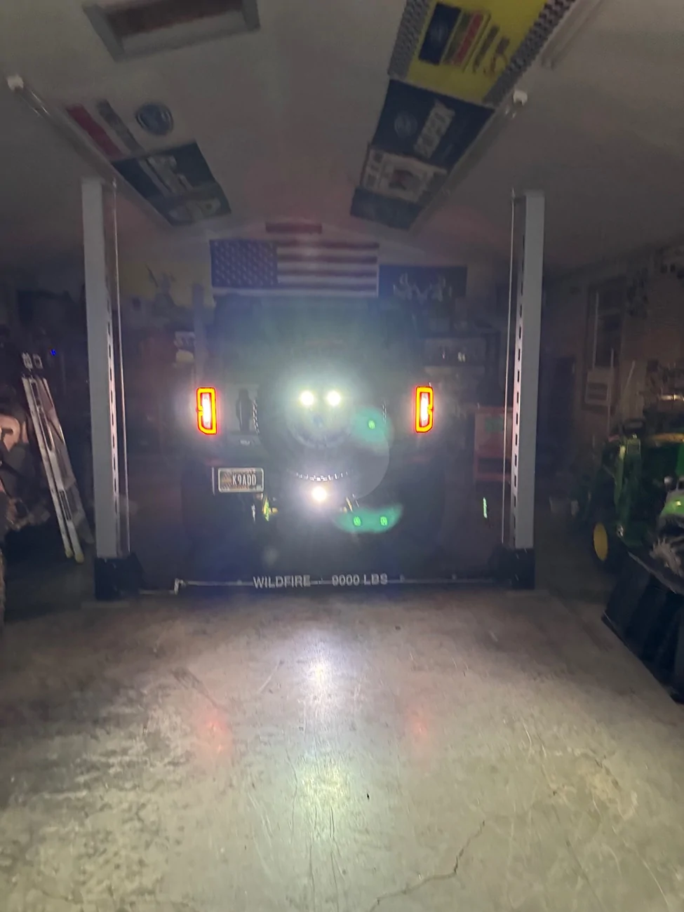

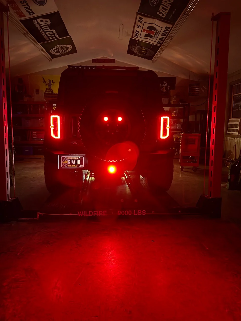

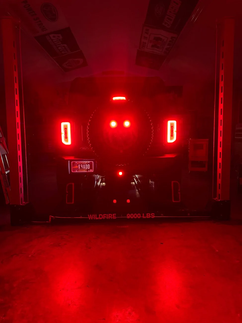

The goal was 2 Diode Dynamics C1R mounted to spare tire and a third in the hitch.

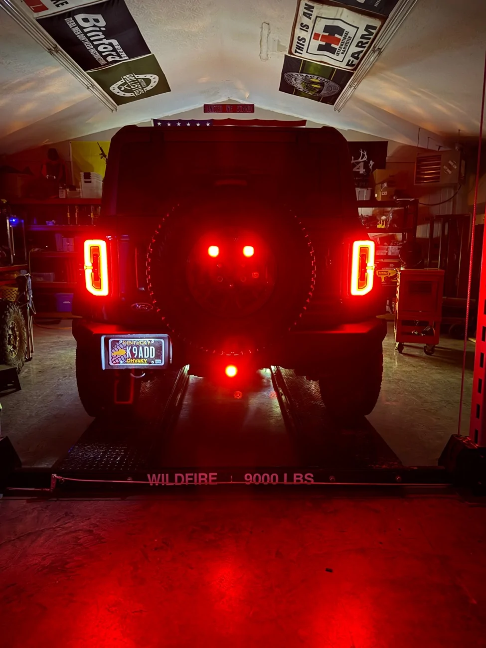

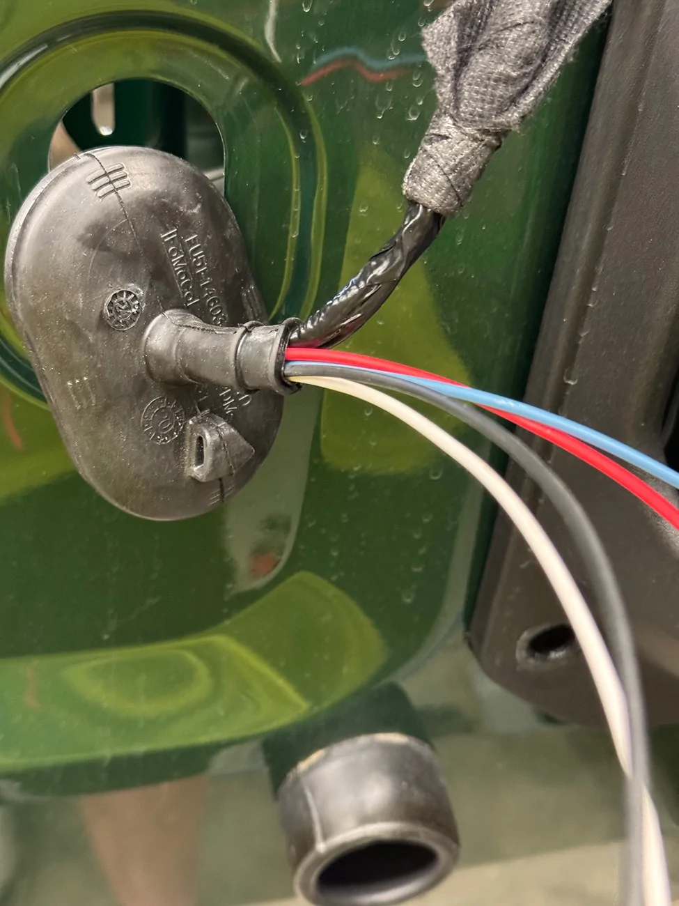

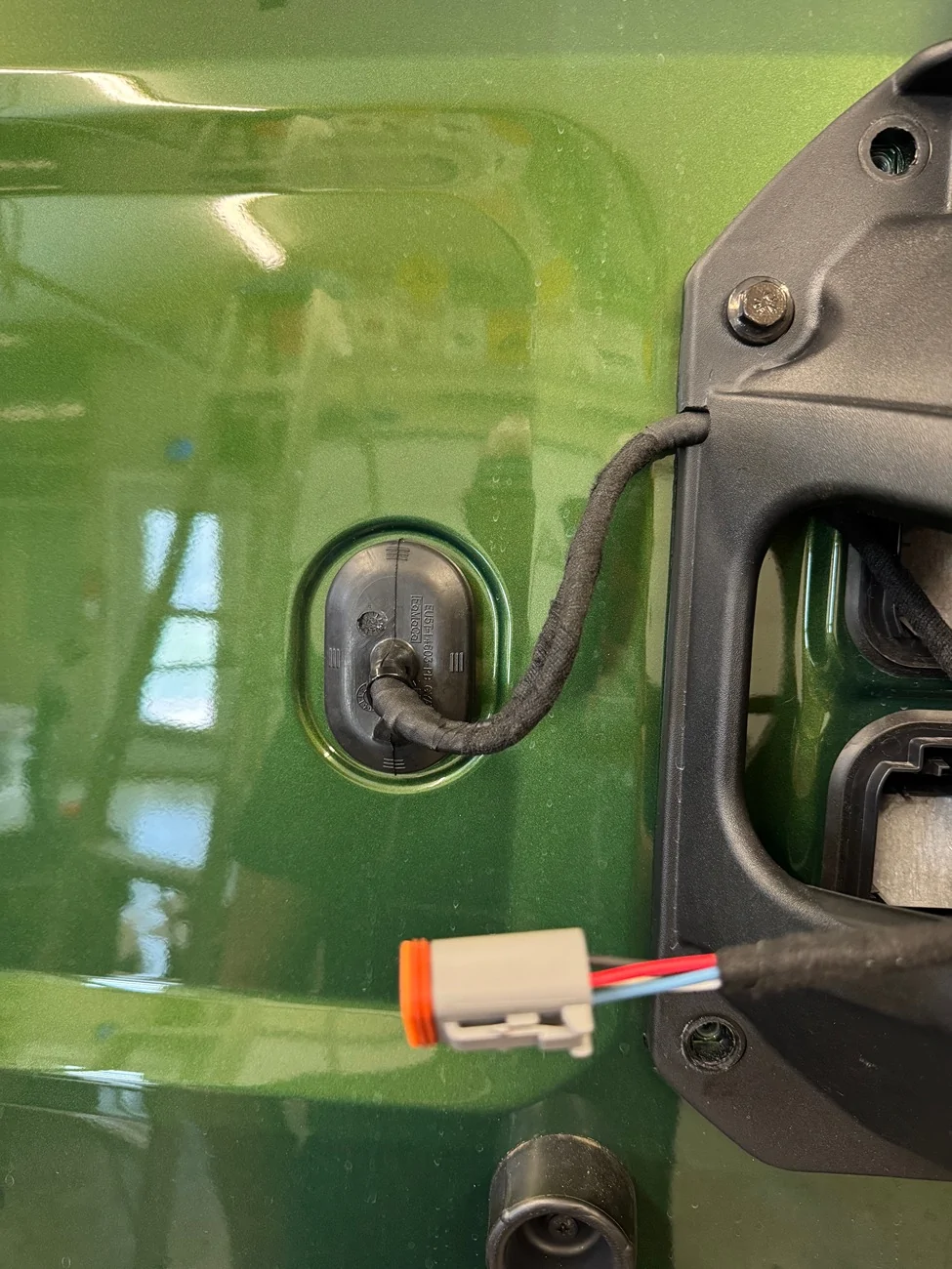

The lights on the spare do running lights, reverse lights and bright red brake. All functions are integrated with the SPV taillight adapter. In addition I can manually turn on the white with an upfitter switch.

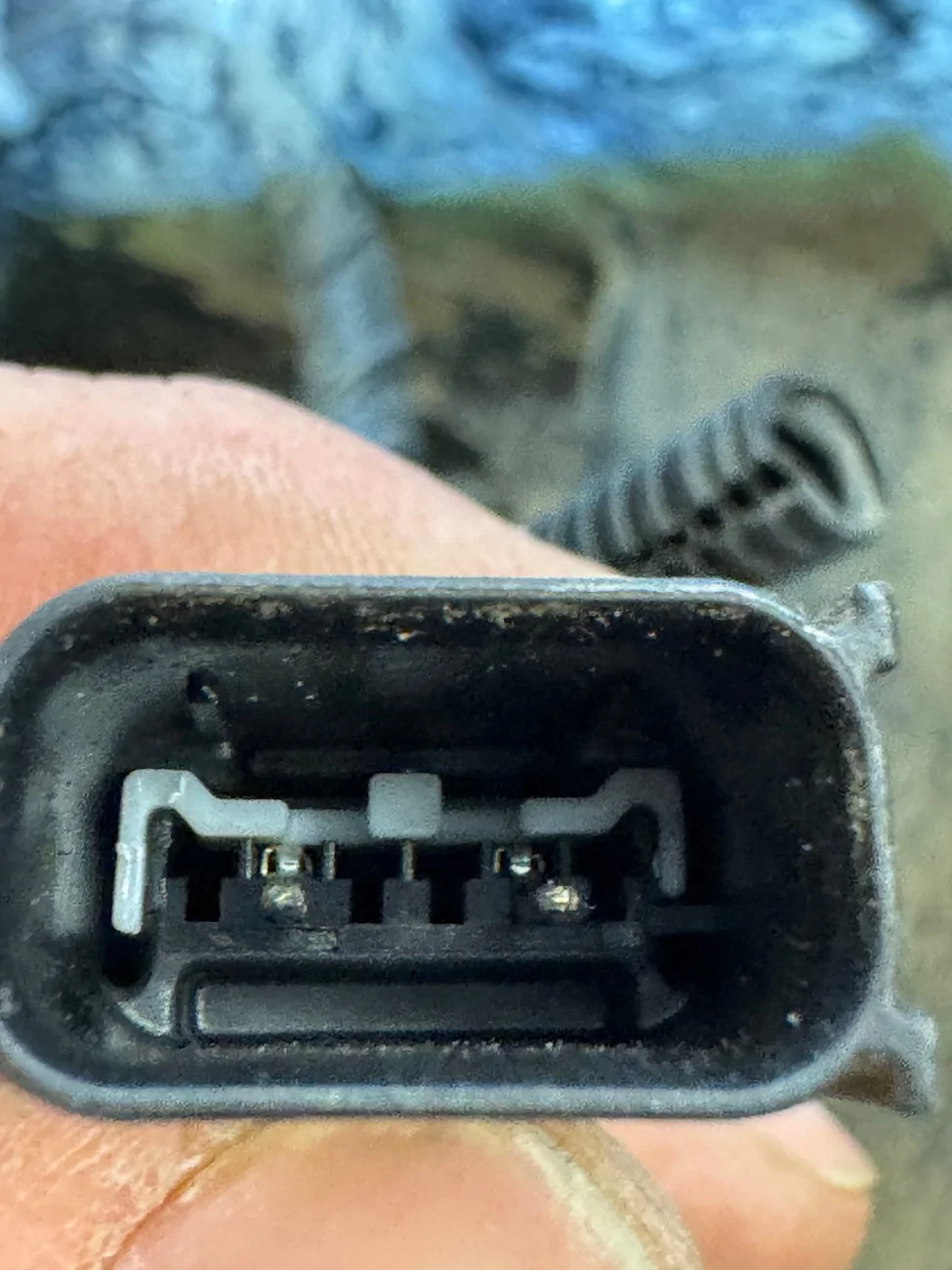

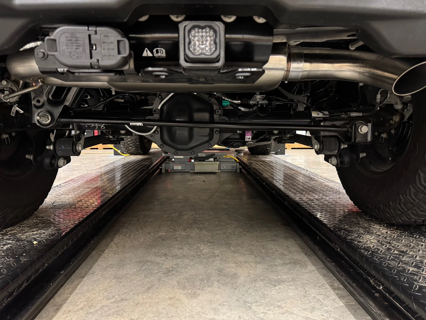

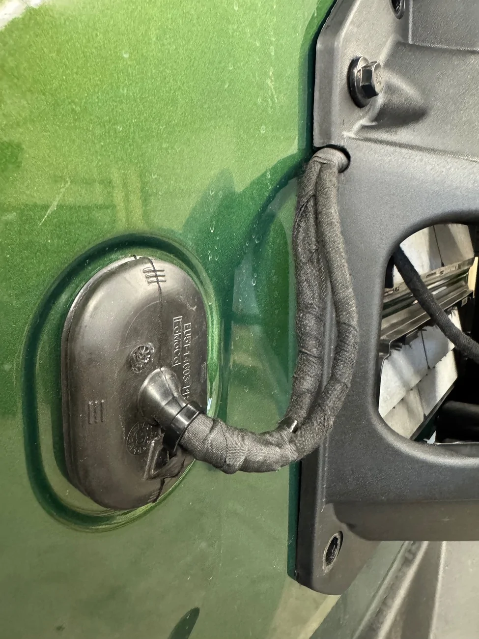

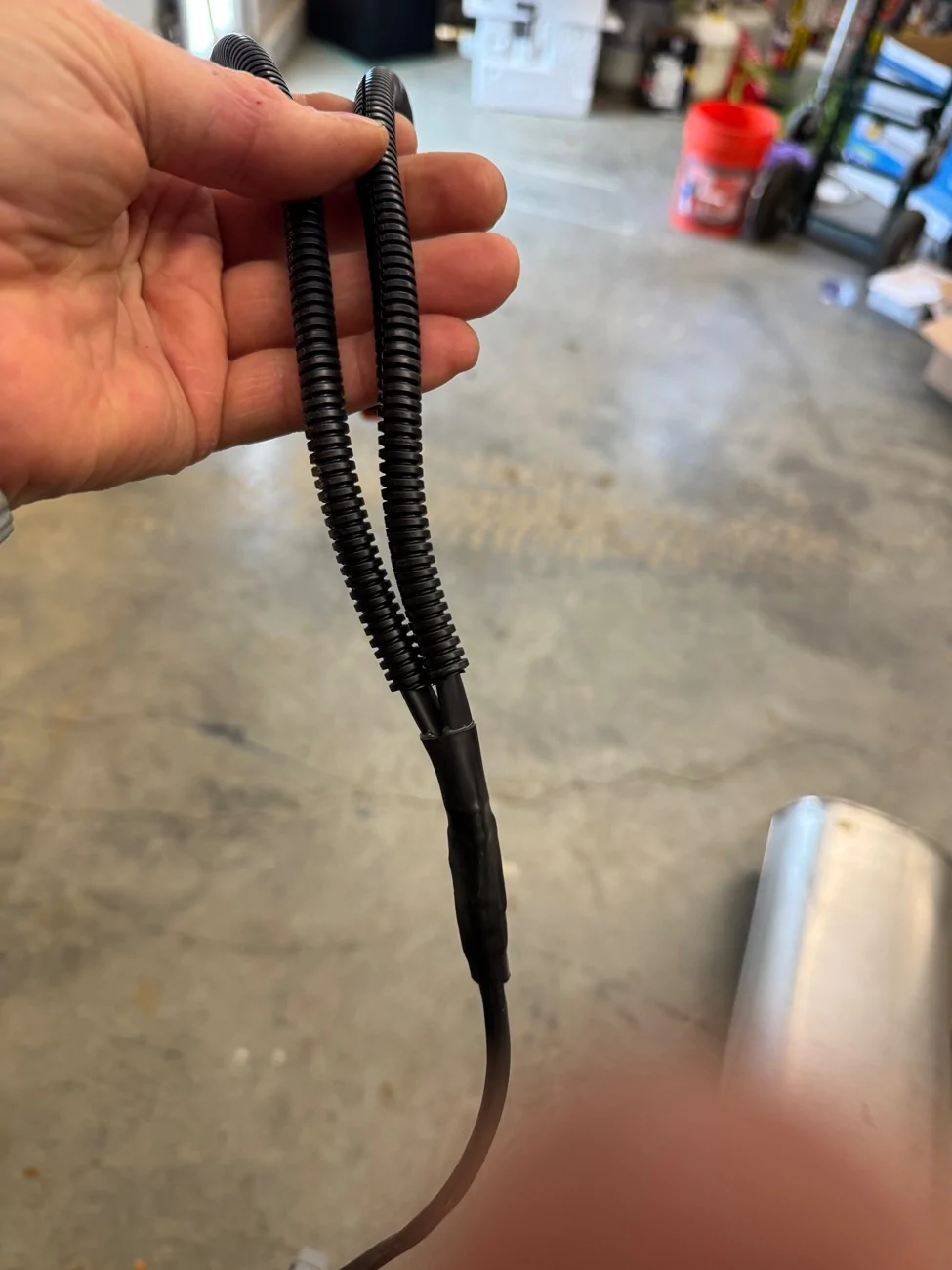

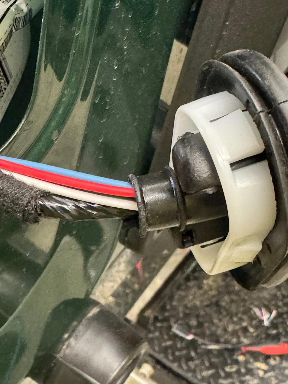

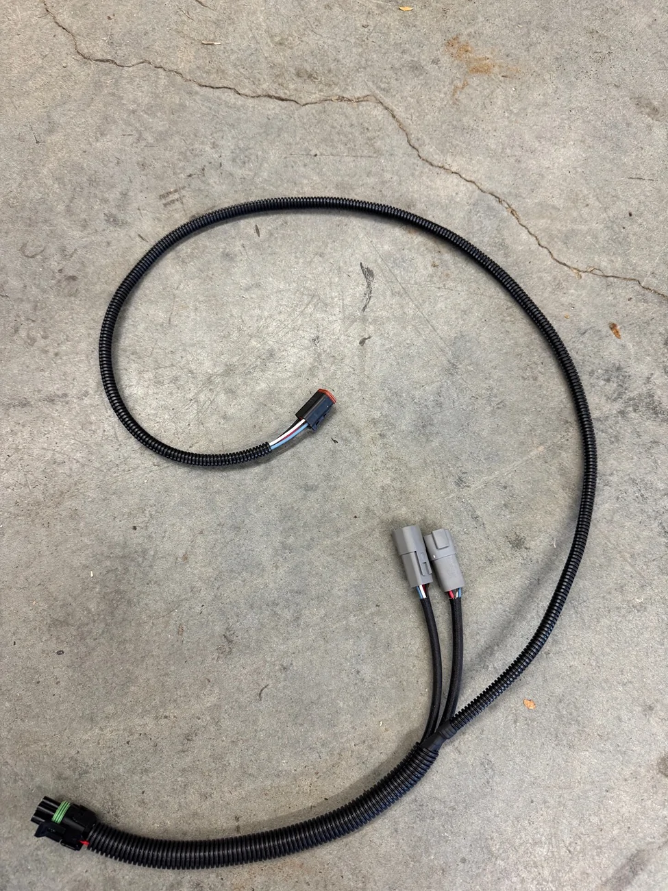

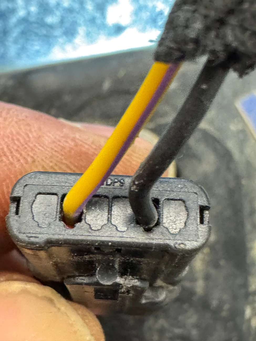

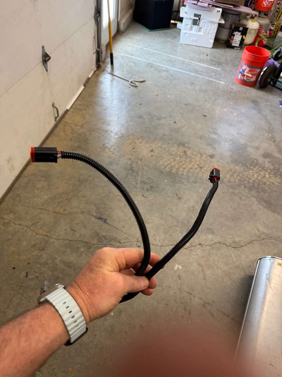

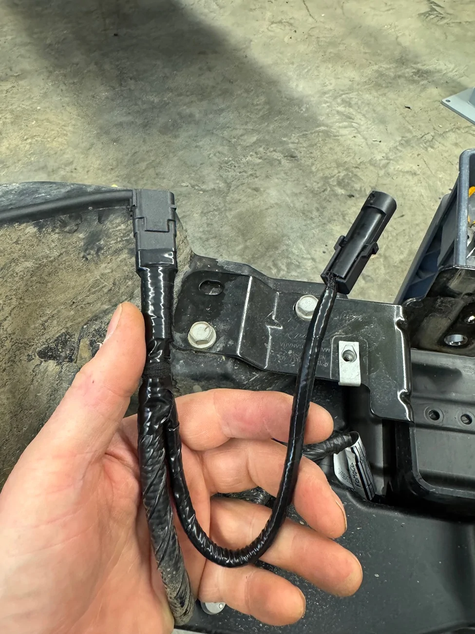

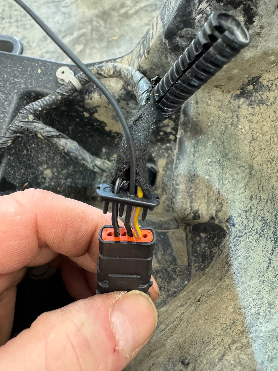

Moving on to the hitch mounted light. Its running light and reverse are tied into the tail light as well with a custom 3 way splitter I made. I added the OEM pin to slot 3 on the bumper harness which is OEM rear fog light. The bright red of the hitch light activates only with rear OEM rear fog switch.

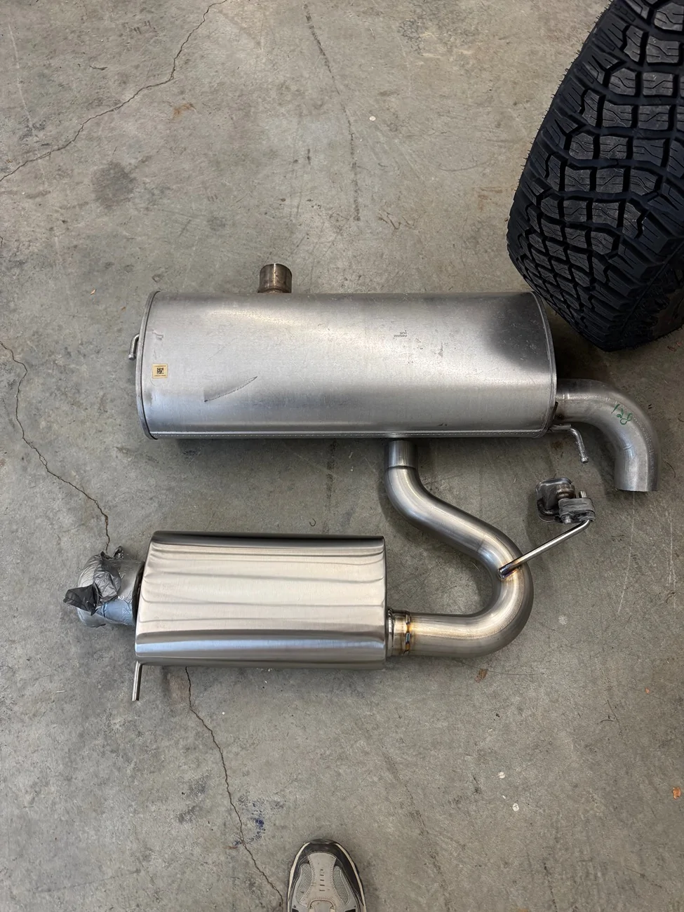

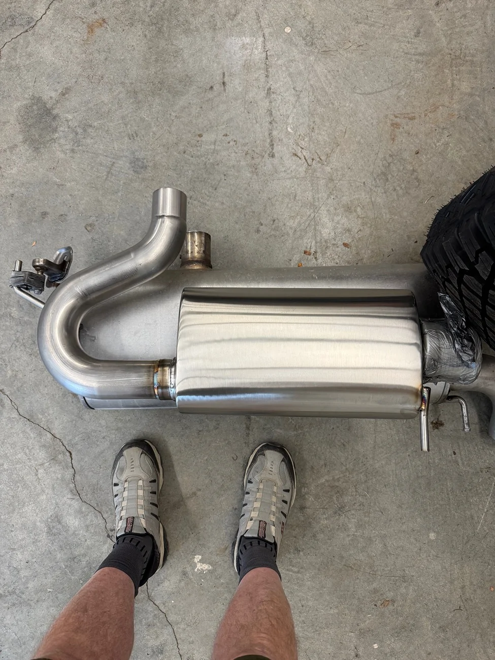

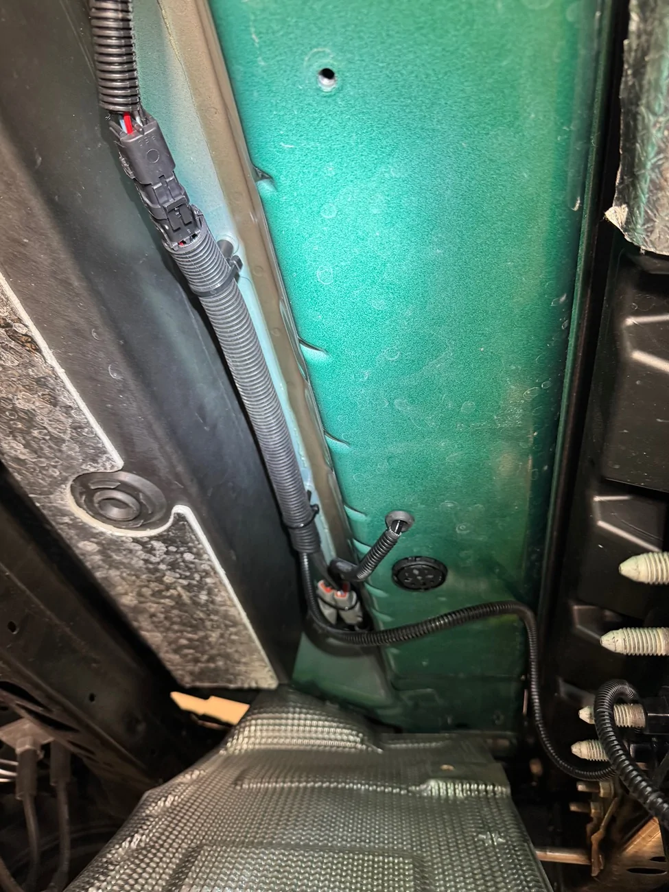

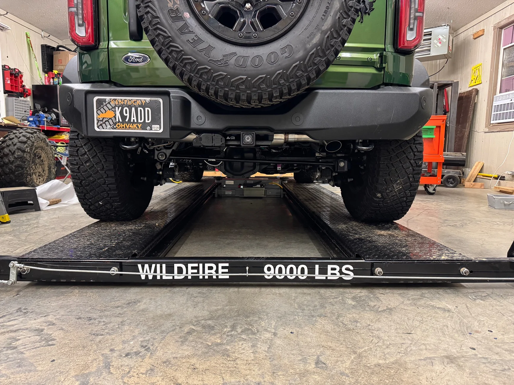

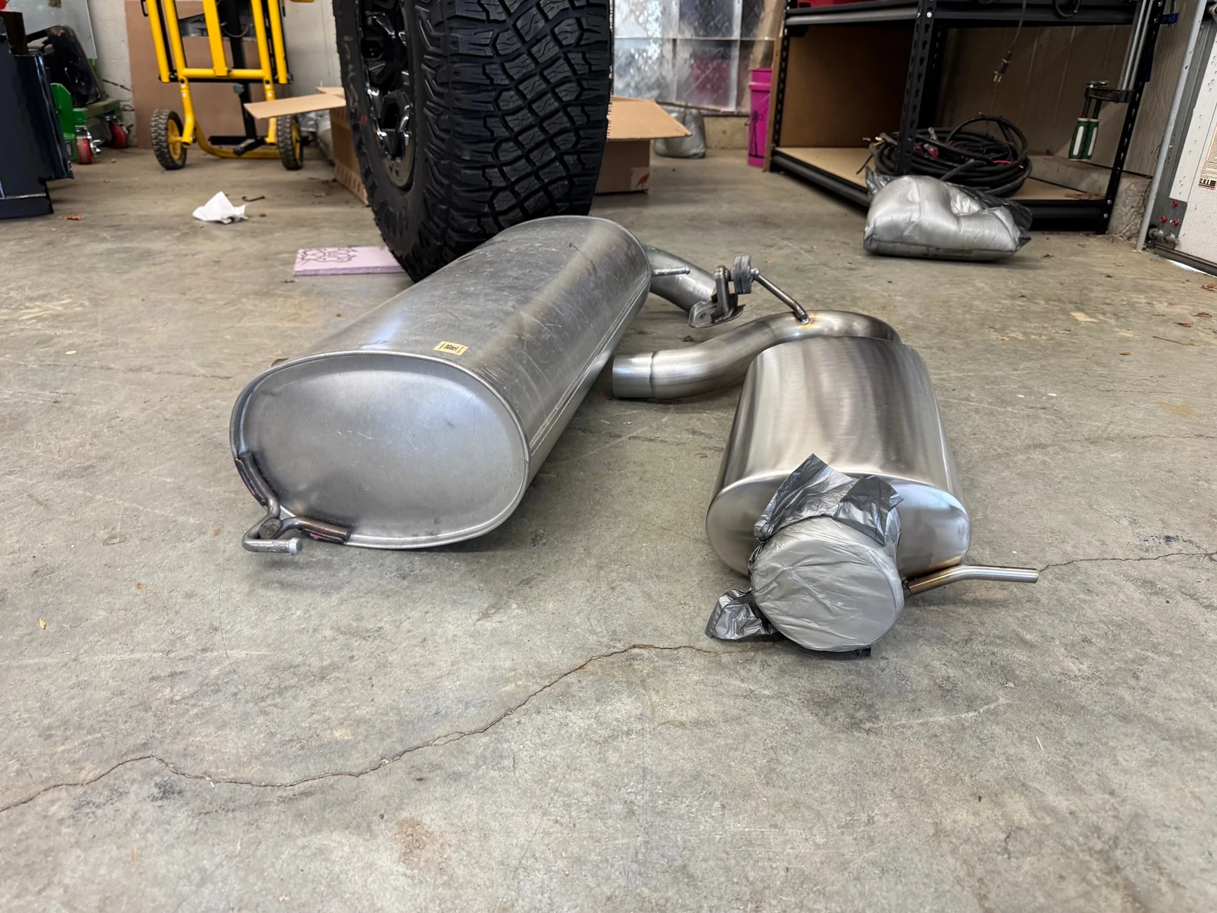

Bonus in order to hide all the wiring I dropped the OEM exhaust. Funny thing happened to when I out it back in. It morphed into a Fast Intentions Axle back. So Glad that fat pig is out from under the rear bumper.
