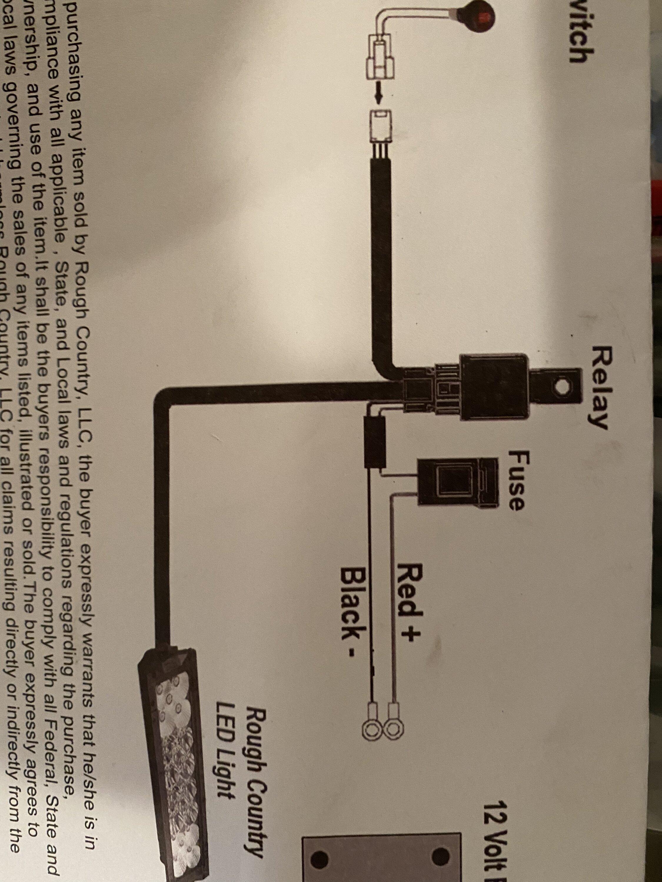

Seeking help please. How do I go about using the harness that came with the lights (see pic), has switch, relay and fuse; utilizing an Aux switch for just on/off. Thanks.

Turn the switch to on and leave it under the hood zip tied up. Ground to a bolt under the hood (there are several to choose from)red to the aux wire you want to utilize.

Thanks I'll give it a go. I take it the black/ground and the relay can go to the same bolt? Then the red that goes to the battery goes to the Aux wire. No need to cut any wire?

Correct. Only need to cut the wires if you don’t like how long they are

Thanks! Worked like a charm.
