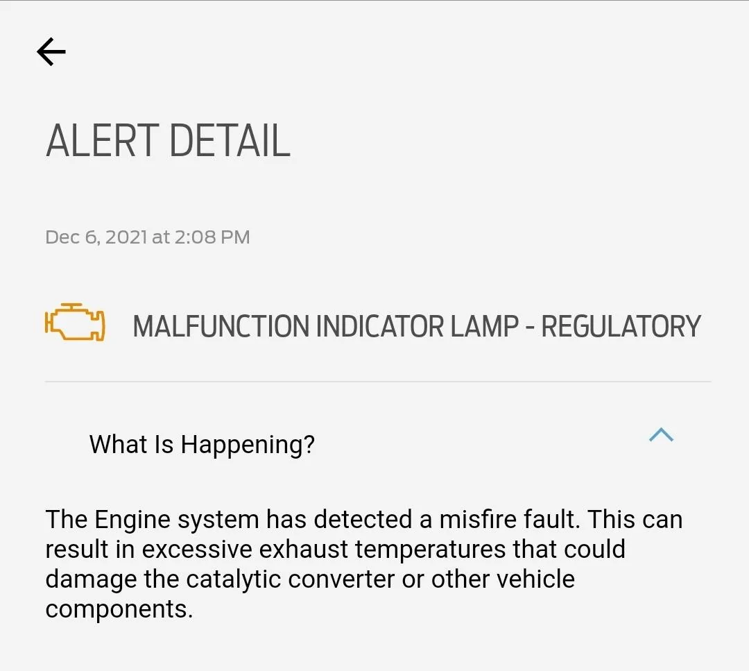

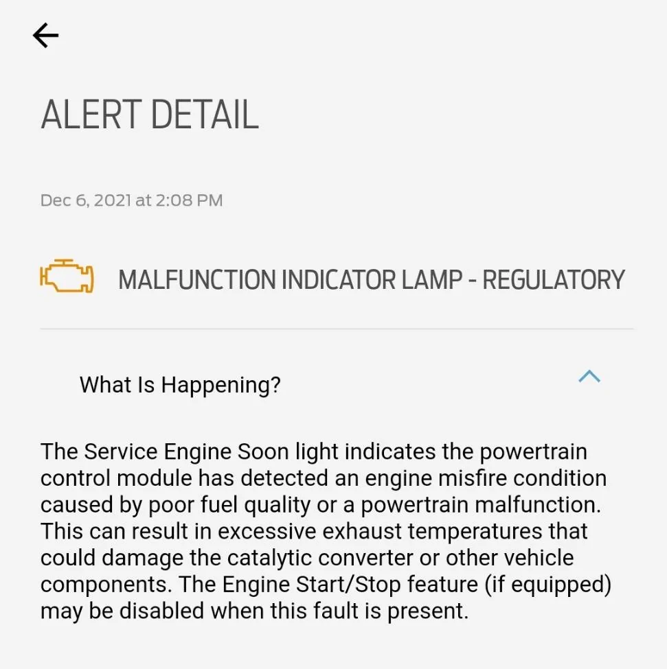

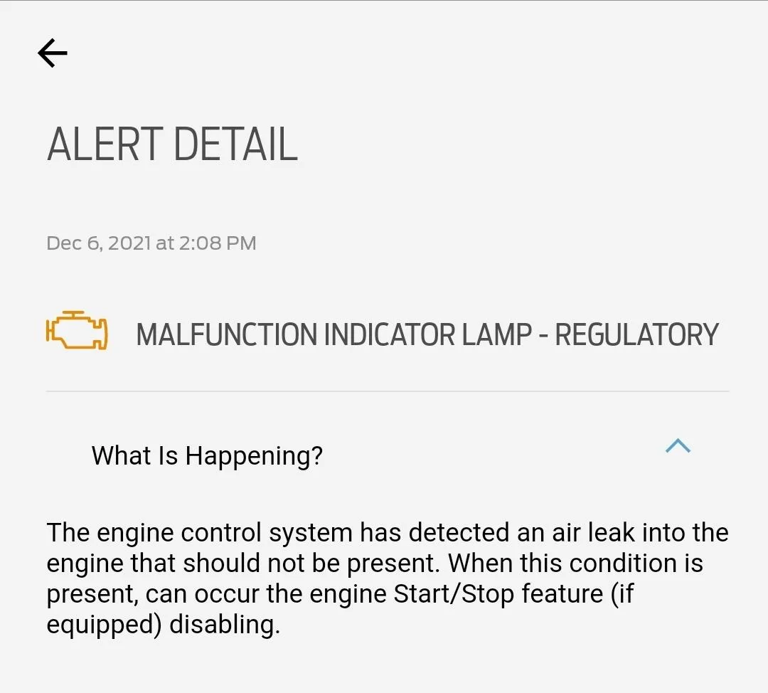

This is the best I can do for information. Vehicle had problems after excelerating onto the freeway. It felt as if the engine was shaking the whole vehicle when you applied any sort of pressure to the gas pedal. This happened on 12/4/21 and it is still in the shop. They have the engine in, but are waiting on a few smaller parts - gaskets and valves were mentioned by a Ford rep. Really unfortunate that this has been such a big problem after everyone talked up the 2.7L and continually said it was the better engine for the long run. I also have a 2.3L that I rent out. The 2.3L has twice as many miles and has not had a single issue to date - purchased off lot on 8/11/21.
Took delivery of 2.7L Badlands on 10/13/21
3,581 miles at time of breakdown
VIN: 1FMEE5DP3MLA85962
Excellent data... And the misfire was certainly something that I was looking for (as well as the air leak) which could be a lean misfire condition.

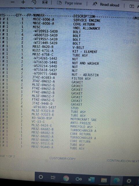

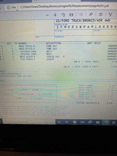

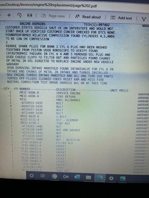

So finally, after 6 1/2 weeks in the dealership, they finished swapping out the engine in my Bronco. I was able to talk to the mechanic that worked on the Bronco...super nice guy that was actually kind of excited he got to swap out the engine. He did a great job getting the hood lined up straight, and I haven't found any scuffs, dings, or scratches. The interior door panel and floor mat are pretty grungy, but they should clean up okay. Of course the exterior is filthy from sitting in the shop, or outside in the weather, for this long.
Mpeugeot, I have attached a picture of the new engine build number as well as the invoice from the dealership. Based on what the mechanic told me, and what I read on this invoice......I think it's a valve issue! Hope this information helps.

A replacement oil cooler for a dropped valve? Hmmm, sounds like detonation more than a dropped valve. A dropped valve would not corrupt the entire oil system... A destroyed rod bearing from detonation on the other hand... Well.
It could also be Ford just being cautious. Also, is there a separate oil cooler on the Bronco?
One picture posted here appeared to show a hole in the piston which could certainly put metal in the oil. I am very glad they're replacing the oil cooler, and I see turbos on the list below so it appears they're replacing everything in the oil circulation path. I guess a busted piston could be a dropped valve or extreme detonation so that's not conclusive but I'm glad they're replacing all those parts, even if it means waiting on them.

It's good to see turbos on that list!

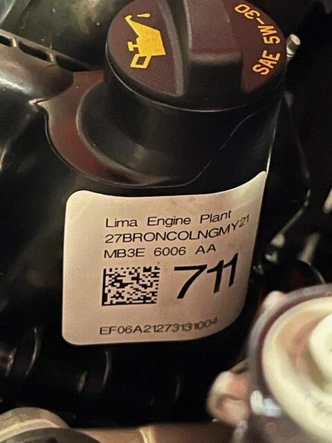

I want to know what the difference is between the 6006 engine and the 6007 engine.
U mean the basic #? Ford uses a couple different basic numbers for engine assy, depending on how complete they are when shipped. 6010 would be a bare longblock. Otherwise they should be the same, or a supersession
