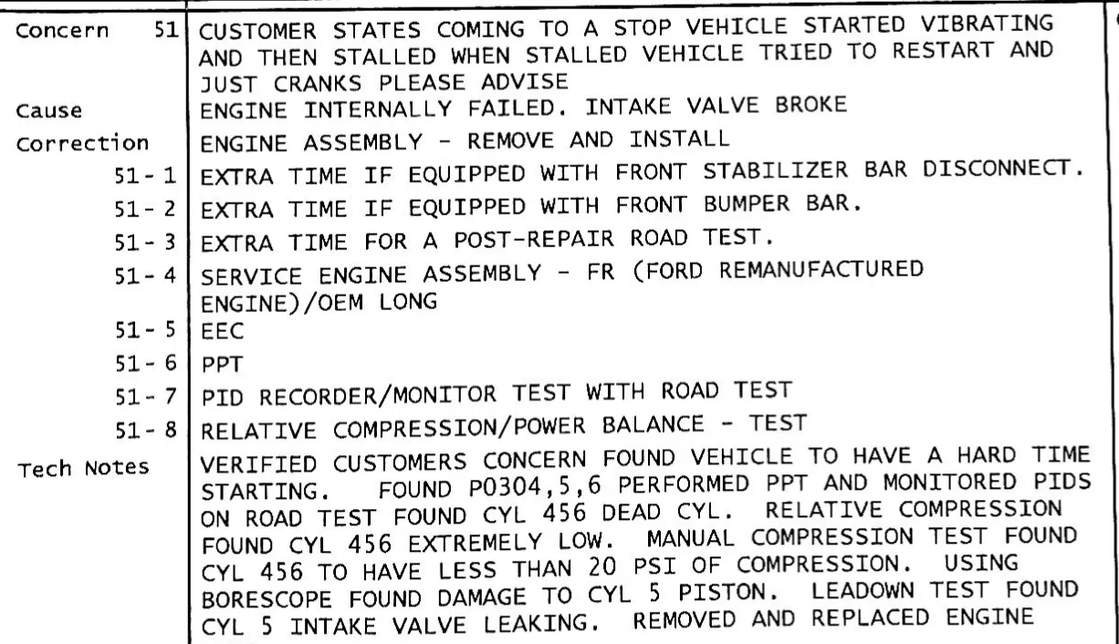

Here are the details on my Failed 2.7 from Dec. 5th. Here is an update on the replacement:
- Dec. 15th replacement engine received by dealership
- Dec. 20th required Gaskets and bolts on backorder so replacement installation on hold
- Jan.10th still waiting on 4 bolts on backorder to proceed with the engine replacement
UPDATE: Jan. 28th. Engine replacement completed by Ford of Clermont, FL
User: TODDGINGA
Failed Part Number: MB3E-6007-AA
Engine Julian Date: 21224
Engine Sequence Number: 120196
Mileage of failed motor: 1358
UPDATED (02/02/22)
Cause of failure: diagnosed as internal damage, Confirmed: Cylinder 5 Intake valve broke
Replacement Part Number: MB3E-6006-AA
New Engine Julian Date: 21274
New Engine Sequence Number: 130883
Here is the Service order write up:

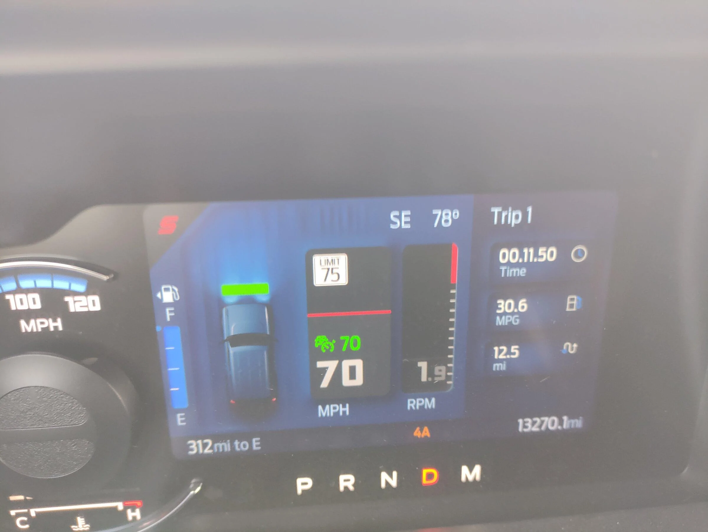

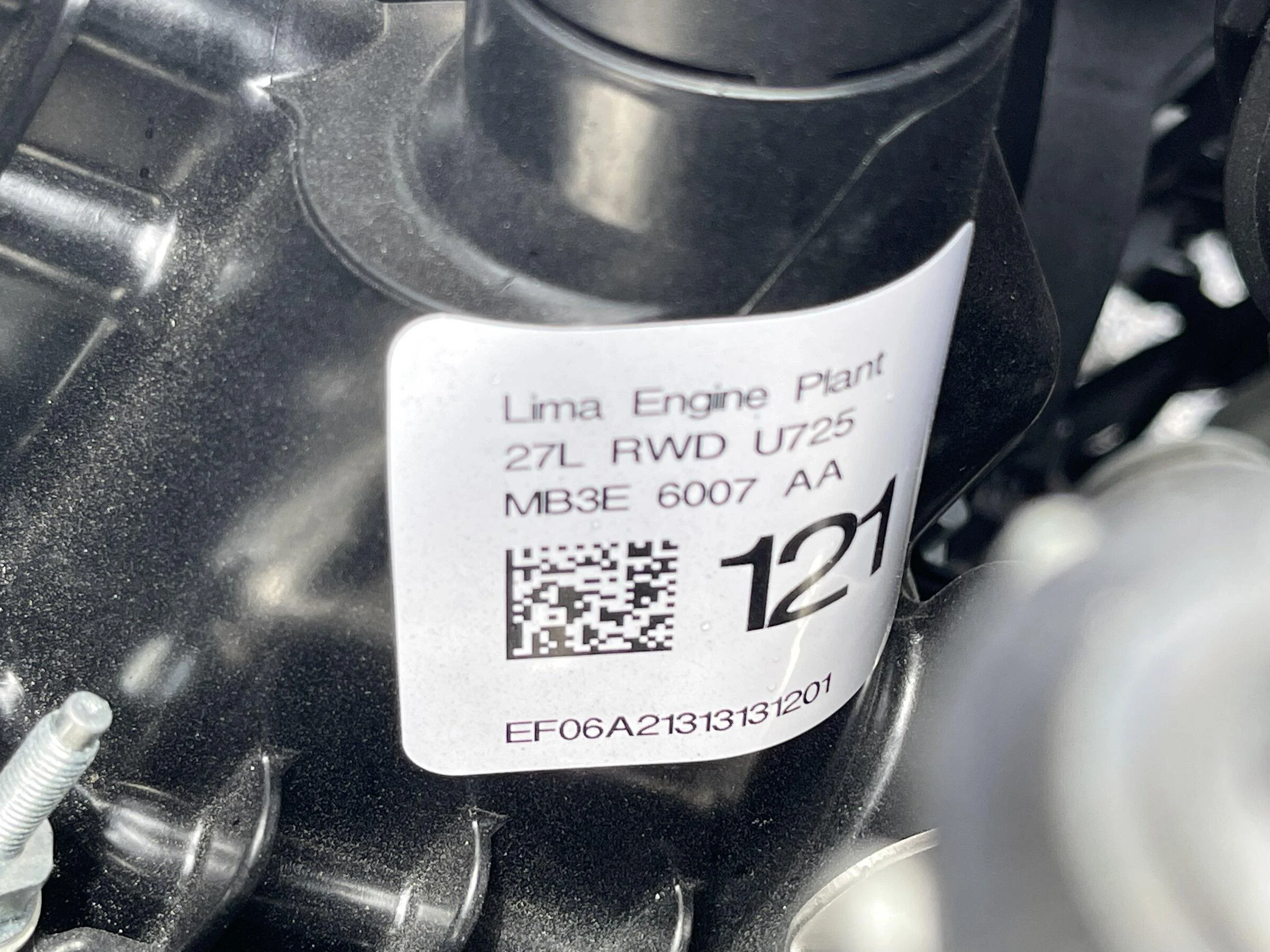

Mileage doesn't guarantee anything, the build date is more important. With a 21313 motor, you aren't in the danger zone. My 21180 on the other hand is... but still not predictable at all.
Ford Bronco 2.7 engine failure tracking thread - Ford Please! IMG_20220413_151749
Over 13k miles, but don't know whether or not to trust it.
