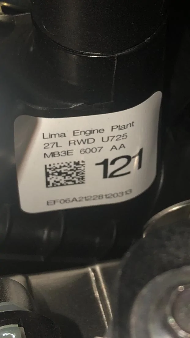

I have a 21228 with 8700 miles. So, clearly there were engines built in the 21228-21266 timeframe.

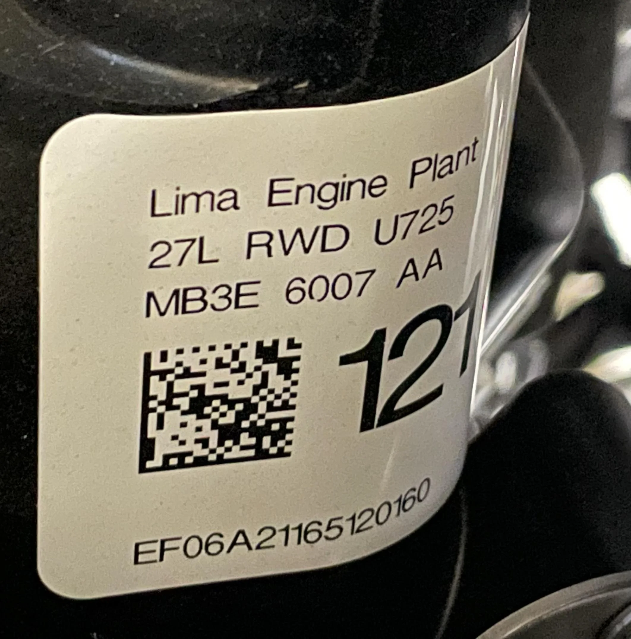

I've got an 21214 131135. 2,450 miles. When is it going to blow up? I've got places to be and need to plan for this, if it is likely to happen.
