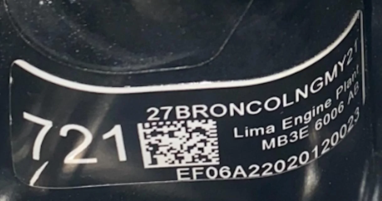

new engine....the sticker is black
FINALLY....we know. It was those white stickers causing the 2.7 to grenade. Should be cheap enough for Ford to change mine out.

Update . . new engine label . . -AB and built in '22
Wow ! !
- you got rev -AB w the new head assemblies
- '22 engine build-date (Jan 20) - ebd 22020
- looks all the latest in this replacement
Ford needs to do something like this for a few thousand owners in ebd 'hot zones', and current blown engine survivors
- 'Replacement Campaign', 'Recall' - whatever they want to call it
To motivate Ford, the best way is file more NHTSA reports
- so far they only have 13 Engine Reports - at least eleven are B6g members in OP list
Ford Bronco 2.7L blown engine failure list . . 68 so far [Updated: December 13, 2022] JollyFolly -AB repl - ebd 22020
[/QUOTE]
A
Wow ! !
Has it been confirmed that the AB revision included updated heads that are not prone to valve failure?

No...all we DO know is that -AB engines started w/22 MY, and none have failed to date. Now we know that a 21 can be updated w/a -AB engine...sure was gonna happen at some point!
