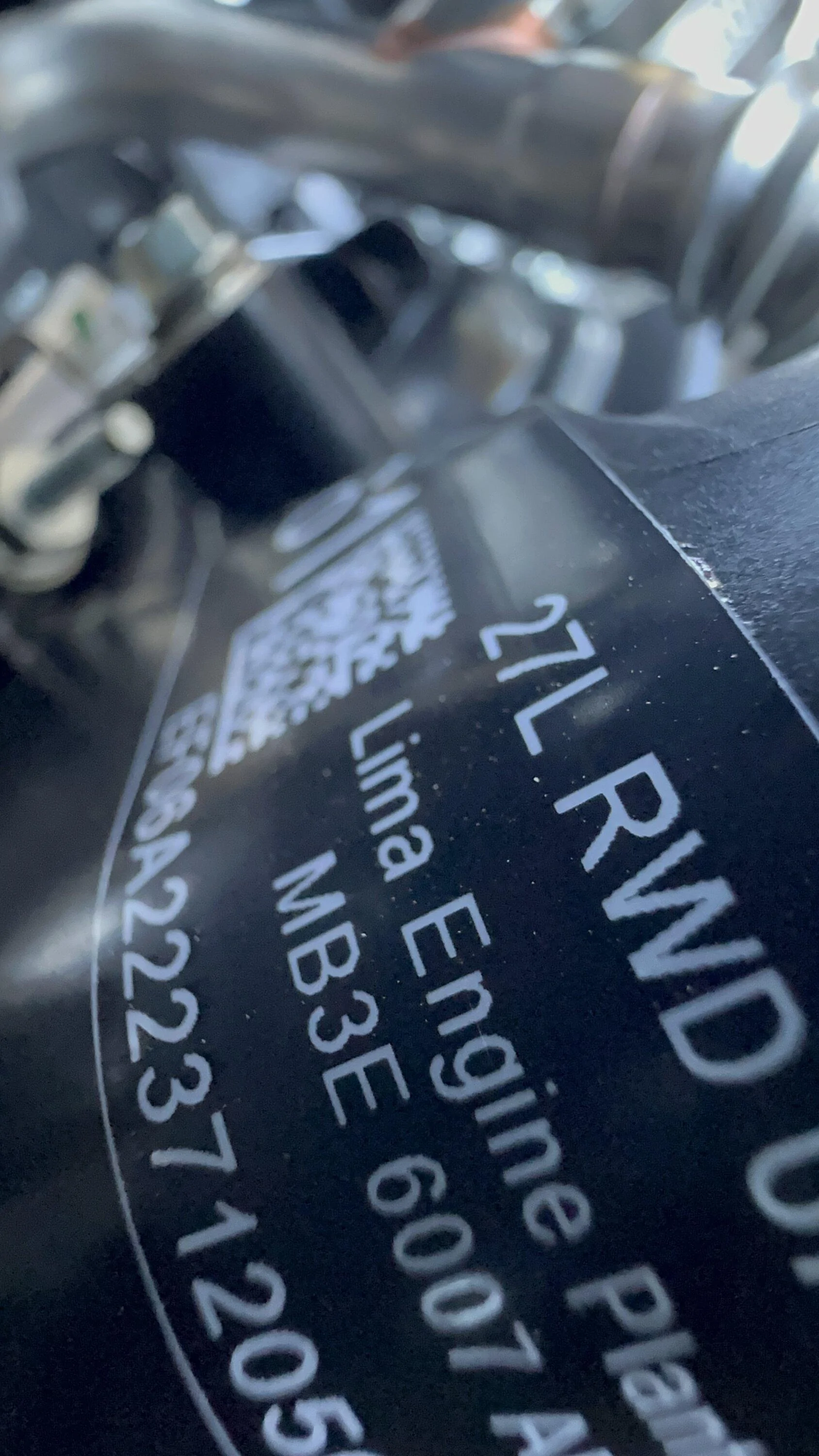

Are November 21 build dates still in the clear my engine was built nov 19
