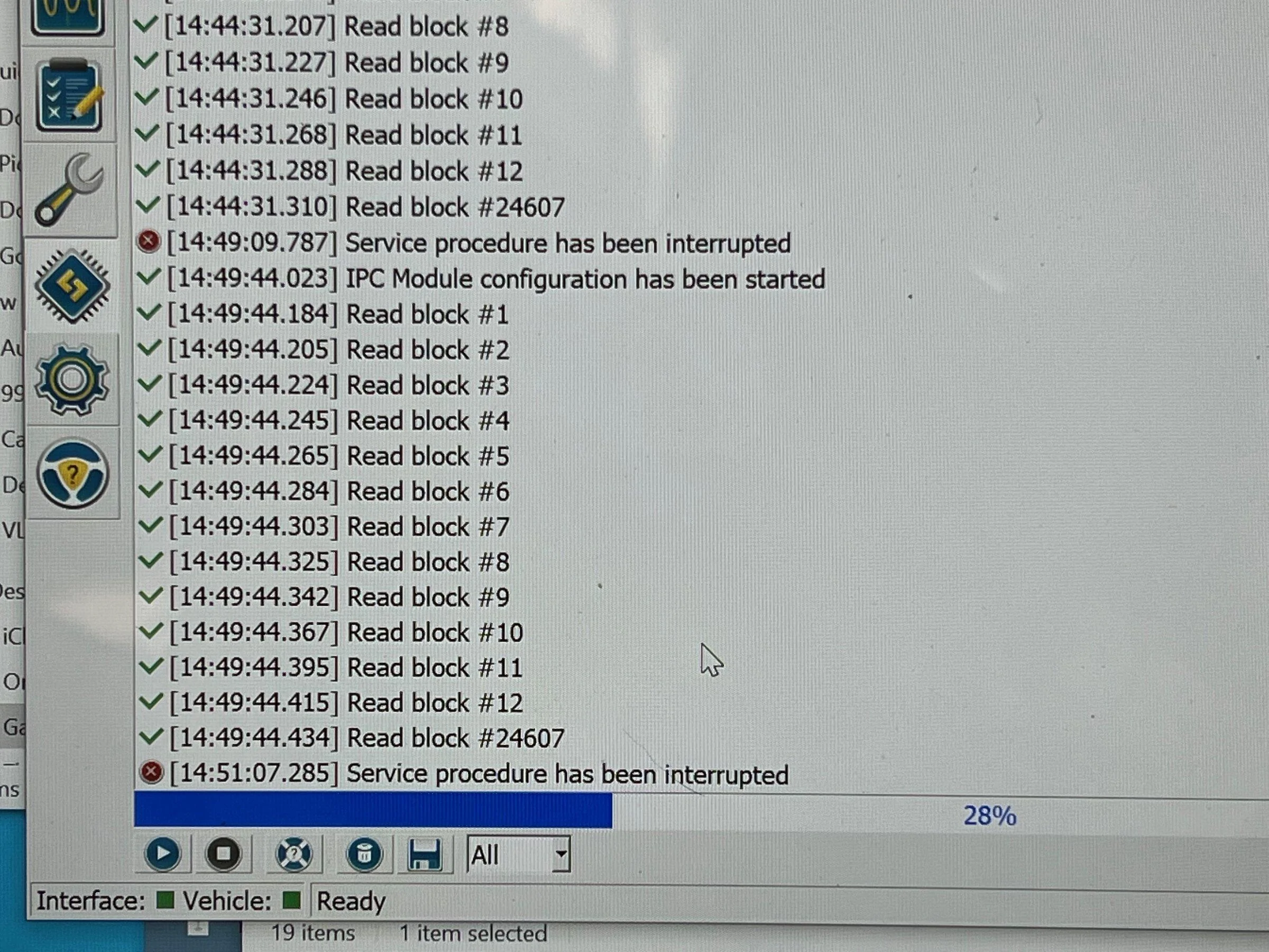

OK writing changes BdyCM module,
Error writing changes to IPC module
Tried both OBDLink EX and Vgate vLinker FS
I have a 2022 Bronco, I have had no issue using Forscan for any procedure with the exception of writing to the PSCM module. When I try to write to it I get the same "service procedure has been interrupted" error. I am not sure why I get that error only to the PSCM module. I am using version 2.3.48
Same here. Something must have changed somewhere. I think I'm going to see about buying the auto stop/start eliminator.
Or you can wait for the next release of Forscan, supposedly it’s fixed (this is based on feedback from others who have received a beta version).
I just downloaded and tried the 2.4.6 beta and no glory. Surely this change is not dependent on an earlier beta..? I think I'm about to buy the ass eliminator.
I meant for the official (Windows) released version. 2.3.48 was released back in June; based on the timing of previous releases it shouldn’t be too long before they update to .49, which supposedly will work for us. There is another thread in here where someone mentioned they were sent a link to a pre-release of 49 and it resolved the problem.
Yes, I saw that -- my point was you'd think a much later beta would incorporate the same changes made in 2.3.49...?
Thank you, I will wait or try to source the 2.3.49 version.
