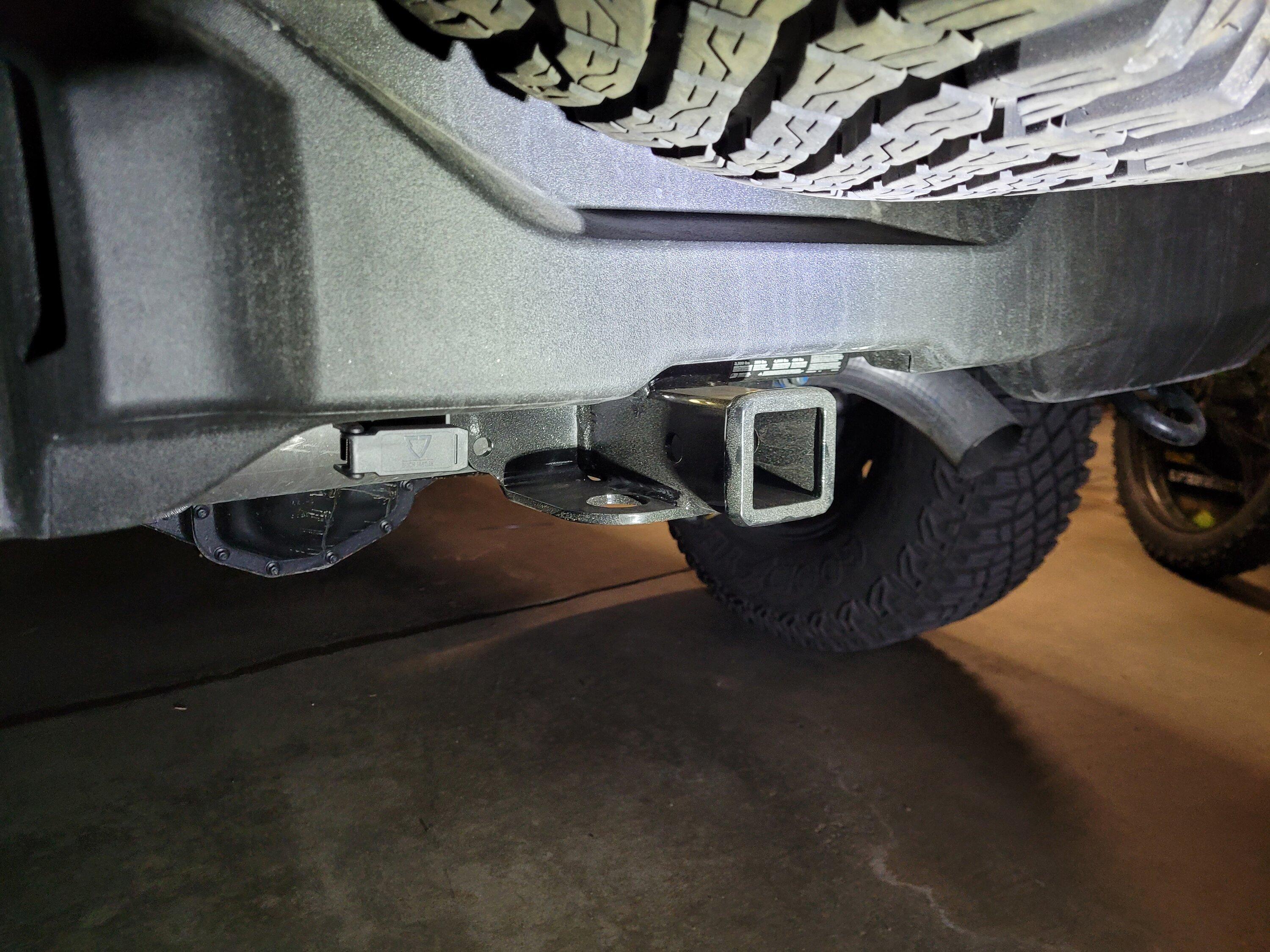

Installed the CURT Tow Receiver and Wire Harness yesterday, was kind of a spiderweb of wires to cram in that little area in behind the drivers tail light. Also added a HD Electrical Connector so I didn't have the trailer wires hanging.

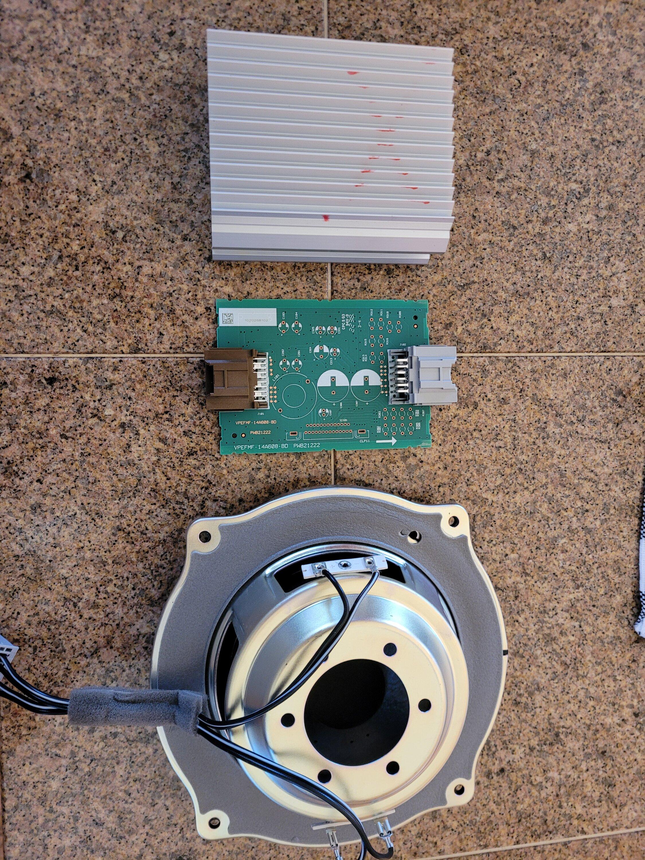

Had some extra time after tow install so started the Sub Install by pulling the side panel and sub box out. I did have the empty AMP with RED X and no magnet Sub.

To fit the Kicker sub in the OEM box I will need to trim off about a half inch circle, the Kicker is WAY beefer than the OEM.
Ford Bronco 2023 2-Door Base FakeSquatch build Bronco OEM Sub Box
Ford Bronco 2023 2-Door Base FakeSquatch build KIcker Sub

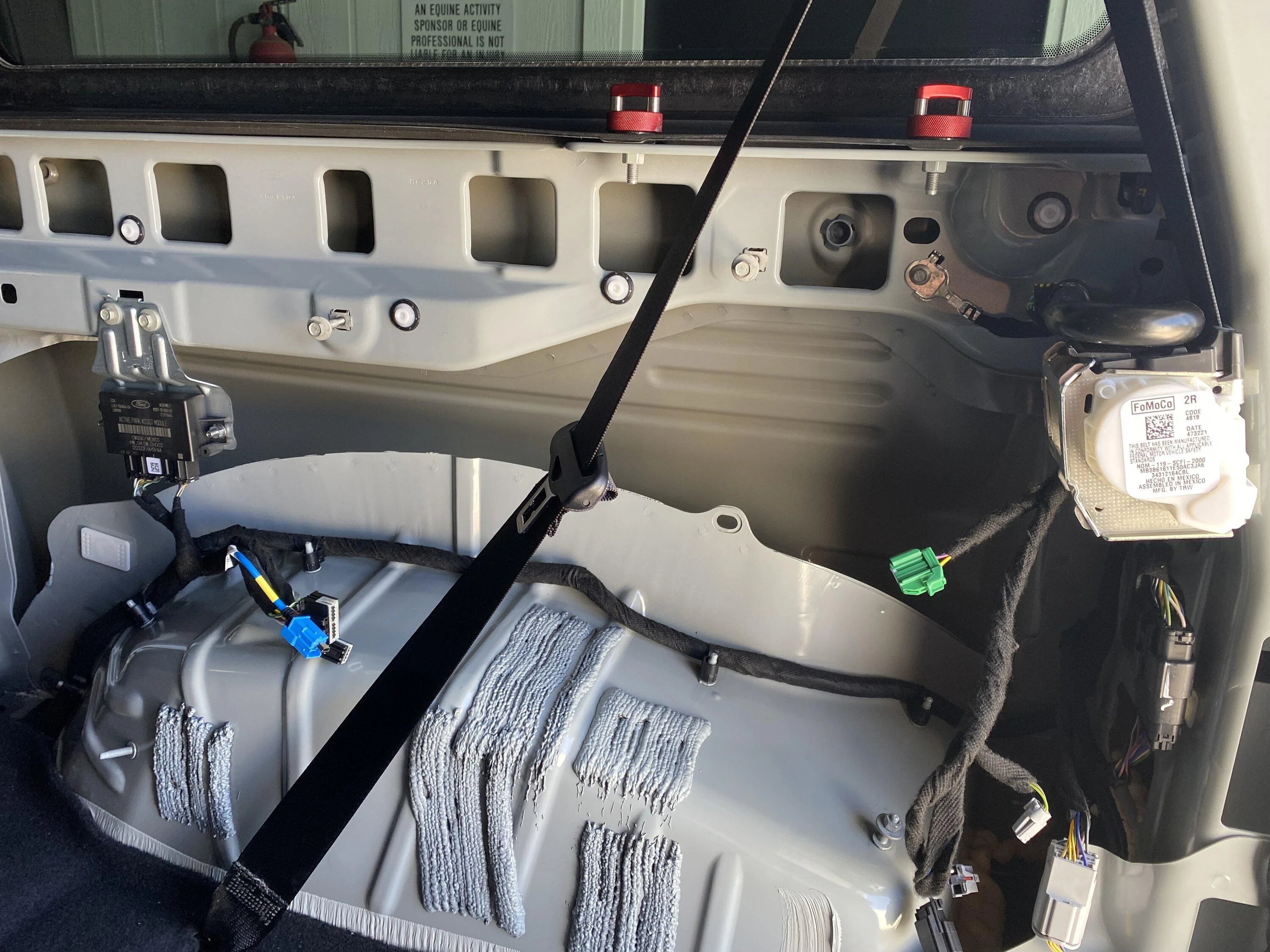

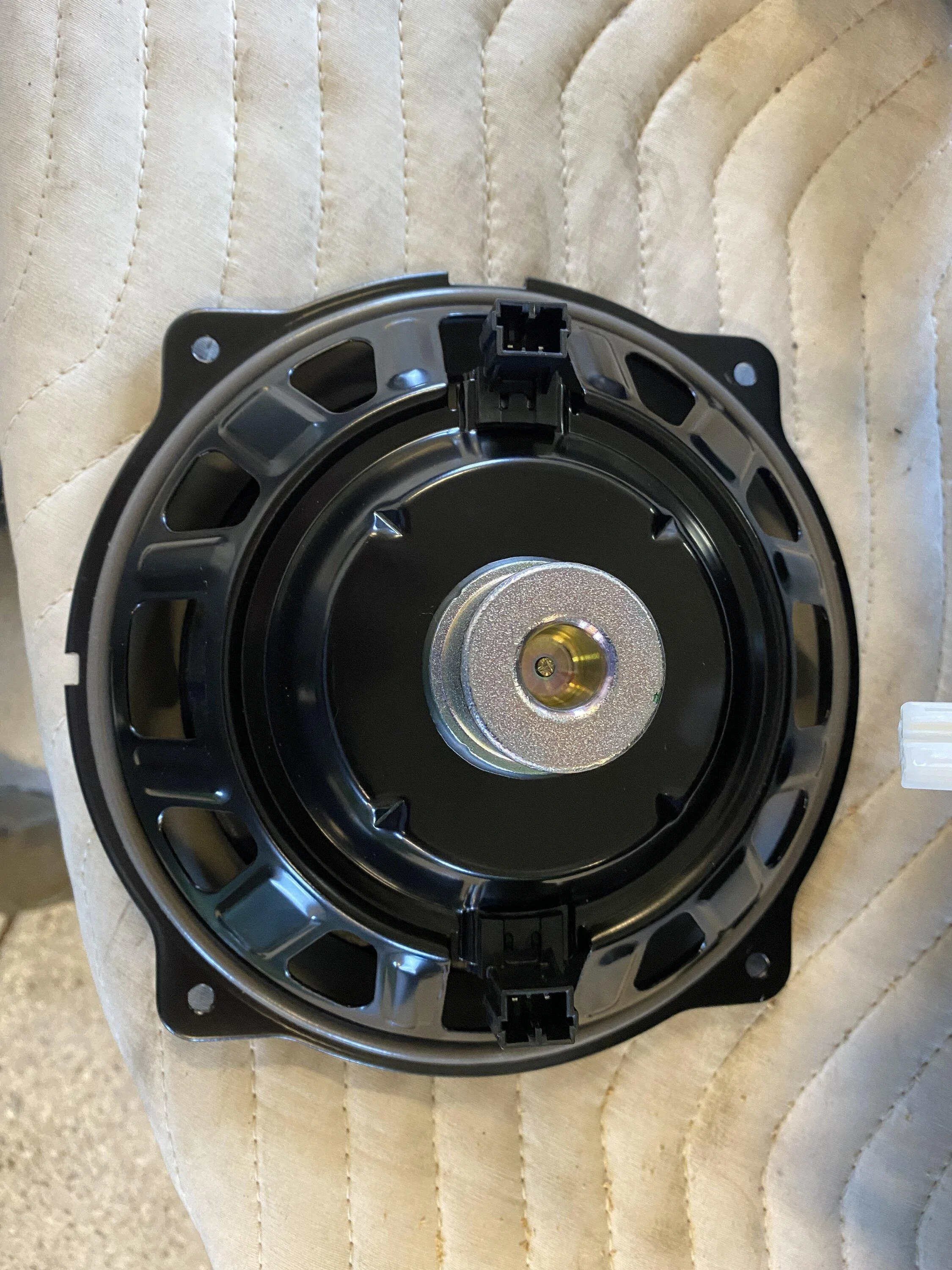

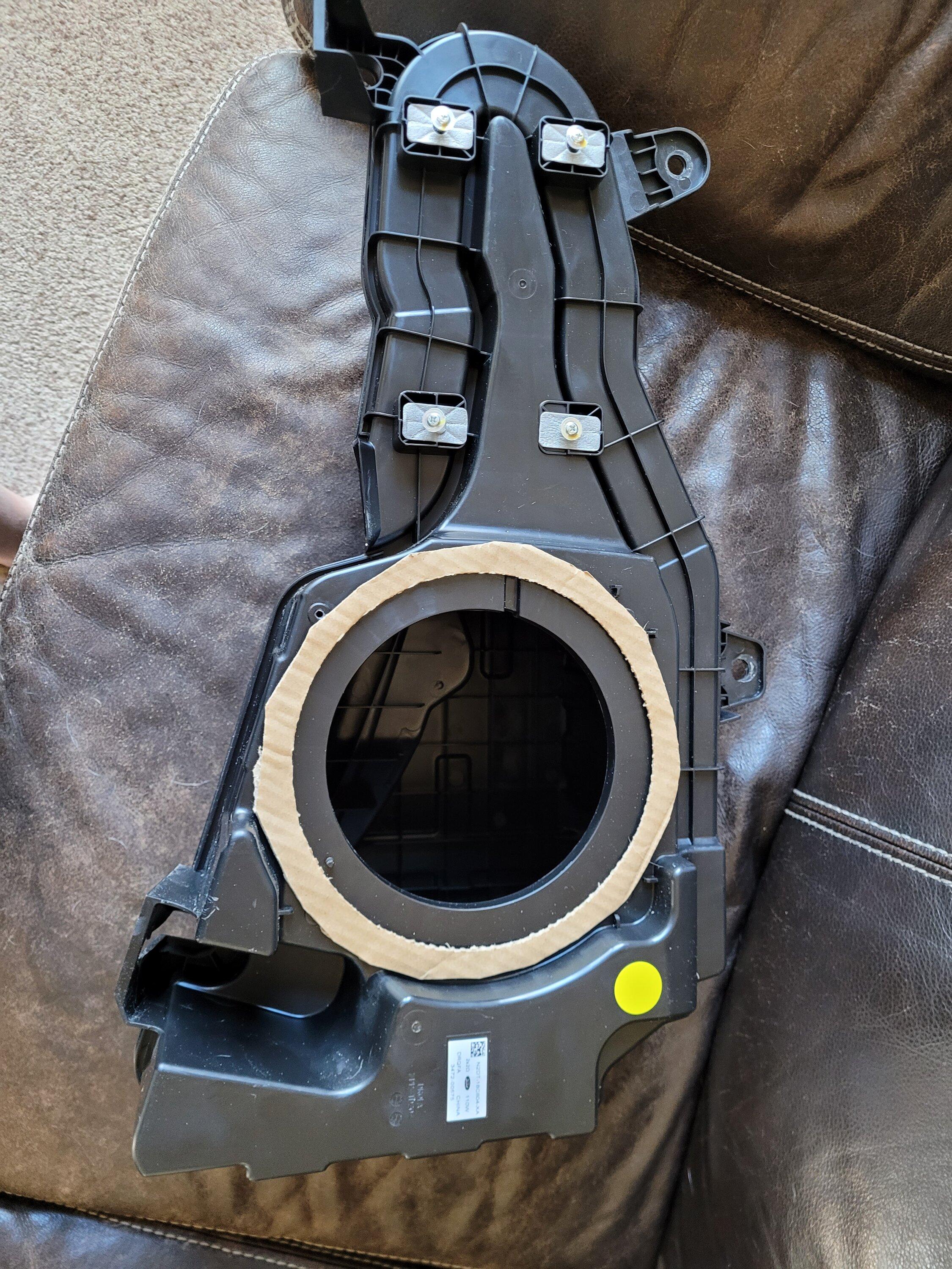

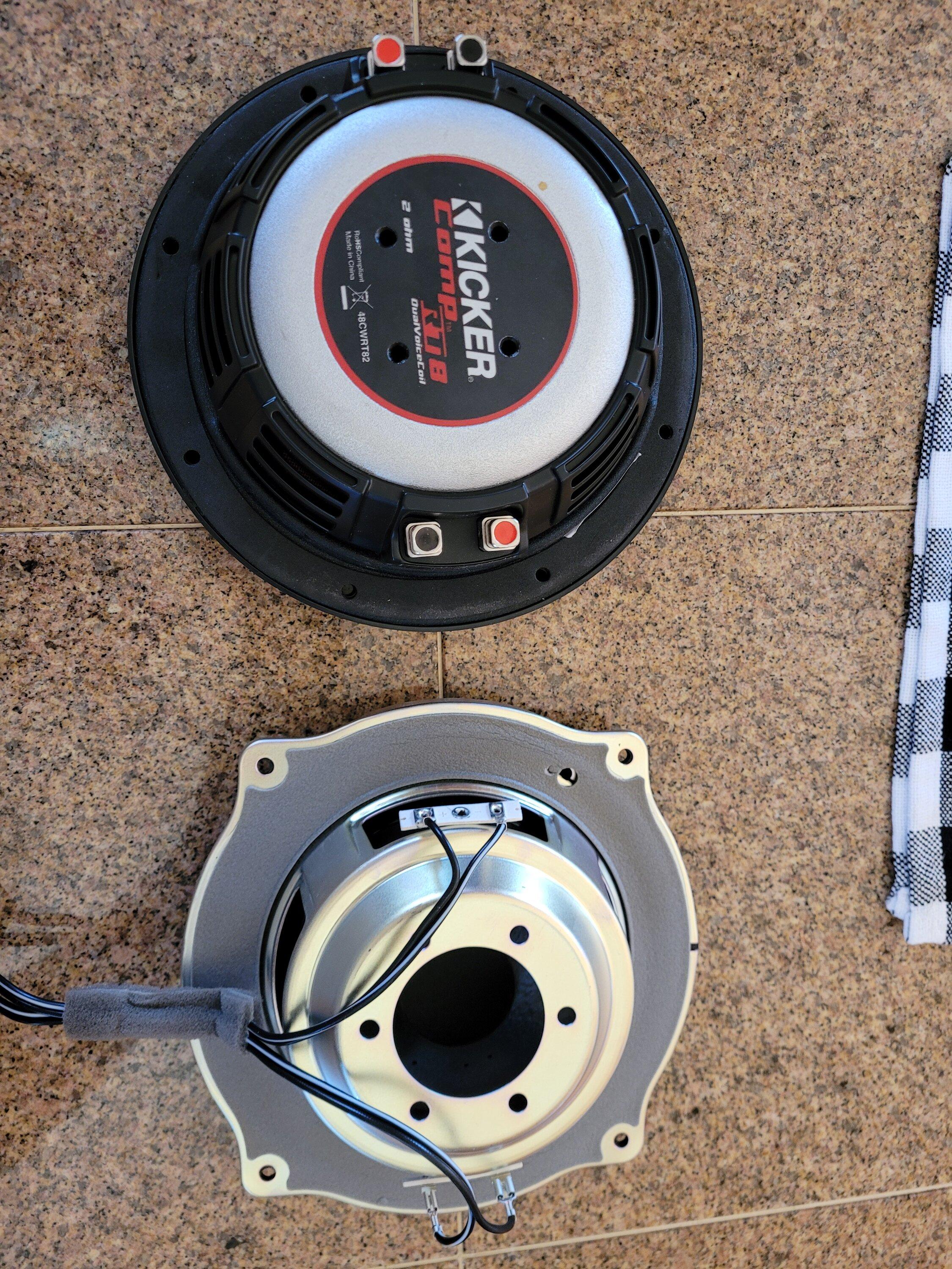

Not done yet, I'm biting off small pieces at a time, started 2 days ago. Yes the kicker has plenty of room with like 1.5 - 2 inches clearance behind the magnet.
1 - Sub is done and ready to go in with AMP mounted and sub wired and bolted up with sound deadner done.

Speakers and Sub are all done, sounds 10 times better than the stock 6 speakers. It was actually a lot more work than I thought it was going to be. Before upgrade I had my treble and bass turned all the way up, now I have them in the middle and have all I need of both.

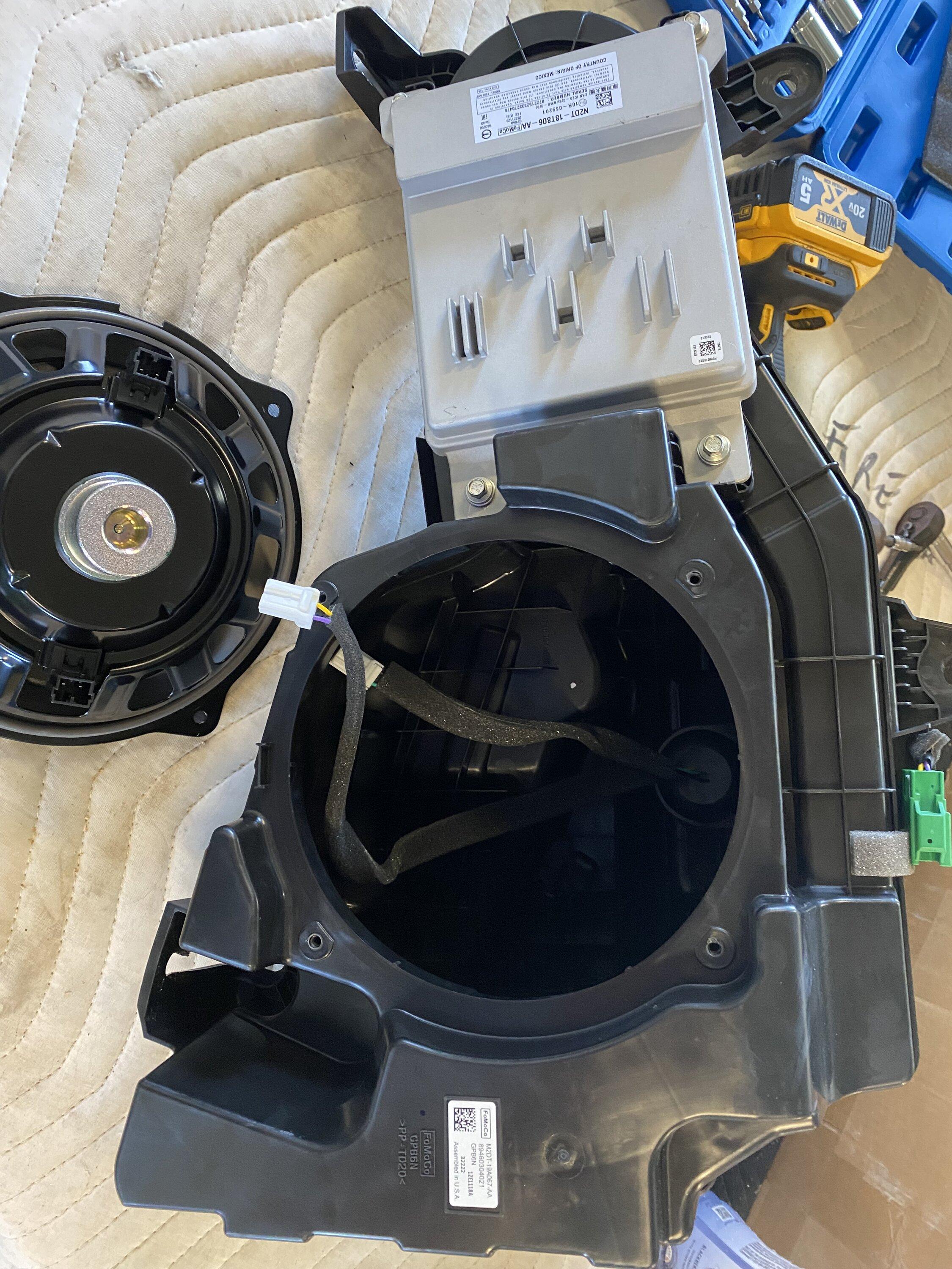

I have the B&O system in my 2-Door. The Sub Box and the AMP are completely different than what you have. The Kicker 8" Subwoofer almost dropped right into place. The one corner near the AMP was trimmed and bingo!
Ford Bronco 2023 2-Door Base FakeSquatch build IMG_0647
Pathetic Factory Subwoofer
Ford Bronco 2023 2-Door Base FakeSquatch build IMG_0646
There ia actually a lot of room for a better Sub Box and AMPs as well.
Ford Bronco 2023 2-Door Base FakeSquatch build IMG_0648

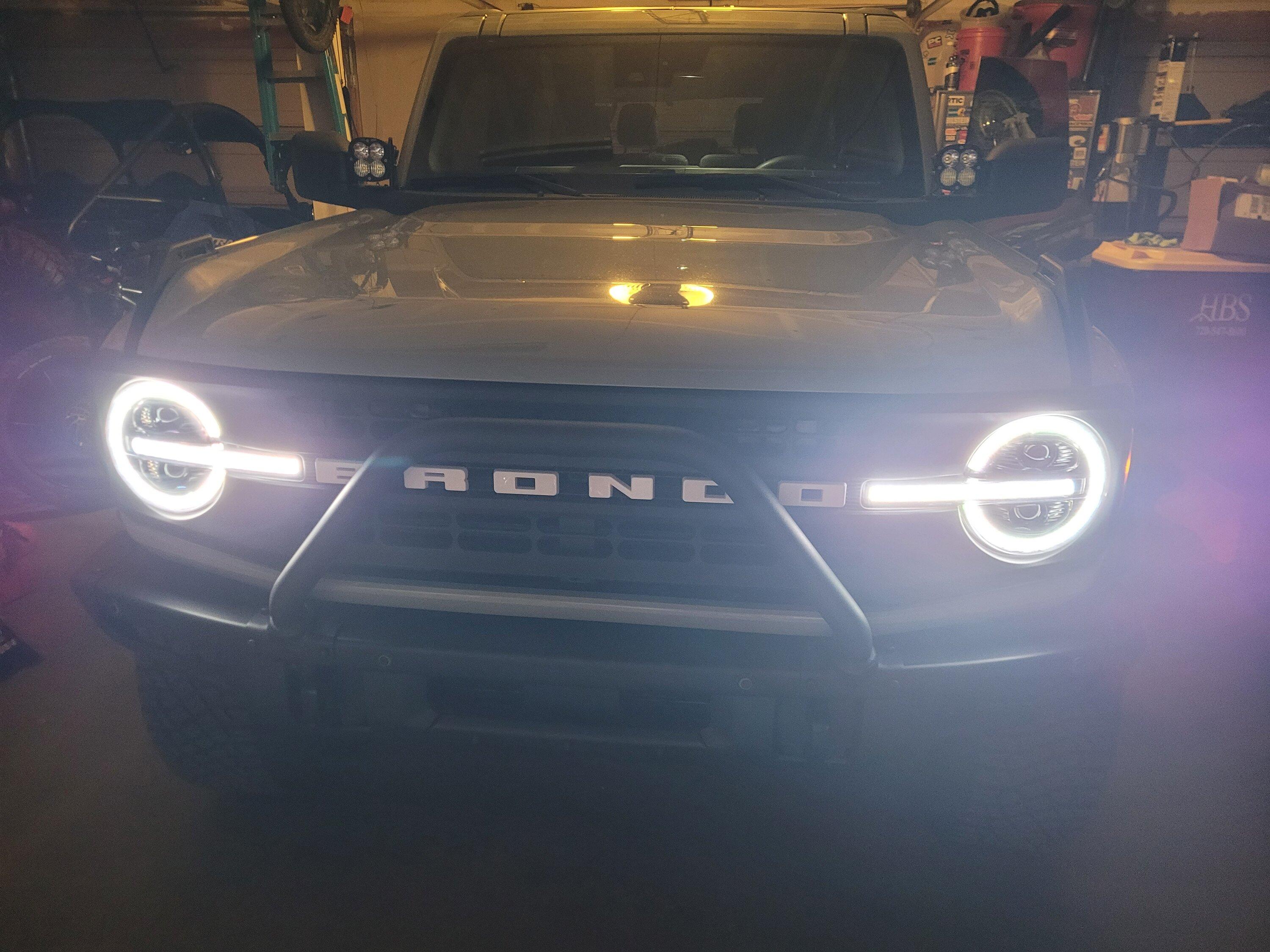

Morimoto XRGB lights installed, after playing with the happy lighting app I think I finally have the white running light color I want. The low and High beams are excellent compared to the stockers. This is an upgrade anybody wanting more light should do, it was only $525 after trade in and forum discount!

Can you let me know how you got them white? We havent been able ot figure it out on the app, weve been keeping ours yellow like a raptor's look
