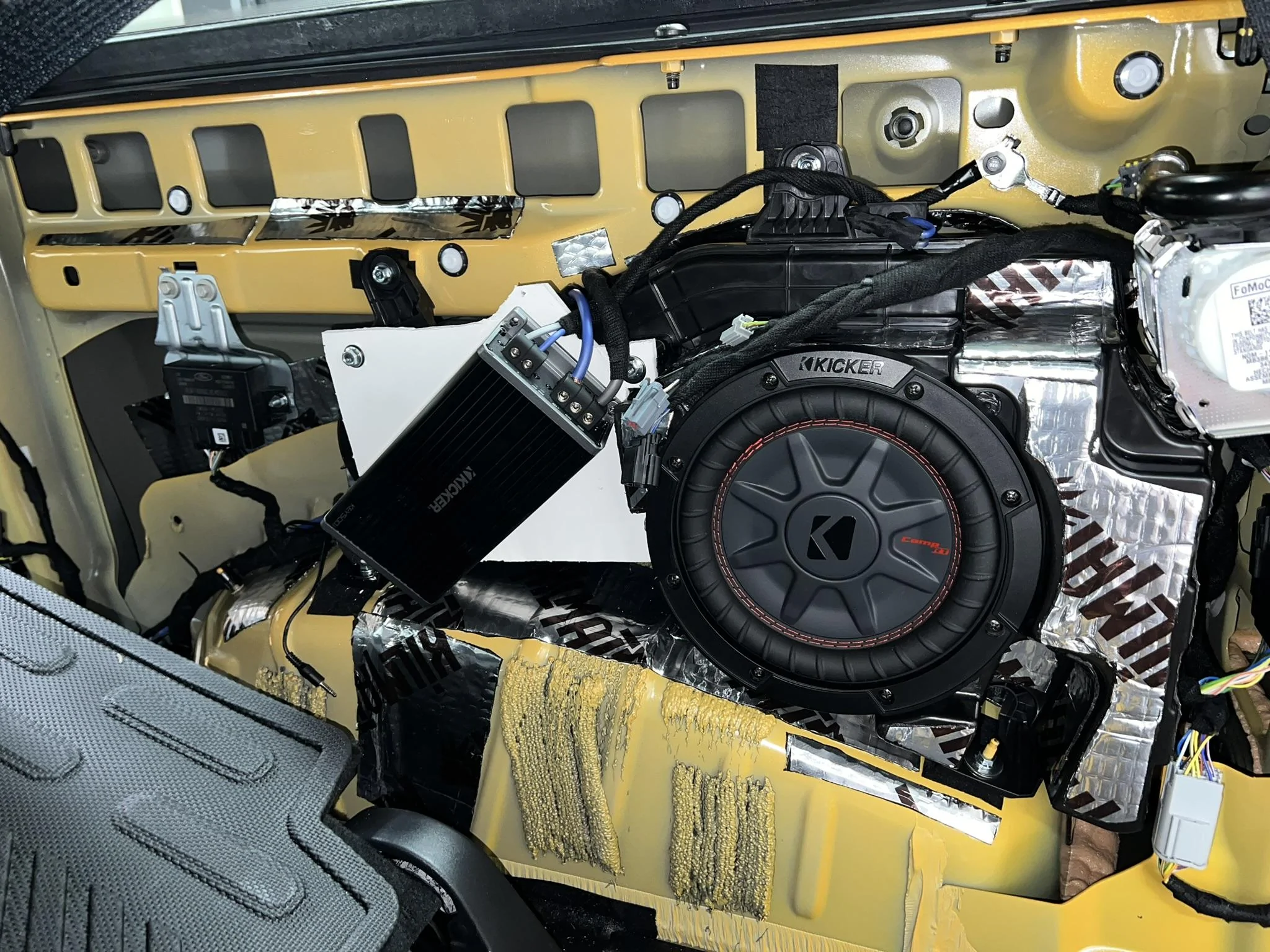

everything works well. The kick panel speakers are a bit muddy but EQ helps. I’m having a terrible time getting the 500.1 to fit behind the side panel. You need to be millimeter perfect in the angle of you want to secure the plate to all four existing bolt holes AND screw the amp at all four corners to the plate. I’m on my third fabricated plate which still needs trimming. More to come once it’s all together.

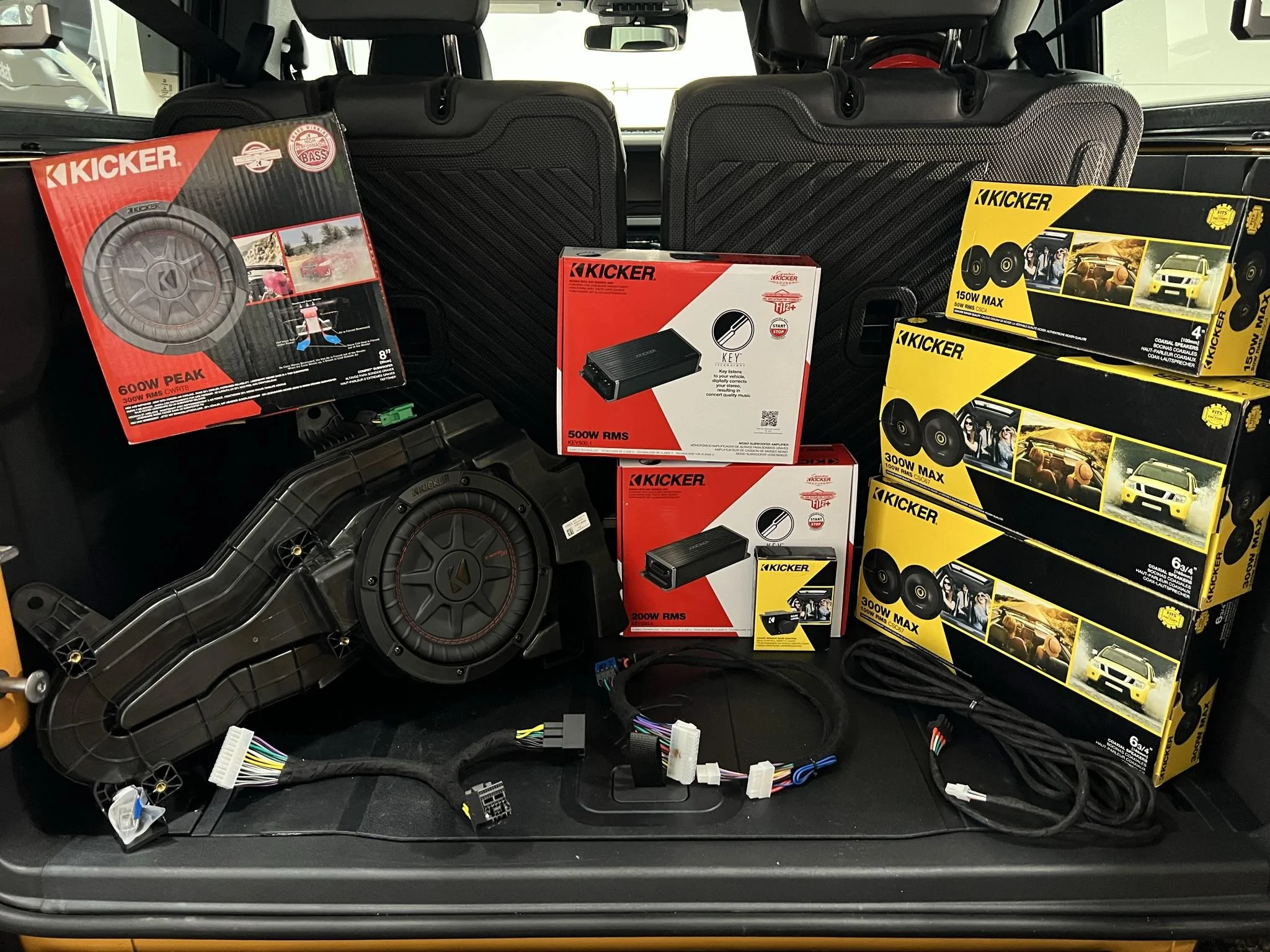

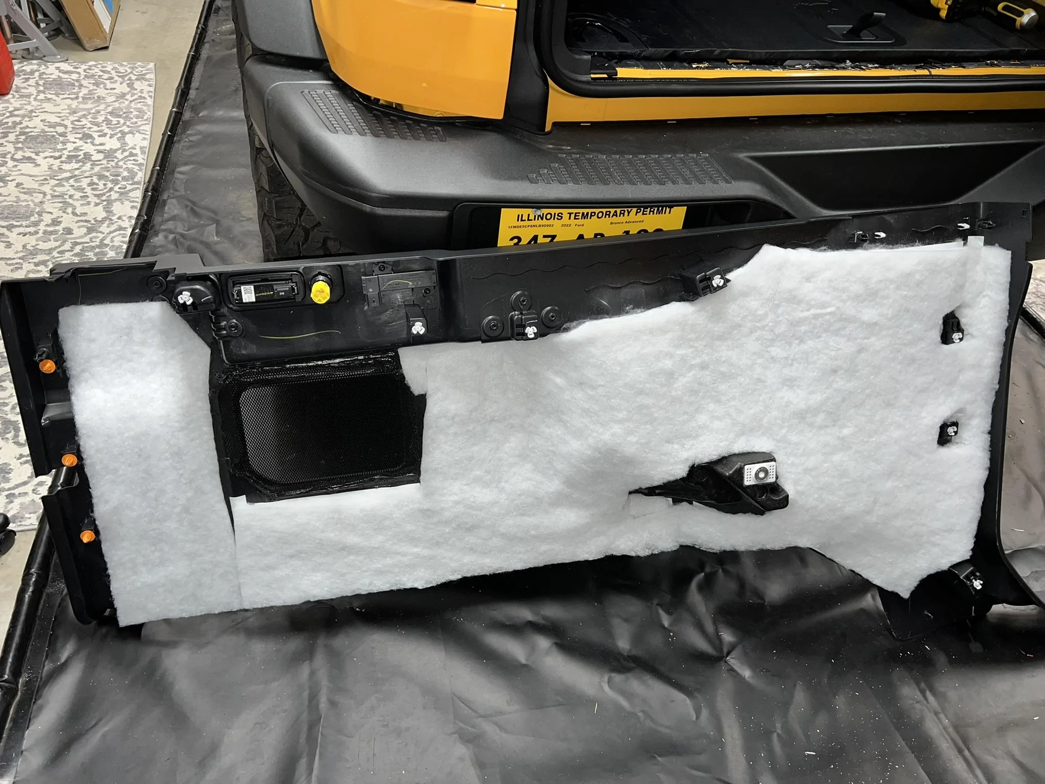

I'm all wrapped up.
Kicker CS speakers all around
Mabett 6.75 pods in back
Kicker Key 200.4 + 500.1

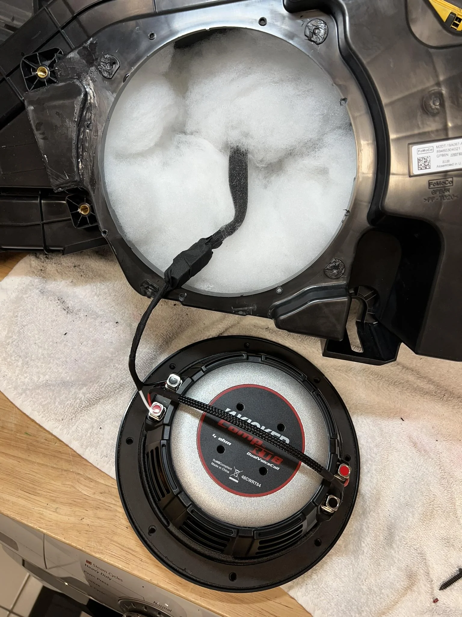

OEM sub box from B&O + Kicker Shallow 8" CWRT8
Polyfill
Quilt batting
Killmat
ZERO RATTLES! :D
Four Important Recomendations
  1. Use a circuit breaker type fuse for your amp power. It's safer and easier to simply flip the breaker to kill power to the 500.1 when you need to move it around or disconnect to refab your mounting plate.

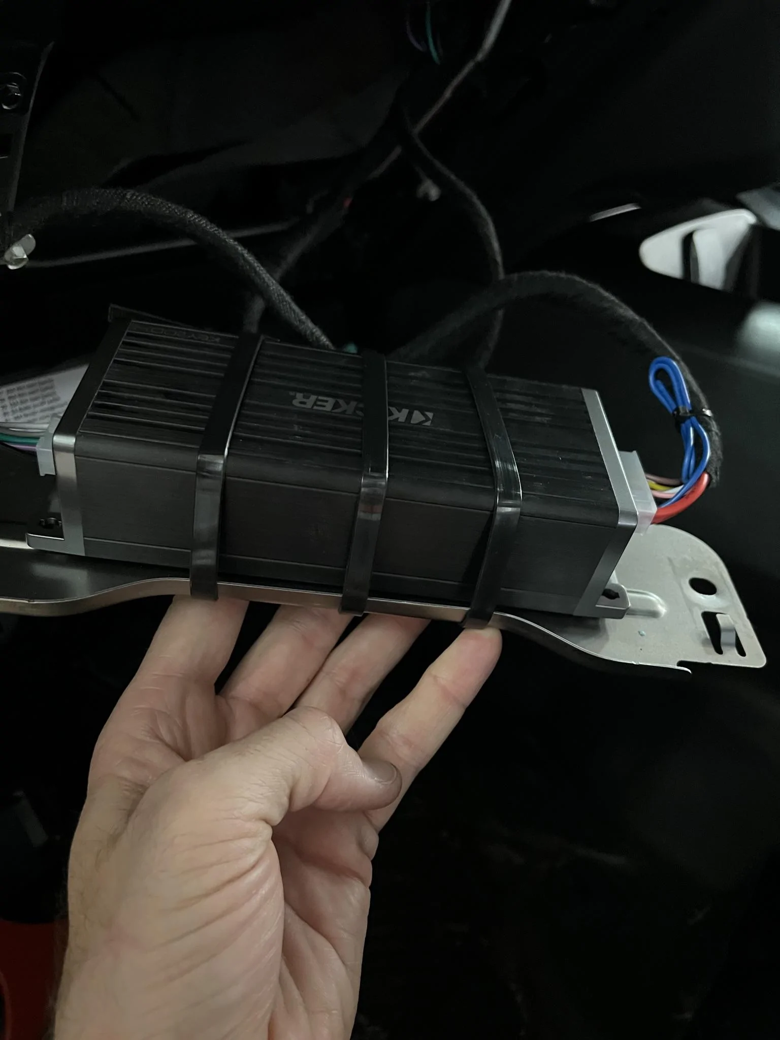

  2. Mounting the 500.1 to the mounting plate to the sub enclosure requires millimeter perfection to get the panel to fit without encroaching either the amp or the plate. The image I have here works well for the amp but I further trimmed the plate to remove ALL excess material around the mounting holes.

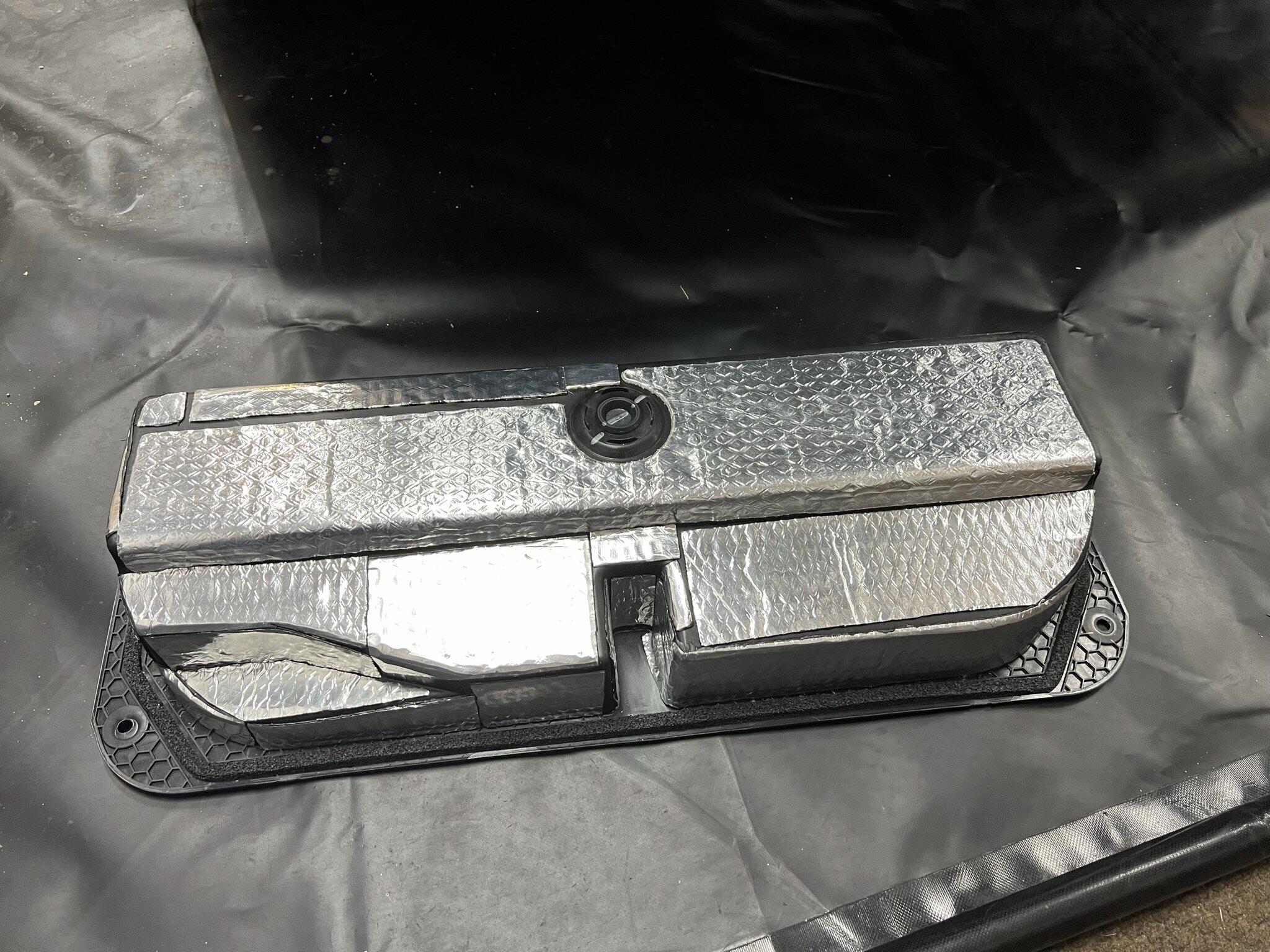

  3. The panel cubby's plastic rivets can be removed in 45 seconds with an oscillating multi tool. Forget the Dremel. I felt like a genius using the OMT instead of the Dremel. Easier faster and less mess.
  4. Run wire for your rear upfitter switch while you're in there. I actually ran two with one using the OEM wire and one with an additional wire. Both terminate at the rear behind the panel and at the front behind the glovebox.
