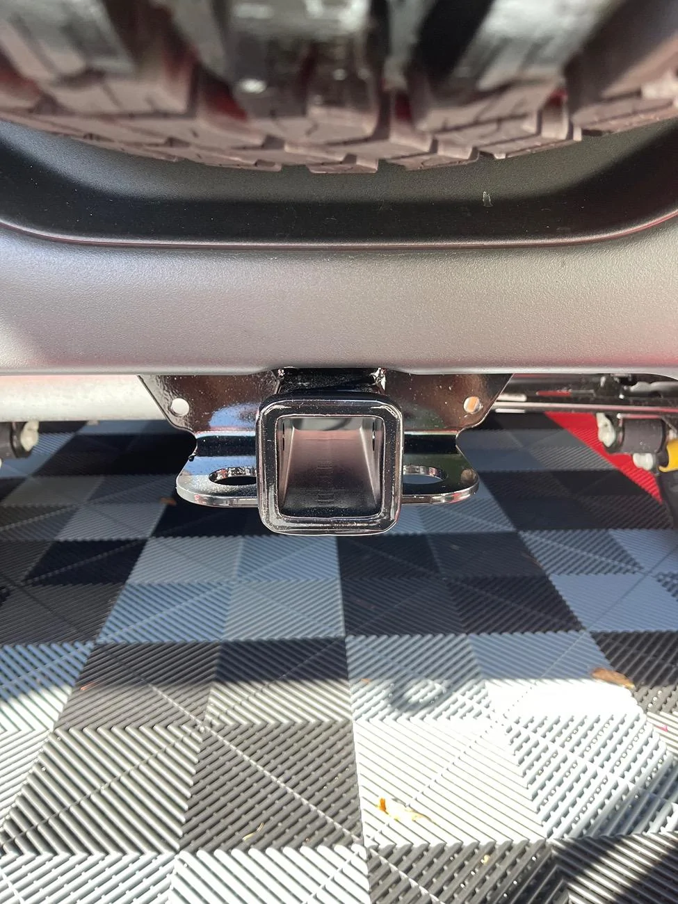

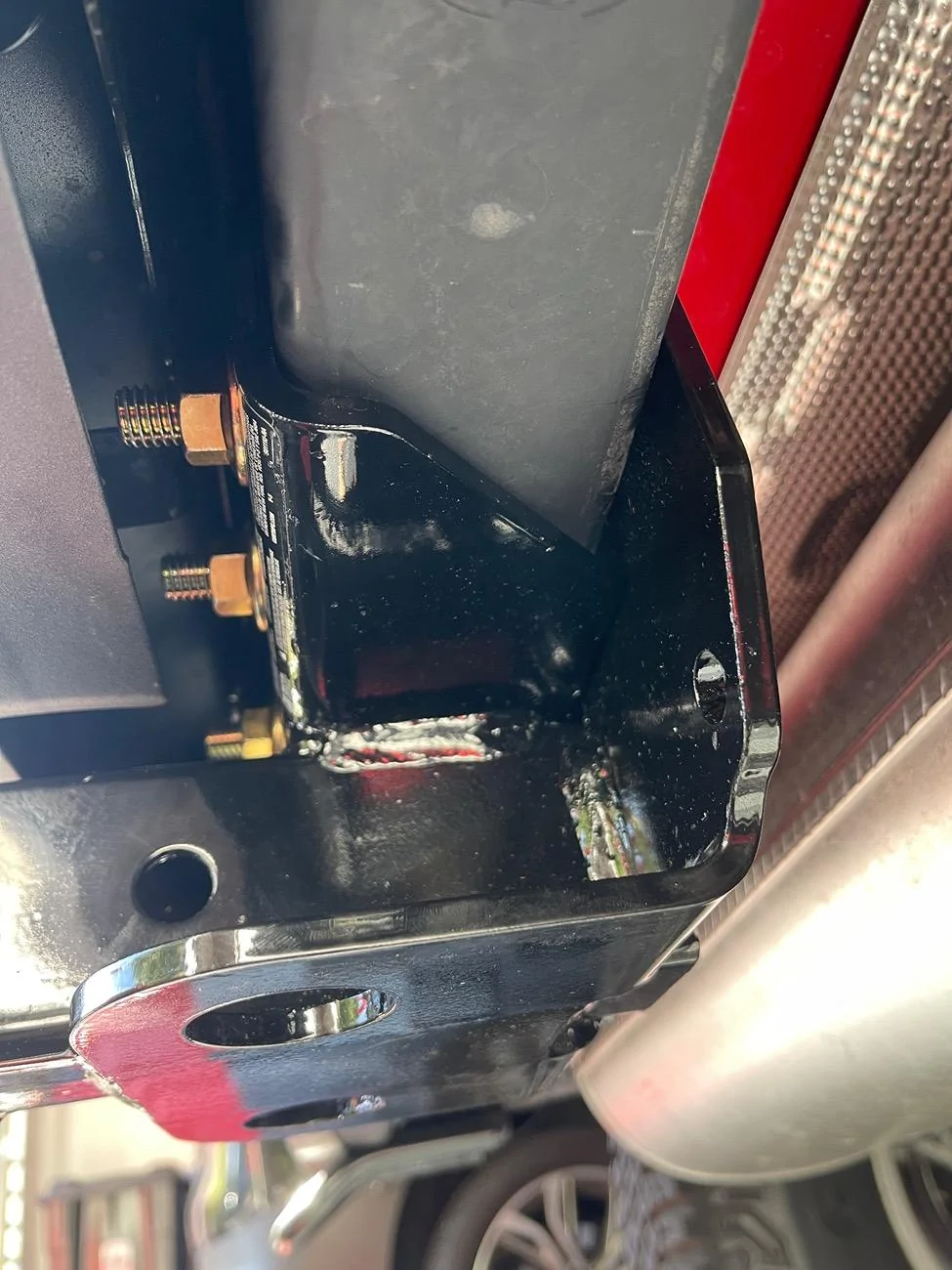

Just picked up my tow hitch package today. It looks like this sucker is going to require removal of the bumper. The fastener nuts are welded to the hitch.
I am doing the wiring myself and then the dealer said they would charge 1hr shop labor ($150) to do the programming.
Burned my pass points on the part….so about $300 for a wired 4/7pin programmed hitch is okay for me.
