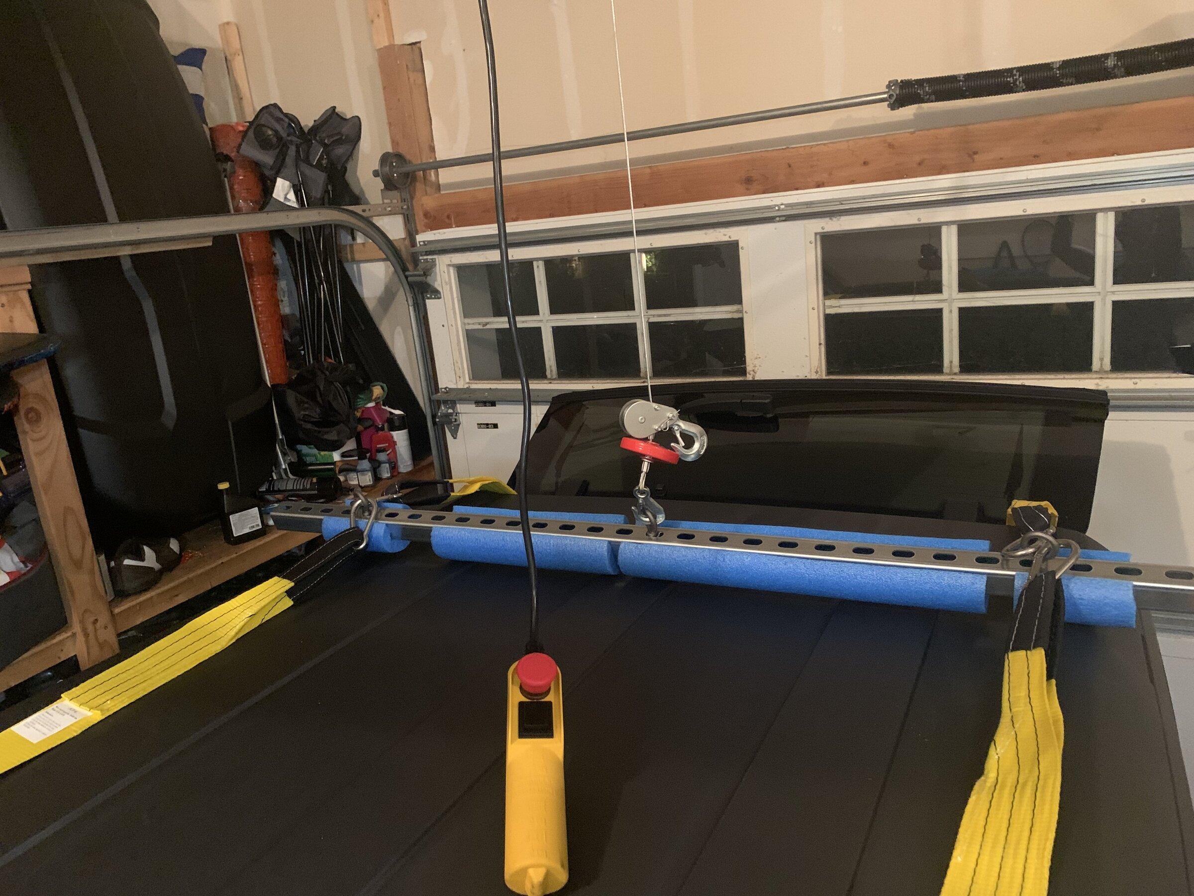

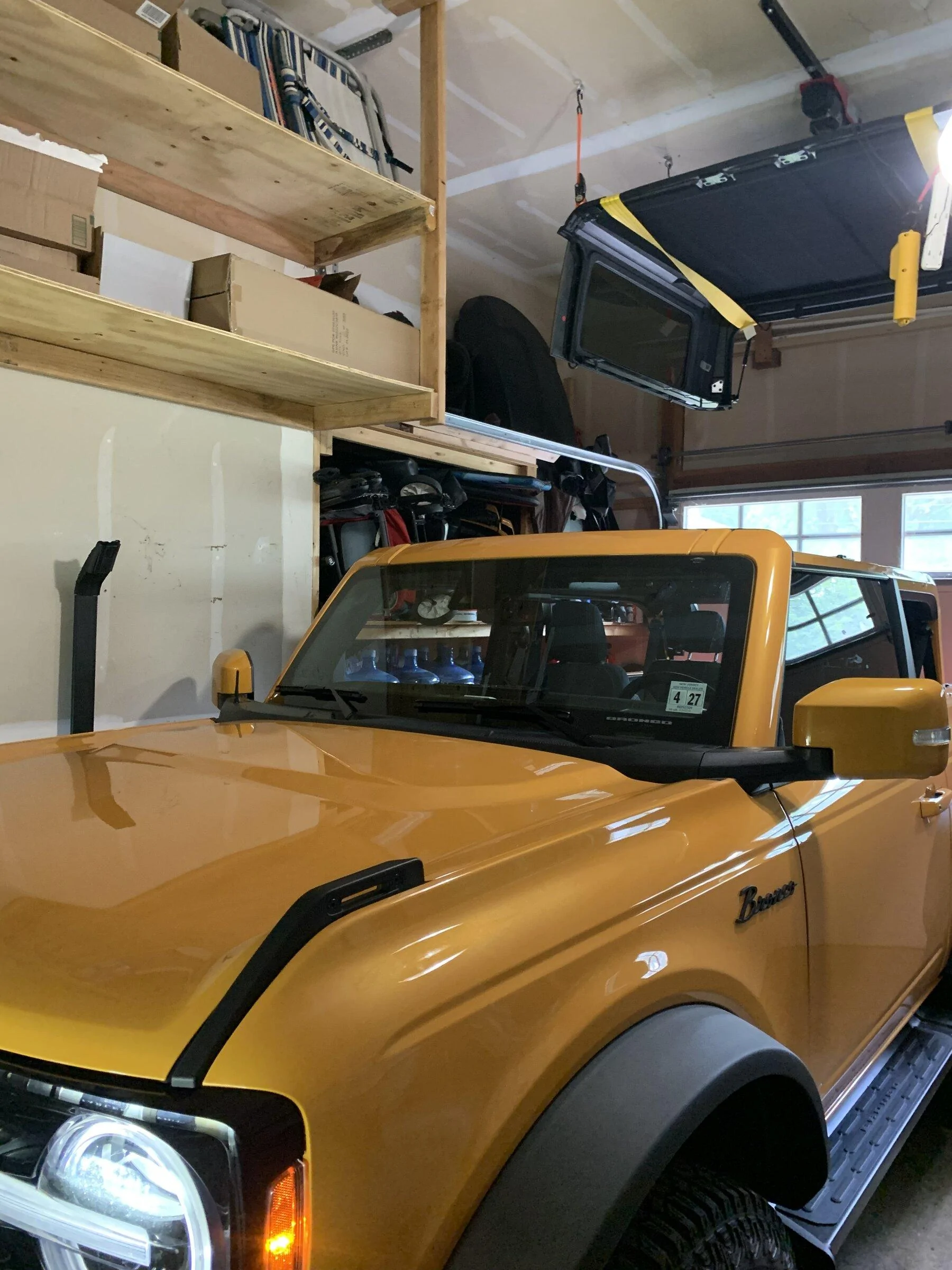

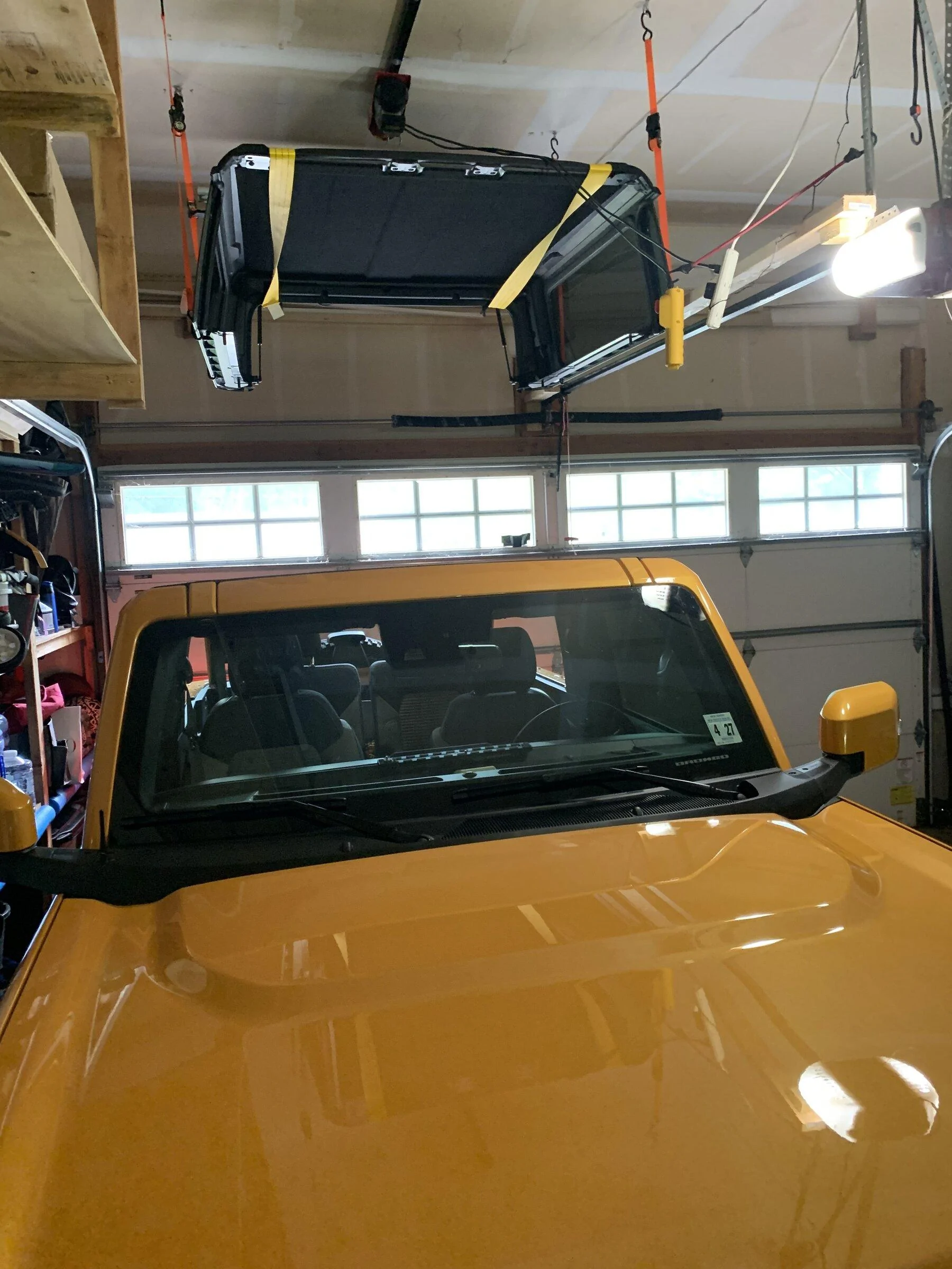

I know theres a few of these out there but perhaps I'm the first diy with the hard top stored above the garage doors when closed (so I don't need to back in). Fortunate to have a very tall garage (happens to be a very narrow2 door garage too).
But it was a major challenge to get the clearance, which involved me getting shorter straps, and adding a unabar.
Also added the 4 ratchet straps to eye bolts, to ensure it stays level, as a backup safety, and to give me confidence that its barely clearing the garage door.
i will add a full list with amazon links later.
btw, things to note, make sure it lifts level, i actually messed up and had to self repair one of the hardtop alignment pins on my first attempt.
im going too ppf the roll bars, hard to avoid it banging around especially coming down.
the 2 door hardtop is heavy and awkwardly back heavy when lifting by hand.

What is the lifting capacity and manufacture of the electric hoist. Amazon has so many brands and sizes it’s hard to determine the best brand to purchase that you can feel comfortable. Did you attach the straps ends to the winch hook or do you have a bar running across the top to the straps on each side.
mykoljay
Apr 16, 2021
191
200
North NJ
2021 Bronco 2DR
220 or 440 pounds, depending on how its setup with the hook.
The bar wasnt required but i do feel like its more stable (tilts less). I also was playing around with strap lengths and the bar to get the least slack because I needed to clear the garage.
the bar has eye hooks on the ends and the straps have big caribeaners that click into them.

I have the same winch system from my Lange jeep lift. I noticed your connecting point is towards the rear. How do you keep the front from tipping ?
Its super back heavy (the glass the heaviest part). I found the right spot. And then i have those 4 hooks to keep it stores perfectly level, and to avoid garage door from hitting it

Curious how you attached the eye hooks to the unistrut bar (the unabar you are using)? Thank you.

Nice work. I think I have that exact same electric hoist, bought it a few years ago (maybe $35 or something around that) for a project to lift a basement ping pong table to the ceiling, to get it out of the way. Never got around to that, maybe I'll try using it for a hardtop lift, if my Bronco ever arrives.
How do you feel about the control of the hoist in terms of speed and finesse, when lifting and especially setting the top back down? Do you have enough control to avoid accidently smashing it down? And I suppose you setup the ring that stops the hoist from lifting, to avoid accidently lifting the top too high and crunching something?

Looks nice and clean. Good job. đź‘Ť
Will you be installing a soft top or taking off the hard top randomly?

Great looking setup! Would love to see your parts list, and some pics of the strapping around the back window.
Lucky guy to have that kind of ceiling height, you could easily get a 2-post lift in there as well! :love:
