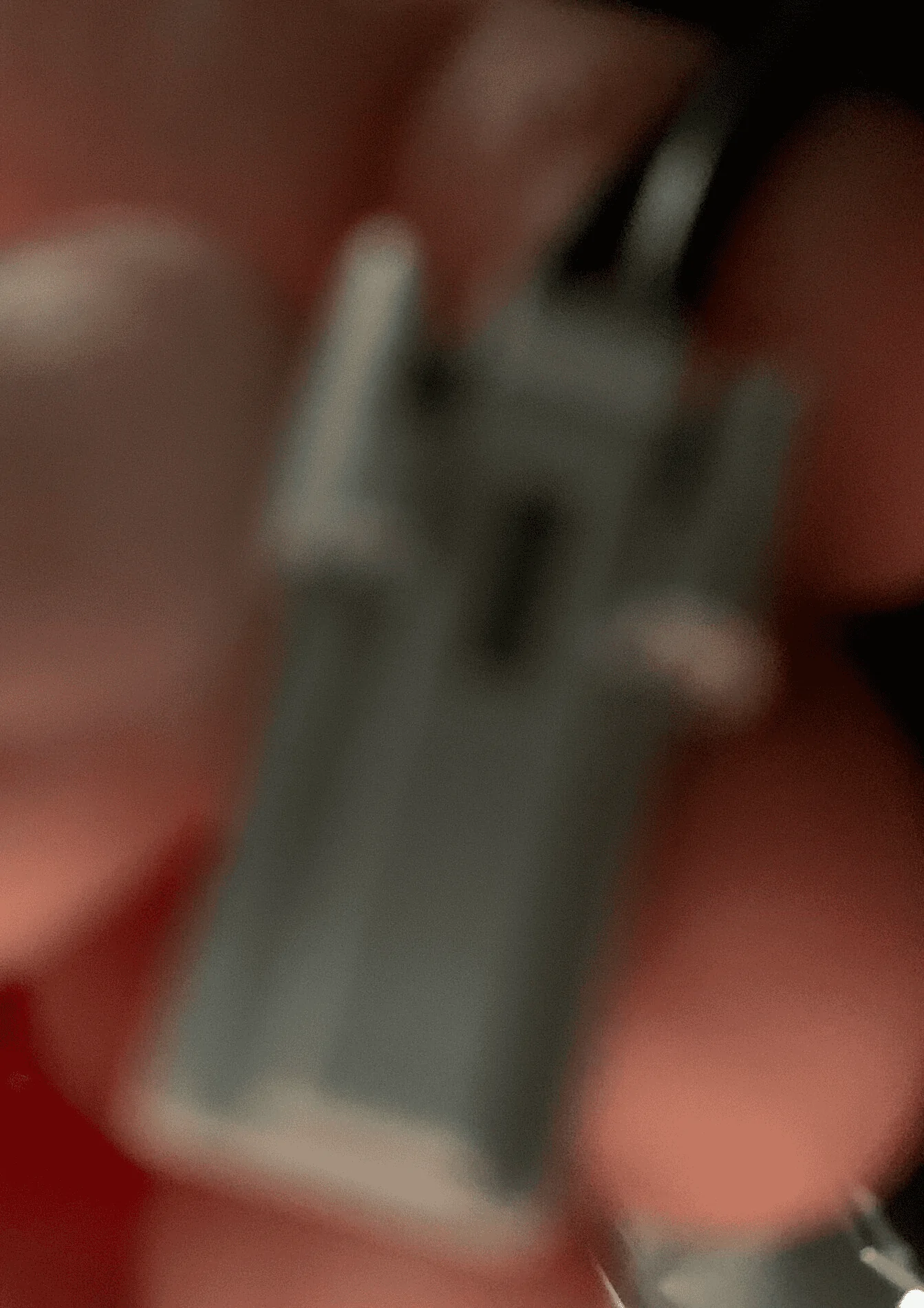

Painful....I can't get the damn iPhone to get a clear closeup...I will try again today. ;o) Any of you that have followed my posts, that despite taking a photography course in college I butcher videos and pictures....I might have to break out my Digital SLR to get a good pic.

I tried all that..I even turned the flash off and then put the flashlight on....I will get it I promise....

let’s just say I got the photos…. So much for using the harness ;-)

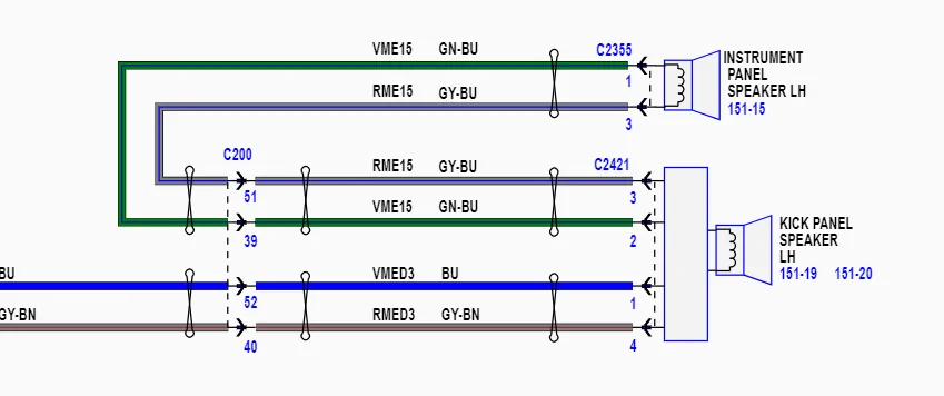

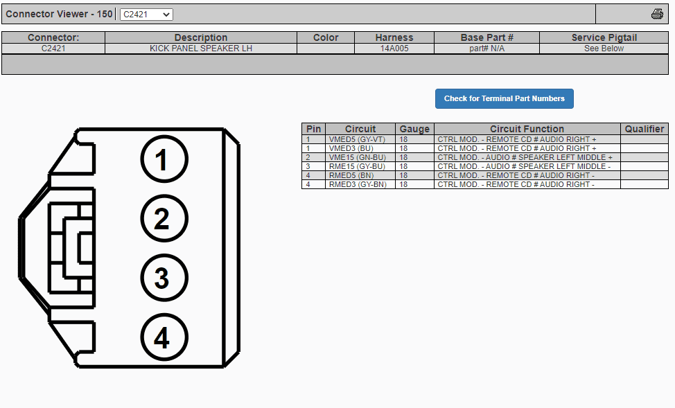

Flip can I ask you a dumb question? I put my infinity's in, thy installed great, I have the boom mat in place, I wired a positive and negative lead speaker wire into them. To test this out from the lead wire I just pushed the Positive wire into the blue wire on the adapter and the negative into the Grey/Brown wire. Speakers sounded pretty good but I lost the 4" speaker on the same side. I assume I need to wire the Blue and Green wire together to the positive lead from the speaker and the Gray/Brown and Gray/Blue wire to the negative lead to get both speakers powered. on that side. Is this correct? I ordered the Metra 4 pin adapter but I am waiting on it. Just trying to understand how this is all wired....I am worried wiring them all together I will lose any type of crossover that was built into the factory wiring schematic. I hope that makes sense. I feel like the 6.5 could use some bass blocking maybe like 200Hz and the 4" maybe could use 300 or 600 HZ, but not sure how to accomplish that with the current wiring schematic. Appreciate any guidance folks may have.

Not sure how the in-out from kick panel speakers work until I pull them. Diagram is really poor and workshop manual isn’t any help either.

Thanks man....I'm thinking based on what I am seeing that the positive feed for the kick panel and 4" front speaker are all powered together. I don't see how it could be done any other way.

Flip for shits and giggles I created two more short speaker leads and wired all the positive wires together and then negative wires together coming off the 6.5" which left me with 2 positive and 2 negative leads feeding into the 6.5" speaker. I then temporarily jammed the positives into the Blue wire on the harness and the Green wire on the harness, put the negative leads into the other two slots. All 4 speakers fired up. Not sure if this helps any, but when I get the Metra harness tomorrow my intent is to plug it into the harness and then wire the positive leads together with the positive lead coming from the speaker so three wires into 1, and do the same for the negative. I will report my findings. Have no reason to believe it should not work like I just tested. I'm trying to avoid cutting this harness if I can. Sucks though because I have the bronco taken apart pretty well so I will have to drive the other car for a day ;o). Then I might just put the bass blocker on the 4" speakers and call it a day. I am worried if I put bass blockers on the 6.5" then those frequencies will also be blocked by the 4". Maybe I do like a 0-70hz on the 6.5 and then do a 0-300hz on the 4", that might work. Will keep really low frequencies off the 6.5 but allow me to further reduce the frequency to the 4"'s. This is frequency blocking is new to me. Probably would be easier with an amp, but I don't see a need for an amp based on my listening habits.
