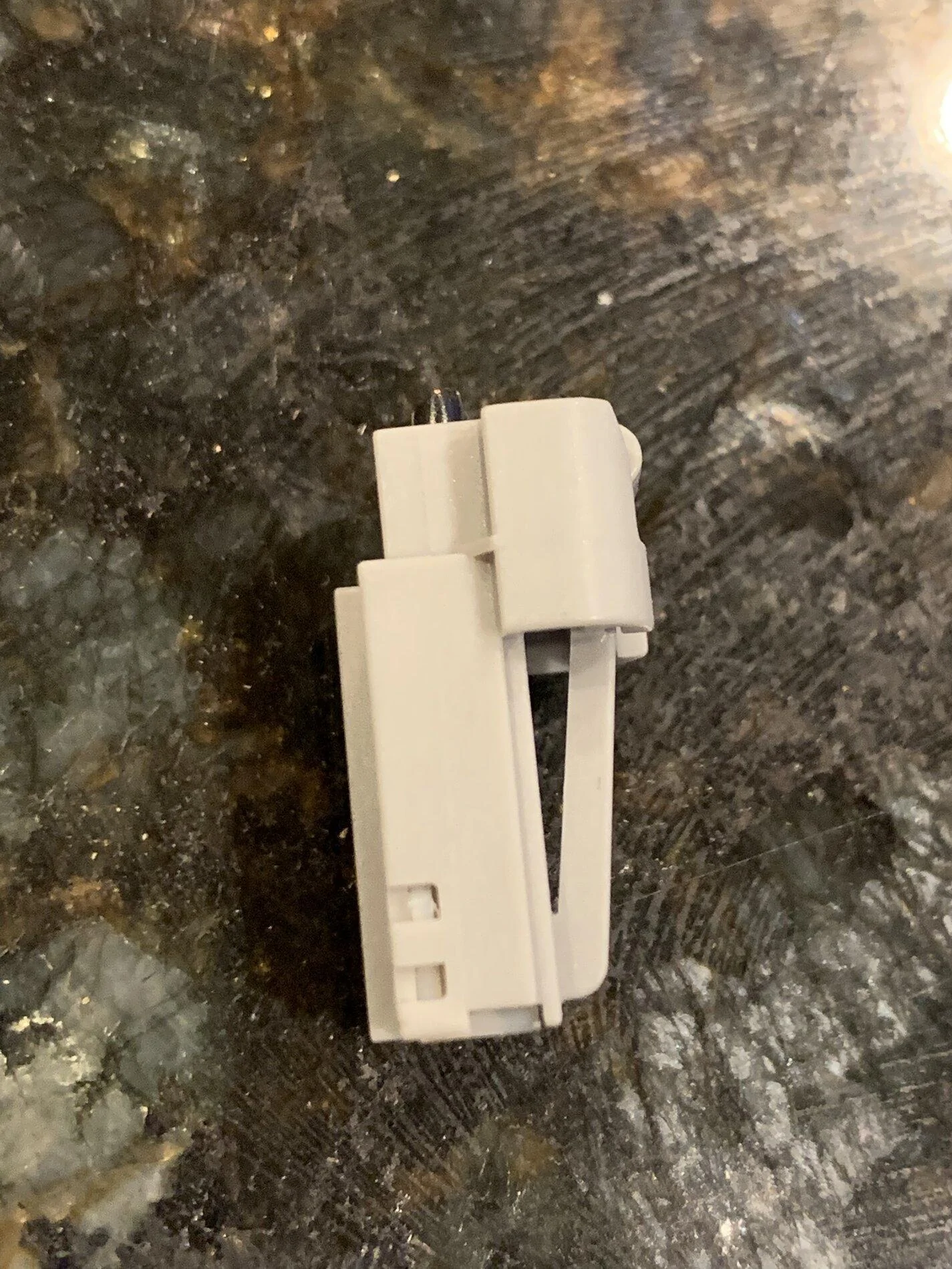

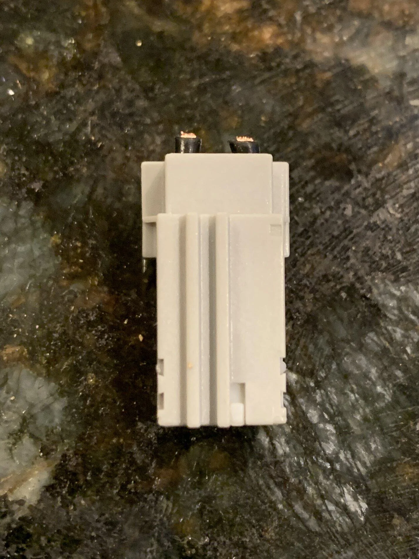

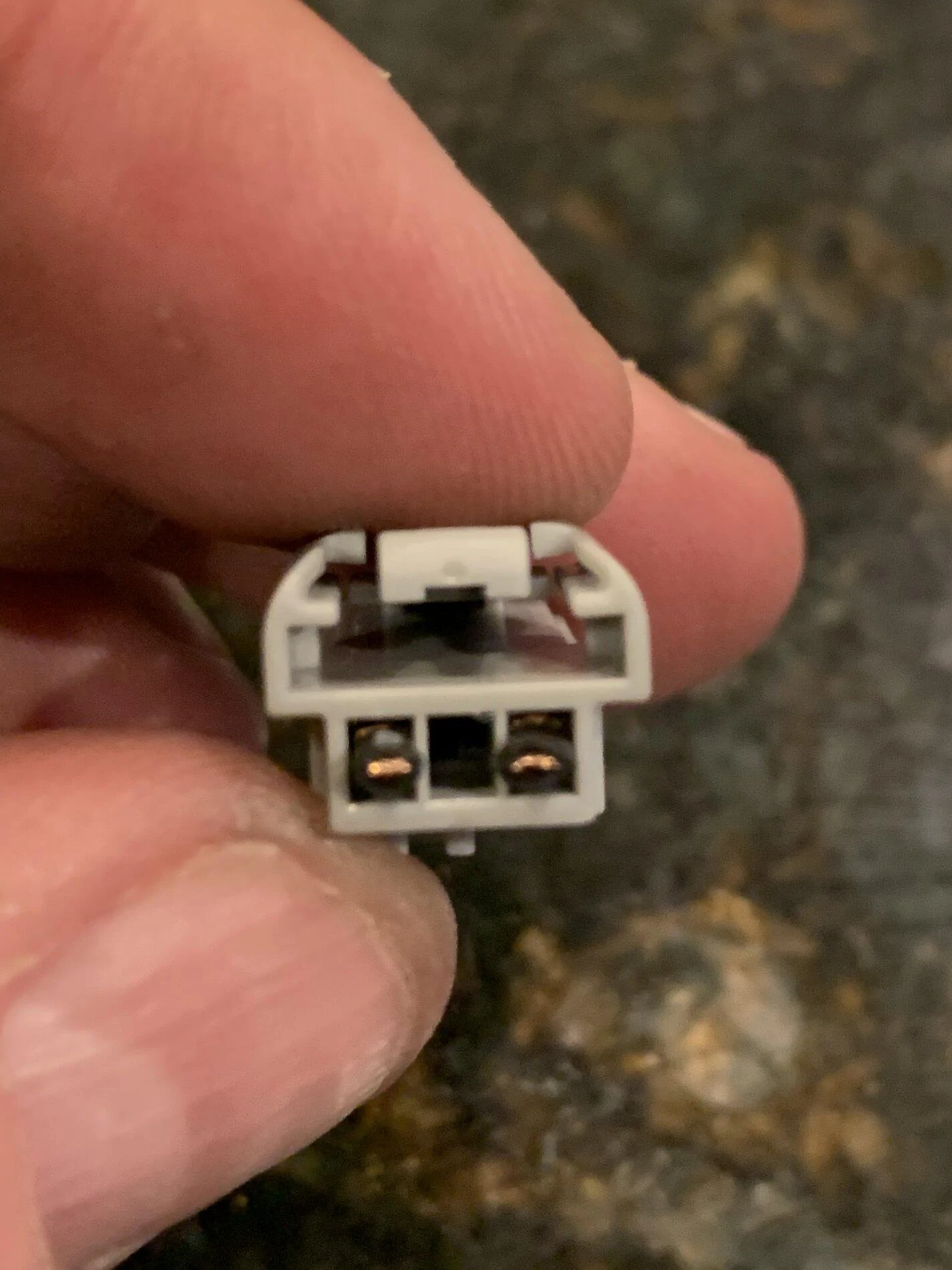

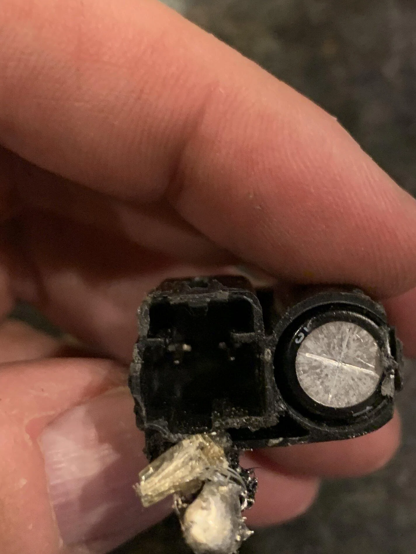

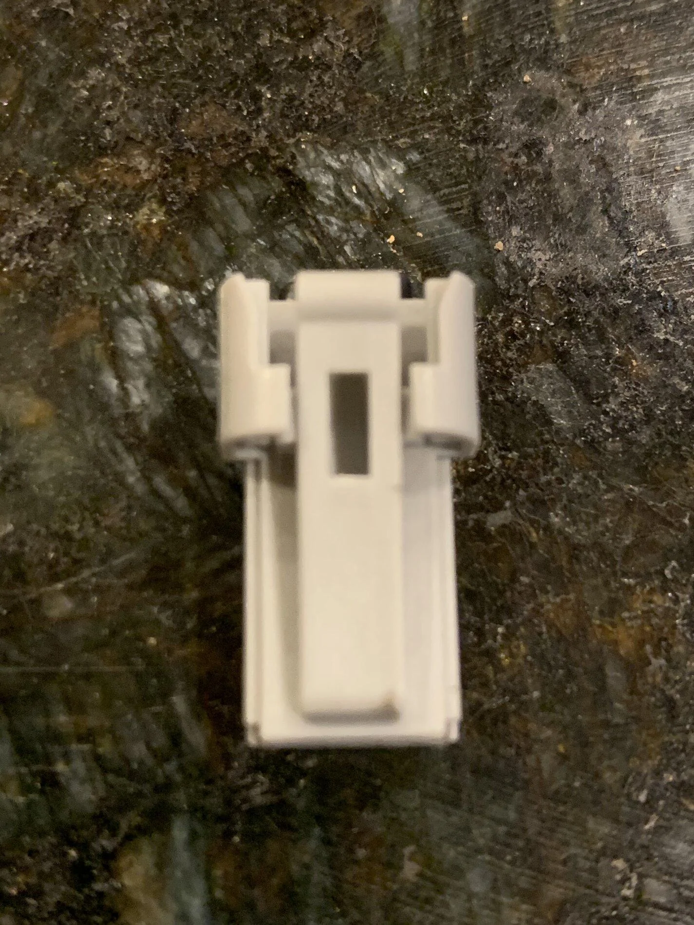

I still find the music sounds like crap with these new Inifity's, and I doubt very much it is the speakers. More like user error. I just think there is something going on with that 6.5"/4" wiring that optimizes those factory speakers. The depth of bass is so much better on the factory speakers, and my 6.5" are those infinity kappa series, they are nice speakers. Half tempted to reinstall the factory 6.5 but I must be doing something wrong, so I don't want to put all the body trim back just yet.. I will keep tinkering with it.Thanks man....I'm thinking based on what I am seeing that the positive feed for the kick panel and 4" front speaker are all powered together. I don't see how it could be done any other way.
Flip for shits and giggles I created two more short speaker leads and wired all the positive wires together and then negative wires together coming off the 6.5" which left me with 2 positive and 2 negative leads feeding into the 6.5" speaker. I then temporarily jammed the positives into the Blue wire on the harness and the Green wire on the harness, put the negative leads into the other two slots. All 4 speakers fired up. Not sure if this helps any, but when I get the Metra harness tomorrow my intent is to plug it into the harness and then wire the positive leads together with the positive lead coming from the speaker so three wires into 1, and do the same for the negative. I will report my findings. Have no reason to believe it should not work like I just tested. I'm trying to avoid cutting this harness if I can. Sucks though because I have the bronco taken apart pretty well so I will have to drive the other car for a day ;o). Then I might just put the bass blocker on the 4" speakers and call it a day. I am worried if I put bass blockers on the 6.5" then those frequencies will also be blocked by the 4". Maybe I do like a 0-70hz on the 6.5 and then do a 0-300hz on the 4", that might work. Will keep really low frequencies off the 6.5 but allow me to further reduce the frequency to the 4"'s. This is frequency blocking is new to me. Probably would be easier with an amp, but I don't see a need for an amp based on my listening habits.
