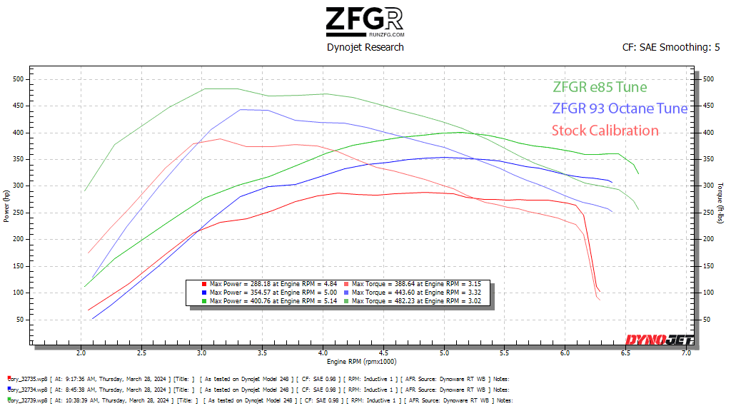

Hello friends,
Wanted to share my recent dyno results. I spent a lot of time making sure we got numbers with the stock calibration, ZFG 93 tune, and their E85 tune. We had to drain the tank and use a custom tune to allow the fuel pump to run so we could swap to E85. The 2.7L Ecoboost can run full E85 with the ZFG Racing custom tune without the need for a HPFP.
Big thanks to Adam @ZFGracing
Here's a breakdown of the mods that are installed on my Bronco.
2022 Ford Bronco Big Bend Sasquatch 2.7L
List of performance mods:
  • HP Tuners MPVI3 w/ ZFG Racing Custom Tune
  • CV Fabrication Intercooler
  • CV Fabrication 3" Cat back Exhaust
  • Injen Evolution Cold Air Intake System - EVO9301
  • Turbosmart Kompact EM VR19 Dual port BOV
  • NGK 95605 plugs gapped to .028
  • BMS Pedal Tuner
So basically, Intake, exhaust, Intercooler and tune.
I will go back to the dyno after I add Down-pipes and charge-pipes.
Here are the results:
  • Stock calibration w/93 Octane
  • ZFG Racing 93 Tune
  • ZFG Racing E85 Tune
All pulls done in 5th gear
Ford Bronco 400 WHP unlocked on 2.7L with ZFG Racing E85 Tune + Bolt-ons Dyno Chart
Here's a video of the runs:
With the E85 tune:
  • 0-60 in 4.3s
  • 1/4 mile in 12.9s
  • (Via Dragy)

I bet it flies man. I'd be up for this, but I would want to keep mine mechanically stock. Just a full E85 tune. I wonder how much the mods helped over what it would do just straight up stock? Also you can enable the ARF gauge in forscan under the IPM controller I think is where it is.

Very impressive!

Adam does great work. That is moving for a vehicle of that size. Why a pedal tuner if Adam could just do the same too?

You would at least need an intercooler because factory one is ridiculously small.

Seems HP Tuners hasn't unlocked pedal mapping quite yet, so I'm using the BMS pedal tuner for the time being.

It’s hard to say for sure, but I would guess both the 93 and E85 tune would lose about 15-20 HP and around 20-30 TQ if you were completely stock.
Also, like @2020FordRaptor said, I would at least install an aftermarket IC if you were considering a custom tune.
CV Fab has them for under $600 shipped.
