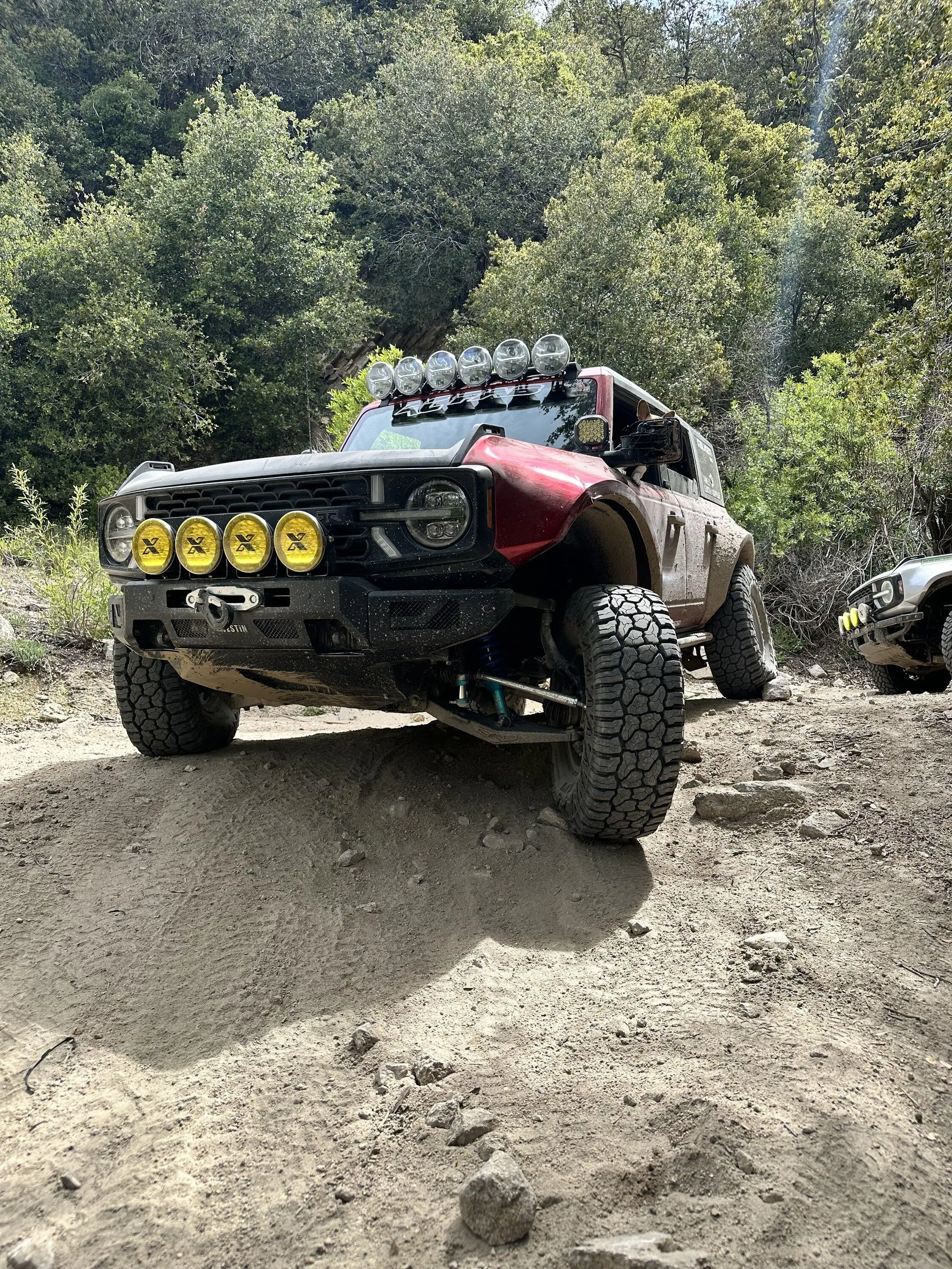

same route I went with on my basesasquatch. Hoss 2.0 rack with heim Steering from wicked. I he’s the crap out of this thing and no issues so far.And I’m long travel +5 and on 38” tires
