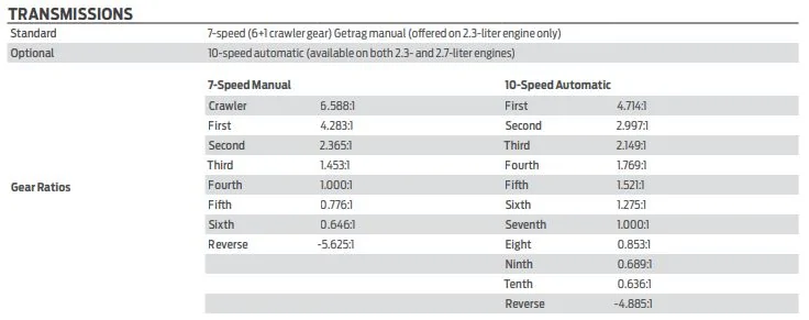

Does anyone have the gear ratios for each gear? Typically the jump from 2nd to 3rd is the largest jump on a lot of manuals which can feel odd at times.

I have about 800 miles so far on my Badlands. While I don't notice anything specific about 3rd gear, I do feel it helps to release the clutch more slowly while accelerating into 1st, 2nd, and 3rd. Once I hit 4th and above I can get my foot off the clutch as humanly possible.
