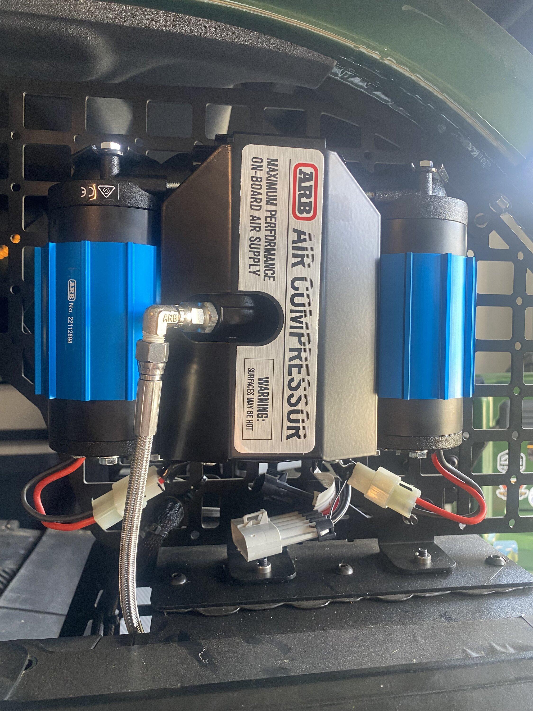

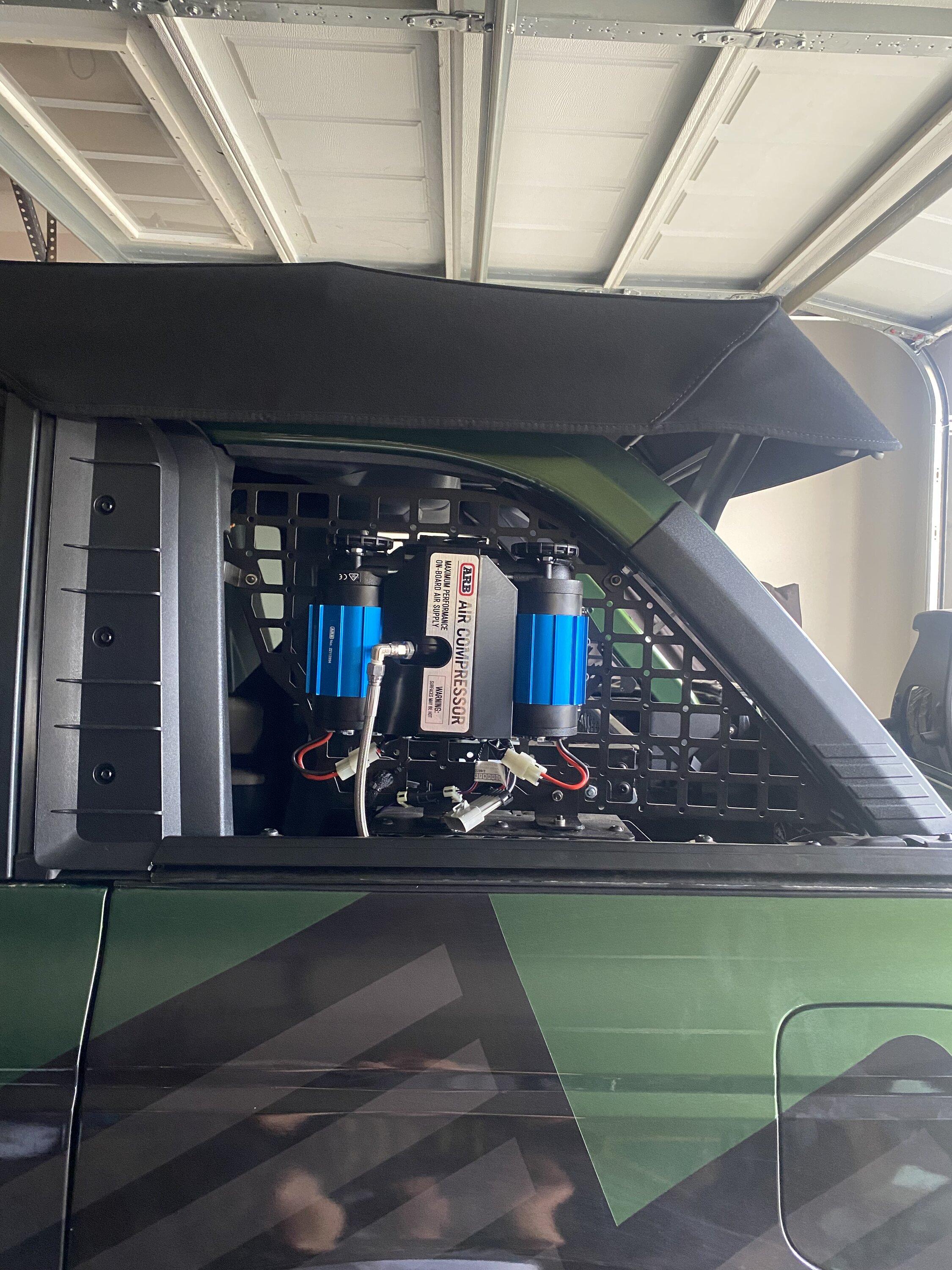

I will preface this by saying, this solution only works with hardtop or Bestop. Factory soft top frame would not allow this.
I wanted to mount this out of the way, but inside the vehicle. @Mountains2Metal makes a couple of pieces for mounting the compressor as well as the switch and chuck. I’ve typically seen the compressor mounted on the lower cargo molle panel, but after some measurements I determined that I’d have plenty of clearance (right around 2” to the window) if I put it on the outside of the upper roll bar molle panel. The space I used is dead space anyway, but easy to access by taking the window off. I still have to wire the main power harness, but I’m happy with the results so far.

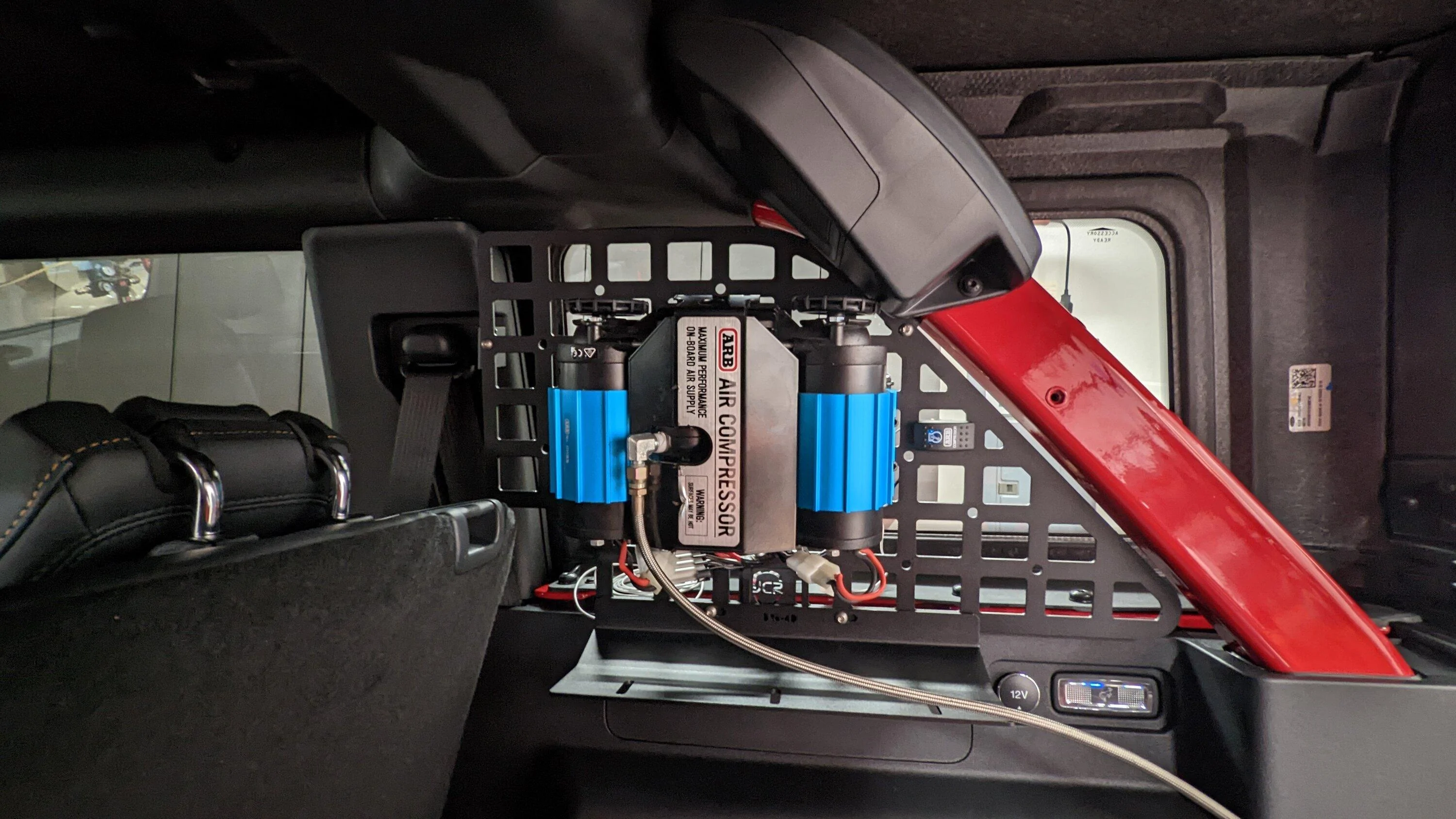

that's how i did mine, but it's facing inside the storage compartment! (pic from mid-way through buildout)
