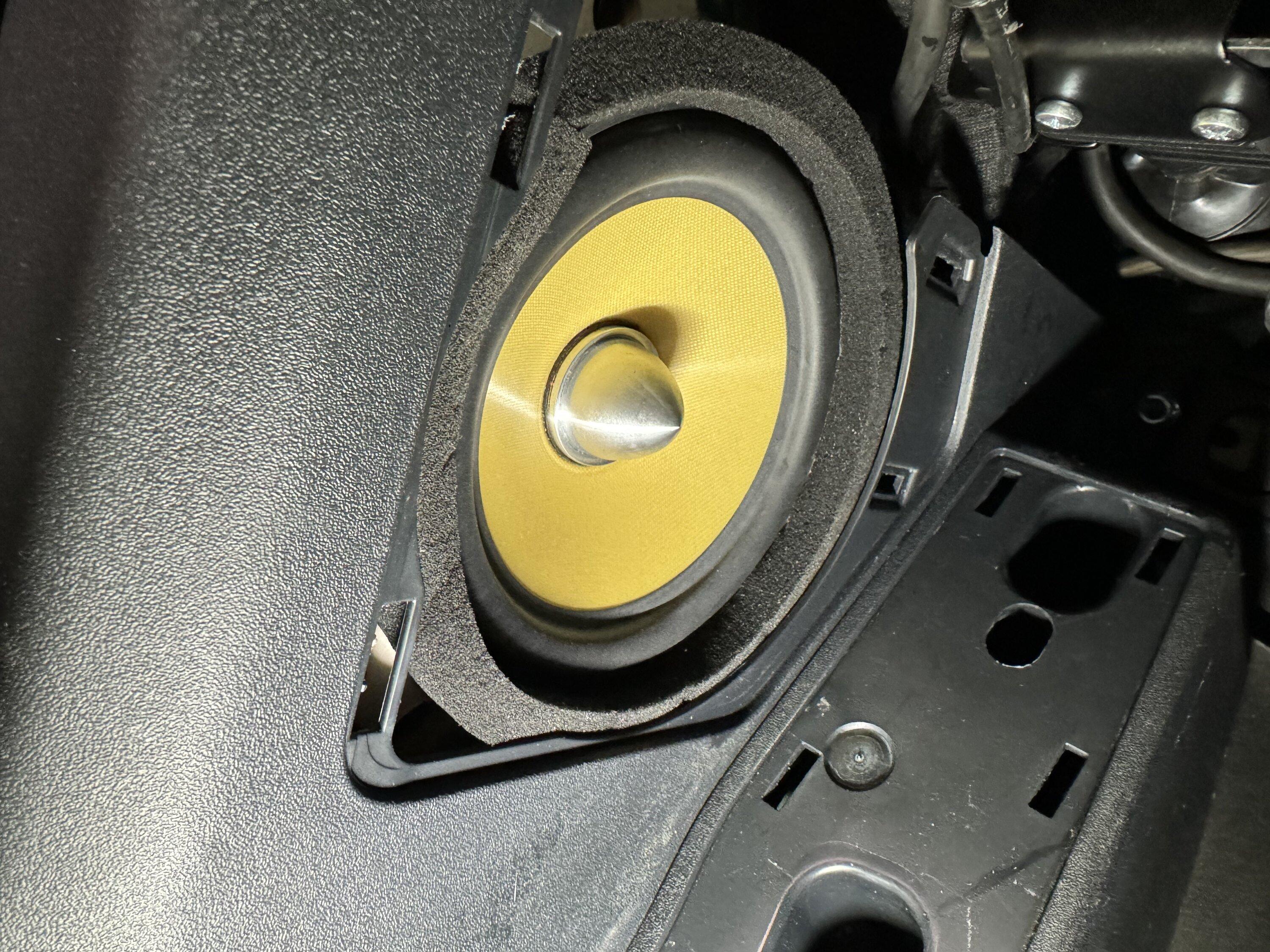

Fronts – Focal K2 3-way components
Rear – JL Audio C5-650 (overkill but I already own them)
Sub – JL 10TW3 shallow mount sub
Amps: Audison Forza AF M5.11 – Running Front woofers, Mids & Sub
Audison SR4.300.2 - Running Tweeters and Rear fill

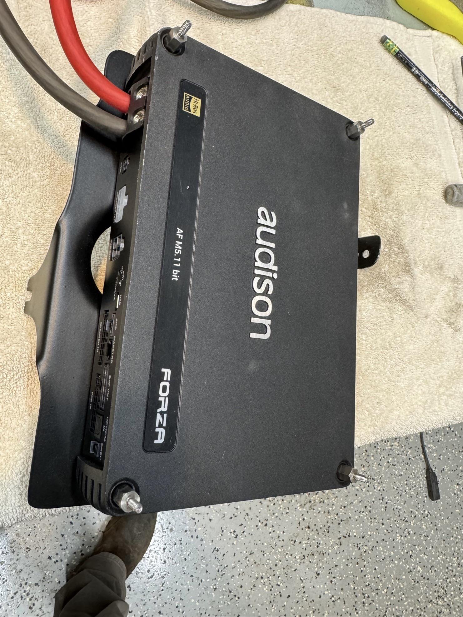

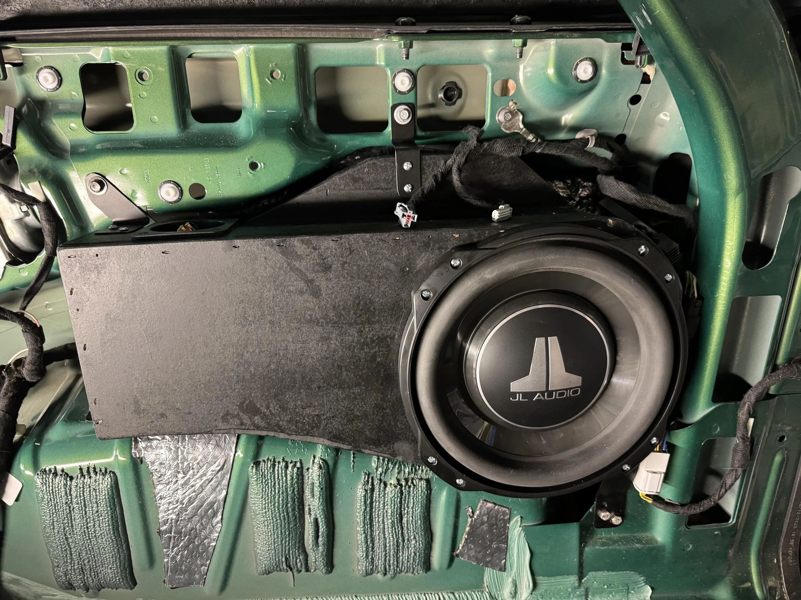

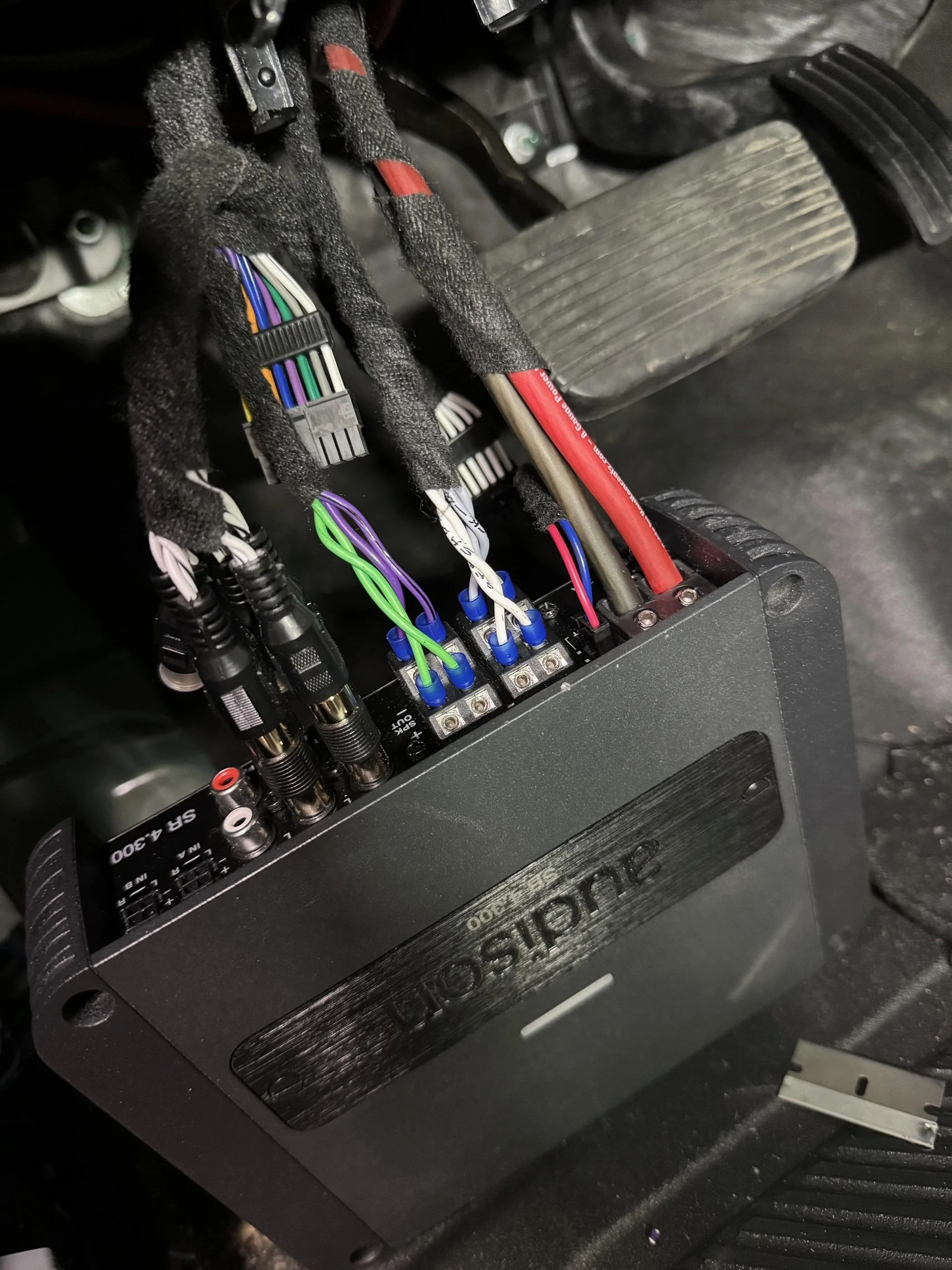

Amp Mounting – My goal for mounting the amps was to find a place that would be safe from water, should the interior get rained on or I decide to ford some deep water (It’s a Bronco thing). This was one of the driving factors that made the Audison package attractive. My original thought was to mount the amps under the rear seat but once I figured out I could fit them under the dash, it was a no-brainer. I designed a clever mounting system that utilizes factory points, keeping the amps tucked nicely up under the dash.
AF5.11 Mount, uses all factory mounting points without any modifications to the vehicle:
Ford Bronco 2023 Badlands Stereo Build, Focal, JL Audio, Audison - Lots of fabrication! IMG_9255
Ford Bronco 2023 Badlands Stereo Build, Focal, JL Audio, Audison - Lots of fabrication! IMG_9292
Ford Bronco 2023 Badlands Stereo Build, Focal, JL Audio, Audison - Lots of fabrication! IMG_9282

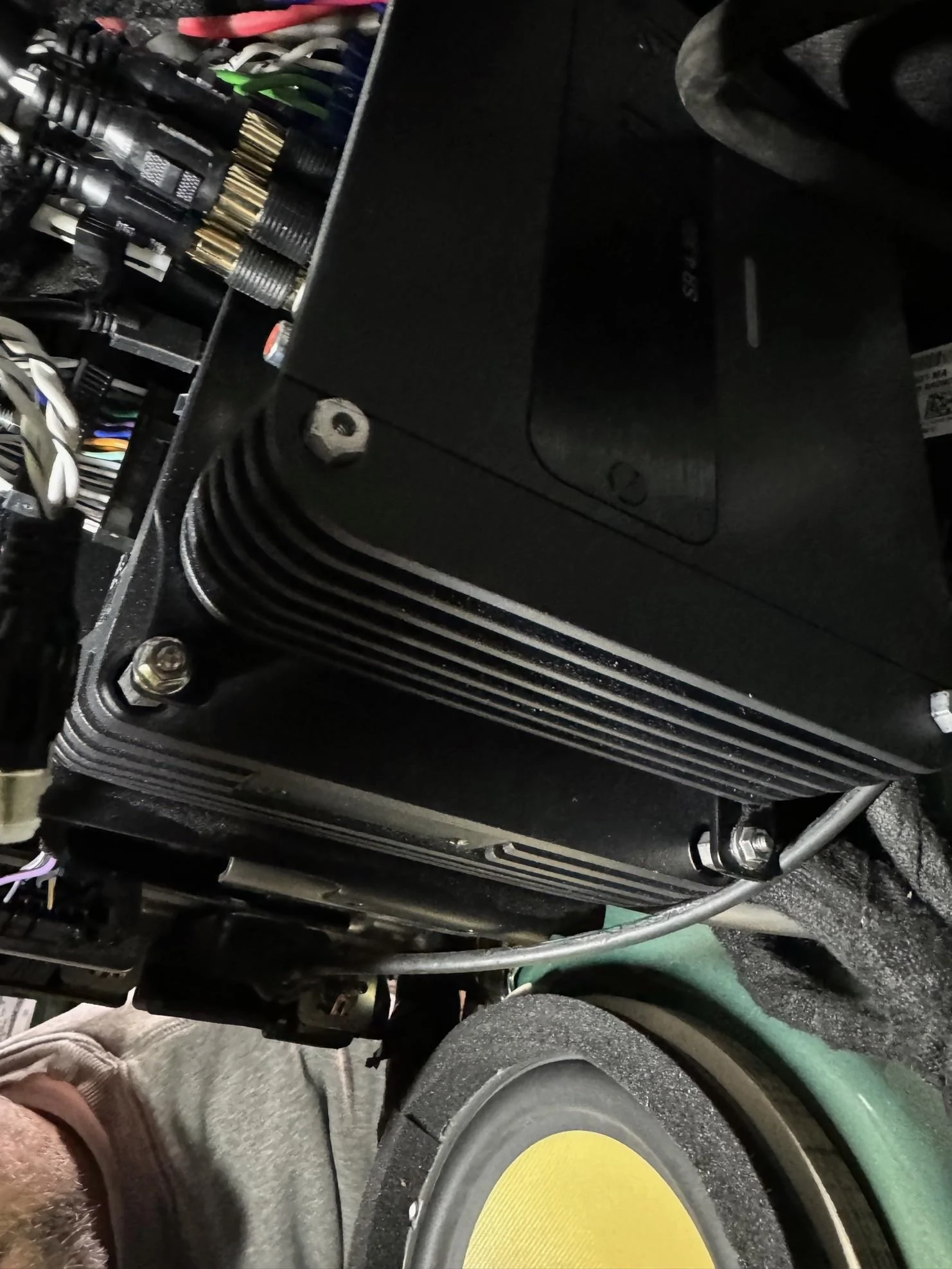

SR4.300 mounts on top of the AF5.11. I was able to leave what should be enough space so things stay cool.
Ford Bronco 2023 Badlands Stereo Build, Focal, JL Audio, Audison - Lots of fabrication! IMG_9286

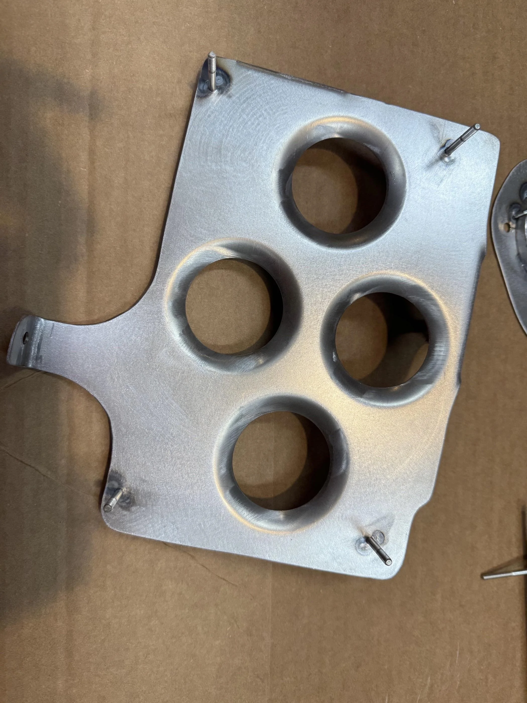

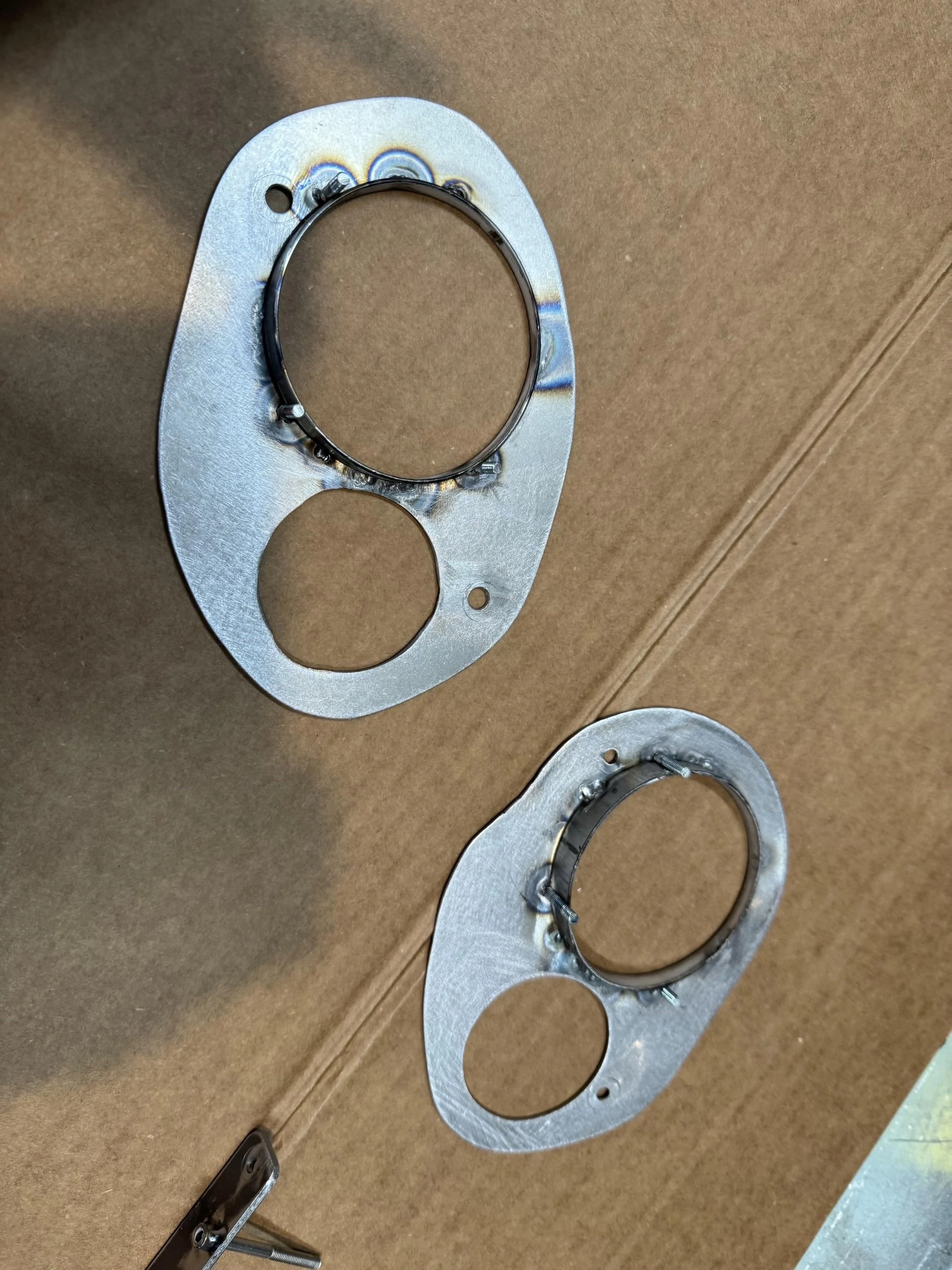

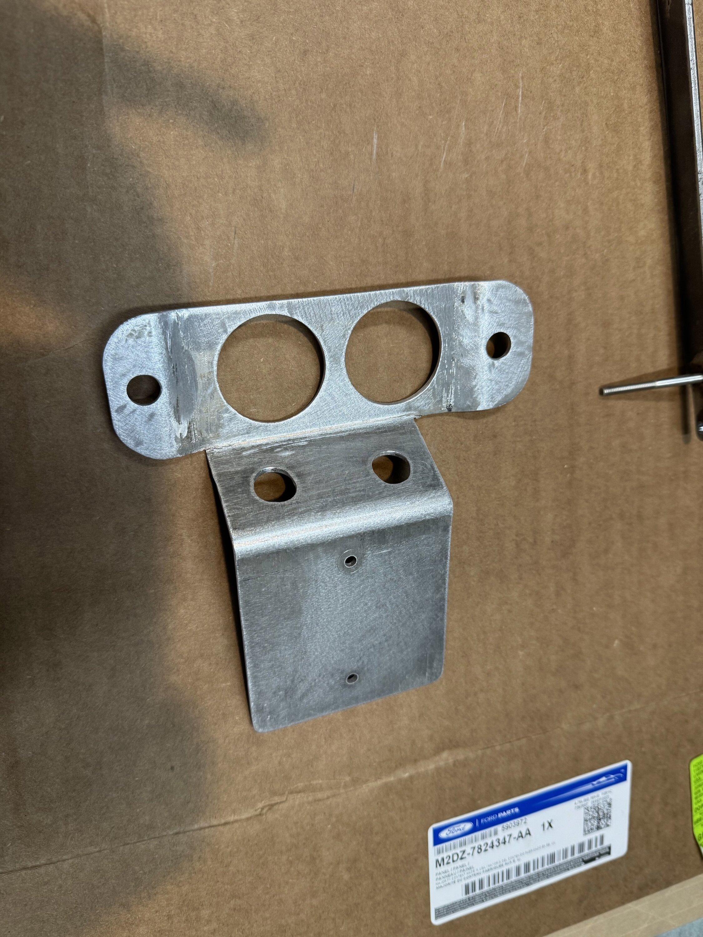

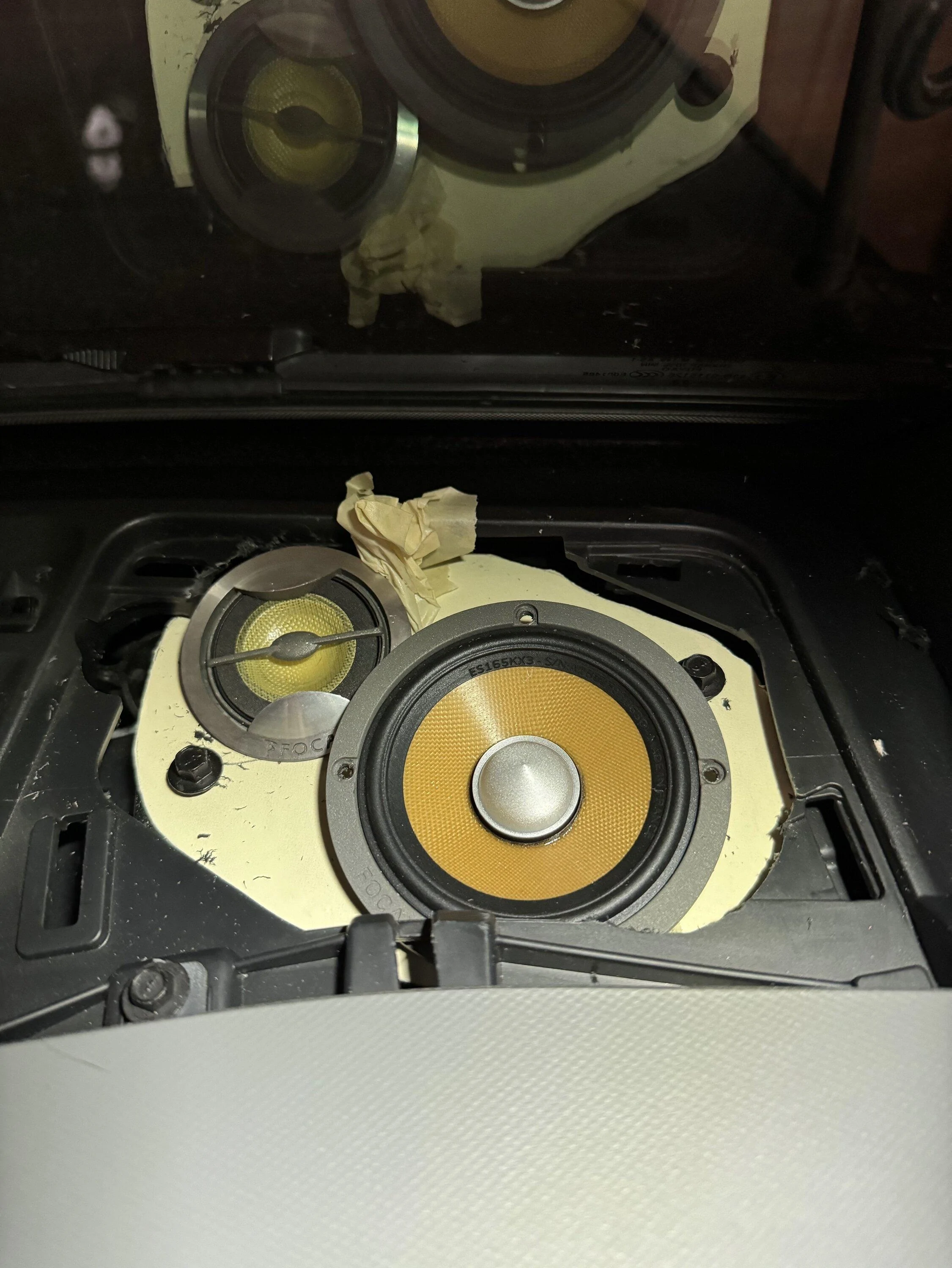

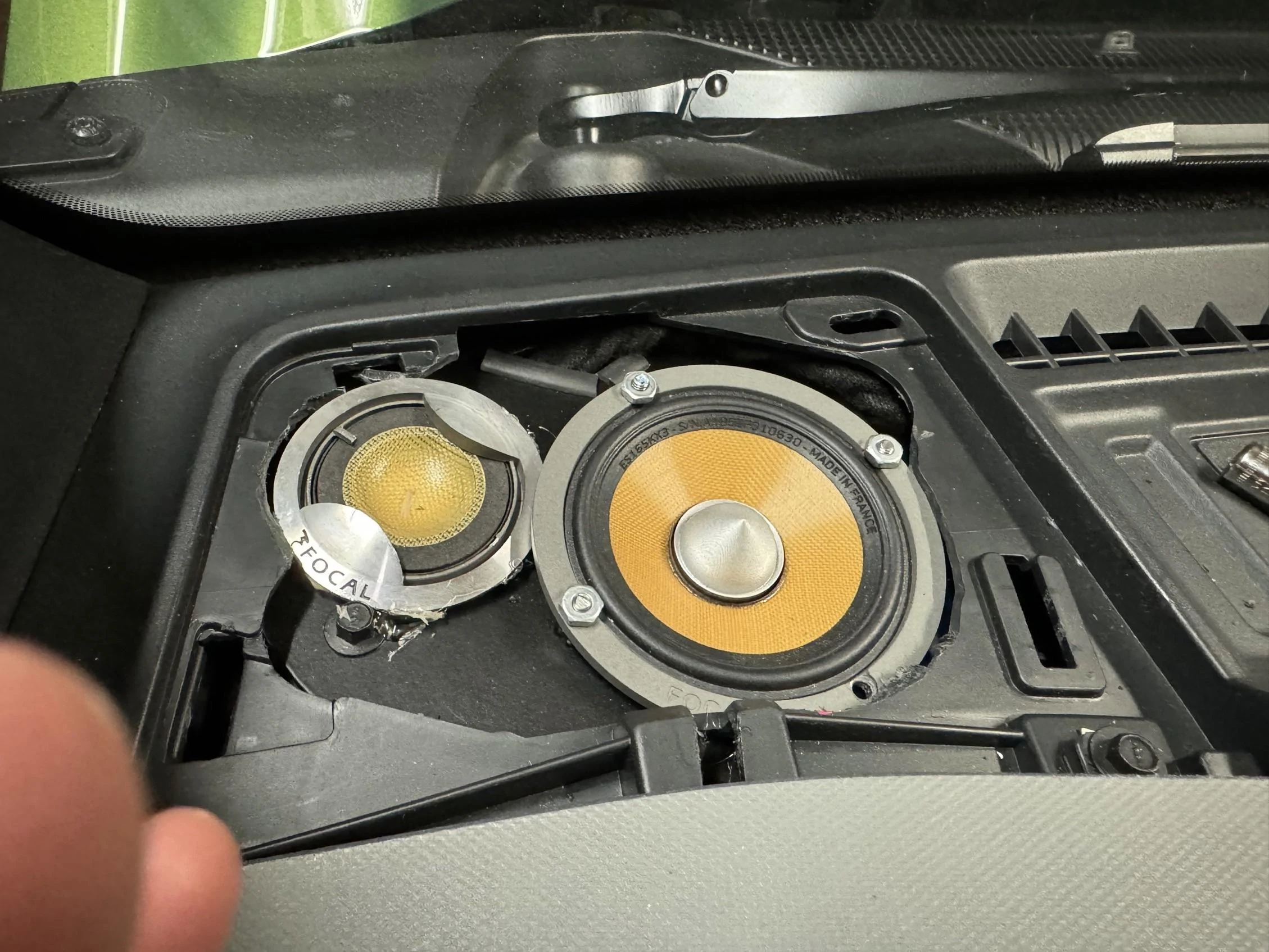

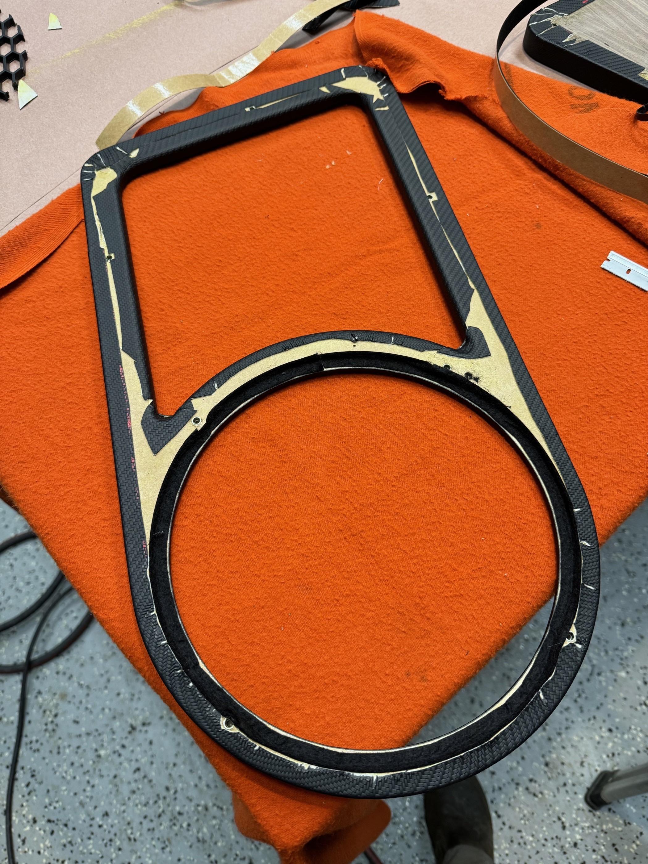

The mid and tweeter placement in the dash presented another challenge. I crafted a non-traditional metal mount, which allowed me to slightly overlap the speakers. This required some trimming of the dash but left both mounting screws in tact. I was also able to use the factory speaker covers, giving it a factory look.
Cad Design:
Ford Bronco 2023 Badlands Stereo Build, Focal, JL Audio, Audison - Lots of fabrication! IMG_9201
Brackets:
Ford Bronco 2023 Badlands Stereo Build, Focal, JL Audio, Audison - Lots of fabrication! IMG_9256
Installed:
Ford Bronco 2023 Badlands Stereo Build, Focal, JL Audio, Audison - Lots of fabrication! IMG_9285

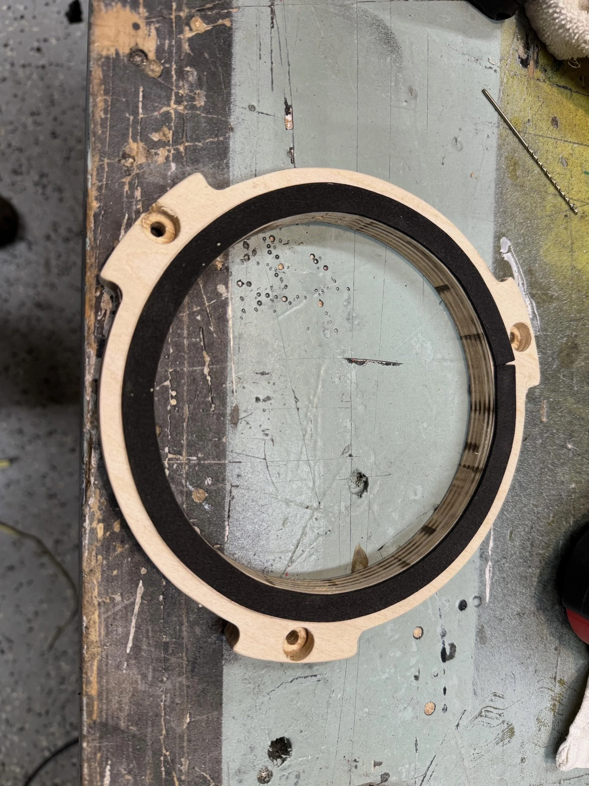

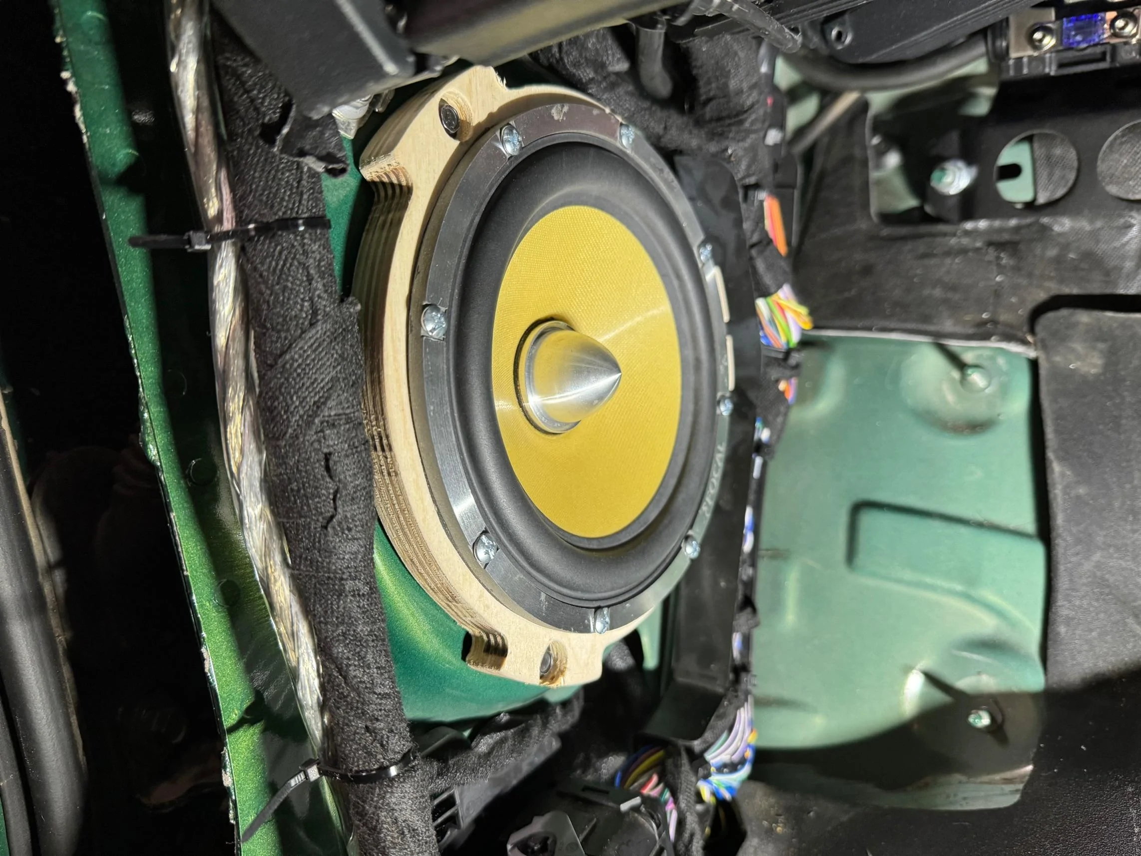

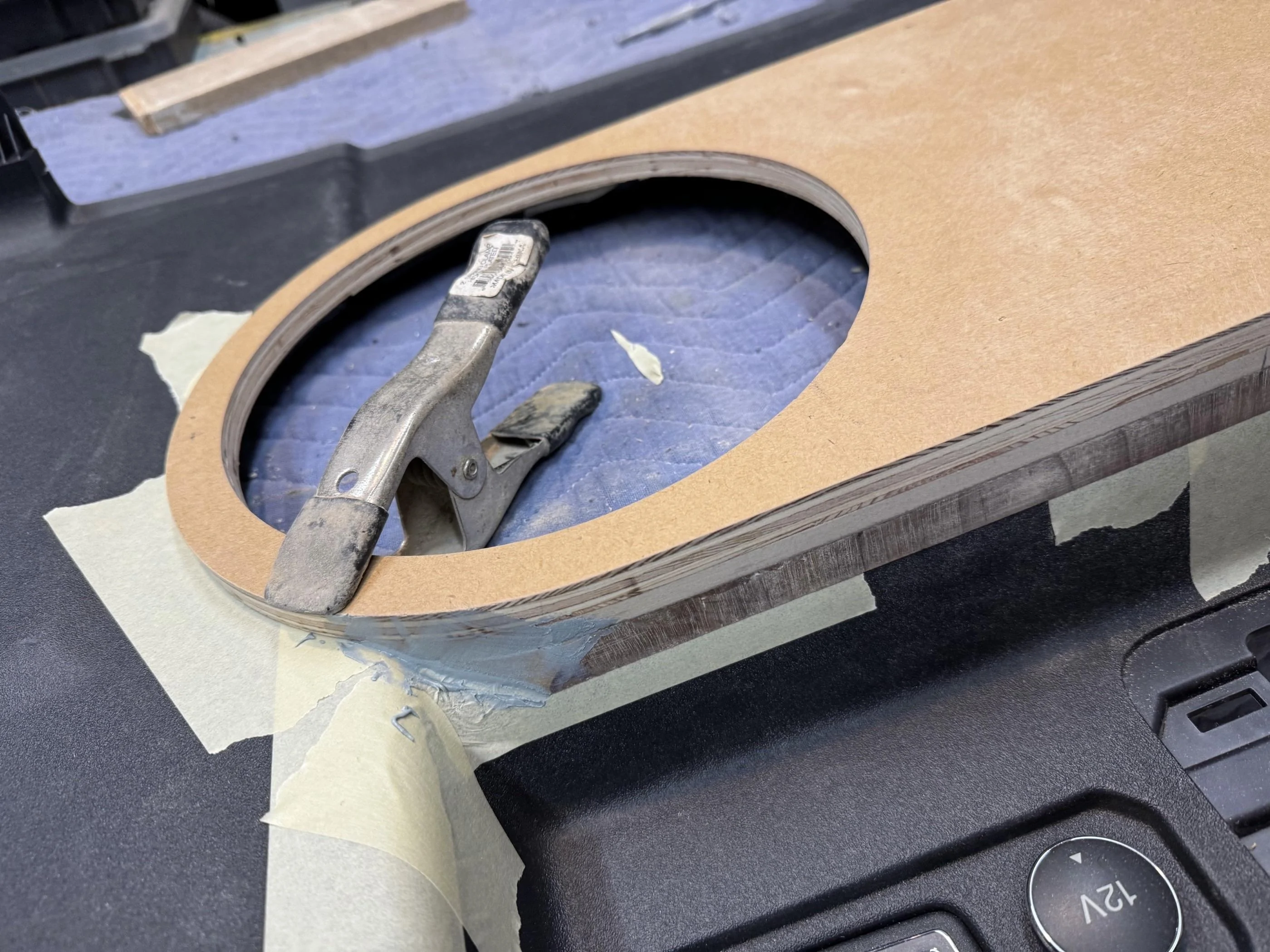

The woofers were easy, I opted to make my own spacers out of 5/8” birch plywood. I could have purchased plastic spacers but it was just as easy to make a pair.
Woofer Spacer:
Ford Bronco 2023 Badlands Stereo Build, Focal, JL Audio, Audison - Lots of fabrication! IMG_9279
Installed:
Ford Bronco 2023 Badlands Stereo Build, Focal, JL Audio, Audison - Lots of fabrication! IMG_9288
Ford Bronco 2023 Badlands Stereo Build, Focal, JL Audio, Audison - Lots of fabrication! IMG_9297

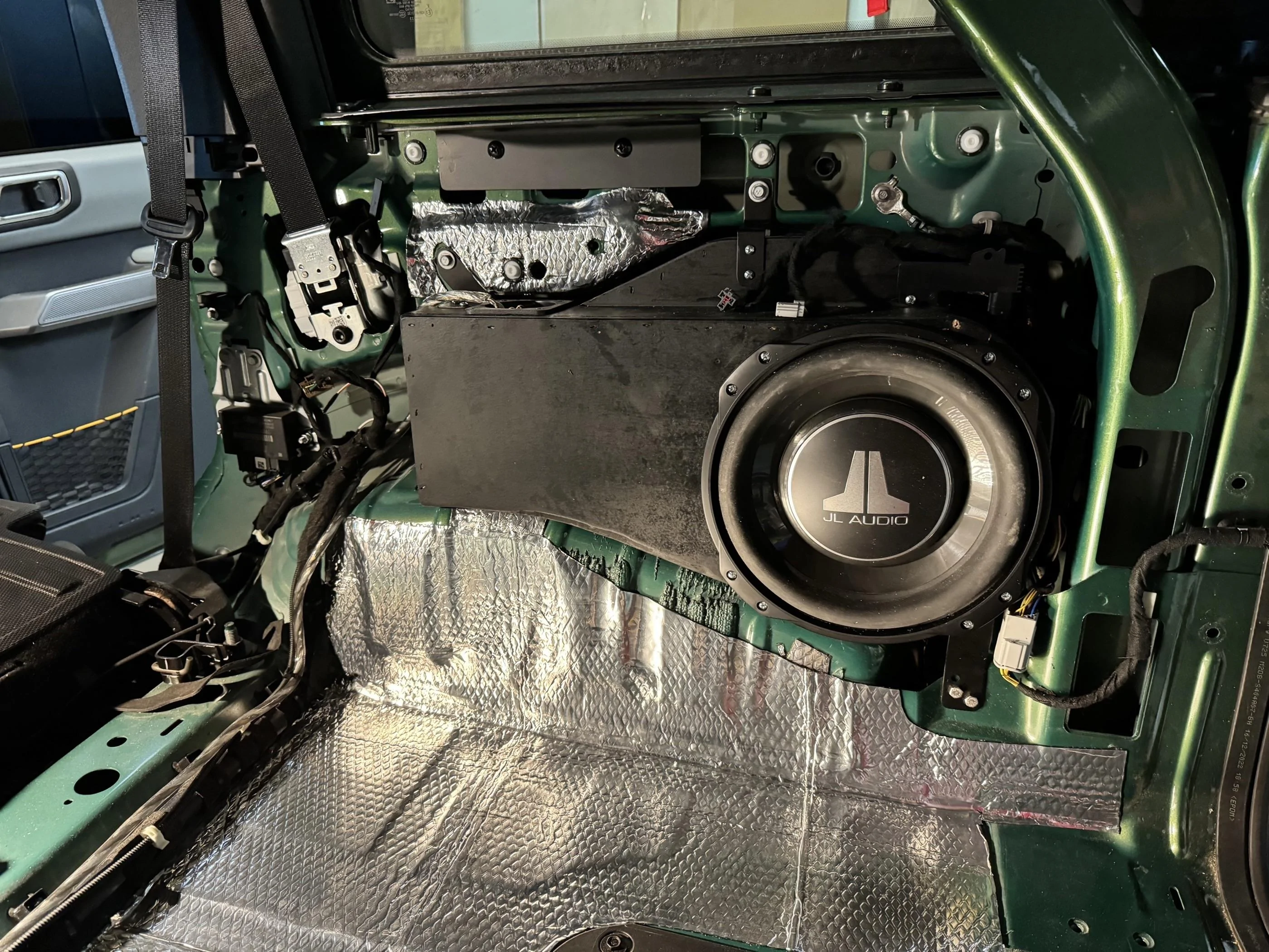

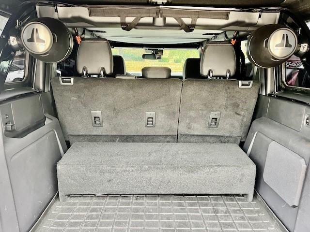

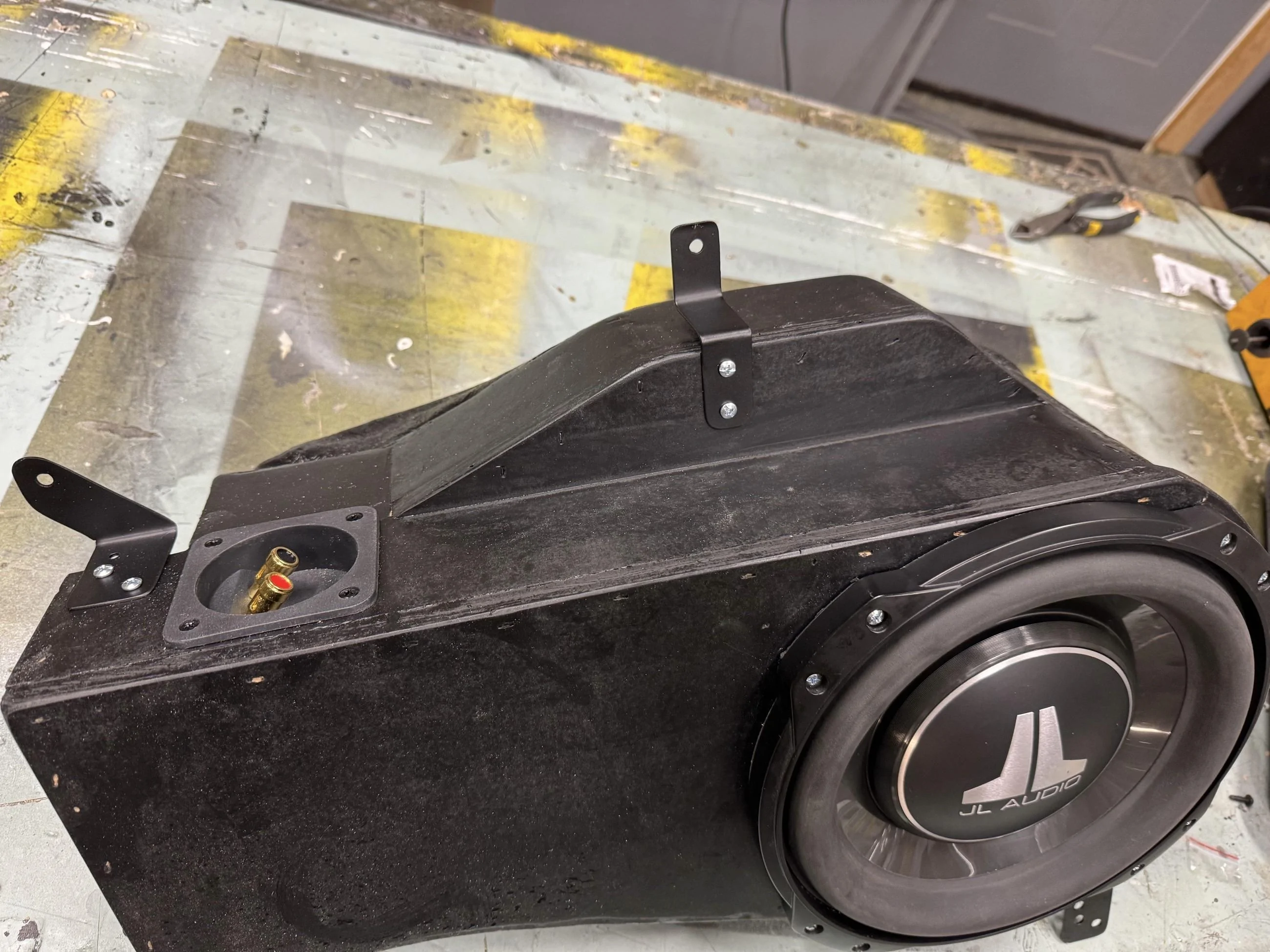

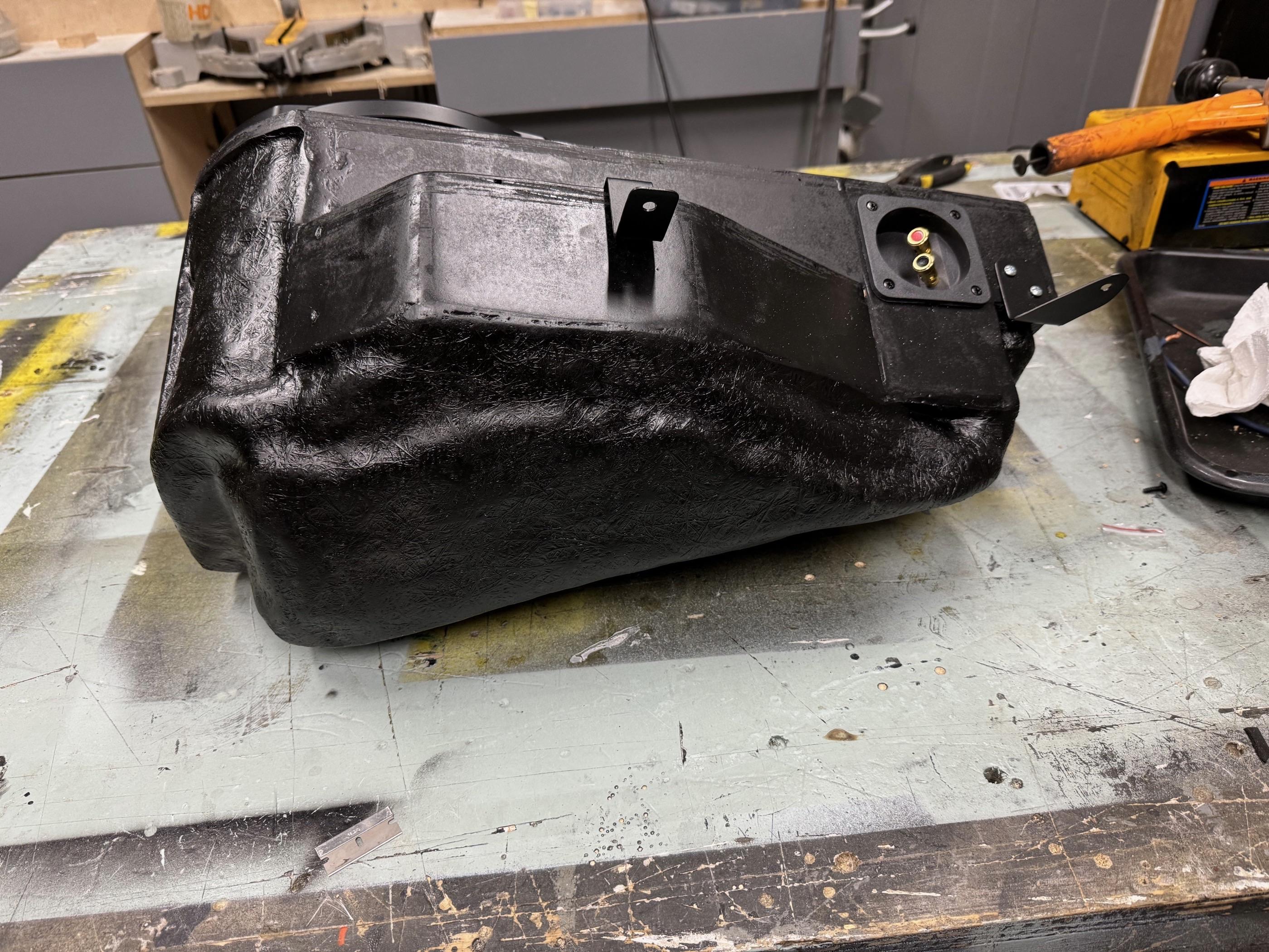

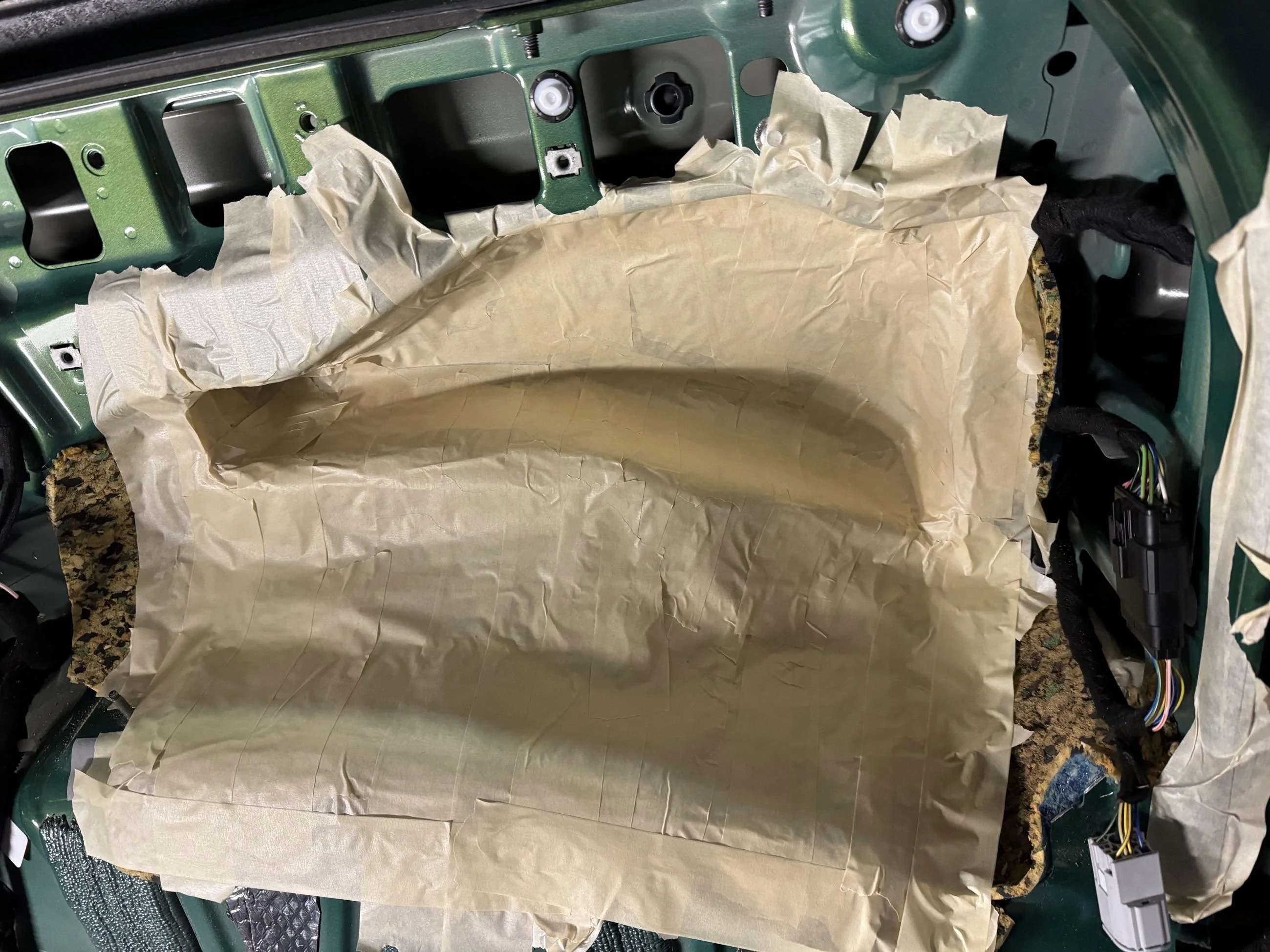

Subwoofer mounting – I waffled over two locations for the sub – the factory location in the cargo area or tailgate mounted. The factory location was definitely more tricky but this gave me a much more factory look and wouldn’t lose cargo space. This made the decision pretty easy for me - factory location. I used a combination of ¾ MDO plywood and fiberglass. I started out making the face to locate the speaker and worked from there. Once I had a portion made with plywood, I mounted it to the chassis through the factory mounts. I then applied a layer of masking tape over everything, then a layer of ¼” carpet pad and another layer of masking tape.
Ford Bronco 2023 Badlands Stereo Build, Focal, JL Audio, Audison - Lots of fabrication! IMG_9269
I laid up two layers of fiberglass to get the basic shape. Once dry, I removed and put 3 more layers on the outside of the box and also attached the face with screws and fiberglass. Overall, the box turned out great from a functional standpoint.
Ford Bronco 2023 Badlands Stereo Build, Focal, JL Audio, Audison - Lots of fabrication! IMG_9276
Ford Bronco 2023 Badlands Stereo Build, Focal, JL Audio, Audison - Lots of fabrication! IMG_9277
Ford Bronco 2023 Badlands Stereo Build, Focal, JL Audio, Audison - Lots of fabrication! IMG_9278
Ford Bronco 2023 Badlands Stereo Build, Focal, JL Audio, Audison - Lots of fabrication! IMG_9313

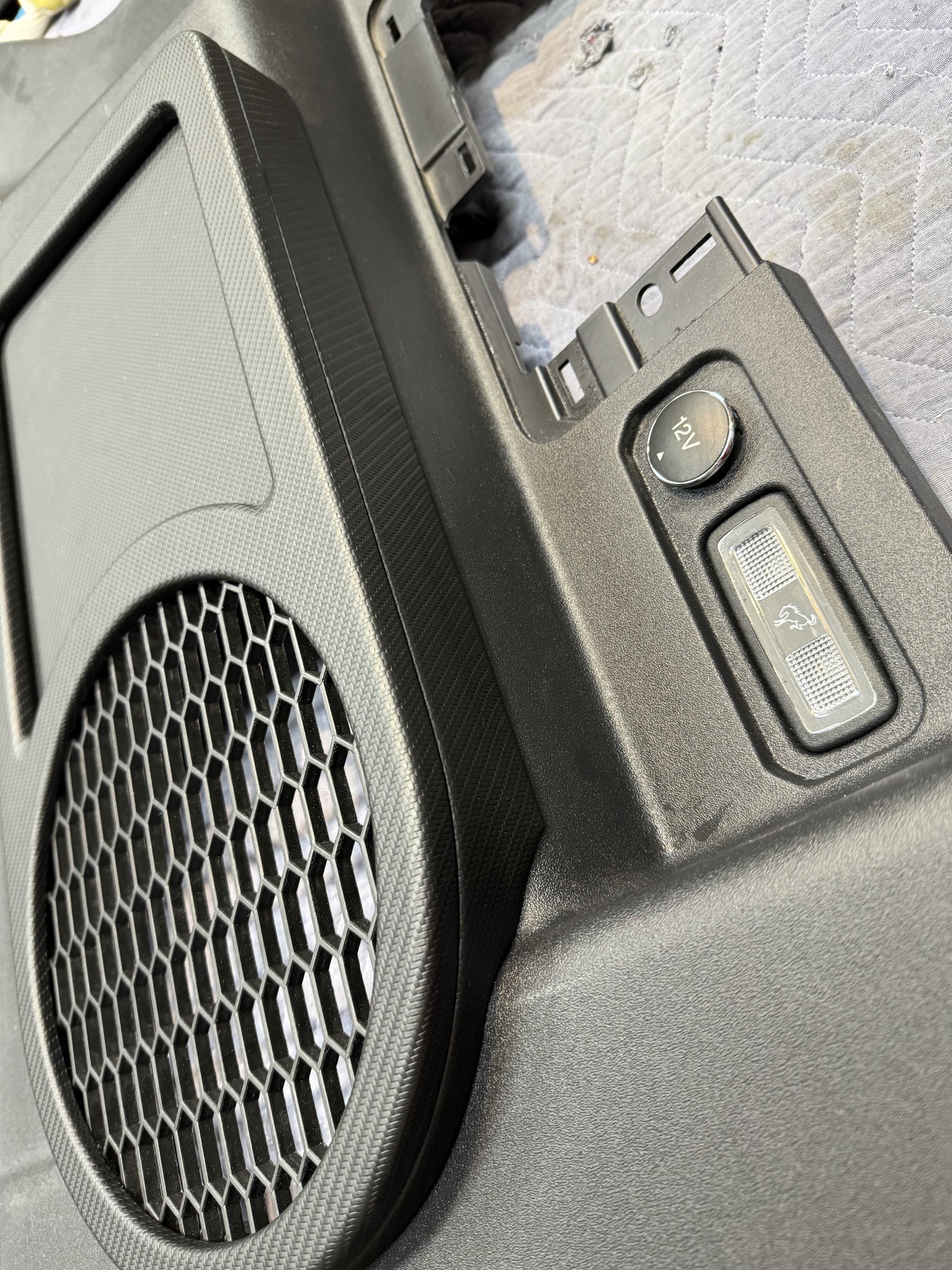

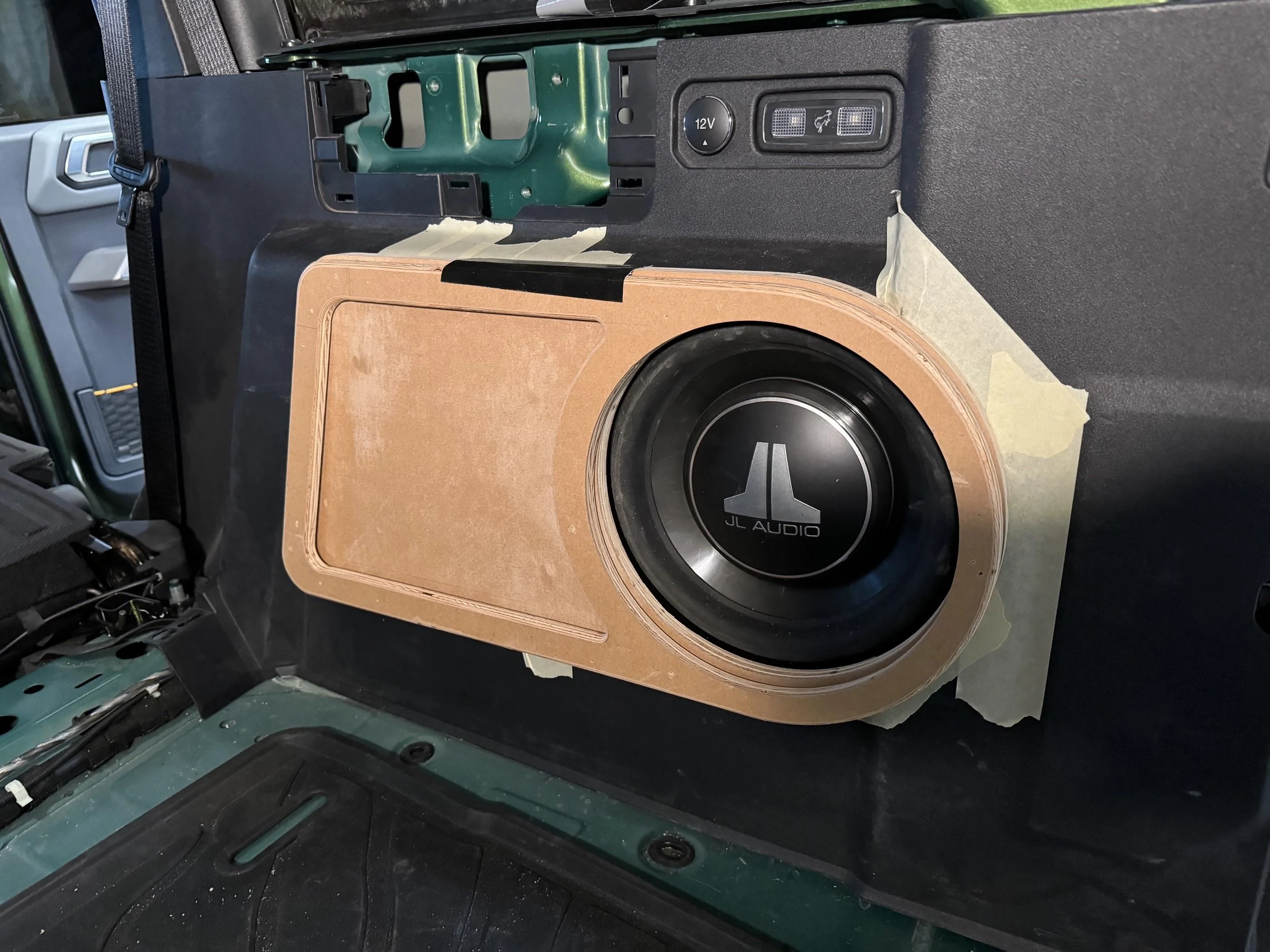

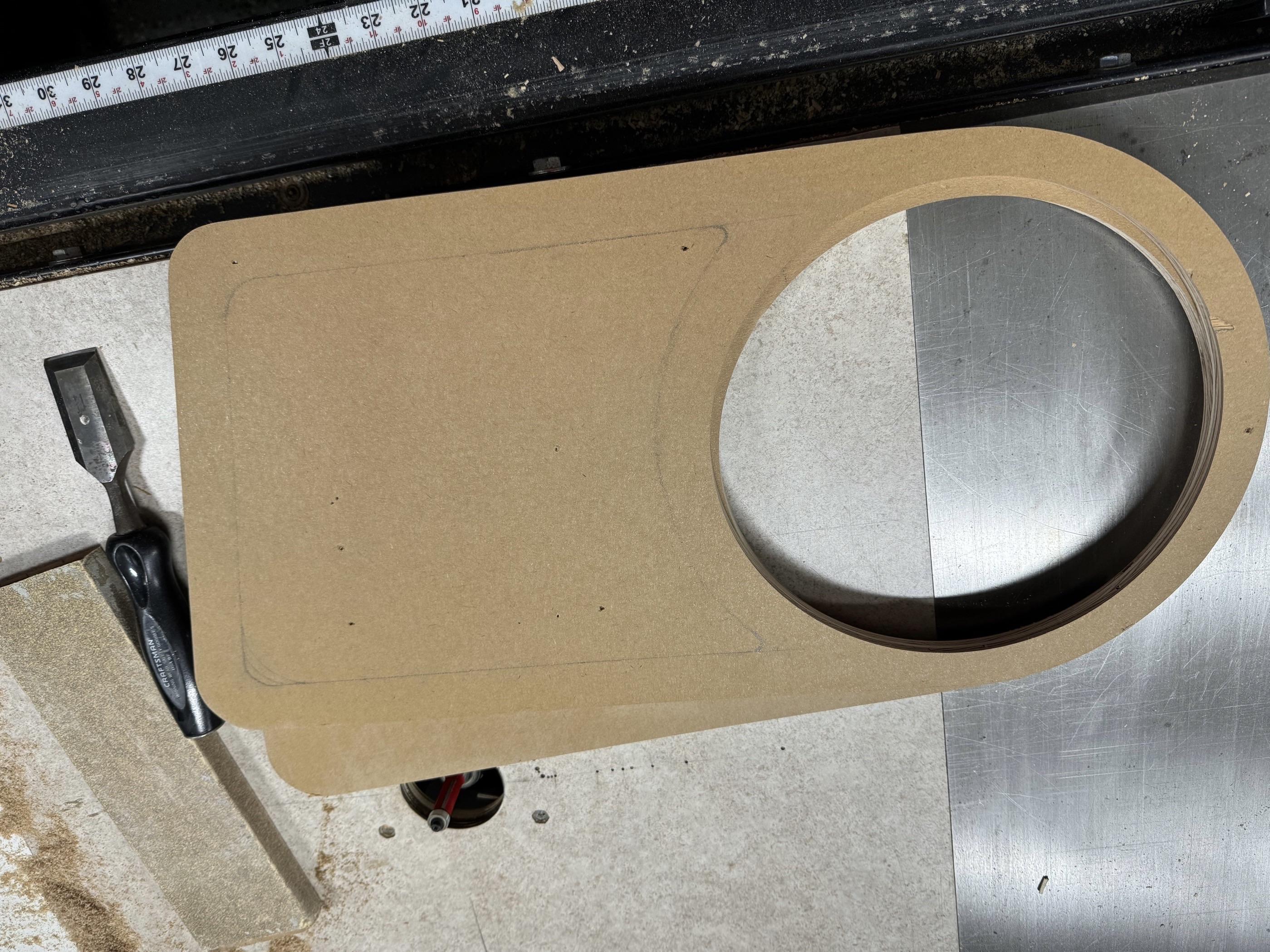

Sub Cover - The bronco comes with a factory 8” subwoofer in the same area but I had to shift the TW3 further back so it didn’t line up with the factory hole. This caused me to get creative in my cover design.
Material:
½” MDO Plywood
Diamond Grill material – Plastic
Carbon look Marine grade vinyl
The basic shape:
Ford Bronco 2023 Badlands Stereo Build, Focal, JL Audio, Audison - Lots of fabrication! IMG_9305

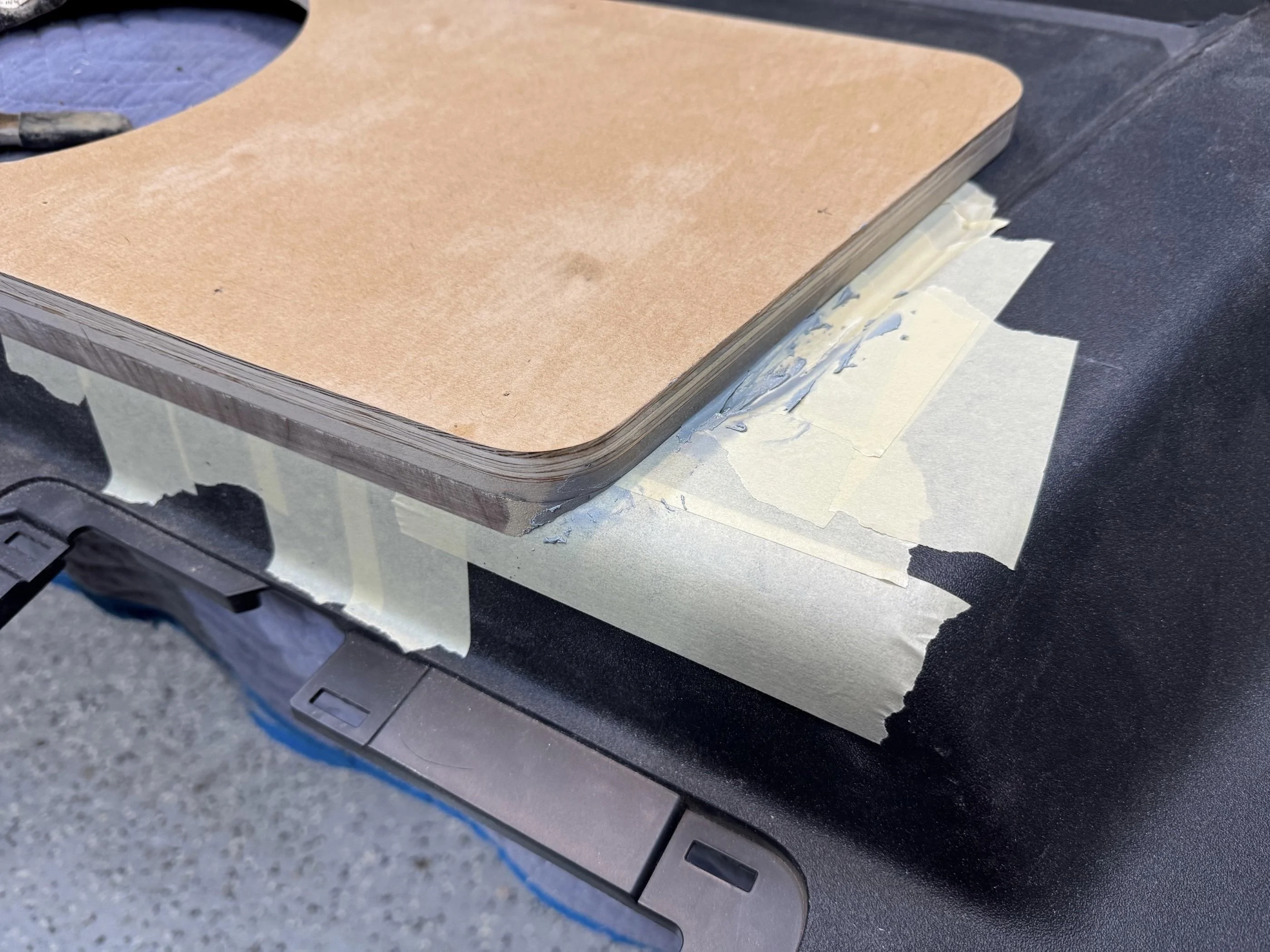

Test fitment:
Ford Bronco 2023 Badlands Stereo Build, Focal, JL Audio, Audison - Lots of fabrication! IMG_9308
Making it perfectly contour to the factory panel via Body Filler:
Ford Bronco 2023 Badlands Stereo Build, Focal, JL Audio, Audison - Lots of fabrication! IMG_9316
Ford Bronco 2023 Badlands Stereo Build, Focal, JL Audio, Audison - Lots of fabrication! IMG_9315

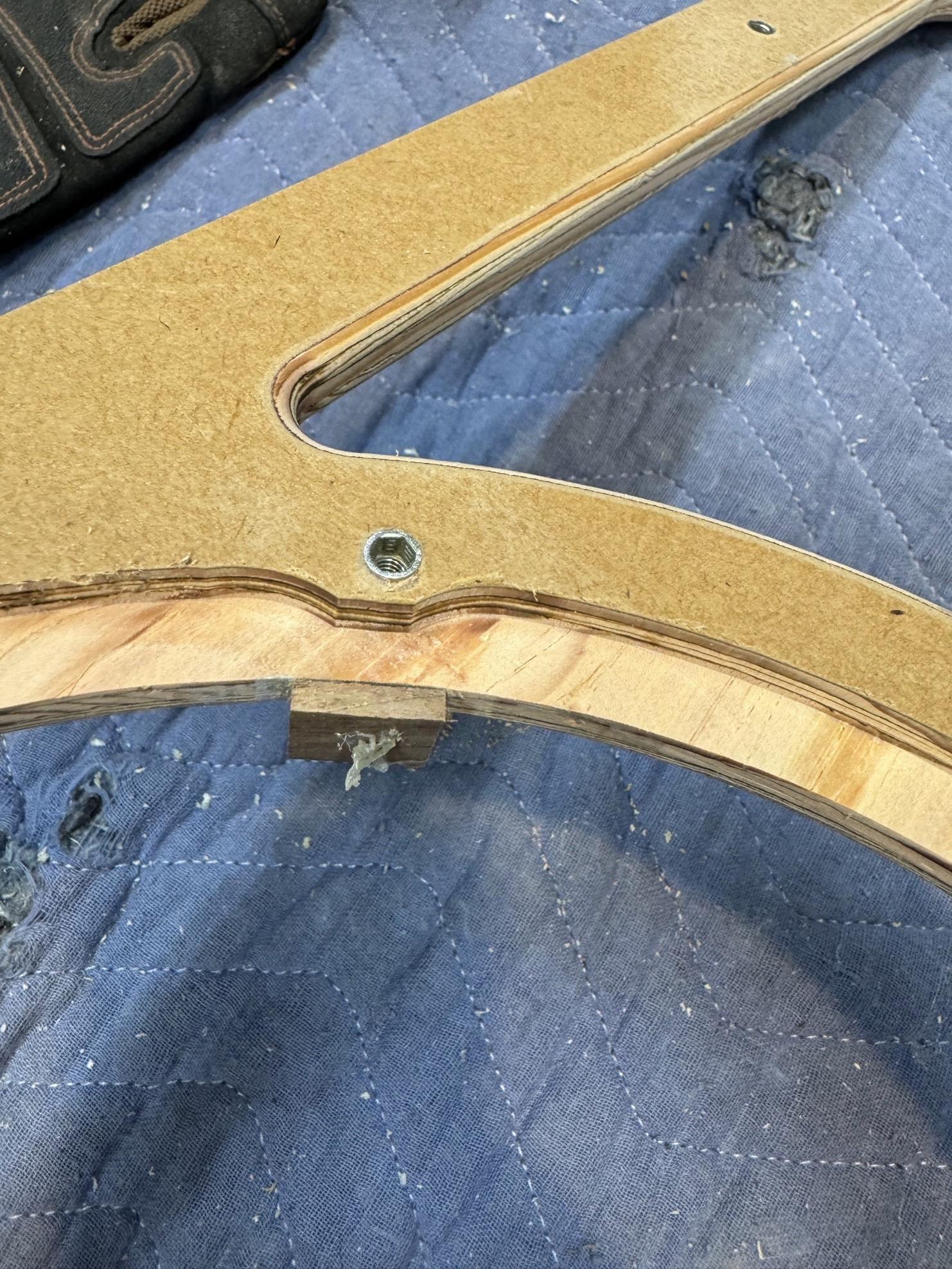

I used threaded inserts for all mounting points;

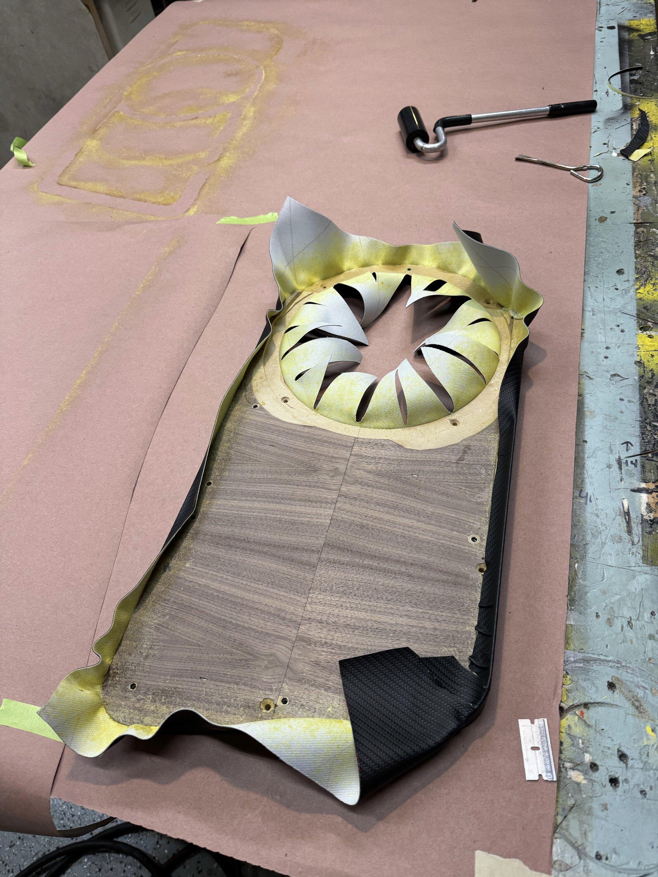

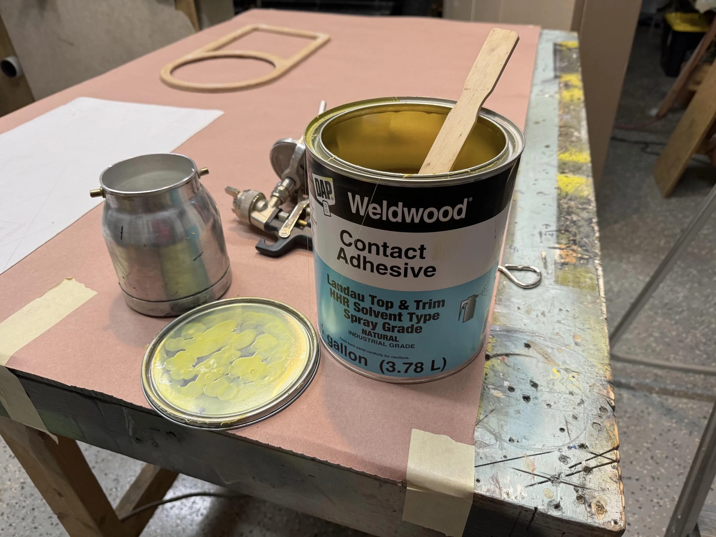

Weldwood Landau Contact adhesive to attach vinyl:

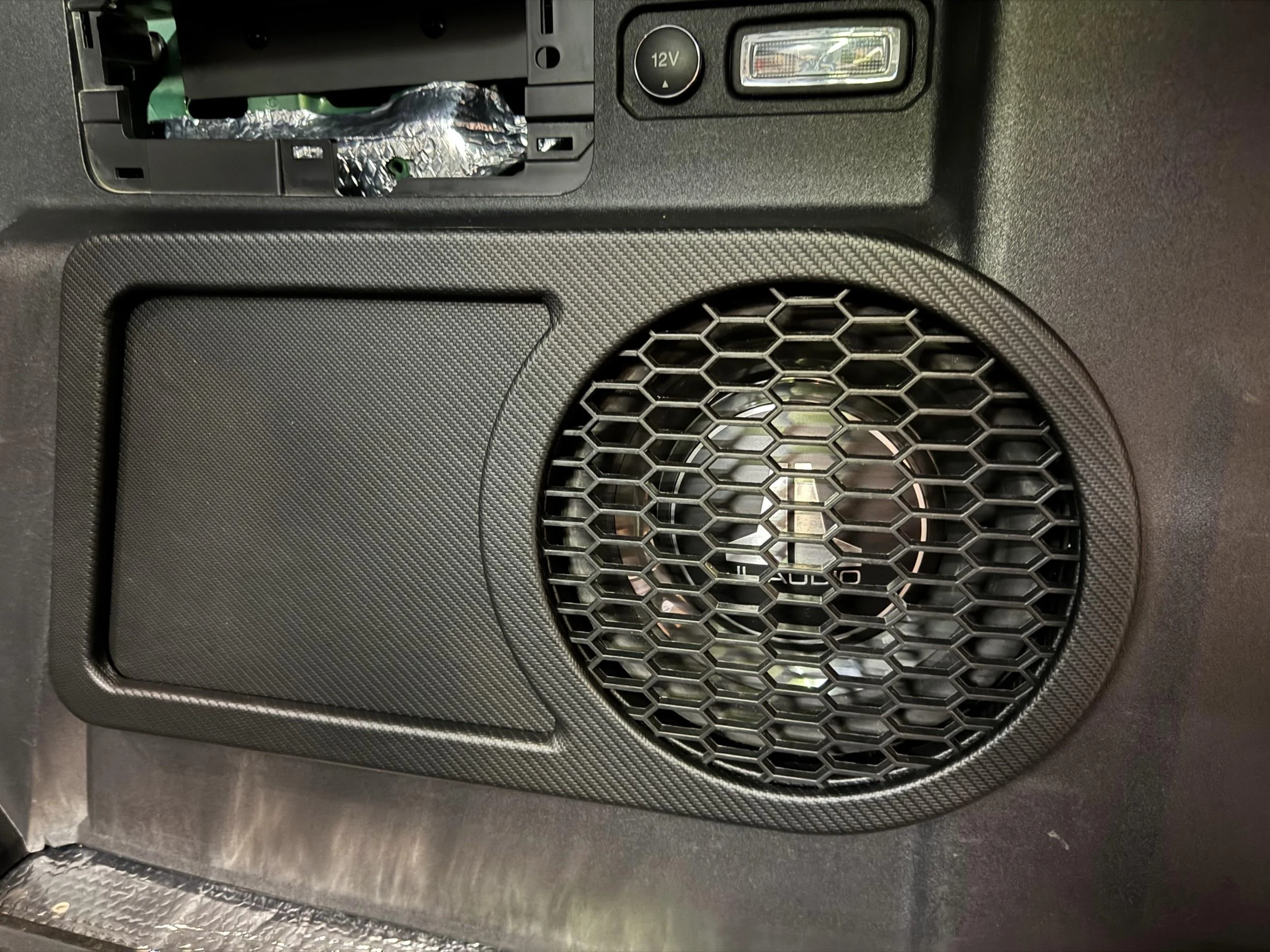

Ford Bronco 2023 Badlands Stereo Build, Focal, JL Audio, Audison - Lots of fabrication! IMG_9323
Final Wrapping (was not easy)
Ford Bronco 2023 Badlands Stereo Build, Focal, JL Audio, Audison - Lots of fabrication! IMG_9326
Ford Bronco 2023 Badlands Stereo Build, Focal, JL Audio, Audison - Lots of fabrication! IMG_9325
Overall, I am very happy with how the cover came out.

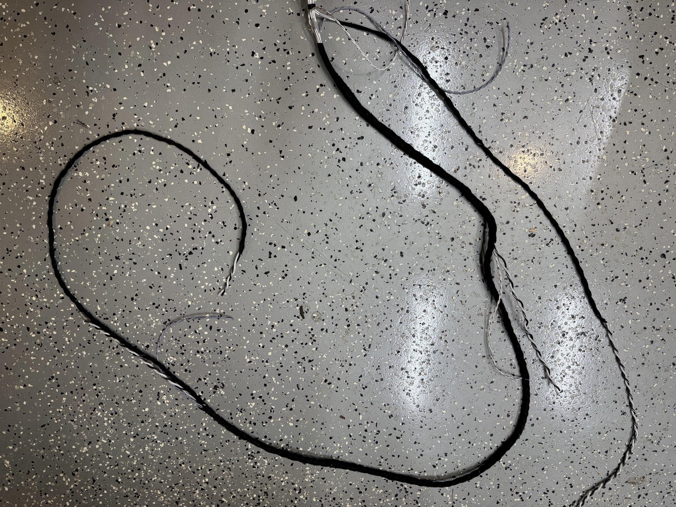

Wiring: Wiring was kept pretty streamlined due to the convenient location of the amps. I was able to pre-assemble the harnesses using Tesa tape, which gave a very factory look. I ran 16 gauge for the woofer and mid and 18 gauge for the tweeter. The sub has 12 gauge running to the back.

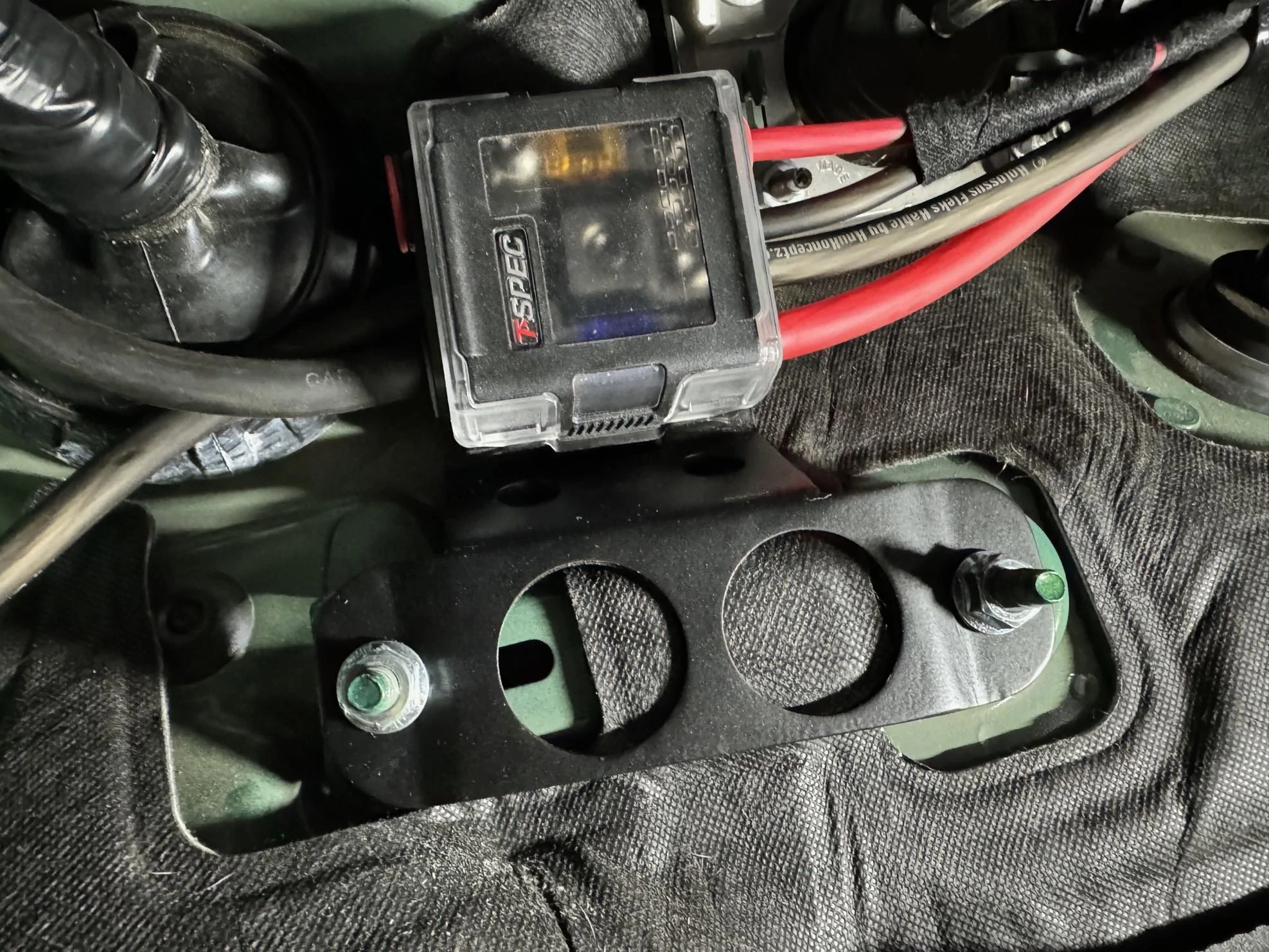

For power, my main power wire is 2 gauge which reduces to 4 gauge for the 5.11 and 8 gauge for the 4300, all through a single fuse block mounted on factory studs under the dash.
Fuse Bracket:
Ford Bronco 2023 Badlands Stereo Build, Focal, JL Audio, Audison - Lots of fabrication! IMG_9257
Installed:
Ford Bronco 2023 Badlands Stereo Build, Focal, JL Audio, Audison - Lots of fabrication! IMG_9296
